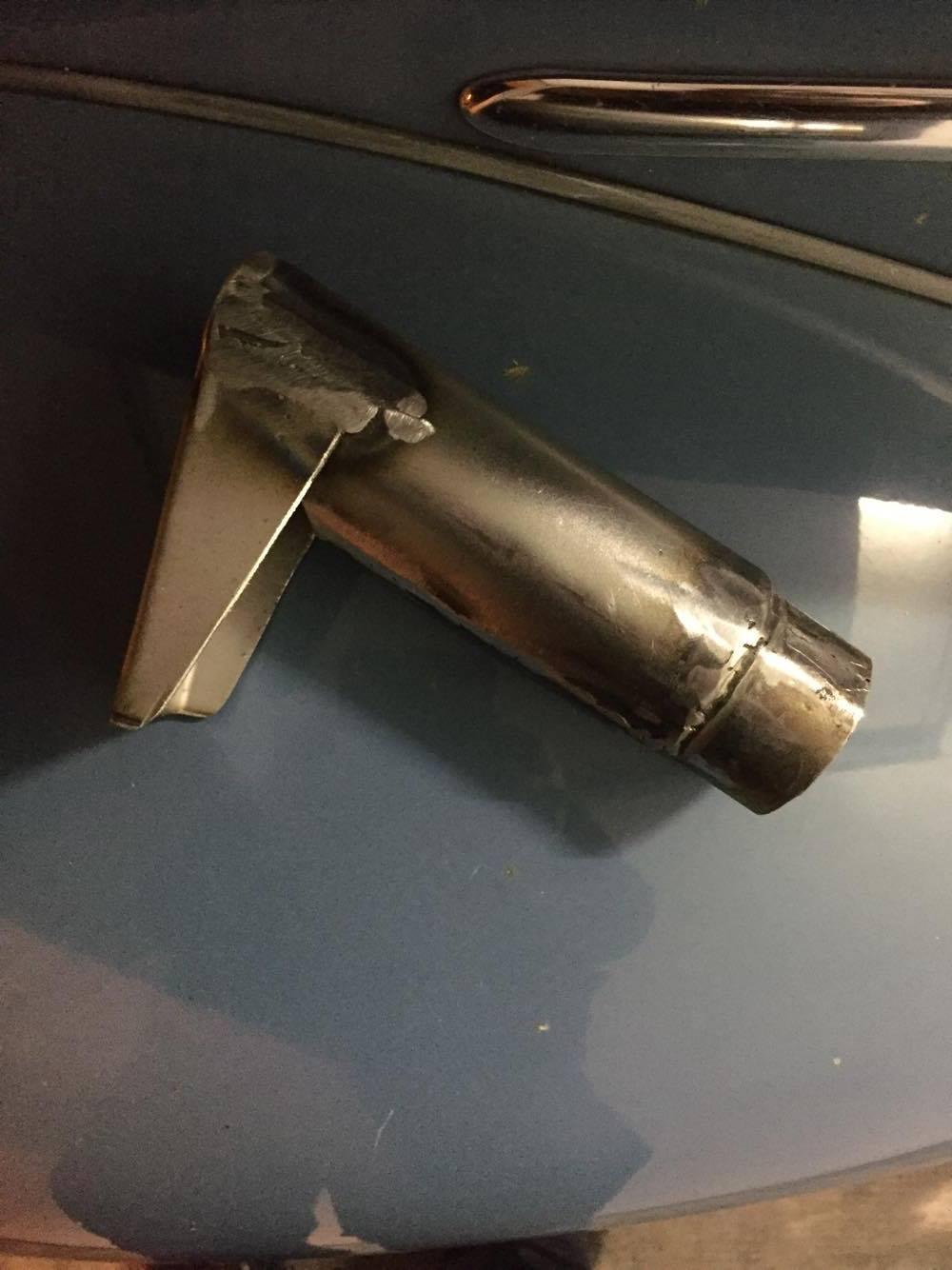

Thanks to your posts for your information a friend was able to reproduce the output of pot for eberspacher b2 here detail

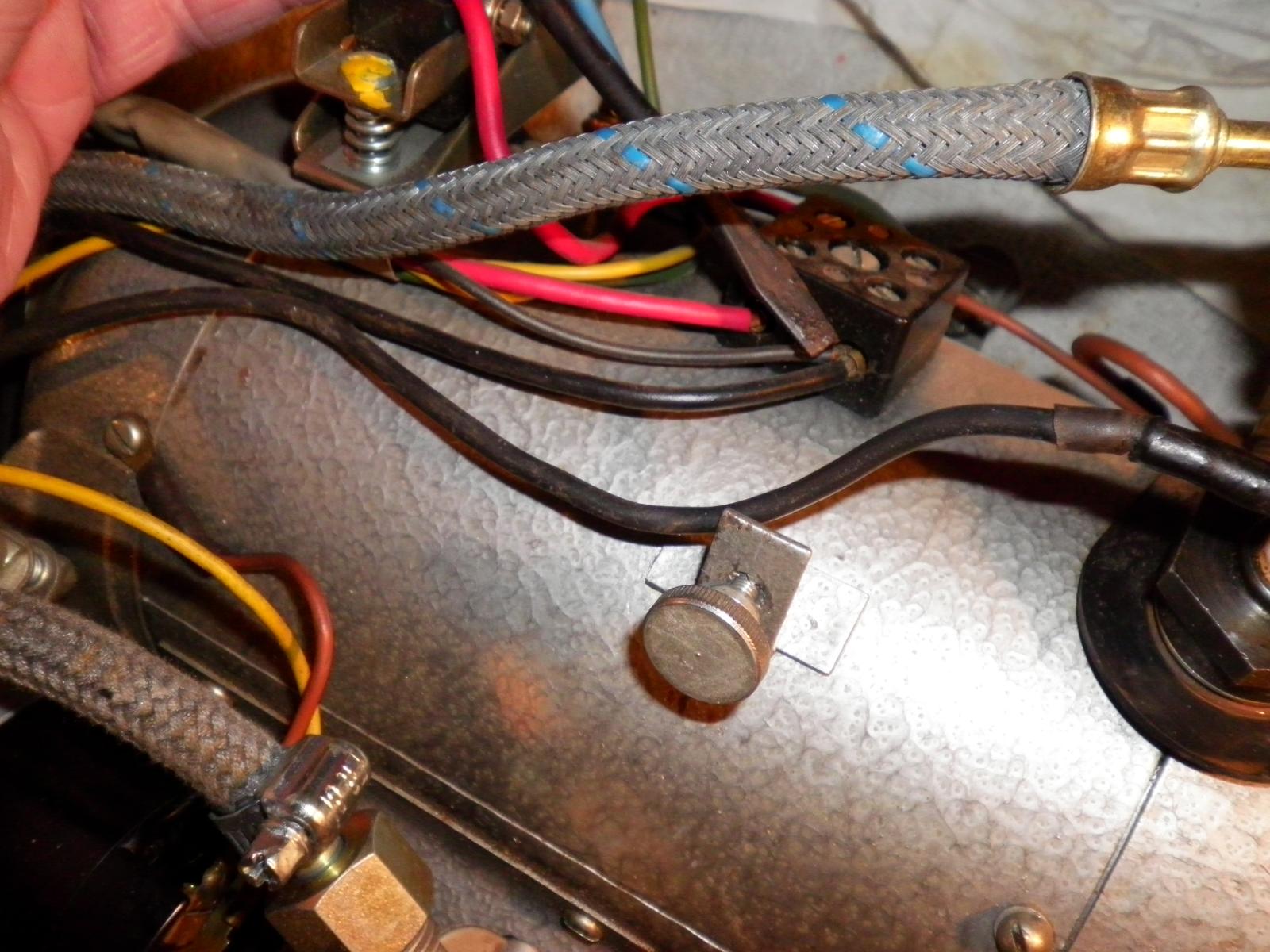

here you can see 2 cables go in the b2. where do they end ?

PostPosted: Tue Dec 03, 2024 8:52 am    Post subject: Re: Eberspacher B2 Rebuild Project Reply with quote
The braided fuel line? It comes from the tank on the bottom and returns the unused fuel back to the tank on the top. It acts like modern FI in that there is a jet that regulates the amount of fuel is squirted into the combustion chamber as the fuel passes by in a loop.

No the Blue marked black cable, i think it is to show starting
