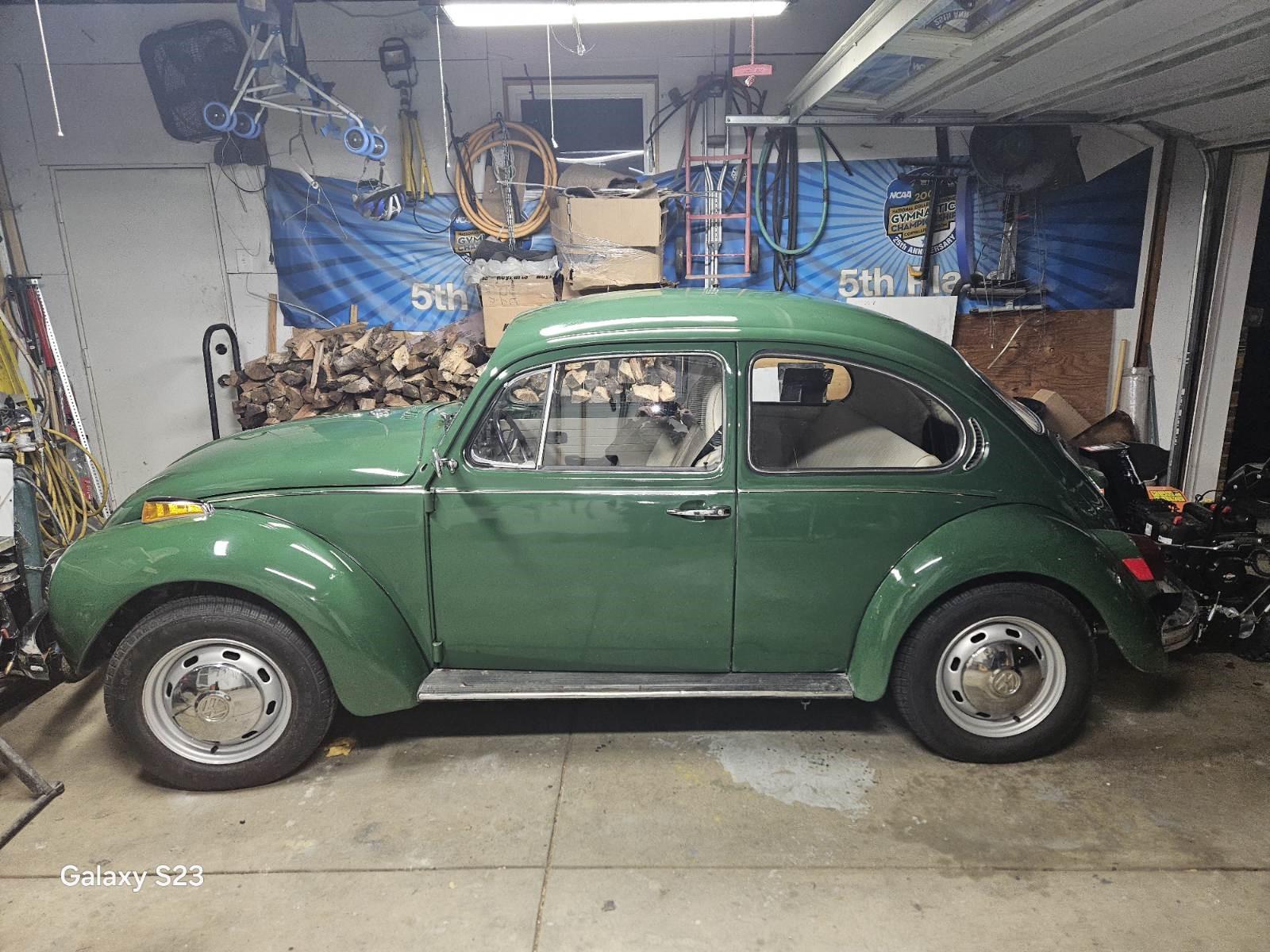

Well lookie here! I got some nice comments from many people who I have met here on Samba, and especially respect ALL of the comments and assistance I've received from these three, VW_Jimbo, Jeremy_G, and tzepesh.
It has been a process, a hobby, an obsession, and many other things but it first and foremost it has been FUN!
Is it all over? Well, if you are like me, it's never really over is it?
Things to do, always, and yes, maybe even thinking about another one...
Hehehe let's get a new garage!
Happy Thanksgiving everyone. And a special thanks to these three!

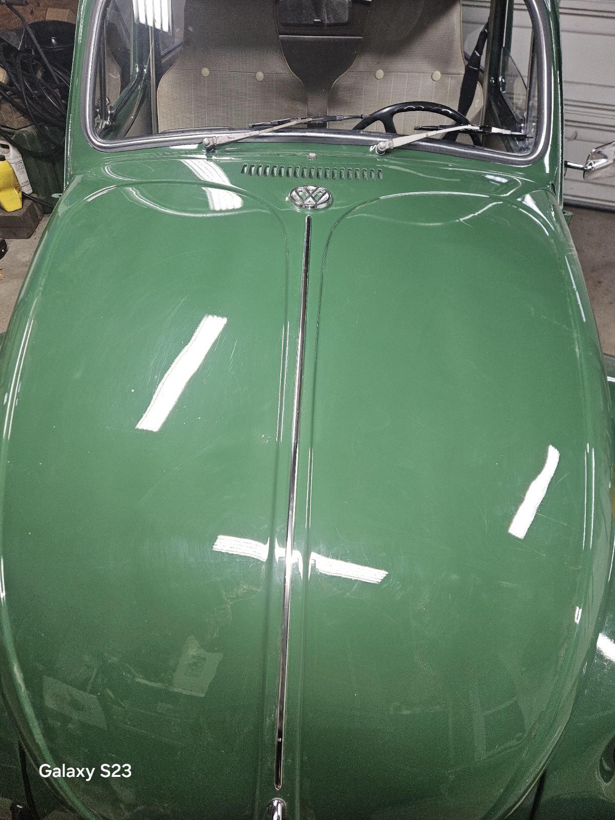

So this holiday weekend, I took the liberty of putting on all my chrome trim.
Now, realize it was probably 3 years ago when I had to take all the chrome trim off, right? Having to pull out and of course subsequently ruin all the "tabs" was a bit disheartening.
Well, putting the chrome back on, I gotta tell ya, the enjoyment I got out of the whole process was real.
Starting with the "reaming" of the little holes with a tool al Chris Vallone on Classic VW Bugs, then pushing the brand new clips (I love the little gasket they include) in the holes, and then just "tapping" the little tab in with the use of a flat hammer head on one of my metal working hammers. It was real!
Then leveling and straightening them all out, and finally, of course, that satisfying "snap" you get when the chrome strips are set in place with a light "thump" with side of your hand.
I felt a sense of "closure", when that last strip was in place.

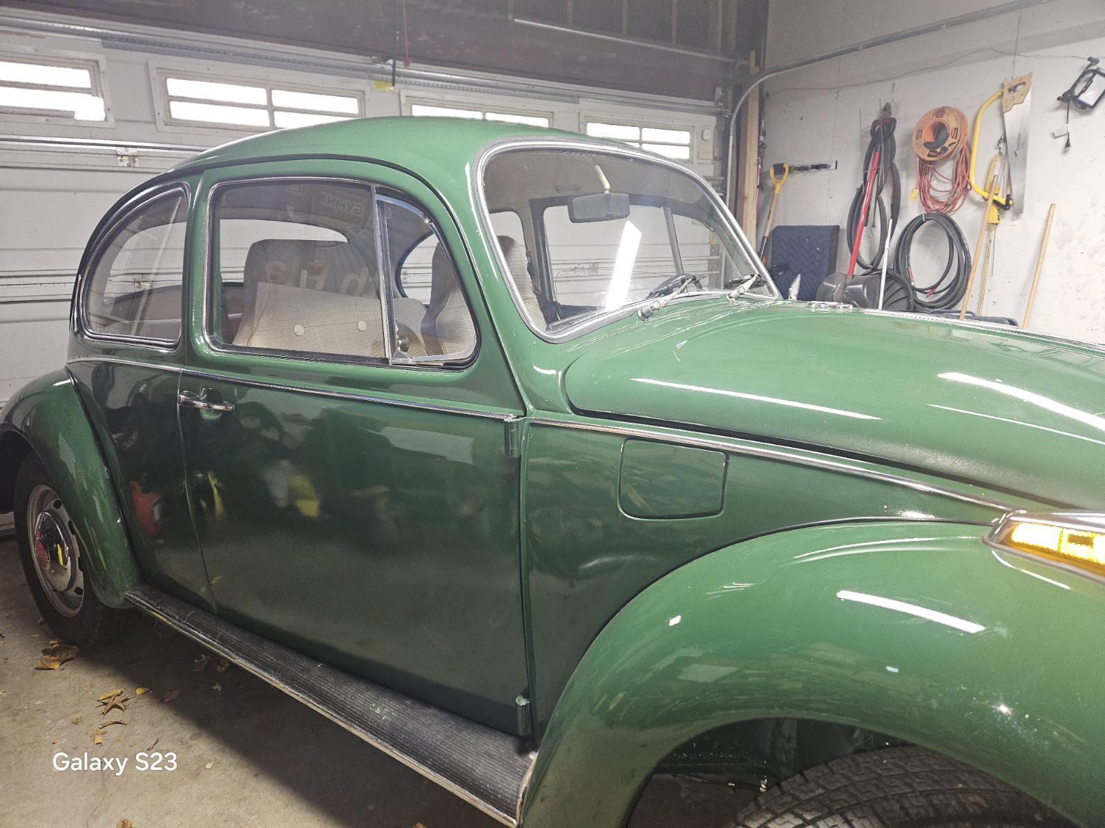

Got the left side visor in already, thanks again for the pictures. What a trip.
Still took about 2 hours to get it in.... Argh. And the worst thing, the little spring and the compression "nut" they put on the aftermarket visor end popped off. Of course, they fell all the way down into the "A" pillar. I can still use the visor from the front to shield the eyes, but if I pull it off the little tab in front to swing it to have the side shielded, the darn visor falls out. d'oh! The right one I'll do another day.
Then I put the antenna in too. Quickly realized I needed to get it in from the inside-NOT the outside..... that just doesn't work. And be careful NOT to disconnect all the wires that connect on the door switch-or pull off the hoses to the windshield defrost. The things ya have to do.....Radio next? Maybe. I have the Sapphire XV on the bench, tested, cleaned and ready to go. Now where is that speaker?
I should probably do the valves again, and retune, now that I have put on about 250 miles on her since her first drive. Then I suppose I have to think about getting her ready for her winters nap, because this car is NOT an "everyday" driver.

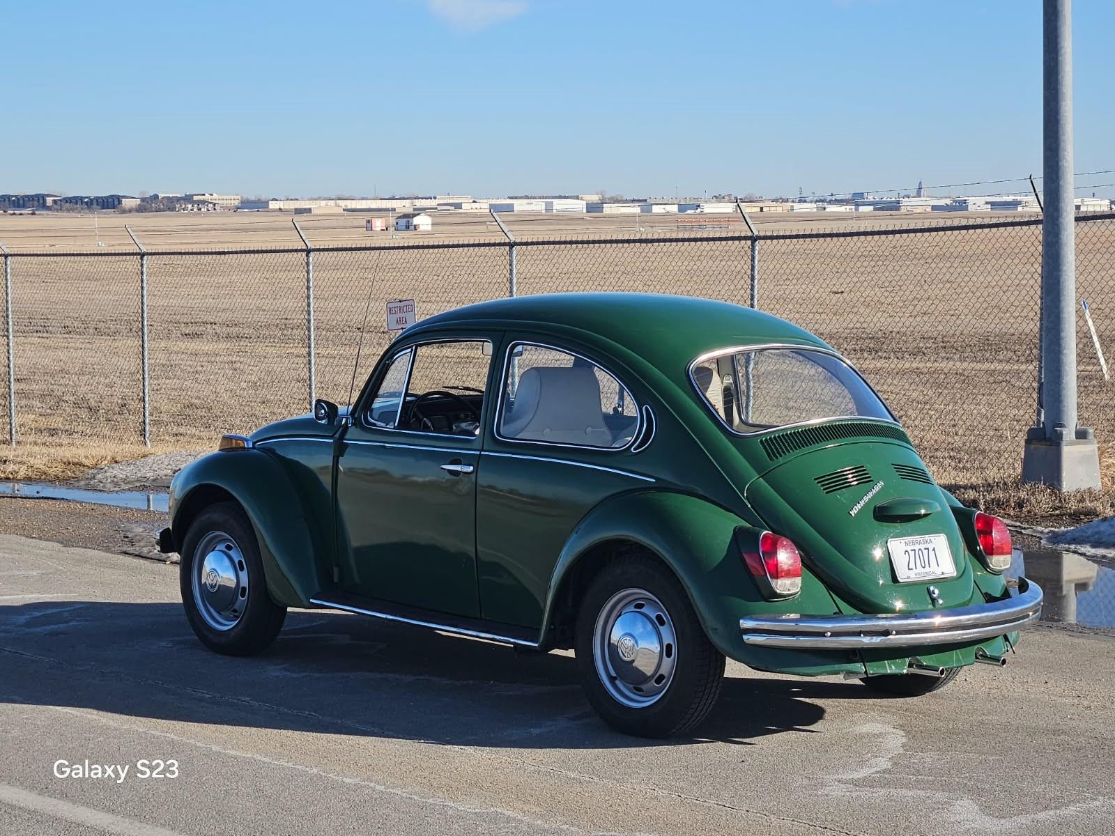

A Sunday drive, stopping at the airport to watch the airplanes land.
Well, 'tis been a while since I posted on my progress page.
You are never REALLY done with these things are you?
I've had so much fun driving and getting the looks and comments and "What year is that?" and the Cool car!" comments, it's just too fun.
A couple of things....
I am now contemplating the front disc brake modification.
I am pretty sure I will go with the Topline series.
Does anyone know if the original 1971 Supers had the disc brakes as an option? Not that I am tooo concerned over losing the "all original" moniker, but I am curious...
Another thing-I noticed a softening of the brakes, in spite of me adjusting them again. It looks like I have a leak in the right rear "distribution block" (dunno what else to call it)
I tried tightening up the right rear brake hose, but no joy. I even loosened and re-tightened, like I read somewhere. No difference. So it looks like I will try another brake hose. Gonna be a beee-otch to get that out and back in with the chassis on (of course), but I think I can manage.
I will save that for a weekend when I have more time.
