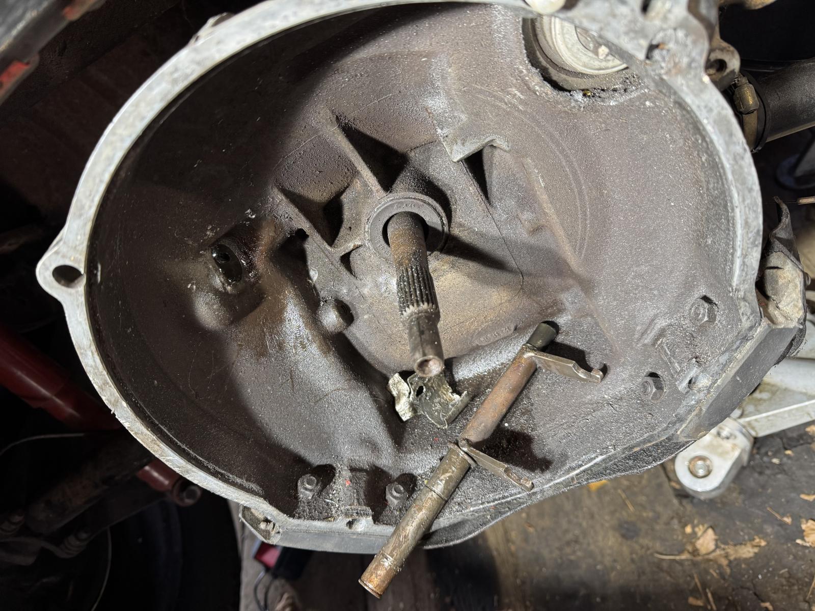

So, ‘tis the season for car folly!
Got the clutch arm off. The bearing holding the fork gave up its inner seal.
I’ve been trying to get it to come out so that, hopefully, there is clearance to get the fork out. I can move in back and for with hammer blows but that only seems to collapse the bearing— it is very flimsy material. Looks like I am going to have to cut it off somehow.
Why do I think that this is not the proscribed method?

PostPosted: Tue Dec 24, 2024 2:44 pm    Post subject: Re: '59 Karmann Ghia fever Reply with quote
From my seat it looks like the only way to get the actuator arm out is extricate that bushing to the interior side of the bellhousing which looks really fiddley.
I'd attack the left arm by snapping it off at the shaft the split and pull the bushing.
Happy Holidays Cool

PostPosted: Wed Dec 25, 2024 7:22 am    Post subject: Re: '59 Karmann Ghia fever Reply with quote
Happy Holidays Cool
Thanks KK!
The actuator arm slides to the right easily, so I think I will not have to ‘snap’ any thing off. Will gnaw at the bushing and see what pulling, pushing, and swearing accomplish.

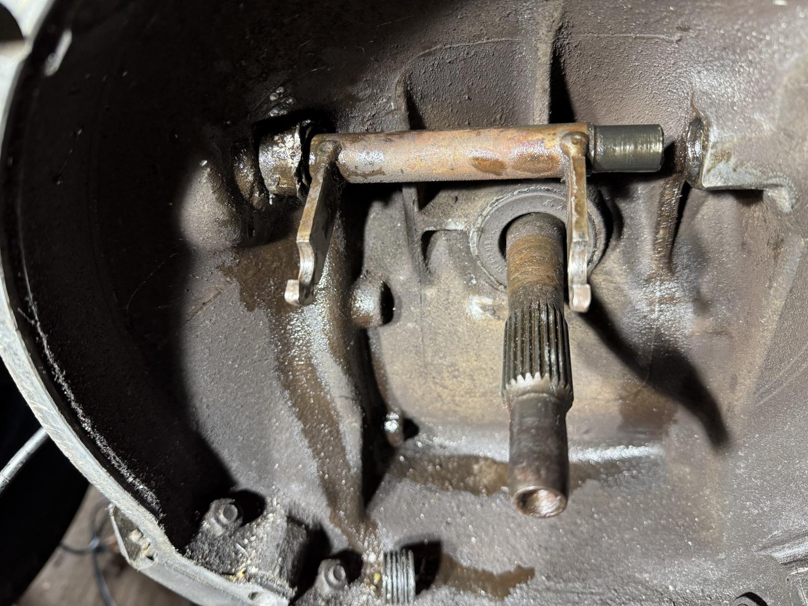

PostPosted: Sat Dec 28, 2024 3:12 pm    Post subject: Re: '59 Karmann Ghia fever Reply with quote
We’d be on our way … if that inner bearing wasn’t so rough:
Gonna find something to pull that out as it is in there for the duration.

PostPosted: Sun Dec 29, 2024 3:33 pm    Post subject: Re: '59 Karmann Ghia fever Reply with quote
Sacrifice a socket and bang it out with a hammer?

PostPosted: Sun Dec 29, 2024 4:31 pm    Post subject: Re: '59 Karmann Ghia fever Reply with quote
Wish I could! It has to get pulled out.

PostPosted: Sun Dec 29, 2024 6:24 pm    Post subject: Re: '59 Karmann Ghia fever Reply with quote
Ah, didn’t realize that’s the starter-side one. Put a nut on the end of a bolt, insert at an angle so the nut grabs the bushing, and pry? Hopefully someone has a trick to share.

PostPosted: Sun Dec 29, 2024 8:51 pm    Post subject: Re: '59 Karmann Ghia fever Reply with quote
Geeze! Yall gots no imagination.
Three options.
Find a pilot bearing removal tool
https://www.harborfreight.com/slide-hammer-and-pul...XsQAvD_BwE
Or this one that uses your grease gun to extract the bushing.
https://www.amazon.com/Lisle-55600-Clutch-Bushing-...&psc=1
This above would probably be the most effective.
Or, find a tap to thread the bushing & use an appropriate size bolt to force it out.
Or, a hammer & chisel to break the bushing apart.
The oil lite bushings are quite brittle & break apart fairly easily.

Another potential option is to "hydraulic" the bushing from the hole.
1) Slide the shaft out of the damaged bushing.
2) Fill the hole about half full of wheel bearing grease.
3) Slide the shaft back into the hole.
4) Use a hammer and something soft to drive the shaft into the grease filled hole. Do not damage the end of your new shaft.
The hydraulic pressure generated by the grease and hammer should force the bushing from the hole assuming the fit between the shaft and bushing is tight enough.
This was a common practice used for removing drill bushings from blind holes back in my tool making days.
Worth a shot. Good Luck.
