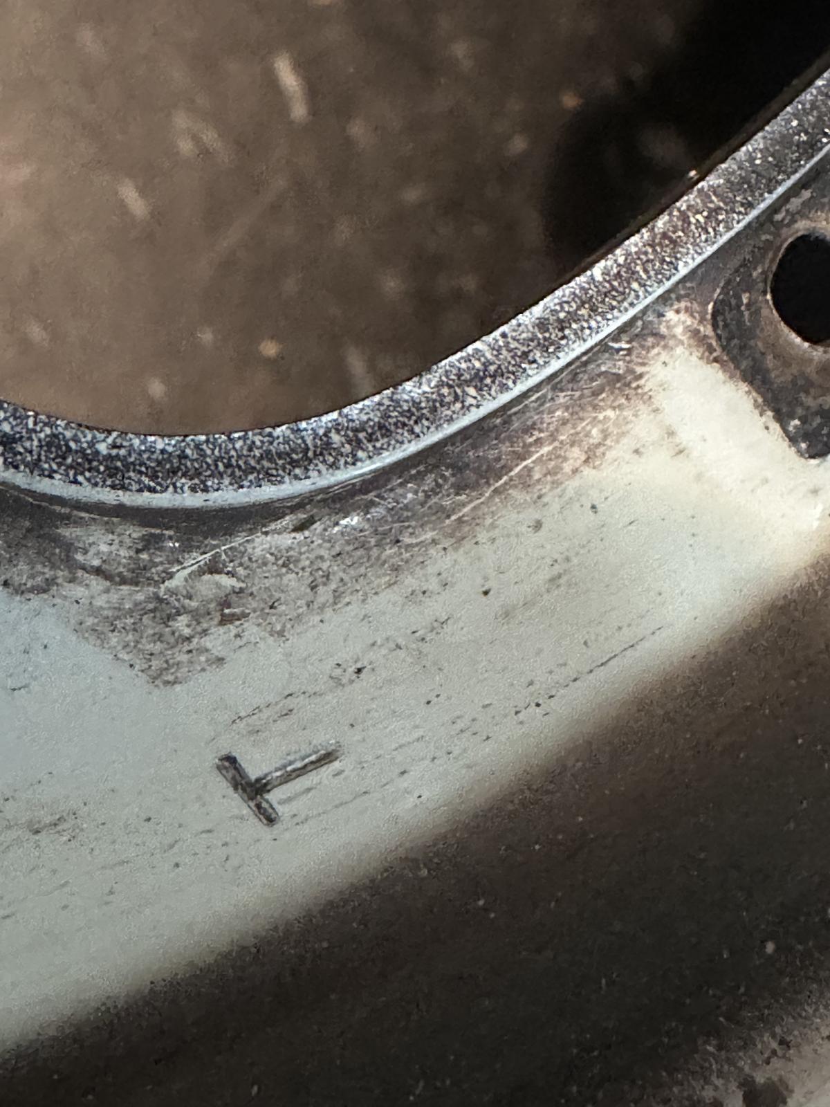

Fried a piston! Rolling Eyes

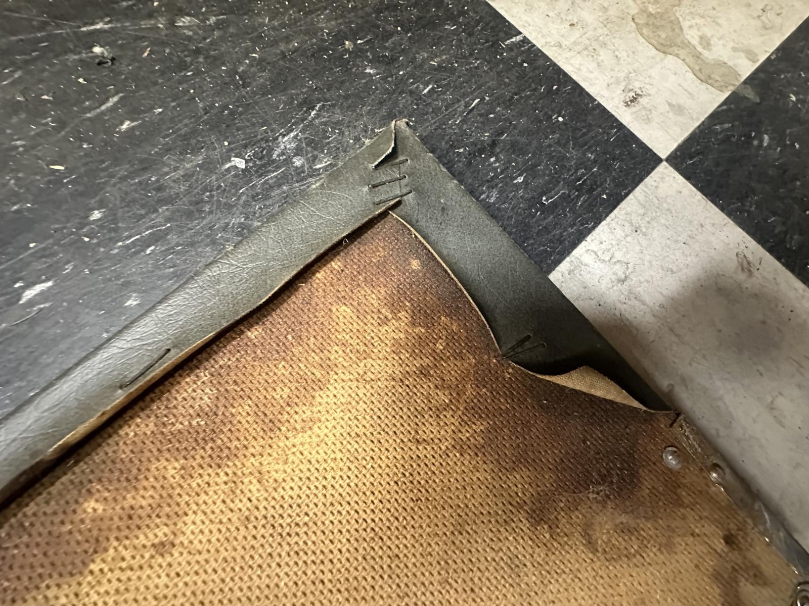

PostPosted: Mon Oct 07, 2024 1:46 am    Post subject: Re: What did you do for your Bus today? Reply with quote

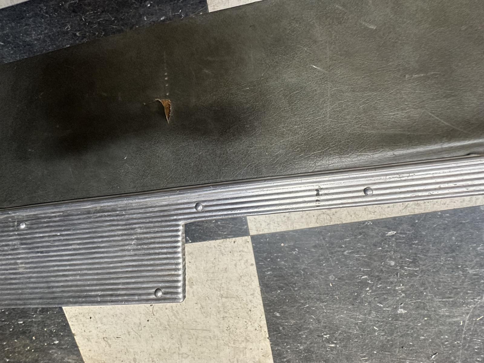

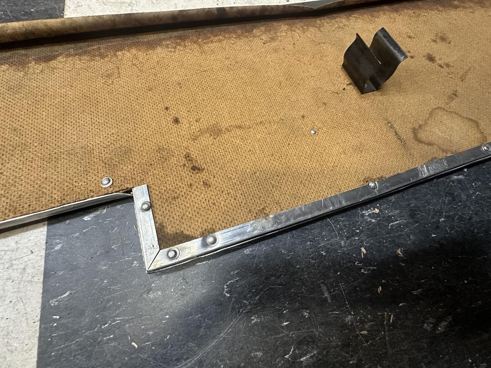

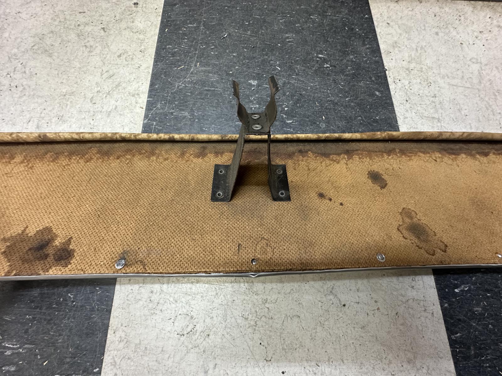

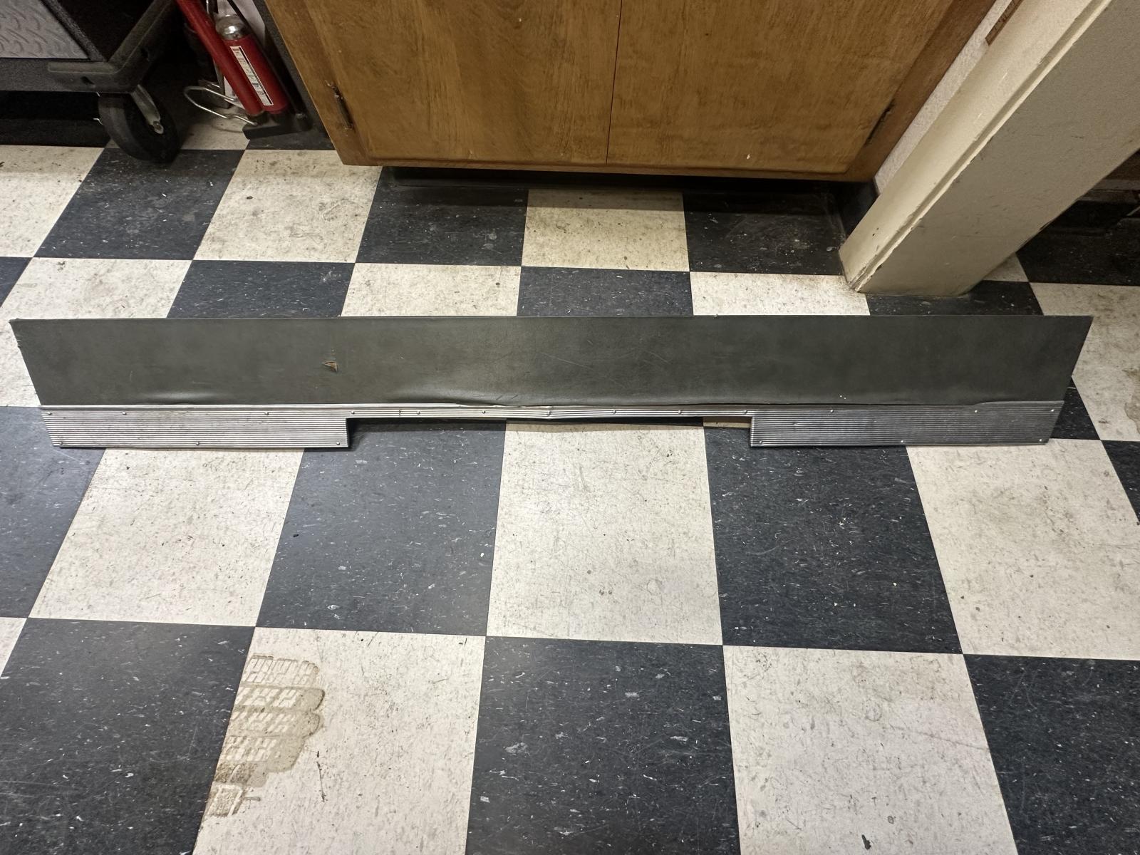

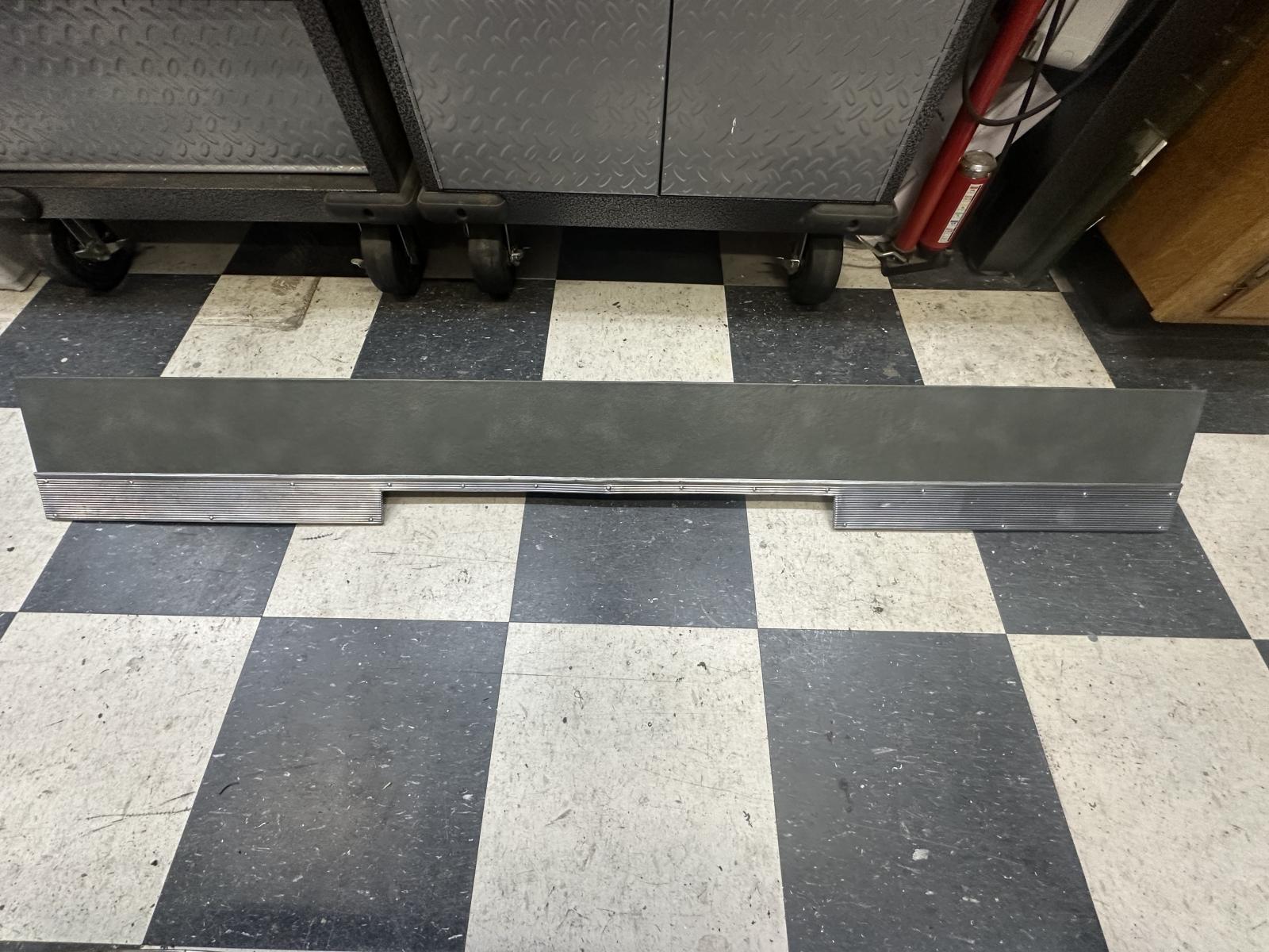

Replaced the vinyl on rear kick panel (TMI) and cleaned up the aluminum. Retained OG board, clips and aluminum.

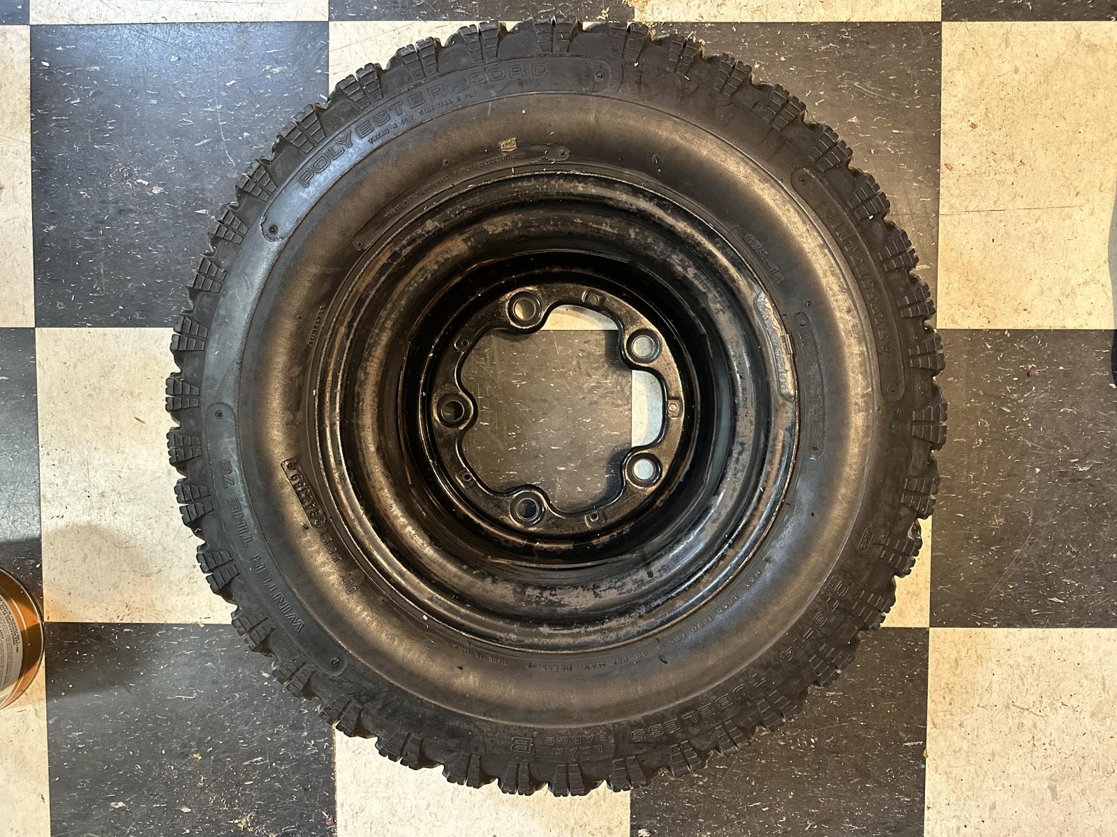

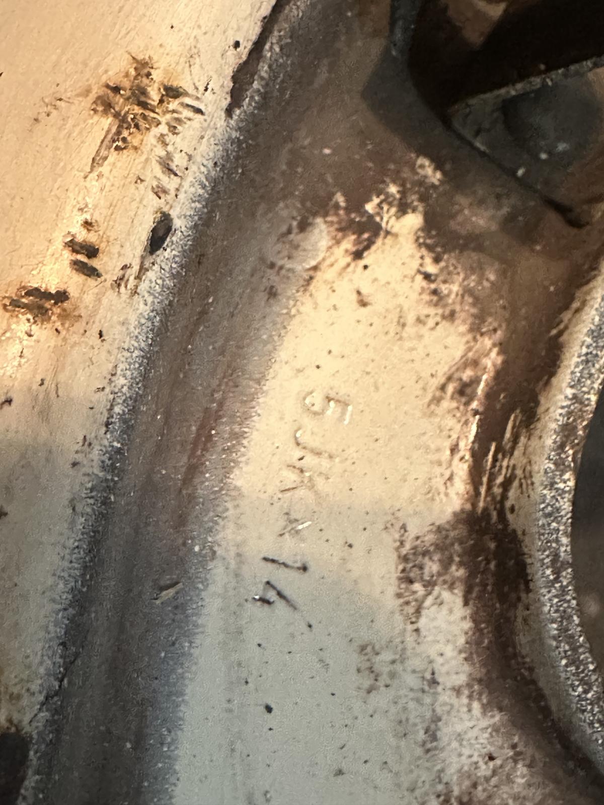

Found out that spare tire rim escaped the chroming-mania of the PO! Cleaned the wheel up (with studded tire!). Will replace tire and leave wheel as-is. Need to replace some hubcap clips. Amazing how sloppy the original painting was....

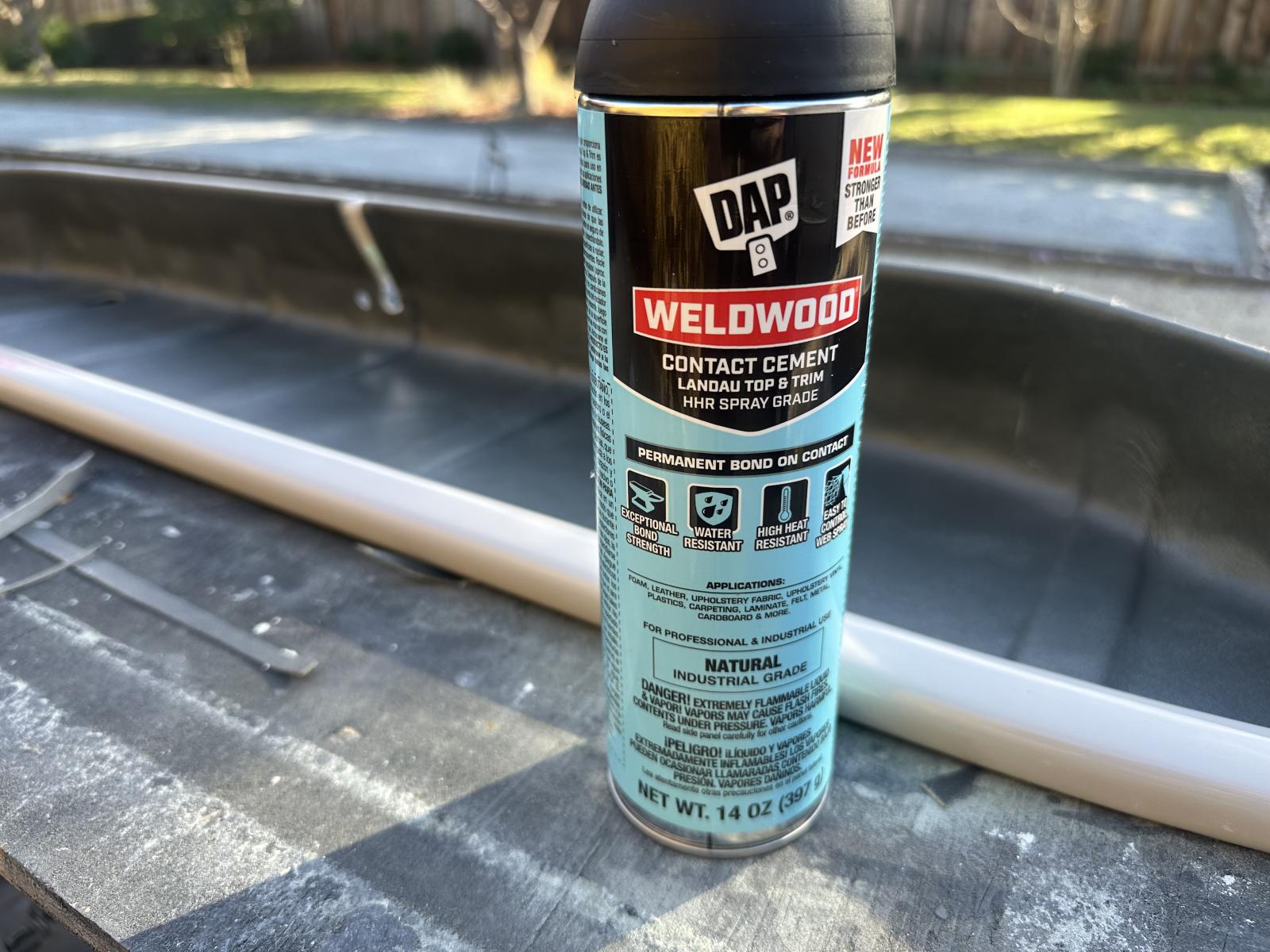

PostPosted: Mon Dec 02, 2024 11:35 pm    Post subject: Re: What did you do for your Bus today? Reply with quote

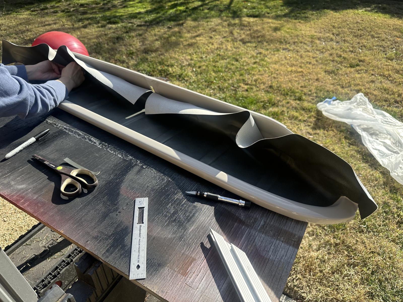

Parcel tray day. Thank god for my daughter's help.
Adding TMI mesh grey vinyl.... Made a rough paper template and then decided to glue it down in 2 steps: started with the front lip and half way up the back, and then figured out where to cut relief cutouts and glued the rest of the back. Added 2 seams in the vertical corners. Ended up with some minor wrinkles , but overall happy with the result and actually better than some OG versions I've see that were pretty rough!

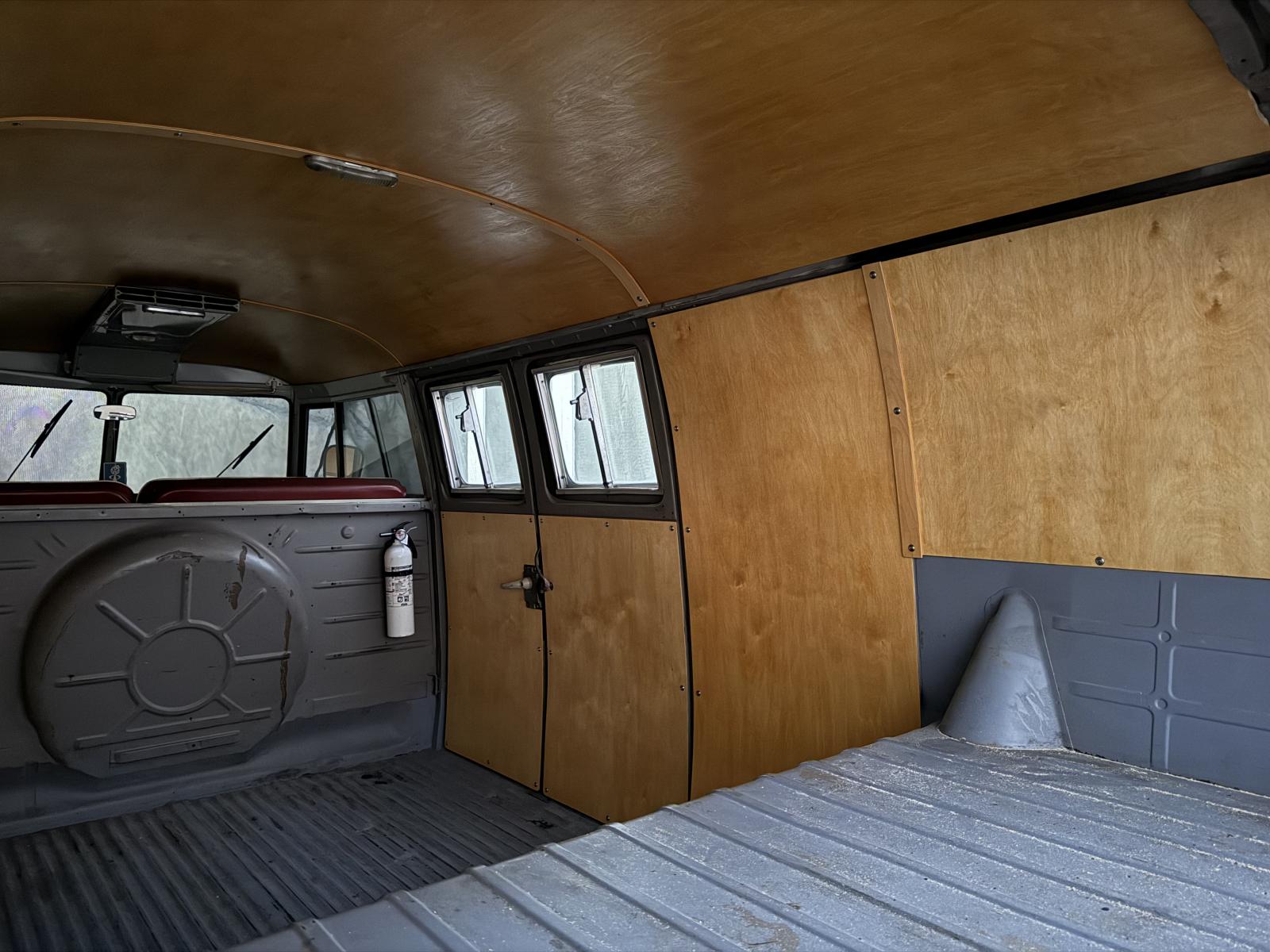

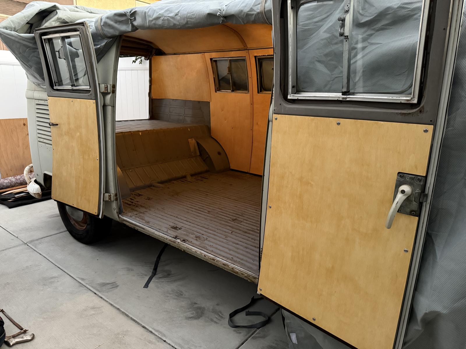

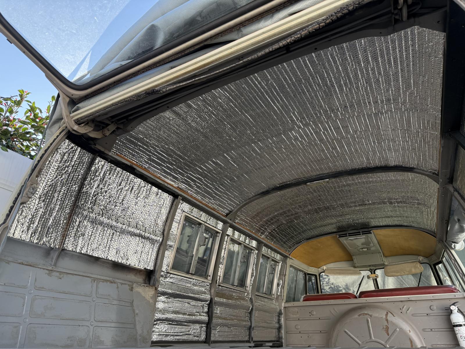

Installed all the new ceiling and rear interior wood panelling after finishing the sound deadening and thermal insulation over Thanksgiving weekend.
I finished all the birch panels with 3 coats of amber shellac.
Next up is the crown strip between the walls and ceiling, then getting started on the bench seats and table!

Looks great... I see the thermal insulation bubble wrap.... did you add any acoustic dampening as well?

Beautiful job. I love the finish color.

Yes, not pictured is the tar mat covering roughly 30% of the walls, doors and roof before the bubble wrap went in. It’s impressive how much it changed the sound of the doors (tapping on the skin and opening/closing)! Well worth the time, effort, and weight!
