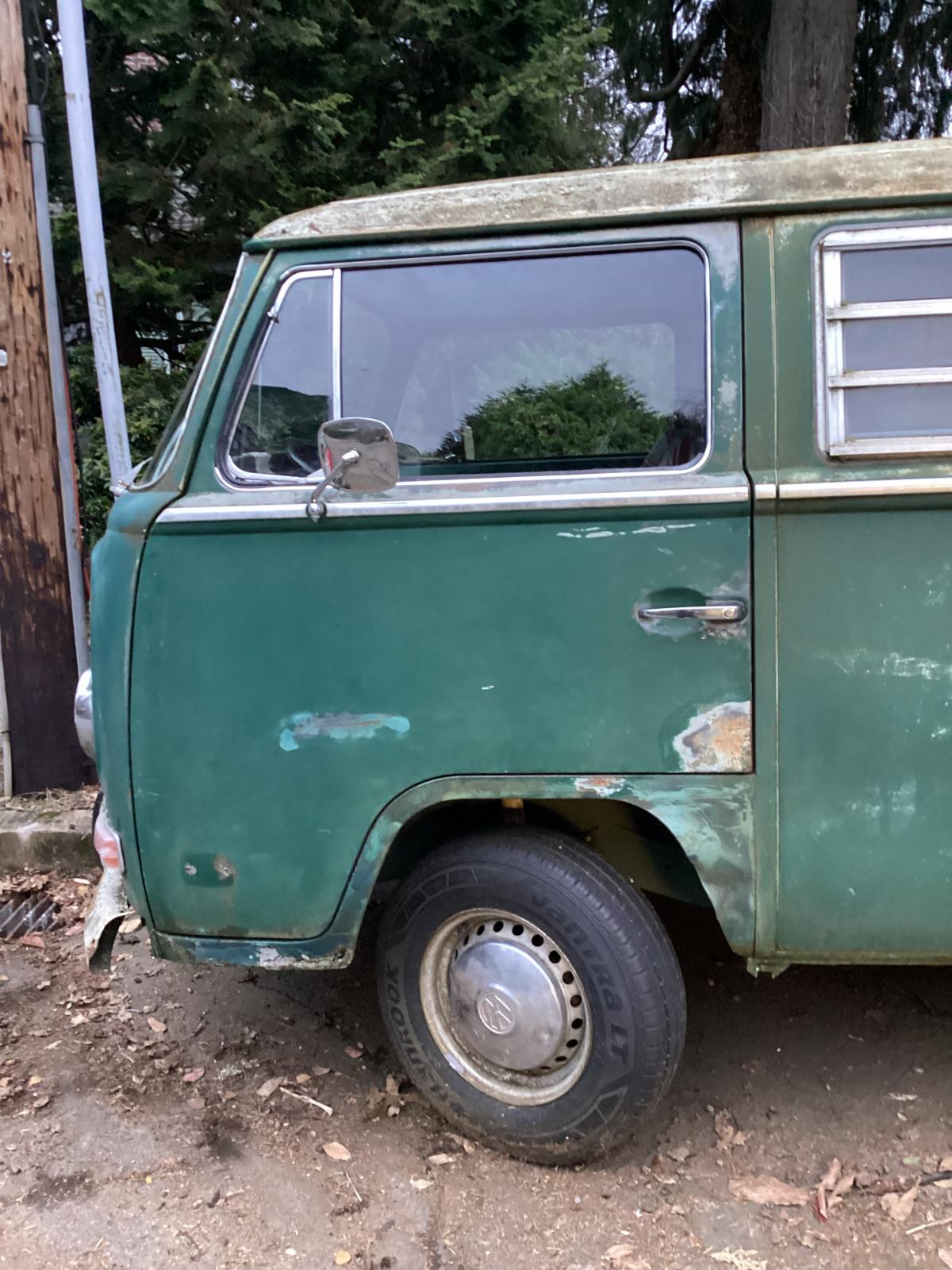

This bus was my first car, and served long and faithfully; most of its trials and triumphs were documented on the various bus lists waaay back (vanagon@lenti, type2.com, etc) so that, and CDR backups that fail to load all those photos anymore, means much history is gone.
So Karl is looking a little rough these days...
but I do work on him from time to time, and will keep future efforts here on his own page.
Some from 30 years ago...

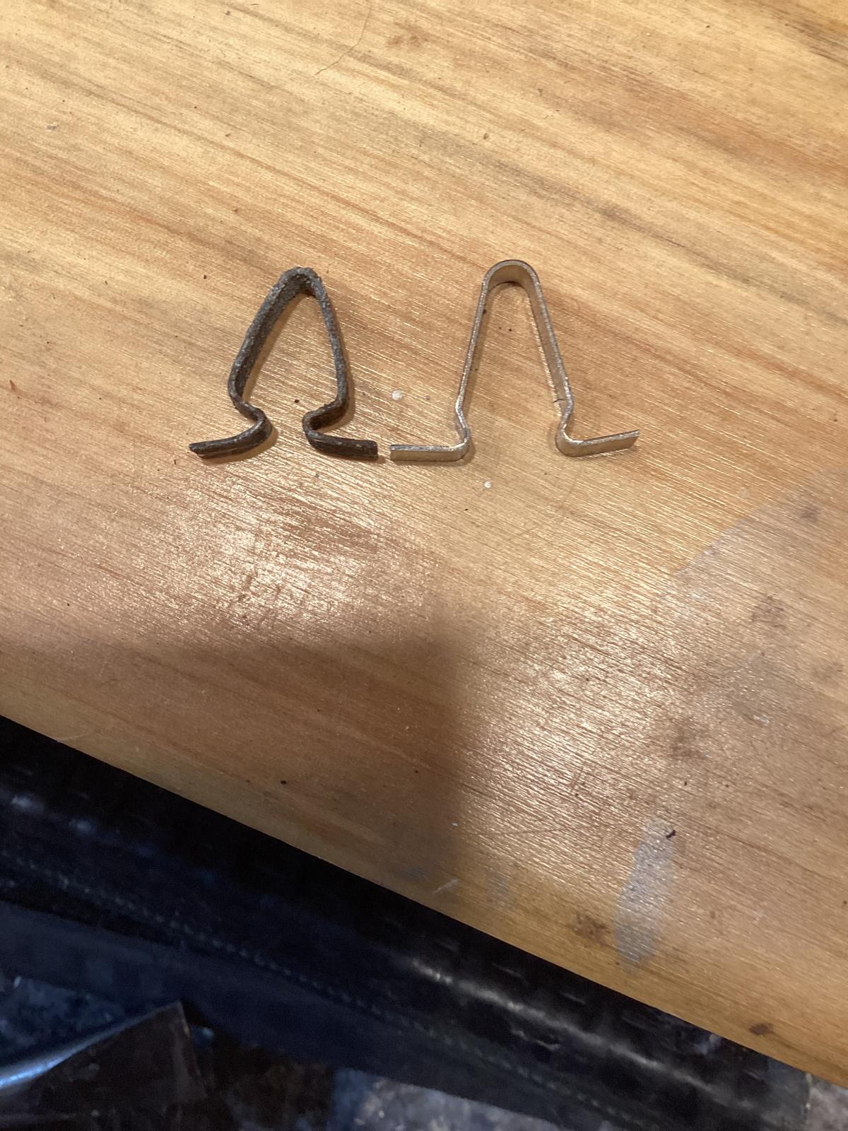

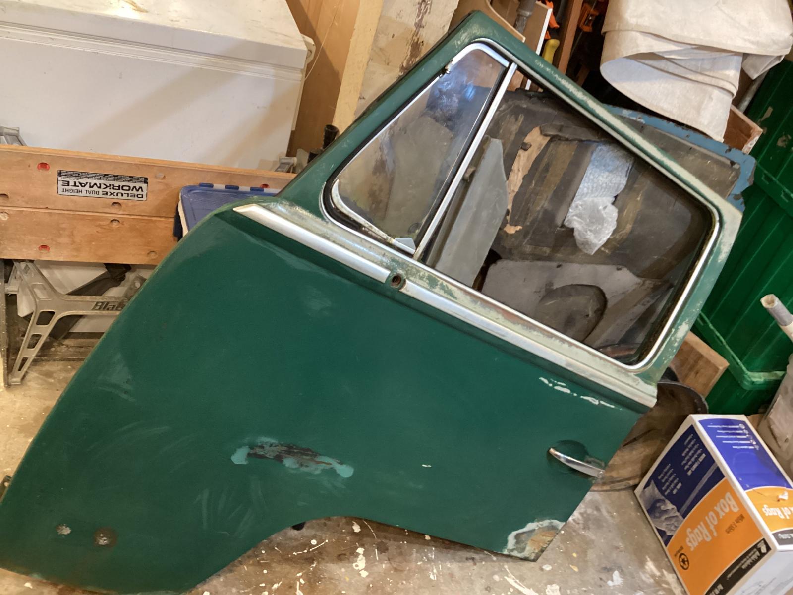

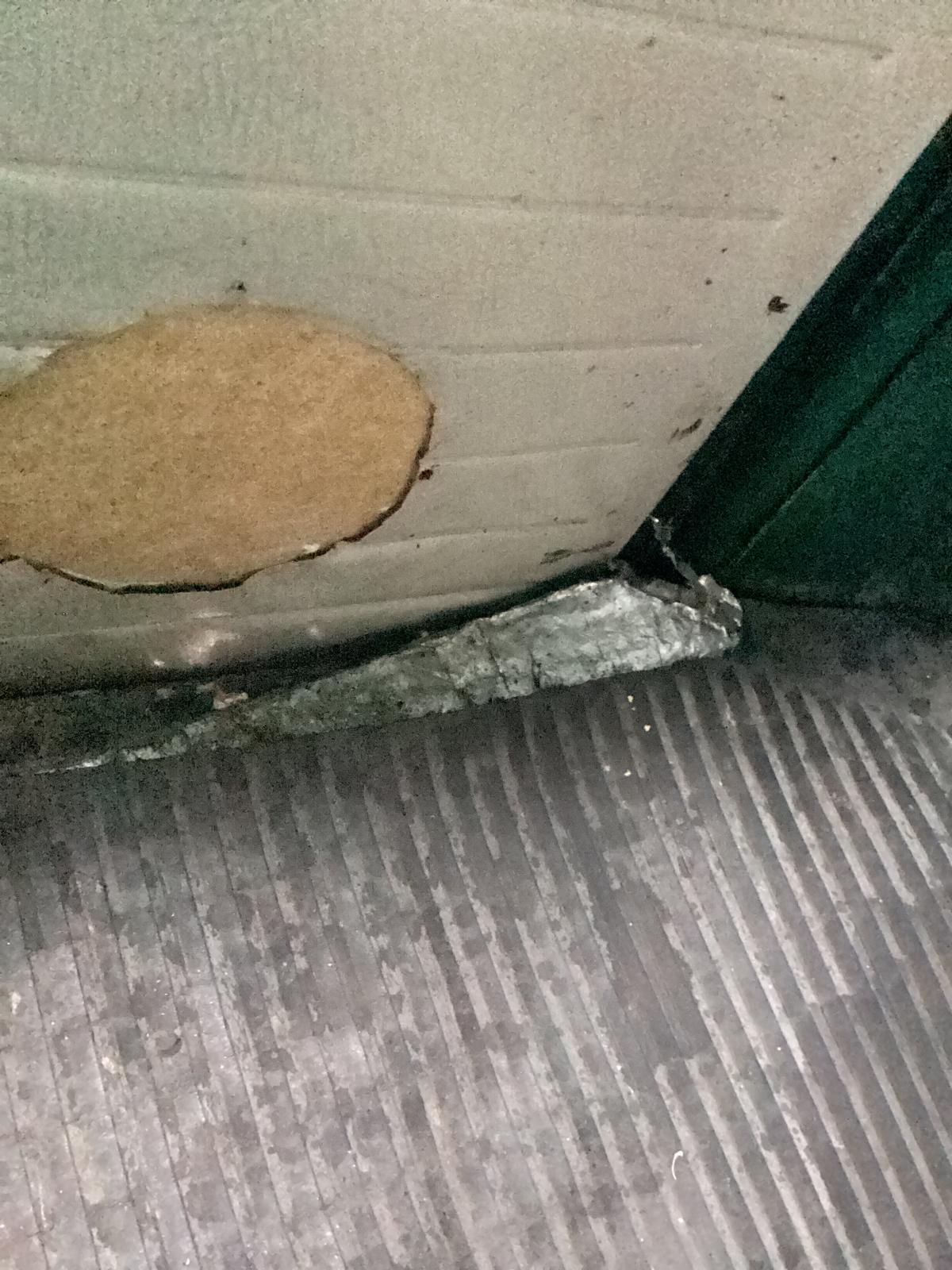

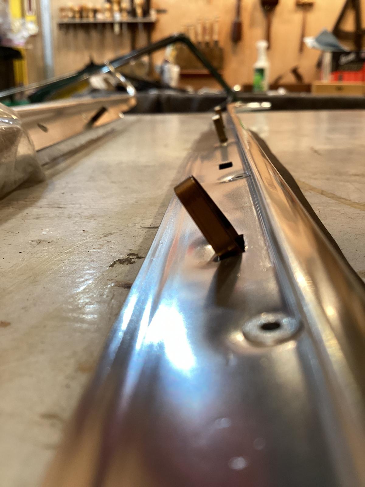

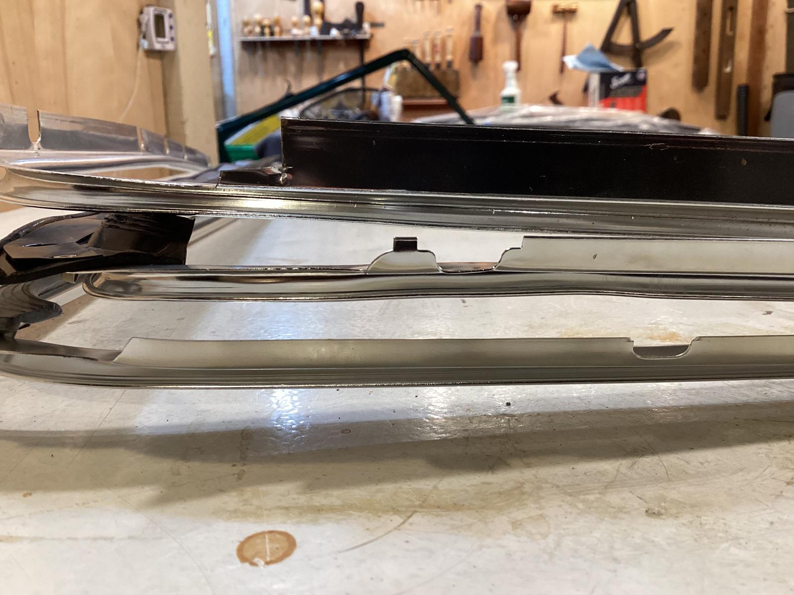

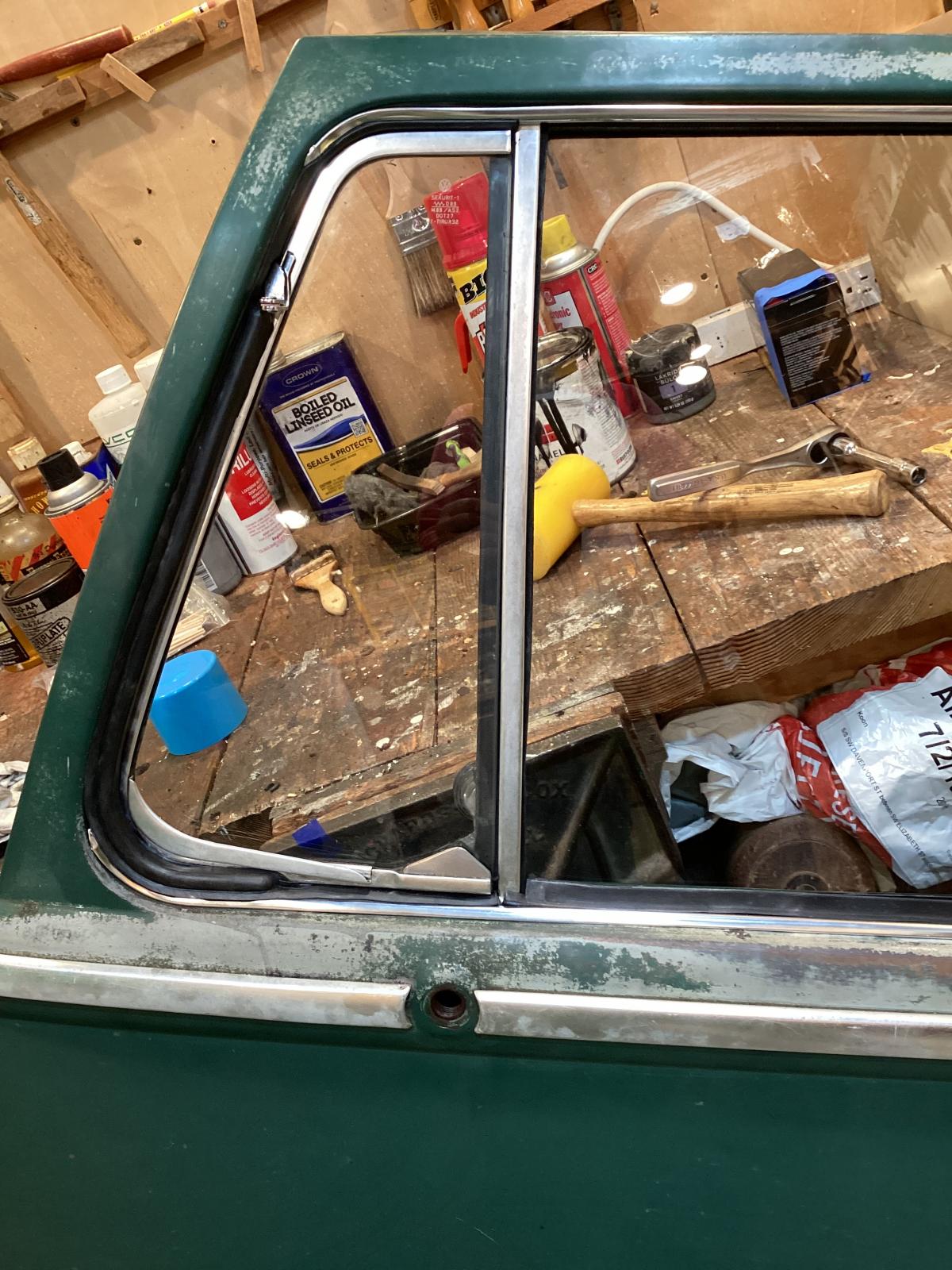

Wrestled for last 3 days with crappy 'German' outer scraper; today I got another one that is still "German" and still kinda crappy... but t least the clips went in this time without bending.
Door after the algae was mostly cleaned off. Outer scraper did NOT want to come out, sadly... I had felts to drill out old and rivet in new, but the chrome was pretty adhered to door.
New scraper - "German" - was a laugh; the lower tab is barely long enough to reach lip of door, let alone wrap around it
Clips were off by a good 1/8 to 1/4"
When you tried to force them in, they simply bent downwards
Not same shape/size either
Went to Always V-Dub and grabbed a few that they said were German; the middle one was actually stamped 'Made in Germany.' Too bad it was in the wrong spot on shelves and was for a Bug. Also, passenger side :P Note my original one (top) lacks the holes for the felt clips - you have to drill/cut those yourself on many of these. As far as that goes, at least the new one from Always was much more difficult to cut than the one I had been wrestling with, so a good sign.
You can see that the better ones have less slop in the slot holding the clips; they still flop a bit, but resist bending down.

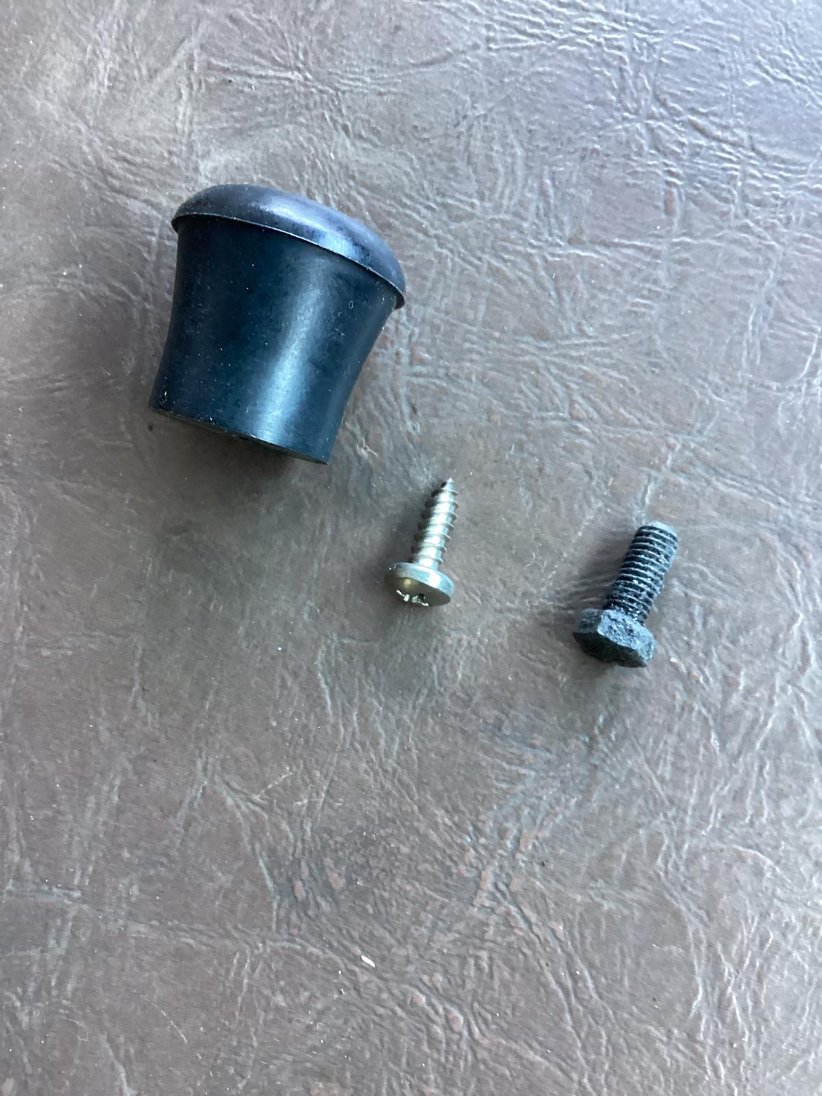

The Bug one had a hole in the lower tab - do they have a screw? Better, or worse way to do it? In any case, the tab length on the new ones is a laugh.
Aside from having to cut holes in the proper places, the vent rubber was a breeze. Now if I could only find the 3 rivets I have somewhere to finish...
The part I bought initially and those from Always all had Pacific Imports stickers on them, and all were said to be German and not Brazil; Always did not have ones from Wolfsburg West or others to see who imported them or compare quality. I did note that the better outer scrapers had greyer rubber, with talcum on them, and the crappier were dark black rubber. So when buying, choose the ones with tighter clip holes and grey rubber if you are in person and not mail-order.
Also cleaned, lubed and reinstalled the door workings; latch did not always open with inner lever, as the metal sliding part's slot had been hammered just a little long over the years - common problem. I don't have a welder to fix as others have done, but peening the little bit of metal mushroomed out by years of operation, and adjusting the handle a tad, heped a great deal.
I have some fancy plastic construction housewrap I might use for the card protector; waterproof, but lets vapor pass to dry door interior. I live in the PNW, so water vapor goes everywhere anyways... only so much one can do to keep a car dry!
Once I no longer have rain rolling through this door and across cab floor, I can track down leaks from the windshield, and then get to straightening out the wiring an inept thief poked at some time back. Car is mostly functional, but there are a few dangling wires left to sort out for lights.

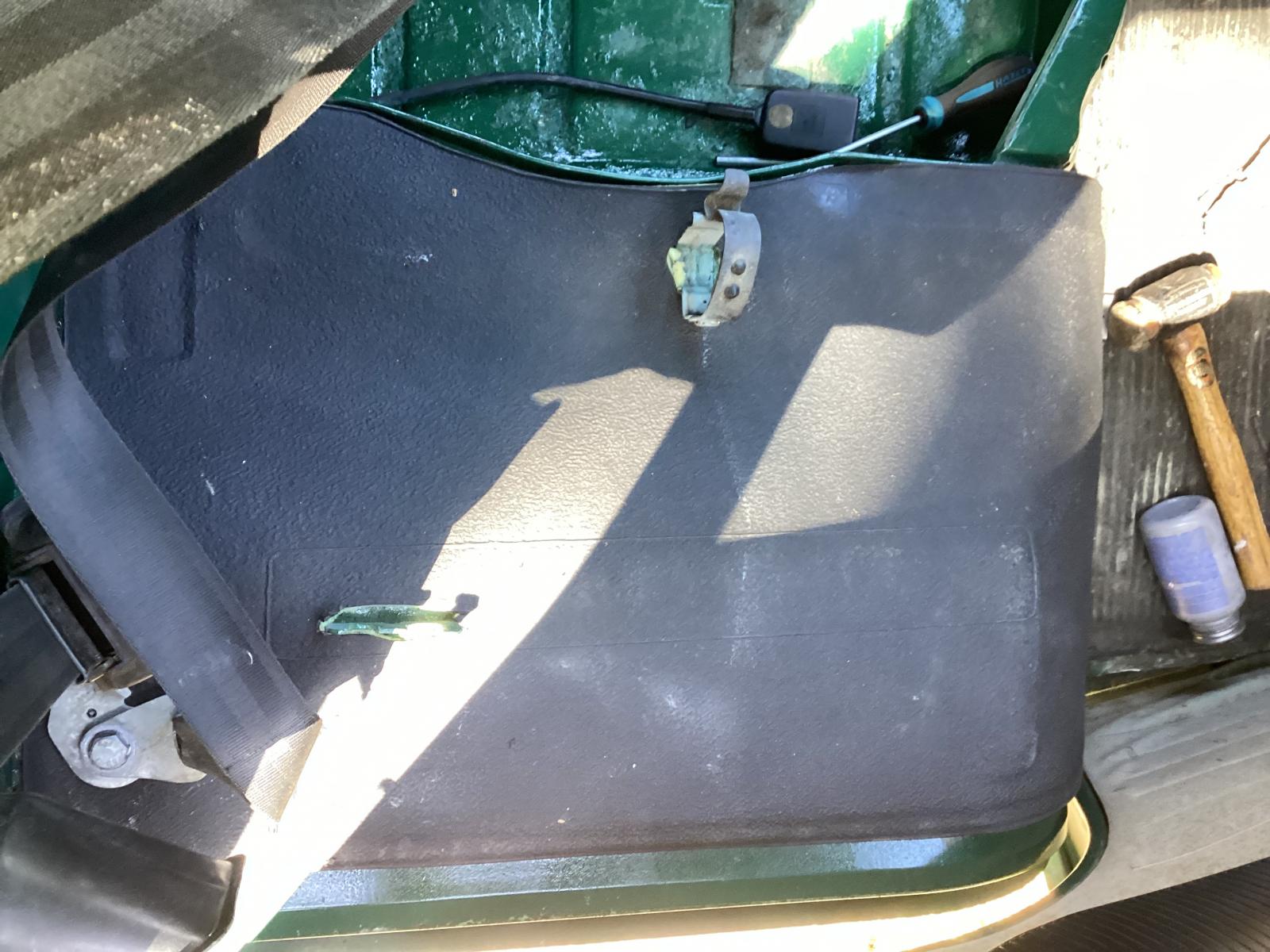

Alright, progress. Sorta.

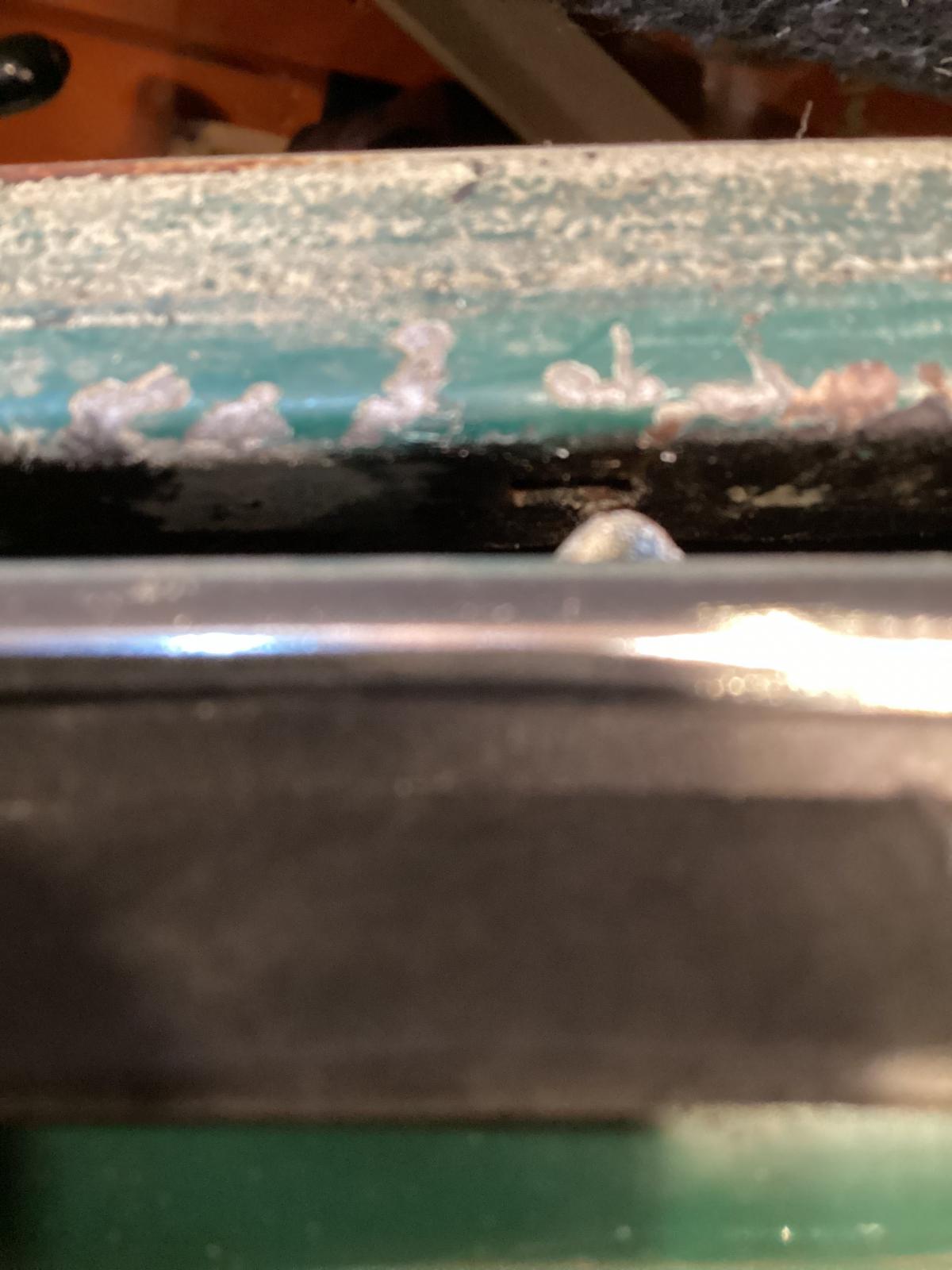

Got a rivet in but did the worst job I’ve done so far. I just couldn’t get it to squeeze right, even with a ball bearing to flare it.
Had some issues with the window racking when wound up and not meeting felt in ventwing upright properly.
https://www.thesamba.com/vw/forum/viewtopic.php?t=799251
But some tweaking got it… decent. I’ll put the plastic on but not door cards and see if I’m satisfied with sealing first. If not, I have a replacement regulator to swap. It would have to be a big improvement to be worth the (minor) effort, and aftermarket parts do not inspire me to take that leap of faith very often.
The scrapers didn’t fit well at ends, had machine marks, and the tabs - especially on the lower end - did not have enough depth to fold over a seam and properly seat them.
I’m going to adhere tha seal gap closed before I install door… gorilla snot and some pressure til set.
I have to say, I was not pleased with changing window seals; between not being practiced in procedure and crummy aftermarket parts, even ‘German,’ ( not to mention worn OG car) the experience was not pleasant. I have all the bits to do the passenger side but I may put that off while I decide if the horror was worth it. Might just make sure plastic fully drains door interior and let water pass on through…
