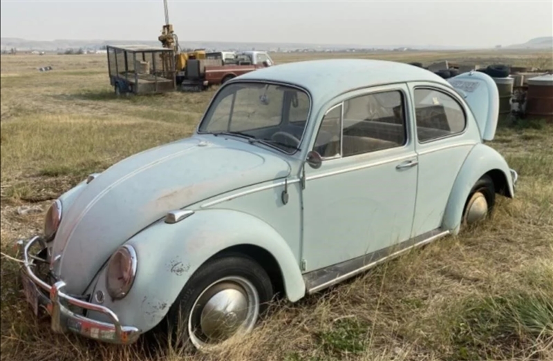

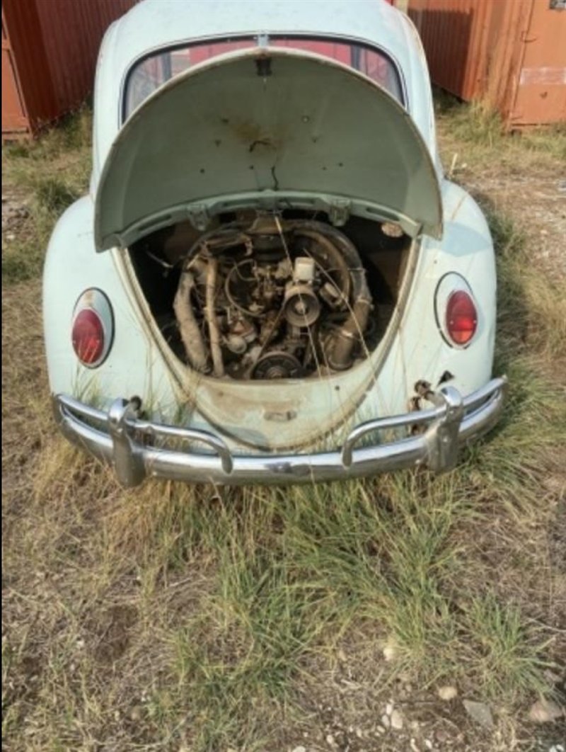

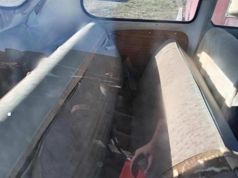

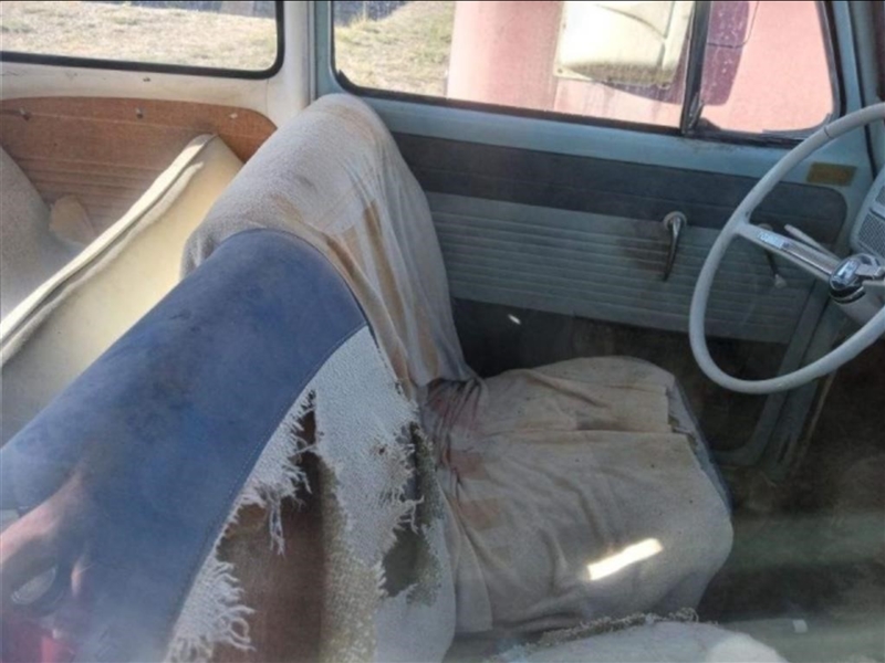

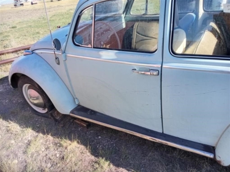

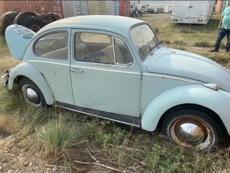

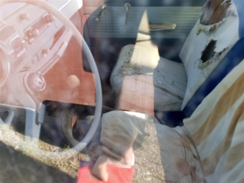

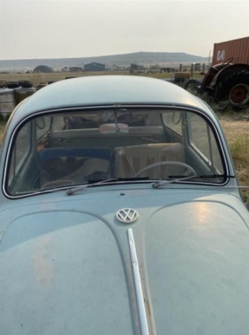

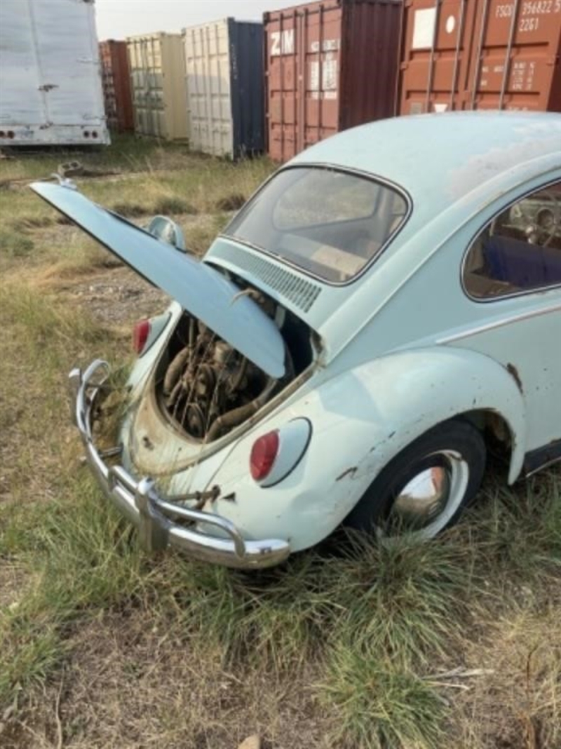

Awesome, I love the options there...thanks all for the suggestions Smile I really just want my buddy to be prepared when he picks it up - he is also a VW guy so I can relay this info and he'll get it.
I have some pictures, skillfully taken with a potato cam. I happen to be 1500+ miles away so they'll have to do for now. I'll fly back home next week and get some more pictures and see what the overall condition is.
I *think* it's a 1965 based on the horn buttons, license plate light, press button on the rear hatch, and the solid wheels. But, again this is my 1st Beetle, so I'll let you guys school me!
Here 'ya go, not all of them but I can post more if you need more to ID:

Oh that's purdy. Pretty good chance the window rubber is hard as a rock and rotted so cutting the rear quarter window rubber is a good option.

Agreed, all indications are 1965. Looks dry and solid.

Nice! Thanks for the confirmations. My hunch was correct, I guess I've been around aircooled stuff long enough now I may be getting decent at this stuff.
My buddy also has a set of pop outs for it, so I'll not too concerned about the crusty rubber, 'cause it's getting cut out eventually.

Mike, congratulations. Looks very original, examples that jump out for me are the possible German bumpers (no grommets between the overriders and the blade) and even the metal vacuum line for the distributor is still present. How long has it been sitting?

Good call outs - from what I can tell, the last date on the registration sticker on the license plate looks like 1993. I can assume it's been off the road since then, and don't know why.
Oh for sure...the plan is to shine the heck out of that OG paint!! Should have just the right amount of patina too.

Am I missing something?
Looks like the vent wing is unlocked. Just push it open.

Dunno, it looks locked to me - I thought the lever that looks like it's sticking up to me needed to be pushed forward to unlock and swing the window open like in my Bus. But again...I've not owned a Bug and I'm 1500 miles away right now.
Maybe it's that easy.

It's still locked...partially moved up, but locked.

So the trick is to have a two-step process for flipping that lever.
One wire bend/motion has to be to get past the seal by pressing the front of the glass inward, creating as much looseness at the rear as possible, so you don't tear the rubber.
Next you need to press the back of the glass inward (near the bottom), so the tension is taken off the lock arm, allowing you to flip it forward with the other bend in the wire.
These two operations are basically at cross purposes, but careful bending and rotating of the wire once past the seal. It will take a few tries to get the bends just right.
If your vent wing seal is already crispy you don't have to worry as much about ruining it. But if it's decent, some experimentation with the two necessary bends in the wire may pay off.
