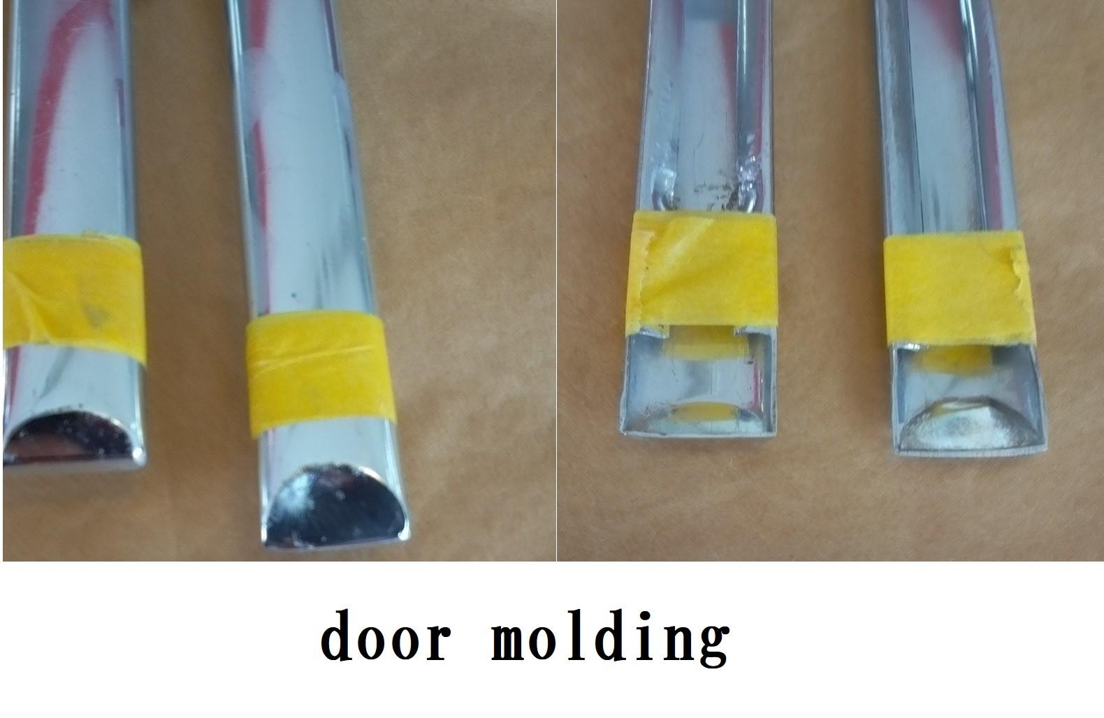

Hello.
My friend has "64.8 Notch".
He began the painting. (in a custom shop)
The body molding and Rocker molding are excluded.
The rocker molding is stamped with "9(or 6?)" and "VW". Right and left rocker molding.
There is a stamp of "S" only in the body molding of the rear right fender.
Five Molding does not have the stamping.
(Front fenderX2, doorX2, rear left fender)
Is stampless molding a reproduction?
Everybody. Does all body molding have a stamping?
Is there the stamping except S, VW, 9(or6)?

I've never noticed a stamping in the trim (any of the pieces). However you do have the correct "wide" trim for a 64-65 type 3 (64 is the first year for it), and it's for the "S" model. Quite a few of us have gone to the stainless steel trim that ISP sells (they also sell new aluminum trim as well as thin stainless steel trim), as it's newer and isn't bent. Plus you can clean it up whenever you're doing the rest of the car. In a lot of cases, the original trim is too easy to bend and scratch up (or already is), not to mention the anodizing is fading on it (most that I've seen, and it doesn't matter if it's the early wide trim, or the late thin trim). Maybe what you have is a Japan import deal going on where they keep track of it. Think IDK, as I haven't seen an unmolested Japan import type 3 before in the wild. I hope this helps.
P.S. This might be a good question for the 1500 Club, as they know ALL about such odd things for the early cars.
Bob 65 Notch S with Sunroof

Very cool indeed! Yes I've seen the markings on some - not all original molding pieces. Especially the VW stamp. A good example is around 66 I believe you find bumper blades with a VW and a 66 stamped in them. I think its a VW change thing, maybe a one or two year thing, maybe even a supplier difference.
But for sure - all original ones didn't have them, just some like you have. Like Bob said, people get the new stainless stuff as its way more durable than the soft aluminum that may be dented and faded after 60 years. If your set is nice enough to use then go for it! Cool to have the logo and stamps on it.

What a lot of people with original parts do now a days as well, is buy the reproduction and install them, then keep the OG parts stored away safe. That way you keep the original stuff but your car looks nice with a new shinny part.

What Jason said. I normally put it inside some 2.5 inch PVC pipe with some foam stuffed into the ends and cap it. That keeps it from getting any more damaged than it already was.
That said, if you can restore it and reuse great. But getting it anodized again could be a problem unless you know someone good where you are, as that's how the factory did it. It's also why a lot have gone to the ISP trim.
I think they've been making them for about 25 years now (since about 2000). I know when I rebuilt 65 Notch back in the fall of 1999, I bought their stainless trim version (it had just came out) for my own car, as all of my trim was damaged (what there was of it). I hope this helps.

Do you have a picture of the pointy ends? The original trim has sharper points than the reproduction trim.
Original trim or the reproduction trim?

Those all look like originals to me. The reproductions are nice, but not as sharp as originals.
squaretobehip san.
Thank you for your judgment.
Compared to the Molding on the ISP website,
It's definitely a different sharpness.
Now I can live with peace of mind. Wink
