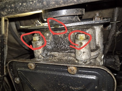

Every time I lift my 412 in the rear it slowly starts dripping from the front end of the manual gearbox.
The input shaft from the shifter is dry aswell as inside the big rubber boot.
So Im wondering which gasket or seal can be leaking?
Three oil drops circled
Nothing obvius can be seen through under the backseat inspection hole, the big plug is tightened well.

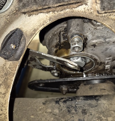

Good detective work so far!
But, on your 2nd picture of the plug, notice that there is some oil and grit in the lower recess area of the big screw plug at about 6 o'clock position. There is also an odd little bit to the left of the nut at 12 o'clock and underneath the bracket that supports the clutch slave hose.
Under that flat bracket .....is the vent hole for the transmission. If you had the car on a slight left hand incline when last filling up the transmission with oil, it can have a small amount too much and when outside temps are high and/or when also driving down hill roads quite a bit at speed,l....it can push small amounts of oil out of that vent hole.
If you can reach it, you can remove the nuts at 9 and 12 o'clock and get a better view of whether there is wet oil in the vent hole.
The only other thing I can think of that can and does happen ....is if the last time you had the transmission out for one reason or another, if it got in a bind while you were moving it or got bumped hard enough, the long tail cone with the shift rod that protruded through the rubber bumper can get cracked right where it joins the housing and will have a very slow seep or drip.

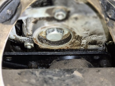

Just inside of that oil hole is the mainshaft ball bearing, due to a variety of driving angles and speeds, oil can get pumped up to that bearing quite a bit. I will see if I can find a picture of the hole.

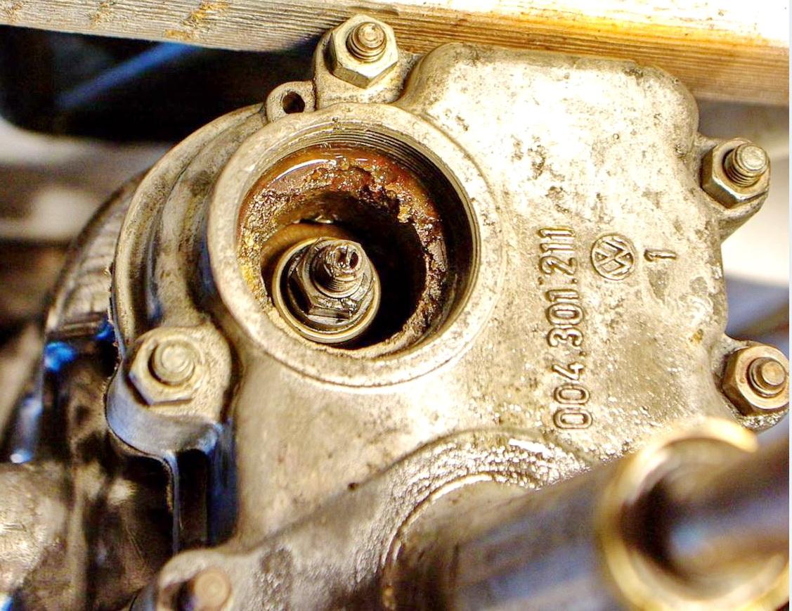

Here is a picture of the very common stress crack that can happen
Here is a picture of the vent hole next to the nut with the bracket removed

Got rid of the bracket in front of the vent hole and, yes, oil is seeping out there!

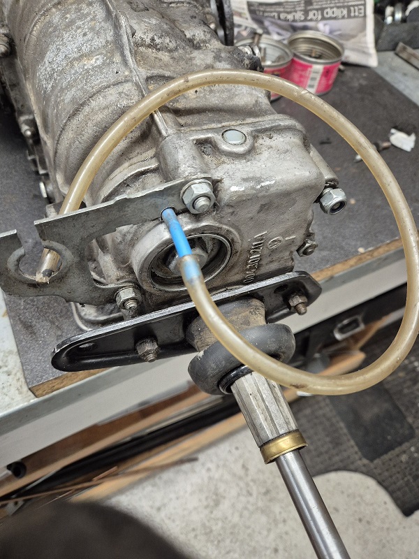

Since I often use my "poor mans lift" at the rear Im planning to insert a short 90degree tube or pipe pointing upwards a couple of inches (poosibly going through the sheet metal) so that the oil level never reaches the top of the tube.

Goodbye oil puddles! Twisted Evil
(I will route the transparent hose up a bit under the backrest).

Nice investigative work here! I love figuring out these problems. Your tubing solution looks interesting but I have to ask why is it leaking in the first place? Was it overfill or something else? The factory never intended it to leak so much.

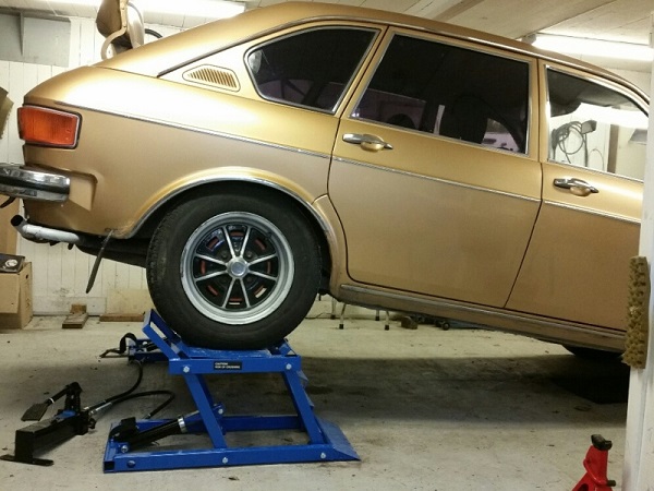

Bill it was the steep angle that my poor mans lift gives the car, the oil level at the nose cone rises well over the vent hole...at the factory they never planned for that...
It leaks quite slowly since air also has to get in...tried to blow in the tube - the gearbox is wery air tight.

Got it. You need to consider a full lift. I like my BendPak scissors lift. Very portable and lifts level. I hate crawling on the floor anymore.

Yes, a scissors lift would be nice...whats the lift height on the one you have Bill?

When fully up about 5 feet. I can sit upright on a regular chair under a car and I am 6’3” tall. I love it. By the way, that photo is 2 years old while restoring Goldie. She looks a whole lot better now as I am sure you know from reading my threads. Goldie is almost just as much fun as driving my ‘95 993! Certainly not as fast but the smile per mile factor is the same.

Bill, 5 feet, thats a lot!!! Unfortunaly my workshop suffers from a low celing (old stable) cant lift a car more than 3-4 feet...
