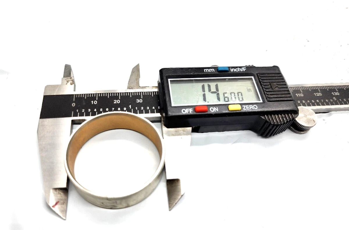

PostPosted: Tue Dec 24, 2024 2:13 pm    Post subject: Re: Torque converter speedi sleeve 010 automatic transmission TC? Reply with quote
You might consider changing your search terms for more results.
You're looking for a Vanagon 090 torque converter bushing, so search for "vanagon 090 torque converter bushing repair" and you may get better results.
https://www.ebay.com/itm/325429927838
I hope that helps. Looks like your thread above has good info.

That looks like a completely different thing. What am I missing seeing here? It's not even 41mm across

PostPosted: Tue Dec 24, 2024 2:21 pm    Post subject: Re: Torque converter speedi sleeve 090 automatic transmission TC? Reply with quote
You're right. I sent you down a path for the wrong bushing! My mistake. Though that is nearly 41mm. The caliper reads in inches! Who does that? Metric is our friend here.

SKF does that, that's who ;-p
....no worries though, your post had me correct the title 010 to 090 ...IDK anything about automatics Embarassed
