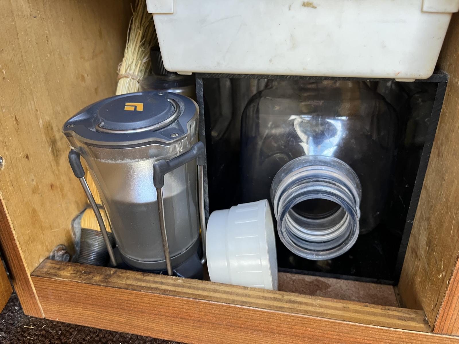

here’s my solution for inclement-weather and urban-camping situations.
i fabricated a plastic box for the 1/2-gallon lexan bottle to live in.

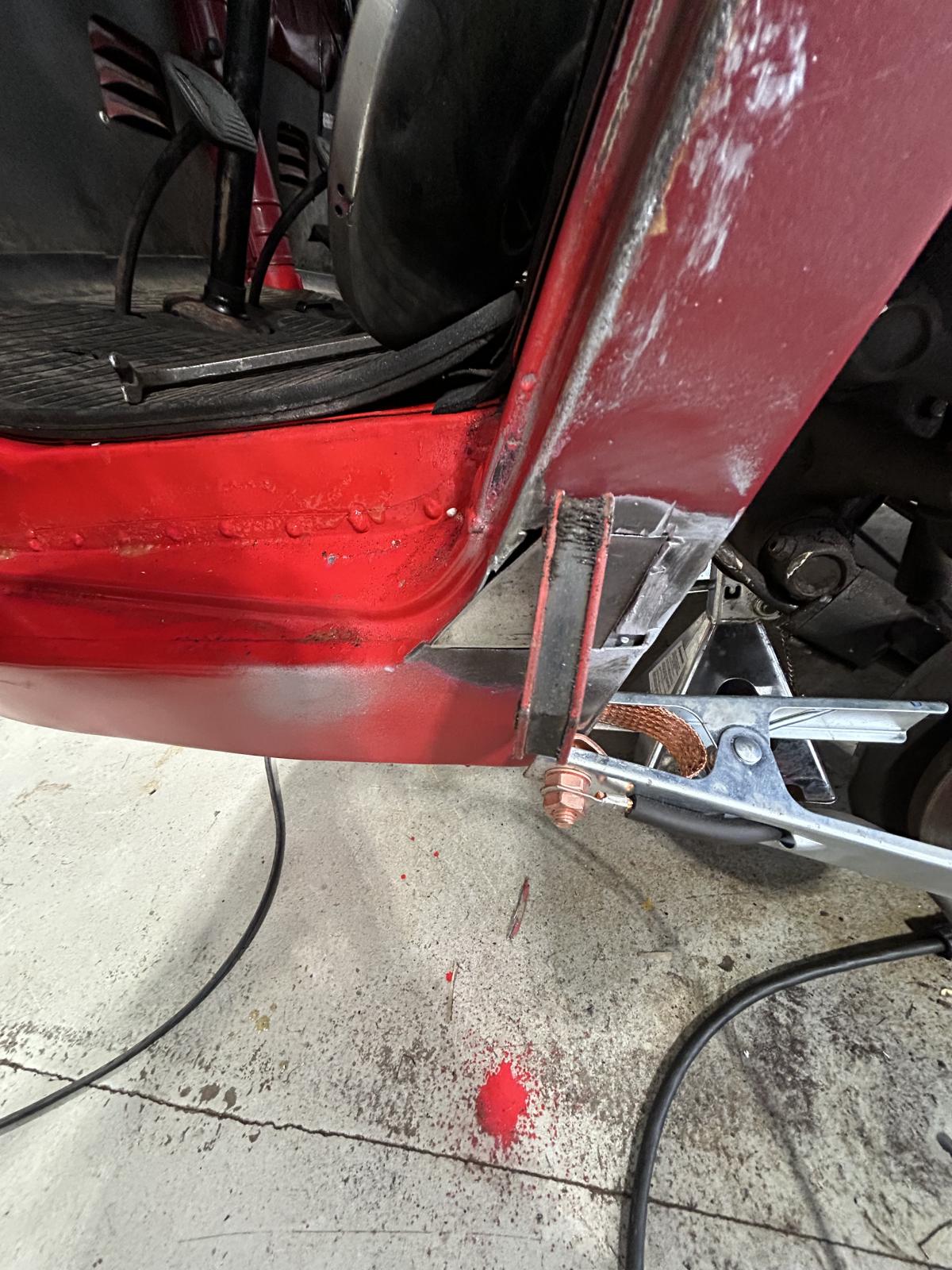

Time for a little update, the bus made it home from school on Friday, with only having to pull off at least 5 times to fix the gas pedal since it kept breaking Evil or Very Mad Embarassed One of the pins to the gate hinge that I was using wiggled out and went missing, then I had to shove a random bolt in it, then the other pin kept working itself out. The pedal rod also kept going sideways then I would lose the pedal and have to fix that. It started giving me issues shortly after I got back up after Thanksgiving break and has been testing my patience since Laughing I had to mess with it so much, good news is it’s getting replaced. I won’t miss the old pedal Laughing
With that, it’s getting a new inner and outer door step/ lower dogleg on the left side, new front floor, fixing the bottom edges of the wheel wells where the front floor welds. So far I got the old floor out and everything cleaned up, the lower dogleg leg parts in and patched the left wheel well so far. Hopefully tomorrow I can get the floor in and start reassembly soon.

Thank you! The trick is minimal heat and patience, to get no warping just keep the heat at a moderate setting and do a small tack at a time and space them out.

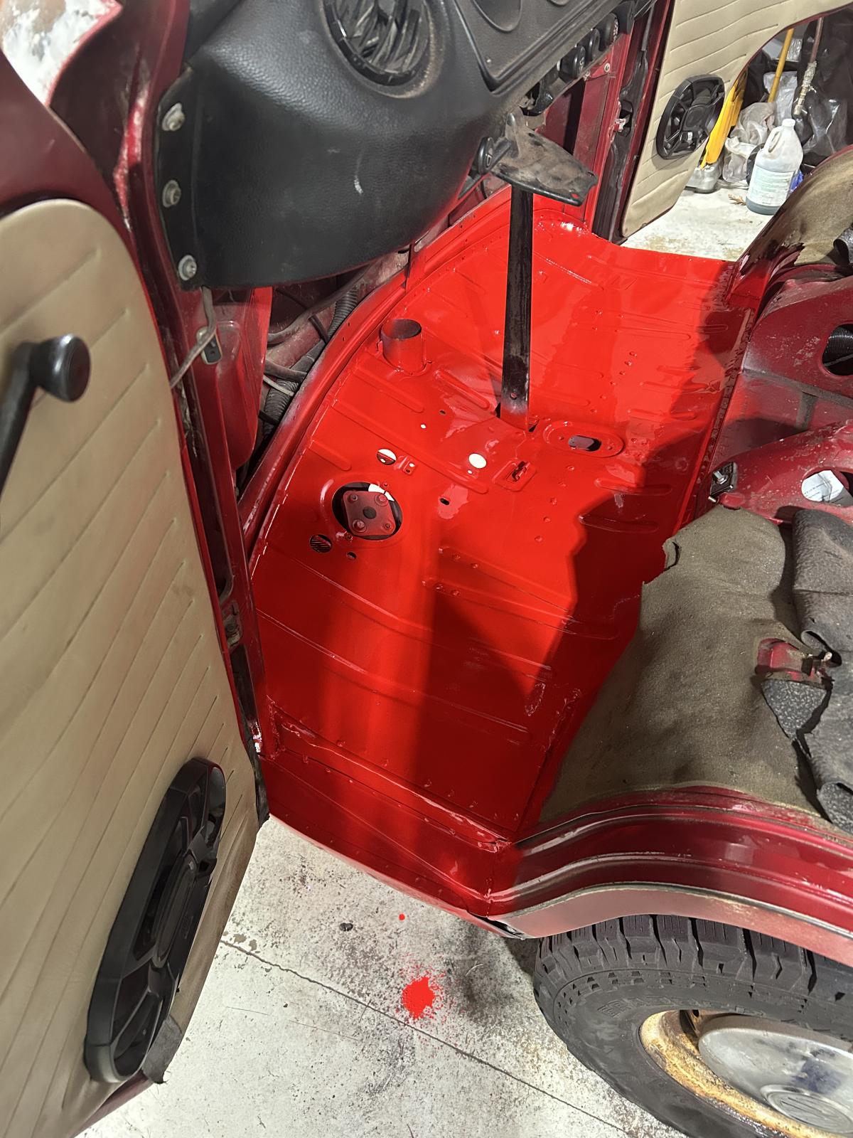

Today I got the other lip fixed, then I got the floors in and painted. Tomorrow after it cures I will start reassembly and finishing patching the dog leg, the new floor is exciting Very Happy

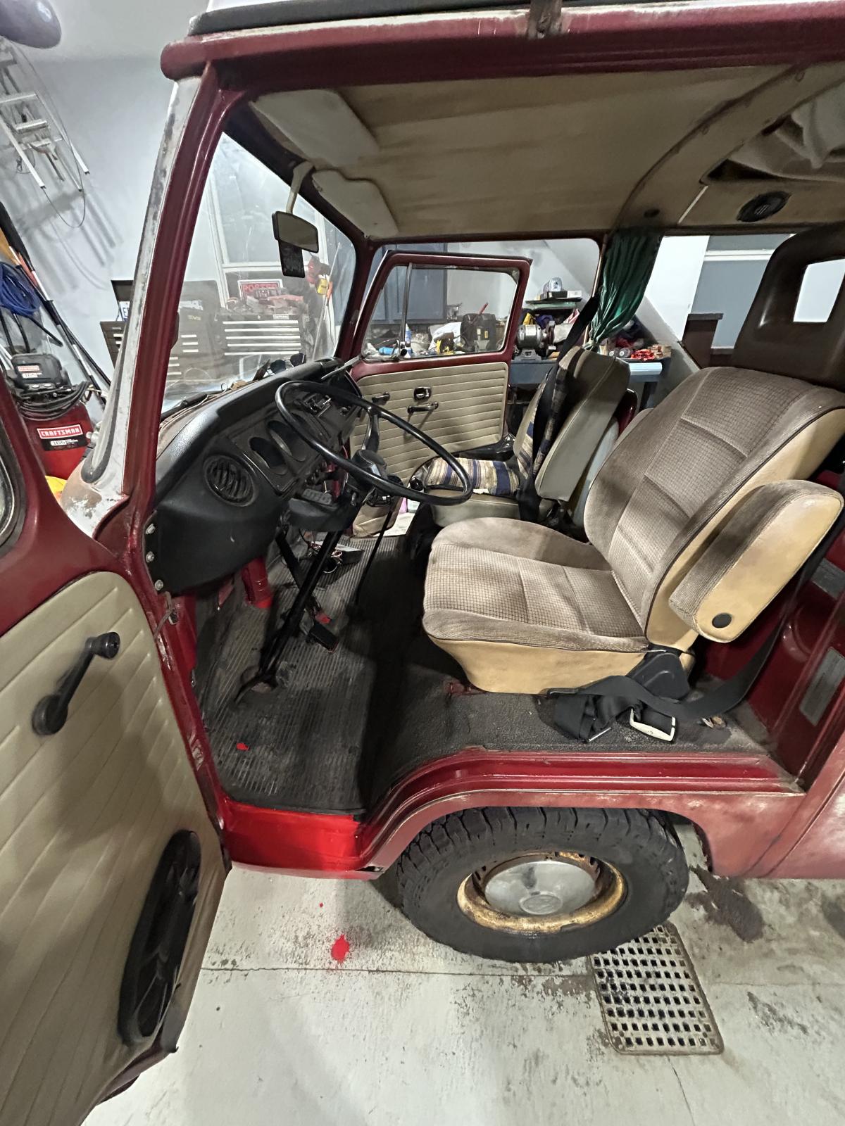

Over the last few days I’ve been working away on it. I got all the pedals back in, steering, shifter, grommets, wiring and all the other odds and ends.
I finally got the horn working, well sorta Laughing The original horn didn’t work at all, and the horn wiring circuit also didn’t work. It turned out to be the power supply wire for the horn was broken in one spot. The ground from the bottom of the steering column above the coupler wasn’t making good contact, and I cleaned the contact ring in the wheel, that fixed that circuit. As for the horn, I sweat the original horns never work, so rather than get a new horn that will fail in a year, I had found some free air horns over the summer at a garage sale, and they worked! So the bus got an air horn Laughing the horn systems on these cars are one thing I hate, but it works now, hopefully I can get a year out of it before it goes bad again.
I also was fighting the turn signals. After putting everything back in, only the right side signals worked, turned out a flipped a wire, they all work again.
One side note for anyone, I figured out you can use a piece of string to pull rubber plugs/ stoppers through the floor. I used it on the clutch pedal stopper. It worked well, same idea as window seals.
The last thing to button up the front end was the ebrake adjustment, everything else was done. I jack up the rear end and checking it and preparing to do the starter, just doing the final check and the I realized the left rear wheel feels wobbly Crying or Very sad The wheel and drum wobble together, I look and the stub axle doesn’t wobble. I pop off the hub cap and look, the hub was wobbling on the stub axel. The castle nut was in place with a cotter pin and I’ve never touched the nut. The nut did not want to come off with the impact due to rusty threads. I’m not sure if a long time ago it wasn’t properly torqued or what happened.

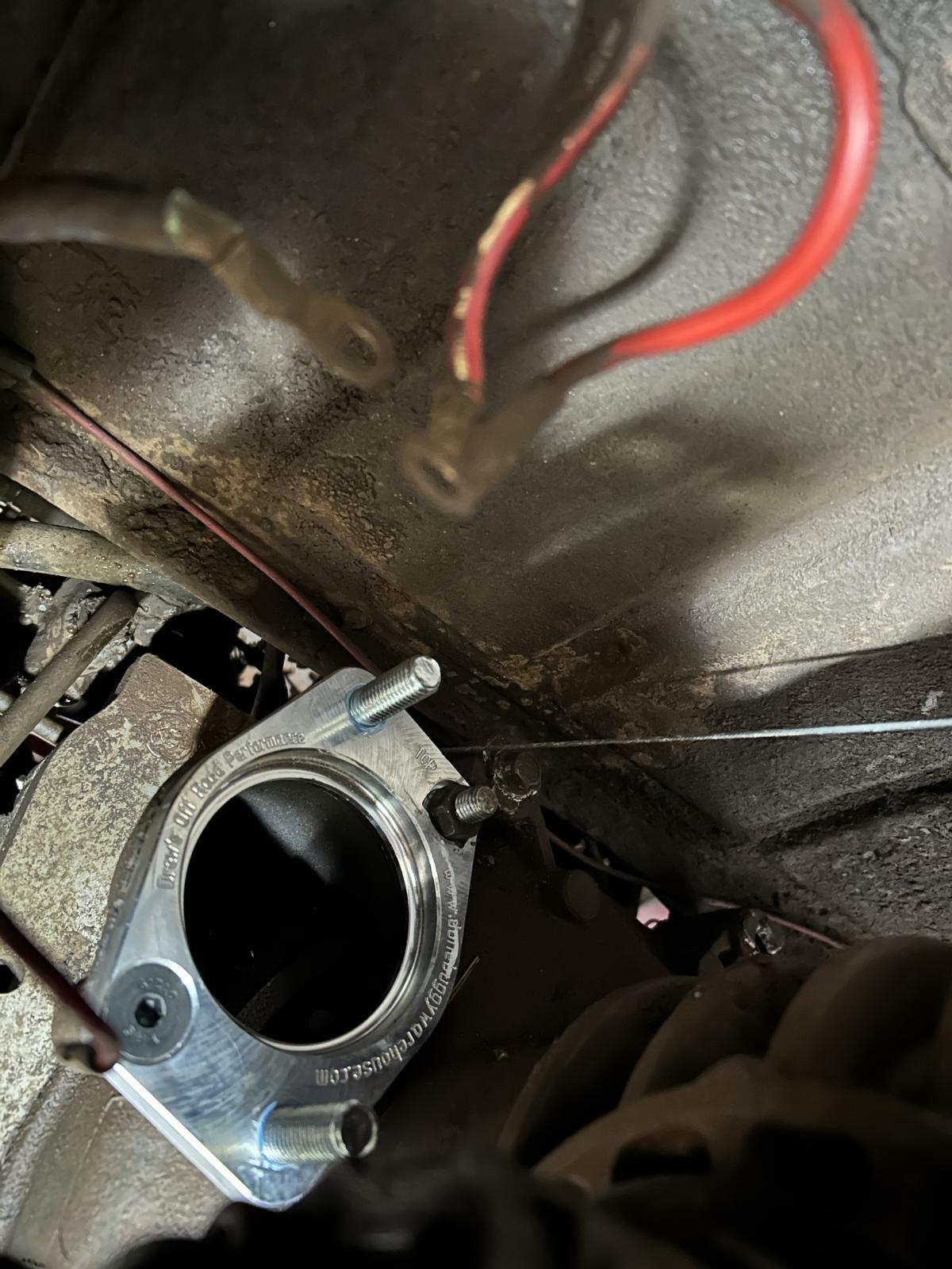

I also am putting in a TDI starter and adapter plate for it, it’s been struggling to crank and I don’t think the OE style starter likes the Subaru engine

But I did also get the new TDI starter in. I realized when I took out the starter I had access to the accelerator cable tube, so that’s how the whole mess started today. But it will all be worth it.
