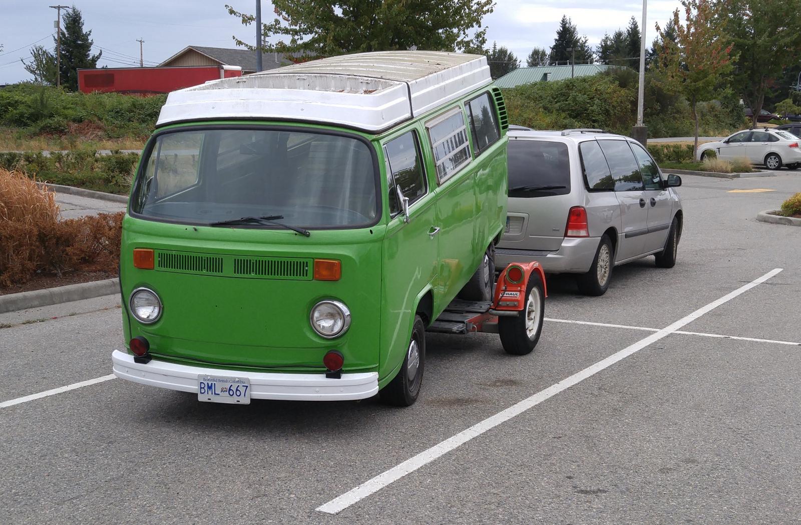

PostPosted: Fri Aug 27, 2021 3:21 pm    Post subject: Reviving my 76 Canadian Market Automatic Westy - Since Aug 2020 Reply with quote
**Build Thread since Aug 2020**
"The Good"
PO ignored the floors and rockers but replaced most of the panels and painted it, then it sat in a garage for 10 years. Dry, but a lot of rust underneath to deal with.

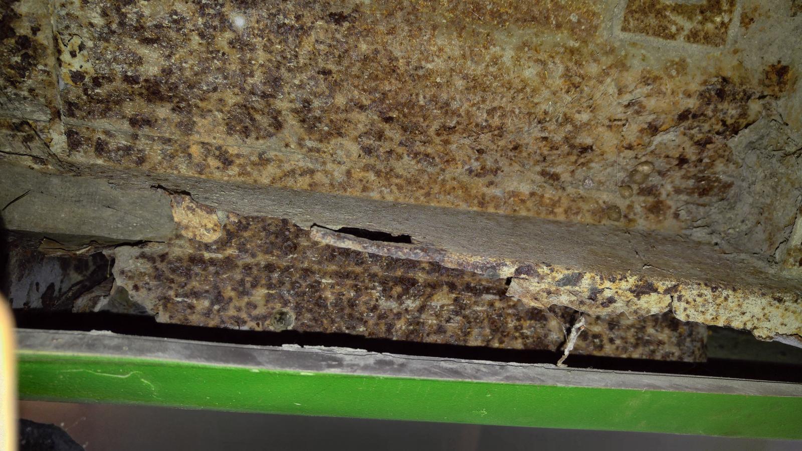

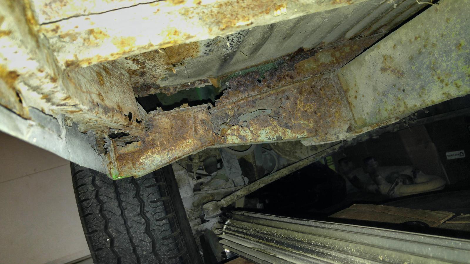

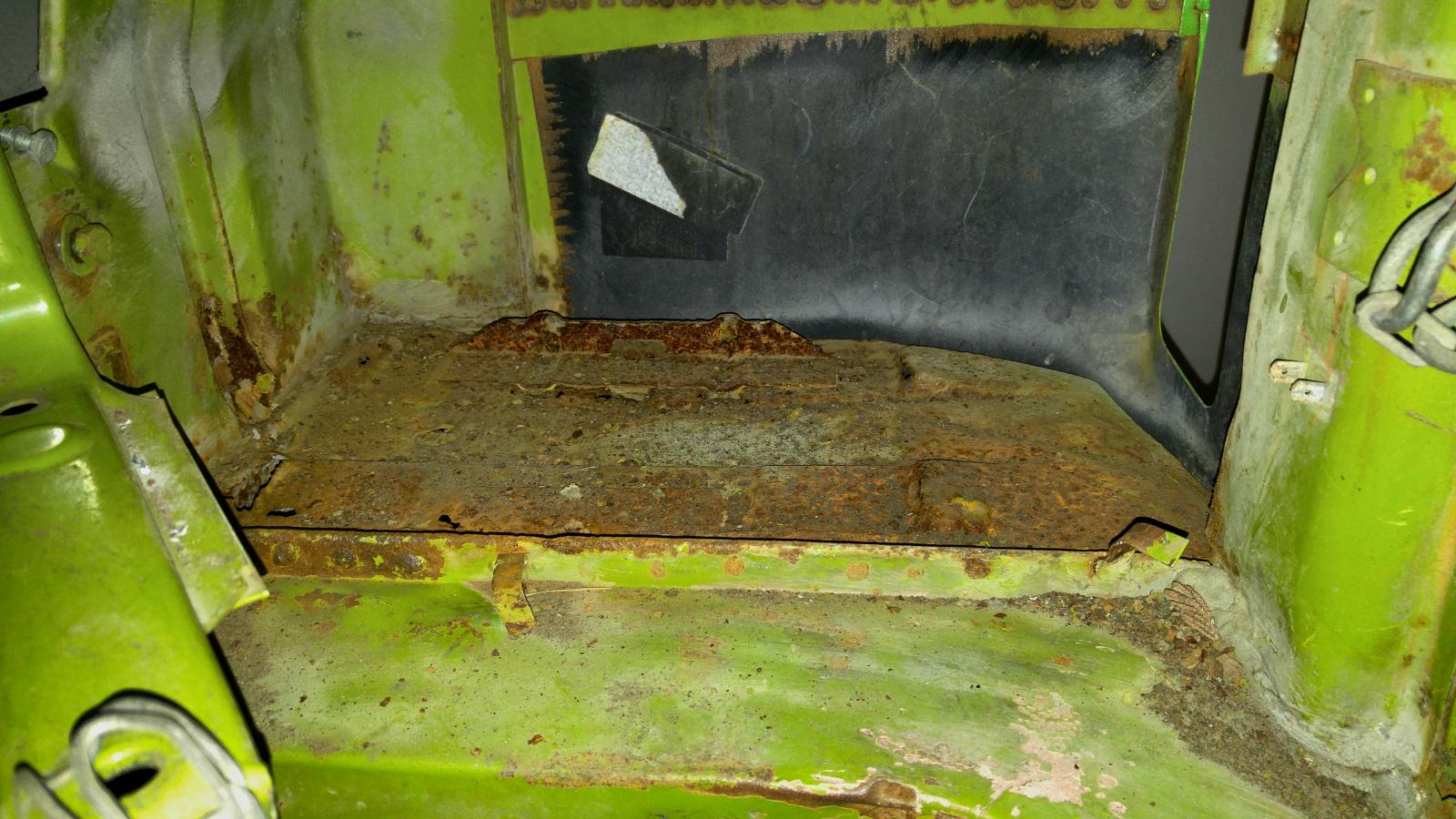

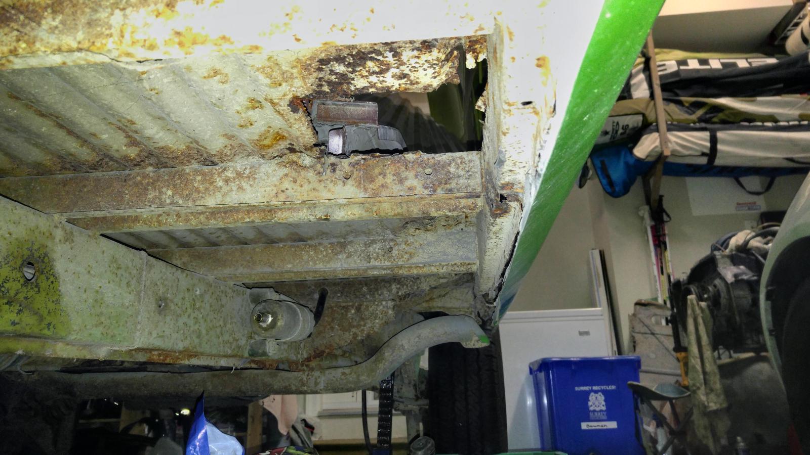

"The Ugly"
Rust, rust, and more rust!

PostPosted: Fri Aug 27, 2021 5:18 pm    Post subject: Re: Reviving my 76 Canadian Market Automatic Westy Reply with quote
That one doesn't have hibiscus flower stickers all over the sink cabinet does it?
Looks familiar in a bad sort of way. Confused

PostPosted: Fri Aug 27, 2021 5:26 pm    Post subject: Re: Reviving my 76 Canadian Market Automatic Westy Reply with quote
wow, what a fucking mess.
it can all be fixed but hopefully you didn't pay more than a couple grand for this gem. i would 100% question everything the PO did on this after seeing the photos

PostPosted: Fri Aug 27, 2021 9:22 pm    Post subject: Re: Reviving my 76 Canadian Market Automatic Westy Reply with quote
No, it didn't have any cabinets or front seats. Skills, got it fairly cheap so no worries.

busdaddy
Joined: February 12, 2004
Posts: 53169
busdaddy is offline

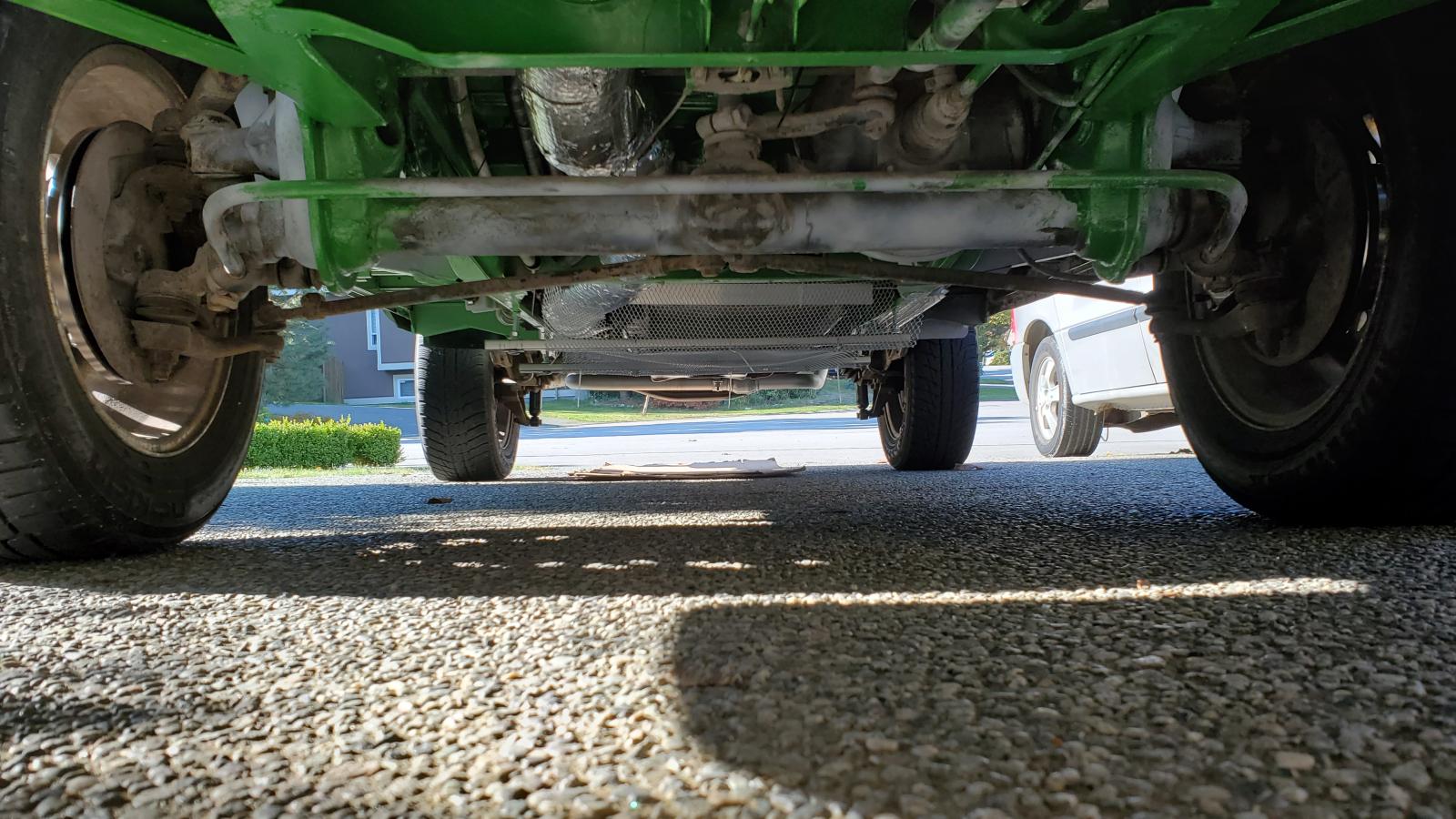

PostPosted: Sat Aug 28, 2021 8:11 am    Post subject: Re: Reviving my 76 Canadian Market Automatic Westy Reply with quote
What's going on with that LF wheel?, is the beam disintegrating as well?

PostPosted: Sat Aug 28, 2021 11:27 am    Post subject: Re: Reviving my 76 Canadian Market Automatic Westy Reply with quote
yea, check the beam carefully
looks like you're jumping in. the rocker is a 3 piece deal... a mid, inner and outer.
many places don't list the mid rocker but they are available

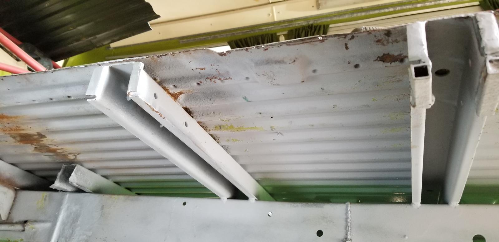

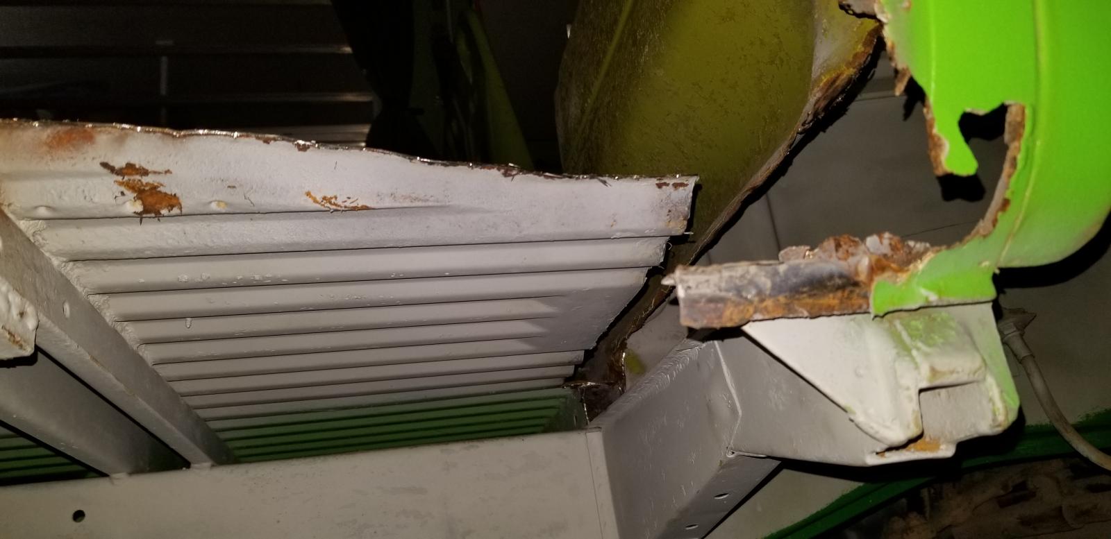

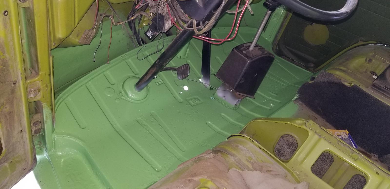

PostPosted: Sun Aug 29, 2021 8:25 pm    Post subject: Re: Reviving my 76 Canadian Market Automatic Westy Reply with quote
Thanks for the comments on the front beam. I had the tire leaning against the hub, not bolted on.
More cutting and cleaning. The sliding door bottom rail was rusted through in a few spots and I replaced all 4 jack points and a few floor crossmember ends.

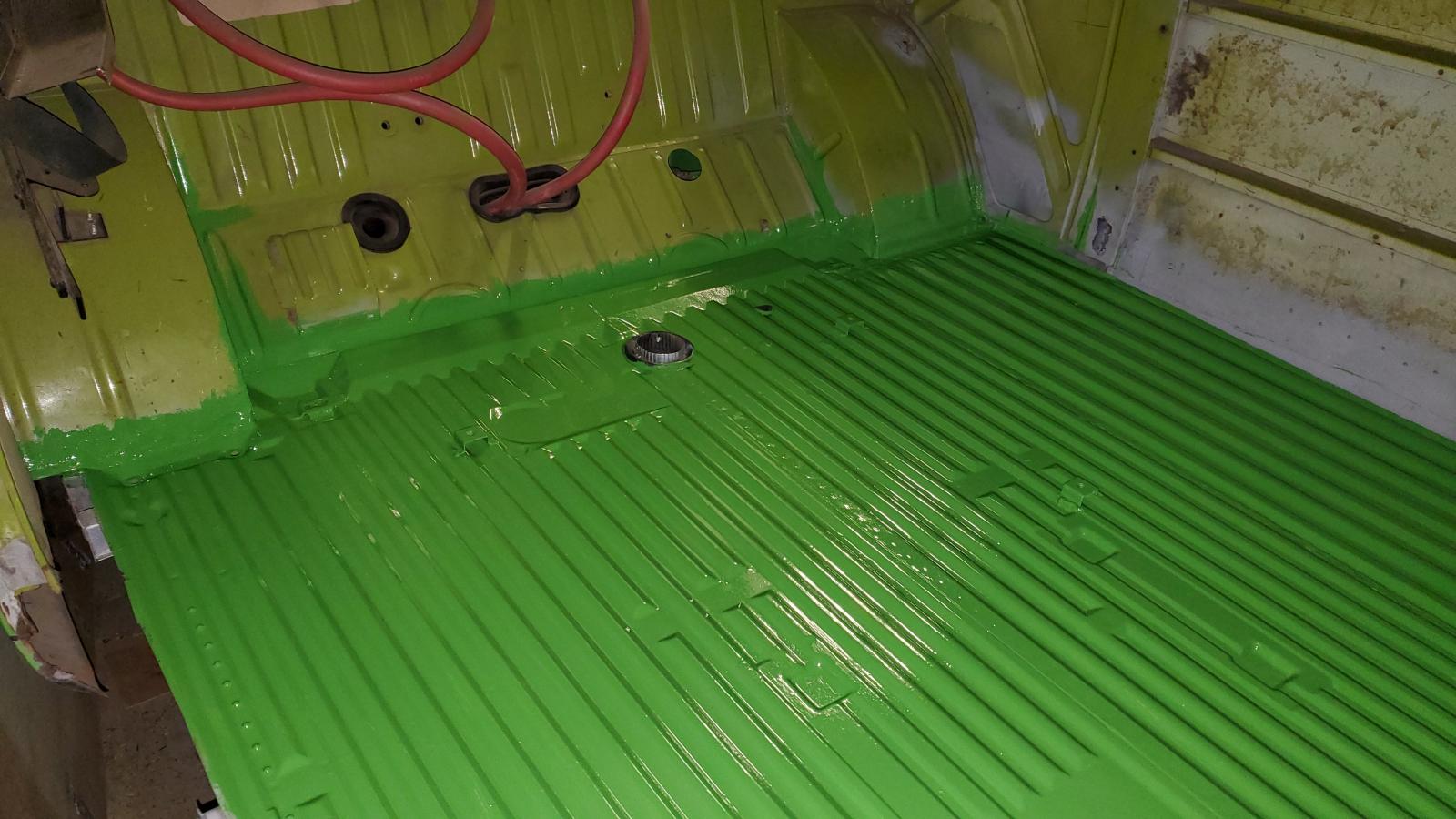

PostPosted: Sun Aug 29, 2021 9:02 pm    Post subject: Re: Reviving my 76 Canadian Market Automatic Westy Reply with quote
Moving forward.

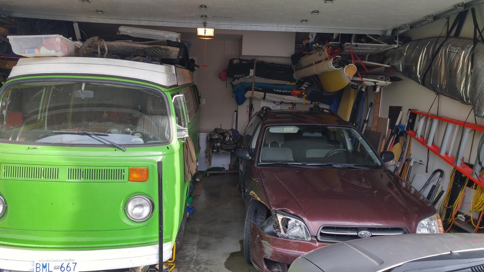

I pulled the trigger! Very Happy

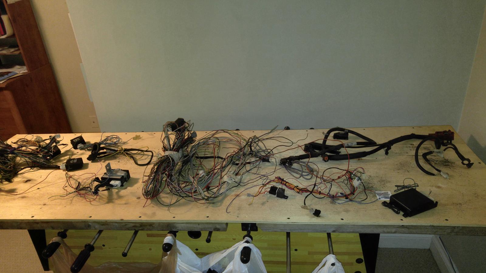

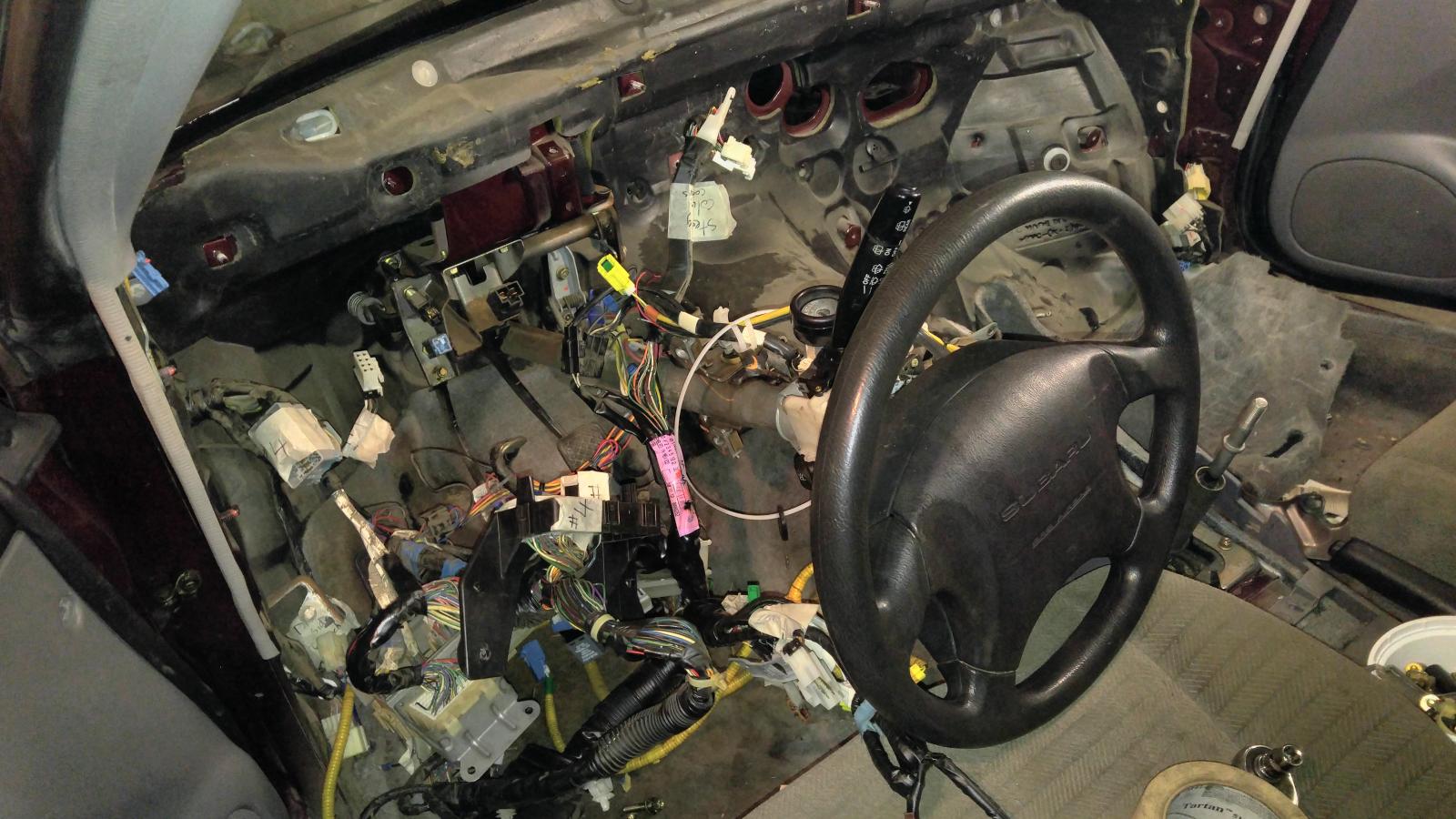

Harness pull
Did the harness myself as I extended the wires to the front of the bus to use the Subaru speedo unit, heater/A/C control unit, cruise control, radio & speakers, and included power wired for AUX battery power up front as well as added a wireless security/anti-theft system to disconnect the starter and fuel pump. Added a start relay and extra wires from the ECU to the Code Cheat board.

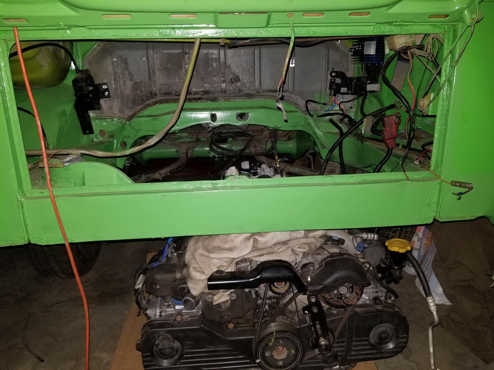

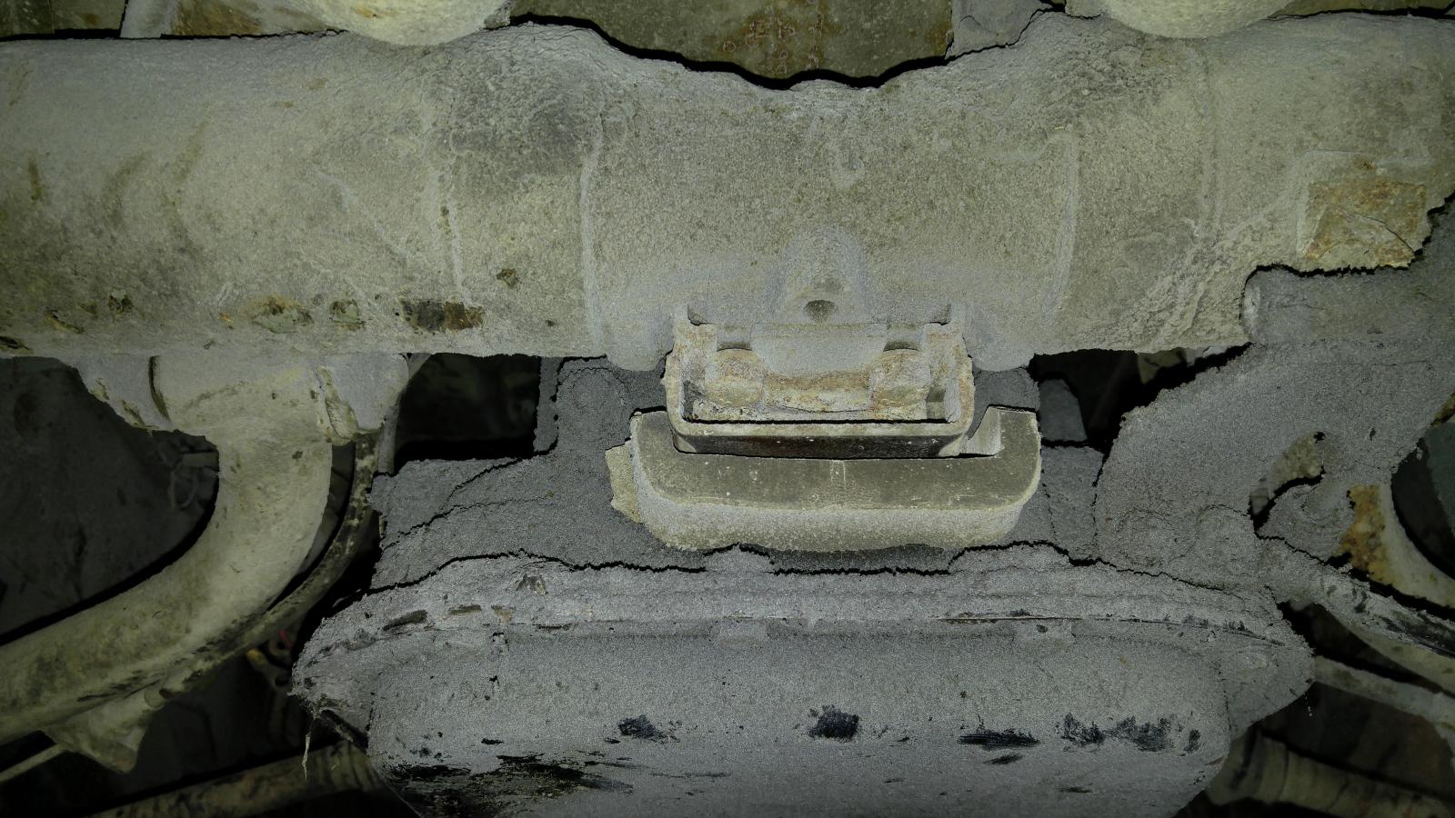

PostPosted: Wed Sep 01, 2021 8:24 am    Post subject: Re: Reviving my 76 Canadian Market Automatic Westy Reply with quote

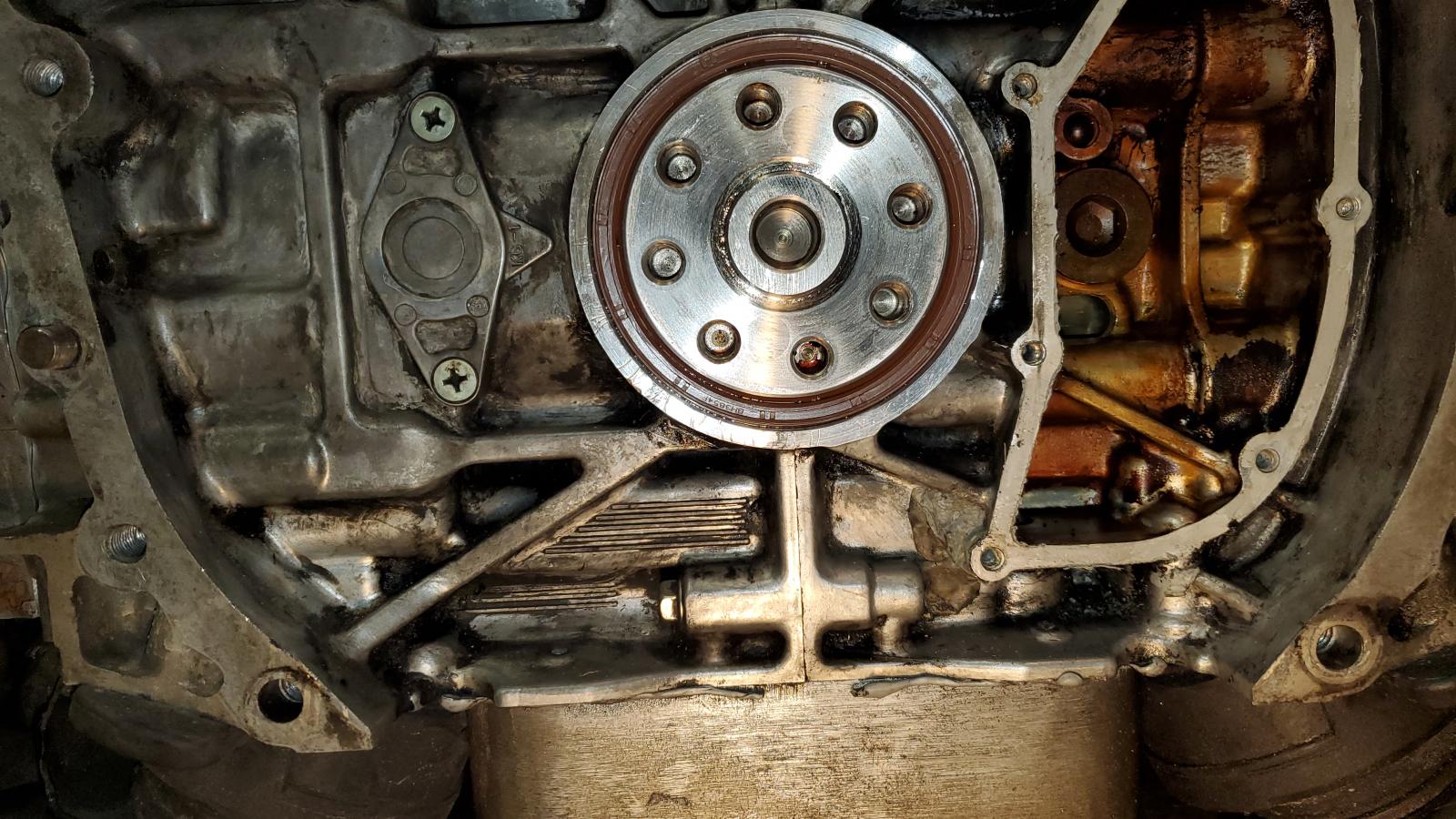

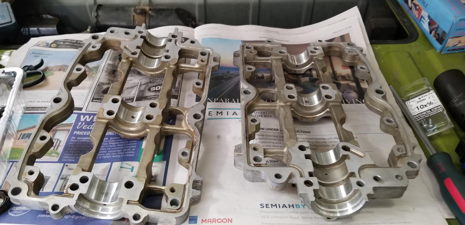

Engine work - Subaru 2.5L SOHC from a 2000 Legacy with 140,000 kms
Swap Kit: KEP Adapter and drive plate, KEP exhaust header, Small Car shortened oil pan, Small Car Code cheat board, throttle cable & kickdown mount for Vanagon Auto transaxle, Busaru engine support crossmember, throttle reverser, & speed sensor. Subaru OEM gaskets, seals, and timing kit. Vanagon Catalytic Converter & a Bugpack muffler.
Had the heads ground flat, did the valves myself with grinding compound, new head gaskets, new head bolts, intake & exhaust valve seals, cam seals, rocker cover gaskets & seals, new rear main seal, reseal of rear plate, new intake gaskets, and new timing belt kit with new waterpump, tensioner & pulleys, etc.

Transaxle swap from an 003 to a 010 from a 1986 Vanagon for the external oil cooler. Had the 010 rebuilt before install. Had to modify the front mount and move the gear changer to the opposite side and make up some adapters to make it work.

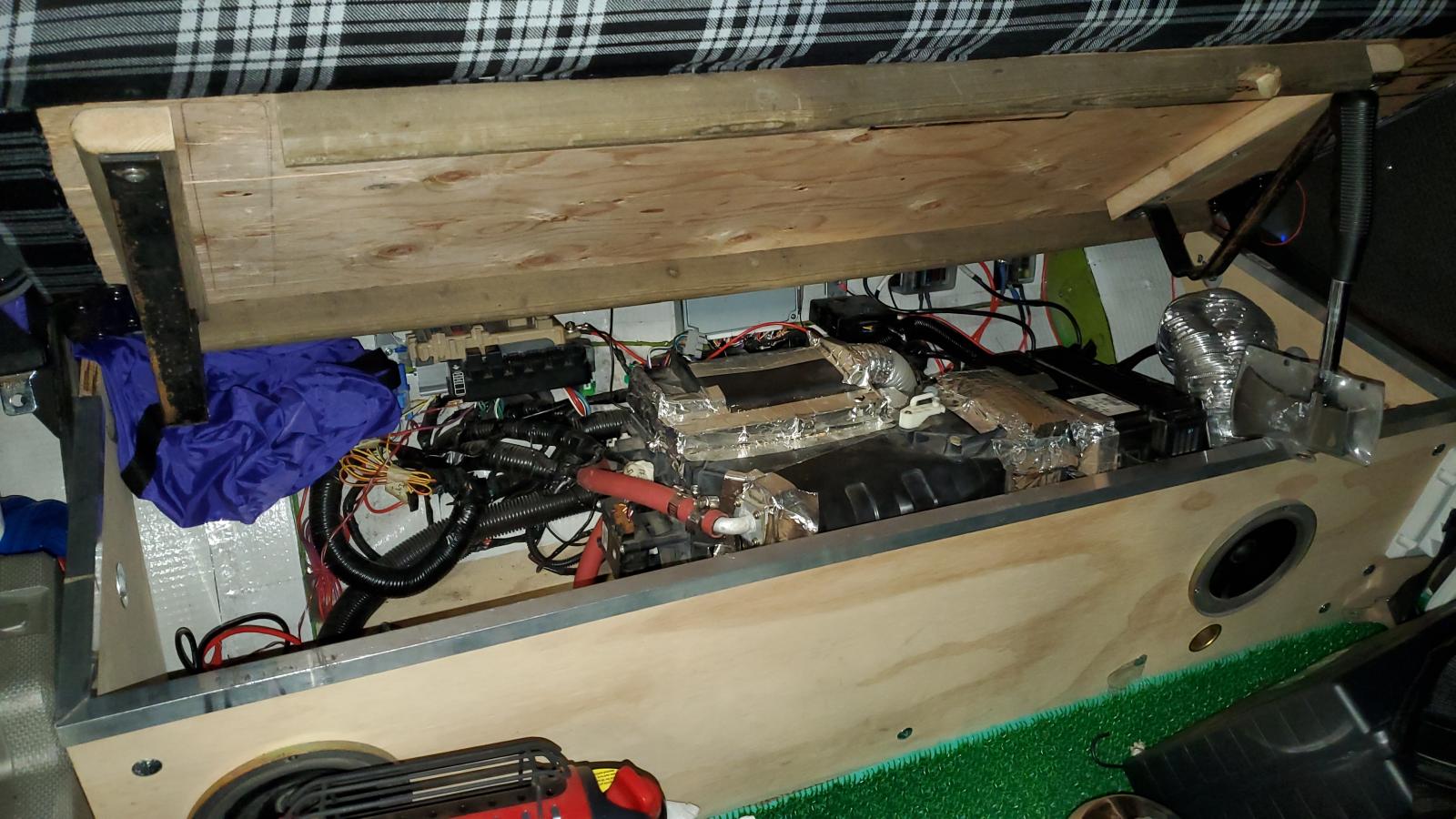

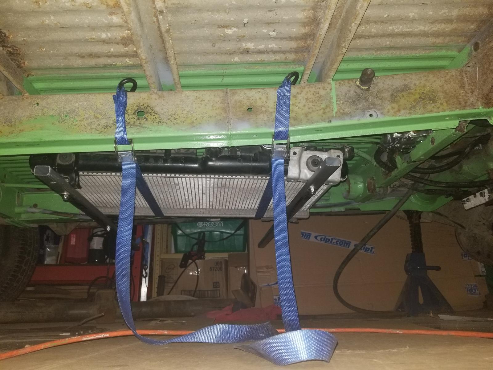

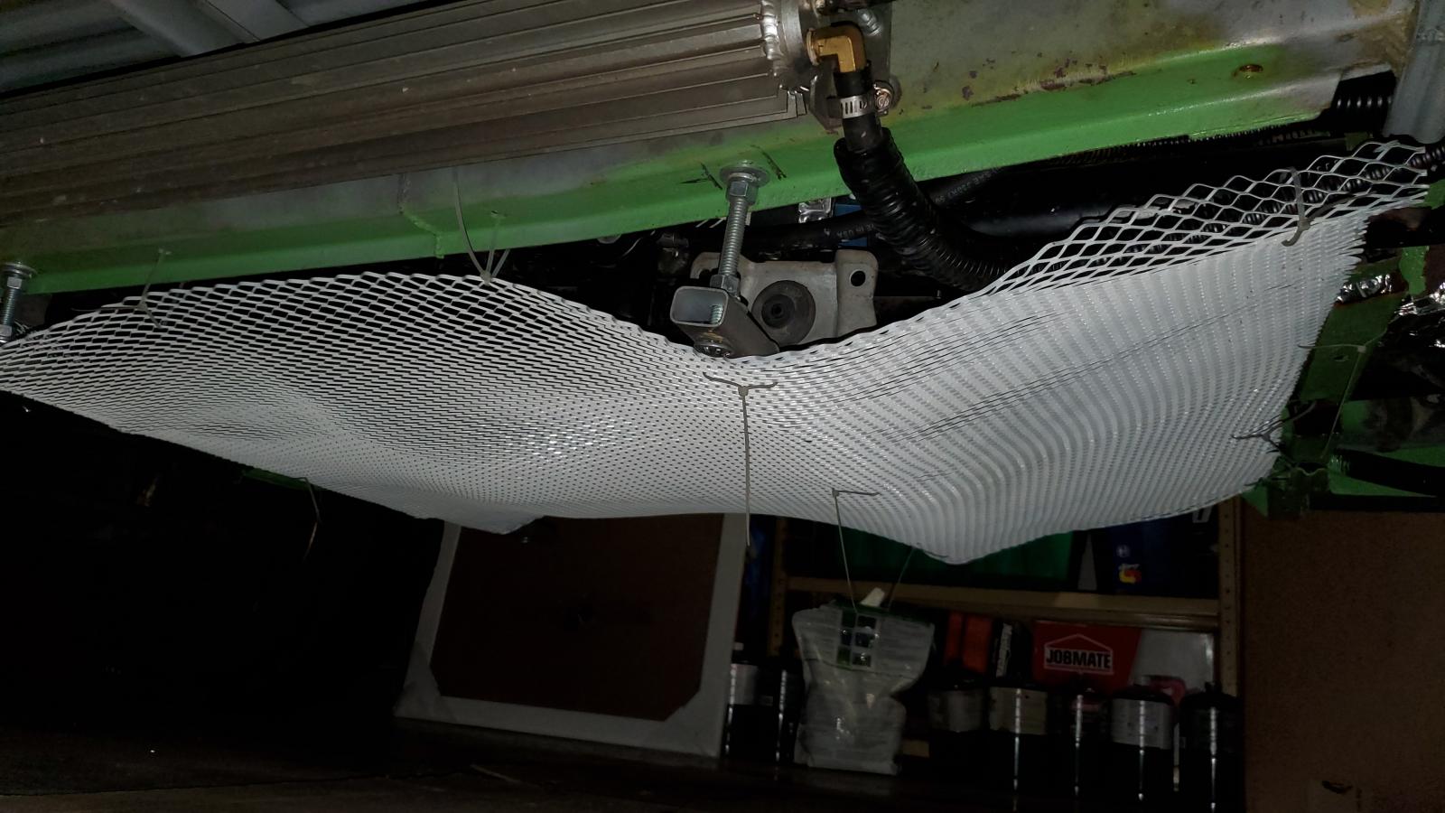

PostPosted: Wed Sep 01, 2021 9:10 am    Post subject: Re: Reviving my 76 Canadian Market Automatic Westy Reply with quote
Belly Rad
Used the Subaru rad and fans out of my donor as well as the overflow tank. Used heavy duty marine exhaust hose rated for the temp, materials, and operating environment. Added 4 connecters: 2 at high points in the coolant lines for bleeding air that lead up to a filling point (with shut off valves) just under the rear access hatch and the other 2 at the inlet and outlet of the rad to install temp sensors, wired to aftermarket gauges to monitor temps before and after the rad. Added a temp/thermo (180F) switch in the outlet connector of the rad to control the cooling fans and ran the ECU fan control wires to the Small Car Code cheat board. Angled the rad and covered with a protective screen instead of making an air scoop. May fab a scoop over the winter. All coolant hose that touches metal (or anything else) is protected by 2" PVC pipe to protect from abrasion or damage.
...and yes, those are aluminum hockey stick shafts that the rad is mounted to as it is a Canadian Market bus after all.... Very Happy

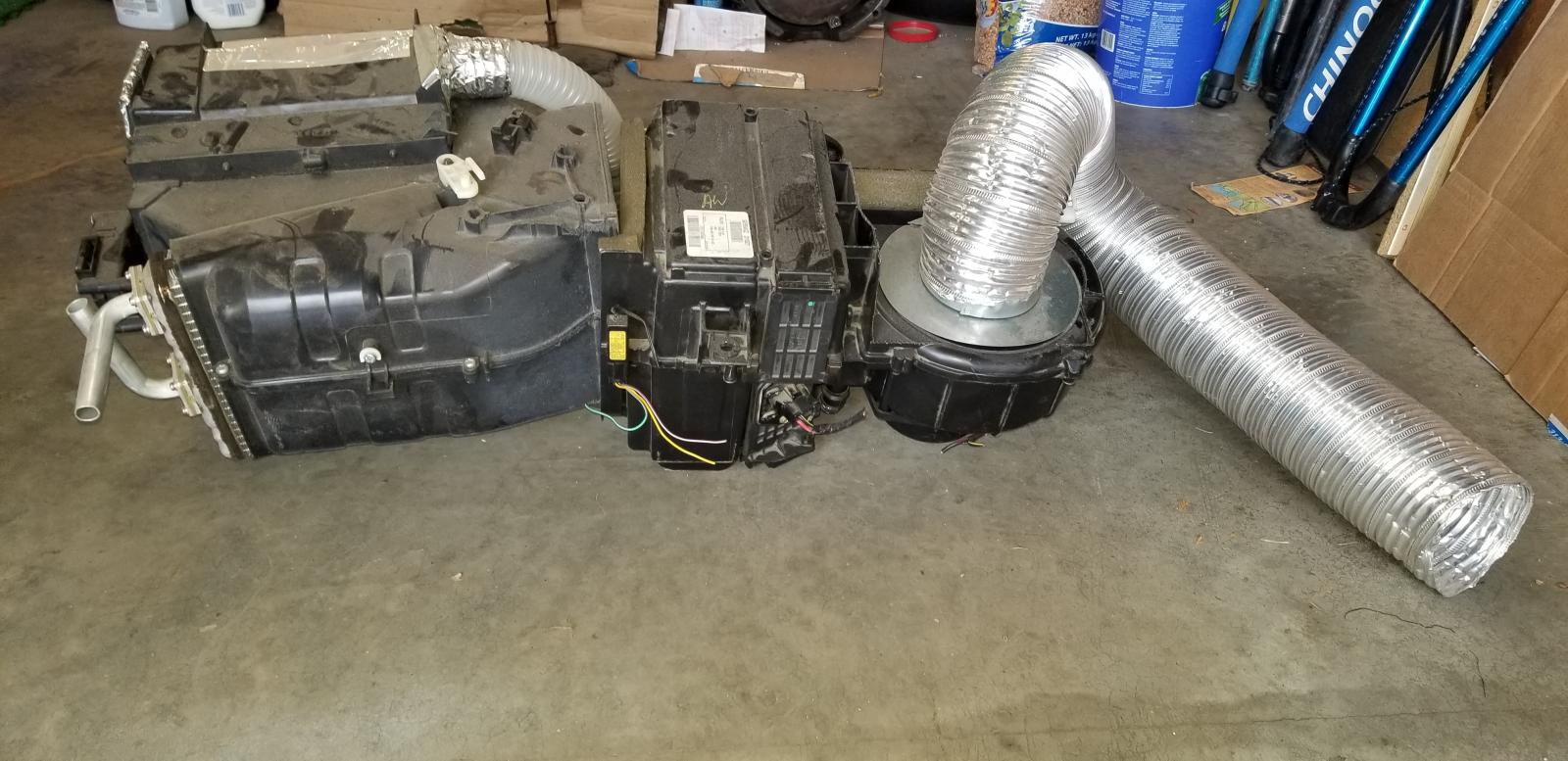

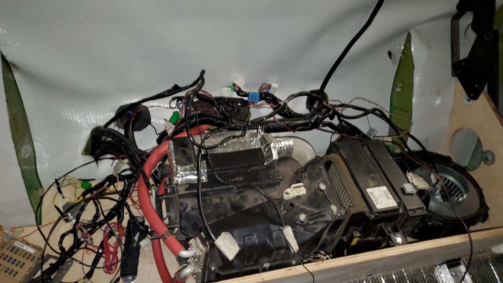

Heater - A/C unit
Piped the Subaru heater - A/C unit through the floor and ran a 3" insulated duct up to the front connecting to the original defrost heater deflect tree/unit.
*Added speakers from the donor and the 1.5" outlets under the speakers are heater-A/C air outlets.*
*Subaru Heater Control Unit that is tied into the defrost tree's mechanical lever and the rear defrost button is connected to the Bus rear window defrost too. Used one of the heater unit's vent actuators to control heat or A/C damper on the heater unit under the back seat using the unit's air recirc button between rear defrost and A/C button. Only issue is it's either full heater or full A/C but will have to see how this works out and modify if necessary.*
