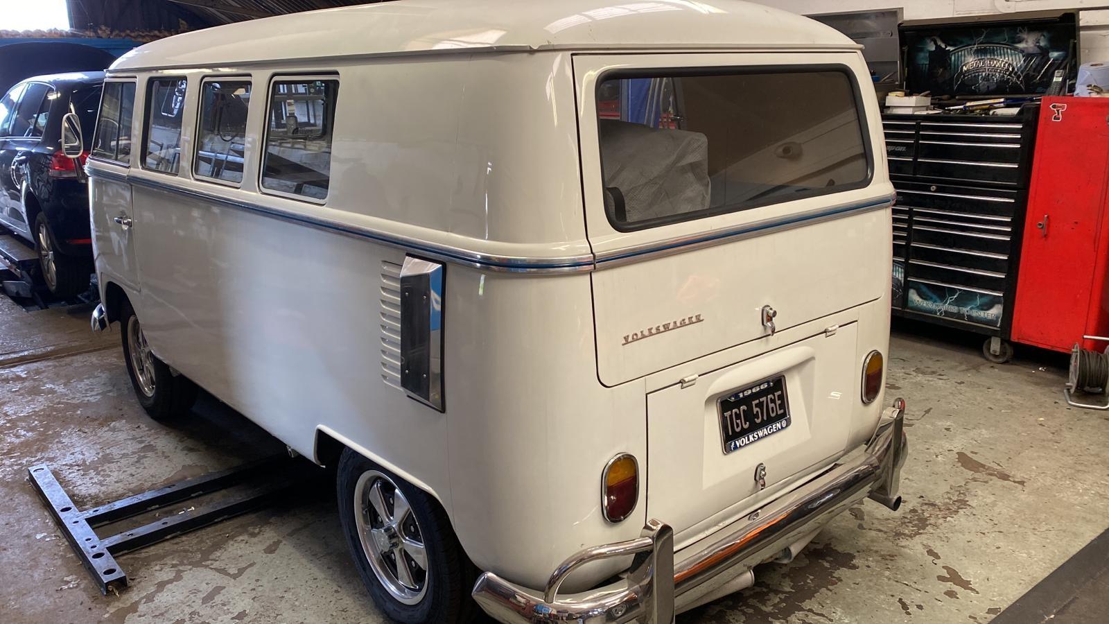

PostPosted: Mon Oct 09, 2023 5:47 am    Post subject: Re: How to keep a Bus stock and all stock height questions Reply with quote
Hi Gents
Please don't slaughter me, but I have a question or two ?
I am a bone stock height 67 Kombi. It's been off the road for a few months, and has now been reconfigured as a camper, with R&R bed Fridge pod etc.
I am currently running Porsche Fuchs re-pops that are 5.5J x ET20. Fitted with 195/70/15 tyres all round.
So Tyres are 195/70/15 current – Circumference 2054.6mm Diameter 654mm = 25.748”
I would like to try and get closer to the 27", and would probably go for
215/70/15 tyre – Circumference 2142.6mm Diameter 682 = 26.850”
After doing some math, I believe I'm correct in saying that if I have a stock Gearbox 4.375 x 0.82 x 1.26 x 1000 = 4520.25 then at 3500 revs.
I would be around 3500 x 2142.6 x 0.06 = 449946 / 4520.25 = 99.54 km/h = 61.85 mph ?
The main question is
A. Am I correct ?
B. Due to financial constraints if I were to only replace the rear tyres what effect would having the current 195/70/15's left on the front for a while ?
The tyres I have on at the moment are almost brand new, probably only done 250 miles on them, and can't really shell out more $$$ after all of the recent work, so was thinking replace rears first and the fronts at a later date ?
Are there any other pitfalls to this that I'm missing ?

PostPosted: Wed Jan 01, 2025 8:31 pm    Post subject: Re: Murt Reply with quote
Hello Murt, it is a shame you got no replies - until now. Changing to a taller tire only on the rear should be all to the good. I use a bit taller on the rear by intention. You must have made the switch long ago. How did you like it?
By the way, that’s a sharp looking bus. What engine specs? I see the dual quiet pac mufflers. Also, it looks like the offset on those rims allow you to fit those tall tires without issue! Nice!
