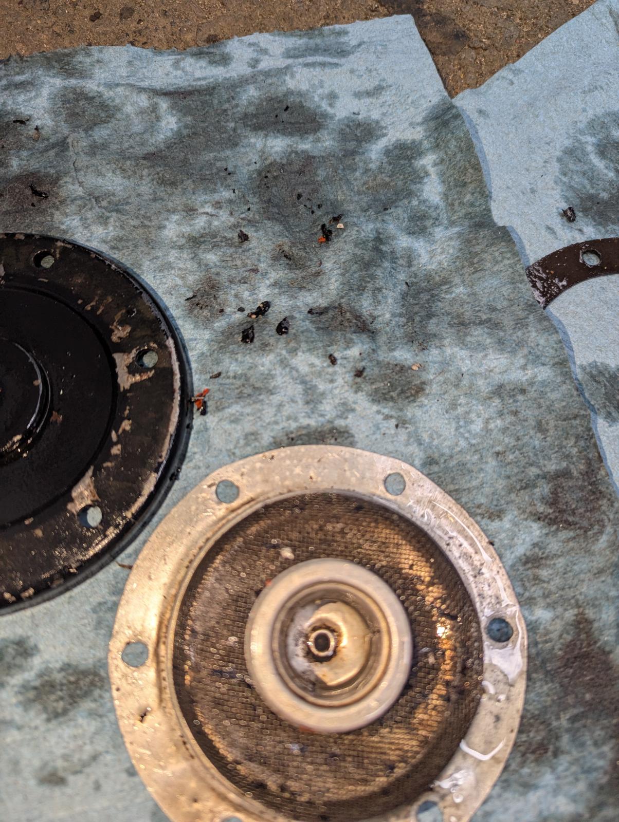

Quick update - still haven't pulled the tank, as winter has hit w/temps 20s-30s and no garage...
But I did empty it out, replace the soft lines, installed new filters in the path to the pump, and disassembled and soaked the carb in one of those parts cleaner gallon cans. So far, 100 trouble-free miles, including 30 at 70mph on the highway yesterday. You'll recall down in Miami I couldn't do 10 w/out the carb blockage and fuel starvation kicking in.
I also changed the oil yesterday as I wanted to see if the FL Fiasco left traces of obvious internal damage. Much to my surprise, it was completely clean. Nothing on the magnetic drain plug. I picked up one tiny flake of silver on a paper filter I ran the oil thru as it drained, but that's it. I did forget to check if it was magnetic or not. I also removed the oil screen and split open the oil filter. Nothing, Nada, completely clean. Makes me hopeful that I didn't do any internal damage to the motor.
Interestingly, oil temps are running a lot cooler now even after yesterday's highway run. I suppose there are a combo of reasons for that - the cold weather, fuel flow not getting blocked, and removing the shims from the rocker arms to allow more opening of the valves, particularly the exhaust (i'm completely guessing there)...? I know this is a temporary "fix" - ultimately I have to set the rocker geometry properly and custom cut push rods.
