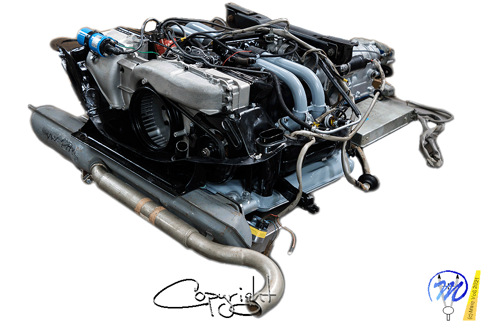

In addition to new springs, new shocks, new windshield, new brakes, the car got a refurbished engine and a pretty good gearbox without any noise during switching.
Now the car is running like a new one - what I wanted during the last 2 years has become true.
