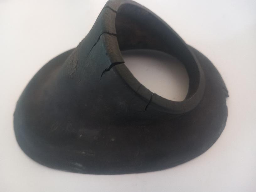

I'm not sure if I'm posting in the correct place, but as there are very knowledgeable people here, someone will know Smile
1950s rubber part with VW logo & part number 29.108.603.1 & also a rearing horse logo with numbers 3135513.
The hole is approx 60mm
Anyone know what's it from please ?

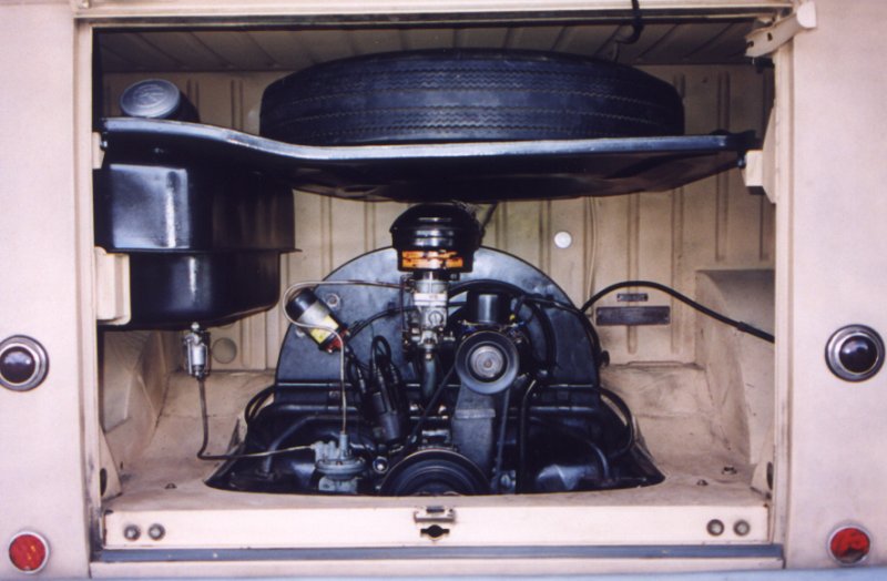

Barndoor Bus gas tank seal.
60mm is:
Chassis # 20-030868 until 20-047001
This is approx. 8/1952 - Early 3/1953
You can sort of see the location here in the upper left above the spare tire tray, although this is a later Bus

Thanks for that, the 60mm was puzzling me !
Can see the rubber in your pic.

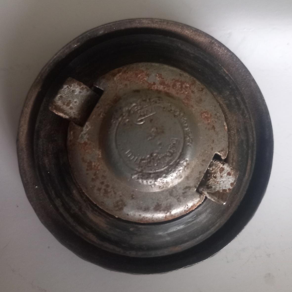

Attached pics of fuel cap. It has "Cwi" & "mit luftung" logos. Presume latter means vented. It has no VW logo on top. Is it original ?
Someone else should confirm but I believe the outlet on the bottom and the neck are both in different places on a Truck.
I don't recognize that fuel cap so it's probably a replacement.
I got and still have a NOS, old-style barndoor fuel tank. It looks similar as the one in pic, but has a neck for a 80 mm cap.
https://www.volkswagen-classic-parts.com/catalogues/TransporterT1/html5.html#/132
VW ETKA lists no fuel tanks or part numbers for busses till 2´55 for different types.
But for the types 261 + 263 the parts number is 261 201 055 till 20 - 117 901
If I got it right, a 80 mm neck and cap makes the tank type 261, 263
Caps:
100 mm till 20 - 030 867, 211 - 244, 111 201 551
80 mm, 111 201 551 A
60 mm, 211 201 551
The 60 mm caps that I know, have a VW-Logo on top. (they fit also as oil filler cap for beetle 8´55 and later)
(wondering about the type 1 part number for the 80 mm cap, but evtl. there was once a bus version without logo)
