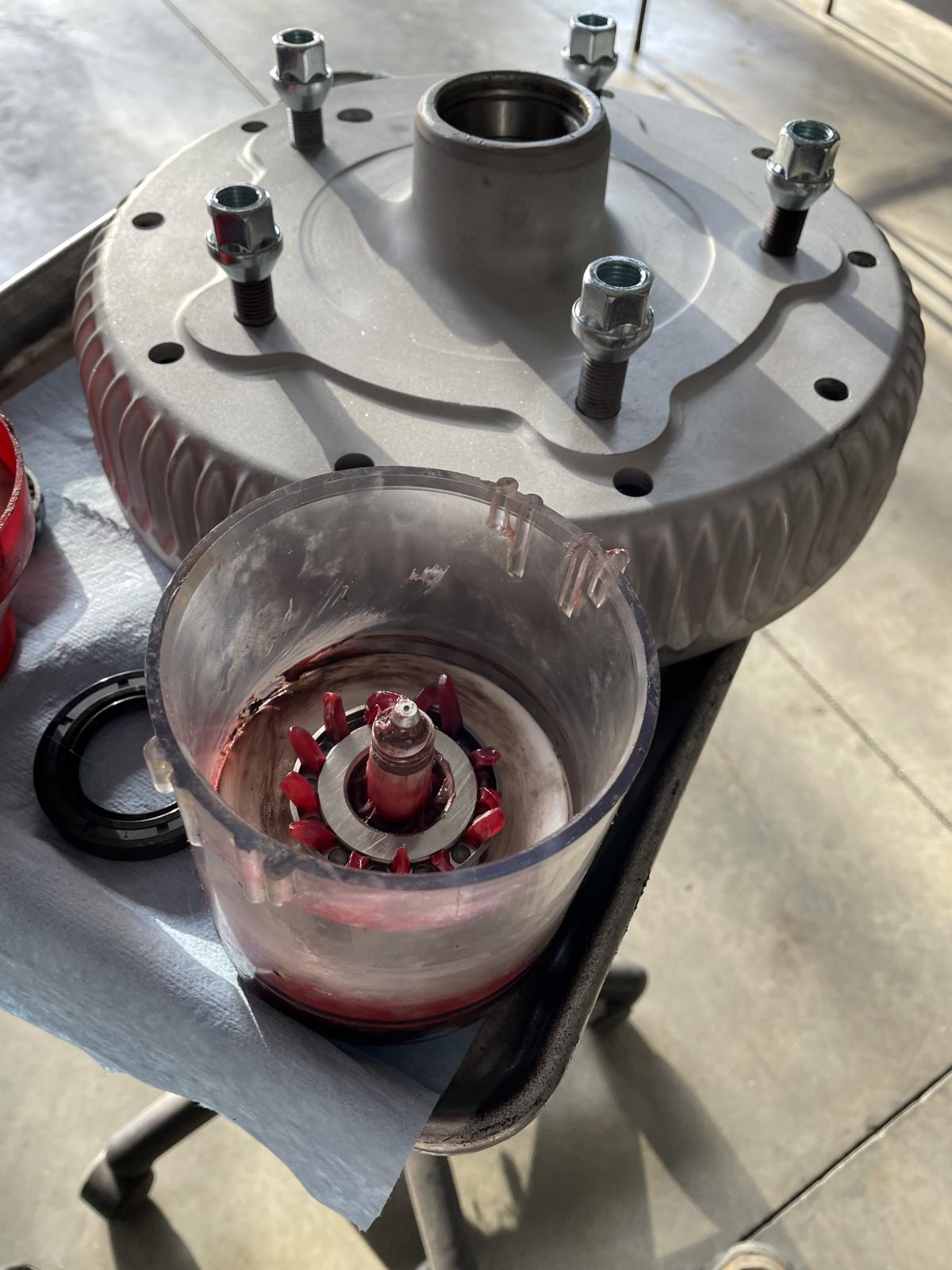

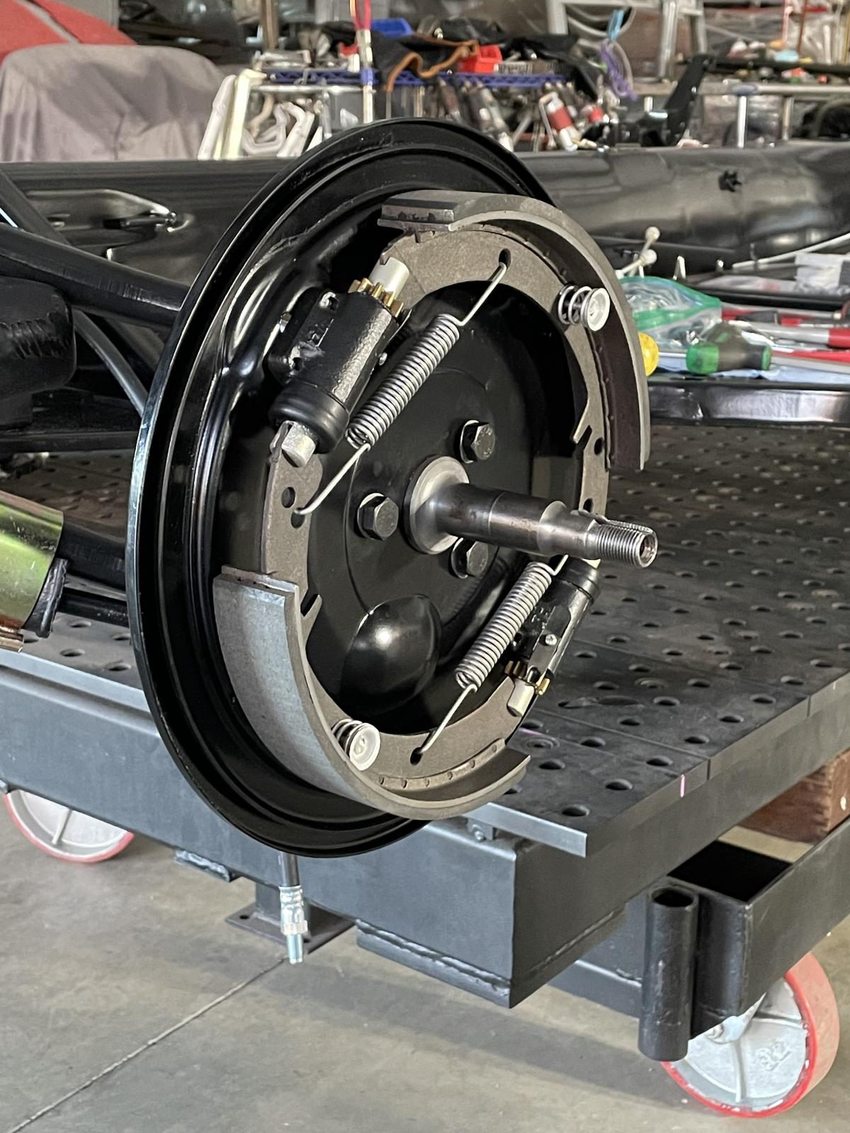

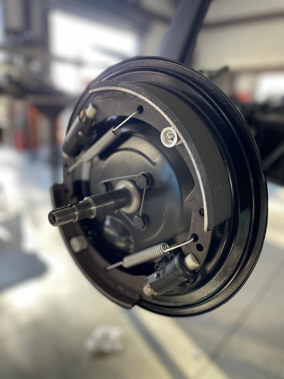

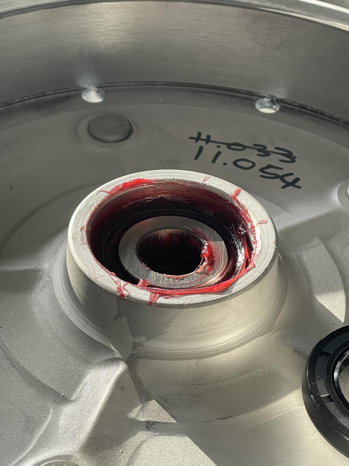

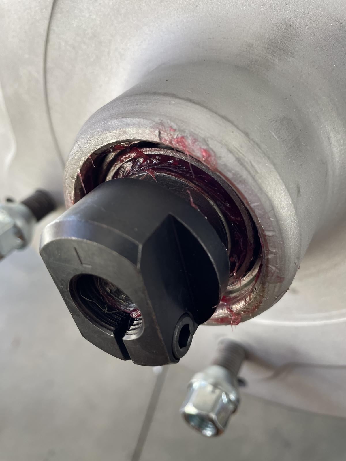

Just wanted to post my experience with putting Porsche 356b brakes on my 58 Ghia with a split case transmission. Everything on the chassis is stock.
First, I sent the drums and brake shoes to Martin at the Machine Shop in Colorado Springs, CO. I thought the drums might need to be relined, but Martin called and said they were within spec and only needed to be turned. He cleaned all the drums and brake shoes, installed new pads and arched them to the drums. I also had him install VW bearings (he had the bearings in stock and knew exactly what to do) on the front drums and check the rear drum spines to make sure they were solid.
Martin was extremely fast and professional and great to deal with. It took less than two weeks to ship him the drums and get them back! I highly recommend his work.
With the VW bearings installed the front drums went on with no modifications using stock VW spindles. I used stock VW soft lines too.
The rear drums bolted right on too, with no modifications (the bearing caps fit just fine), though I did use Porsche 356 castle nuts for the rear drums.
The only issue I had was e-brake cables. With new shoes the stock cables were a bit too short. Here is a breakdown of type one cable sizes that are close and potential issues:
