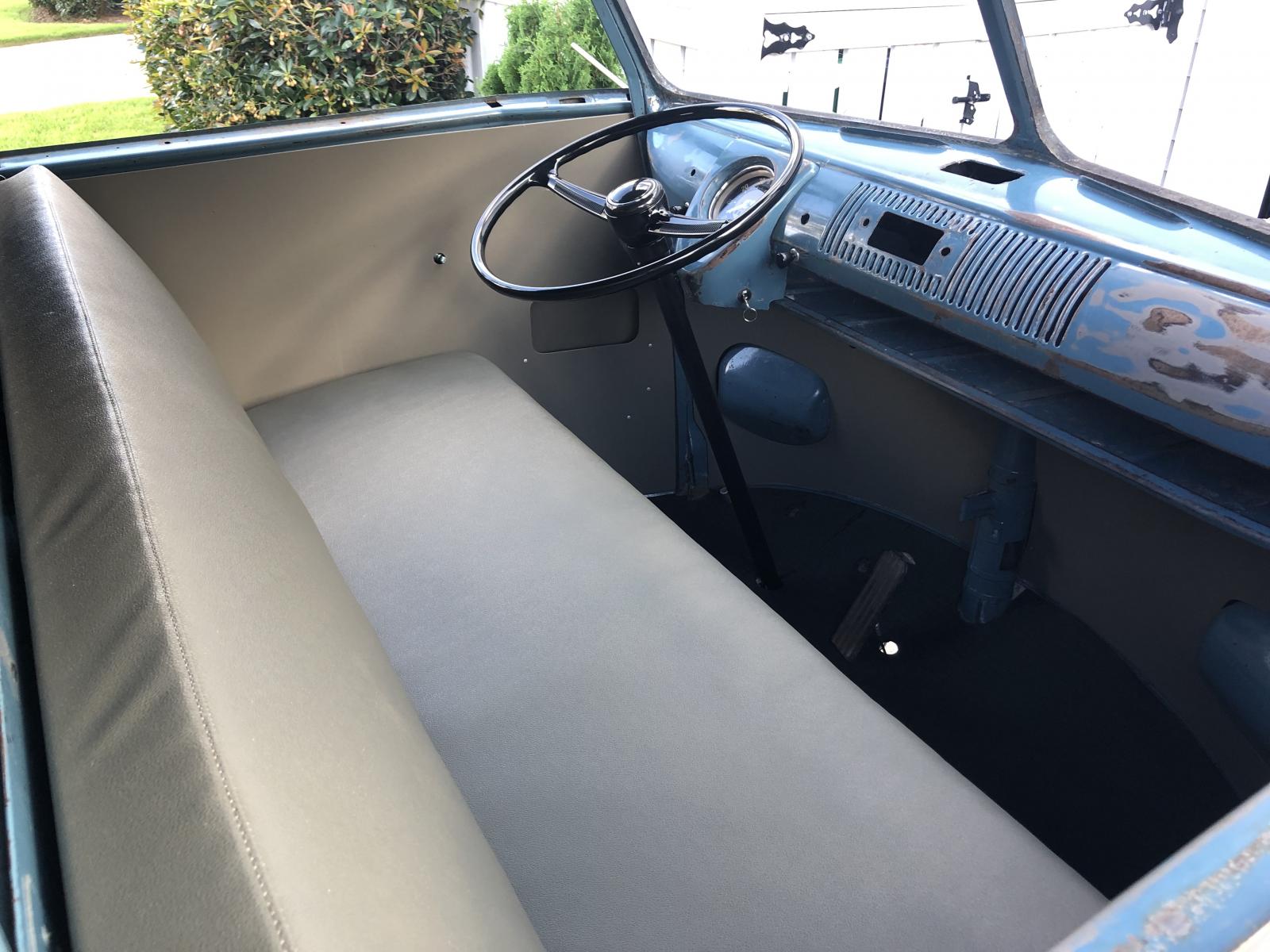

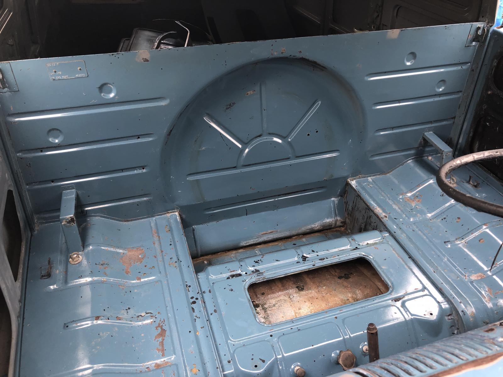

Interior: It was bad. Seat cover was history, only one door panel remained and the wiring was pretty bad. No door or side window seals. Fresh air vent was missing all the internal parts. All interior metal was painted in black and grey spray paint, with some areas of the dash covered in glitter (?!?! Rolling Eyes ). I was able to strip all of this paint of with Goof Off Graffiti Remover. The stuff works fast and did not damage the original Dove Blue paint that remained. Steering wheel was history too. New steering wheel by Flat-4 was purchased along with a new seat cover from Deutsch Polster. New knobs, switches and wiring was purchased. All pedals, hand brake, shifter and misc parts were powder coated or painted. New correct hardware replaced broken, incorrect or rusty pieces. Internal door lock hardware was either replaced if broken or cleaned up. Door glass was dissassembled, cleaned up, new seals purchased, powder coated and reassembled with new latches, hardware & rivets. Previous owner had purchased a new set of panels from Clara and never installed them. They survived, still wrapped up in her packaging. I have not completed installing them, waiting to do doors and kick panels last, after electrical is sorted. Here is a few pictures of the before and after....
Stripping paint....

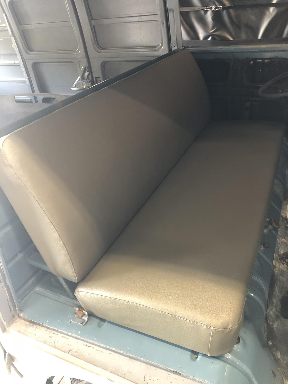

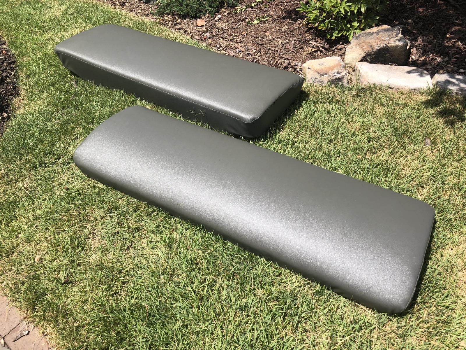

New seat covers.....

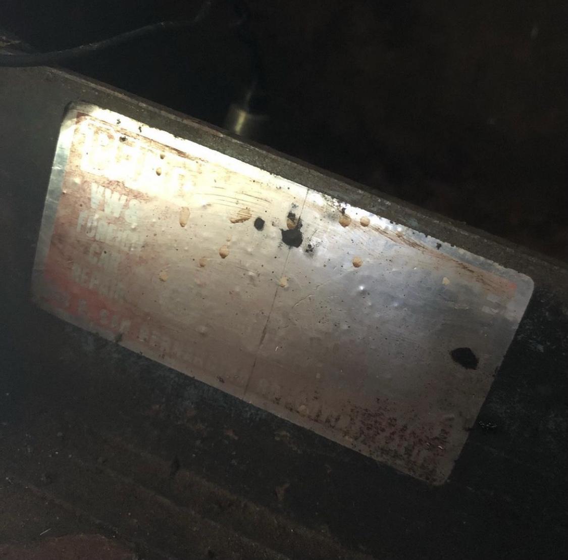

Thank you! Sticker had a chrome background with red graphics. It was mostly gone. Sorry had it wrong...Covina, CA
Only thing I could make out....
Beetle Clubhouse
348 E. San Bernardino Rd.
Covina, CA
