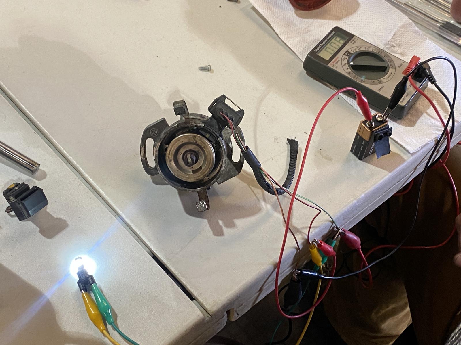

Saturn wrote:
Jeff suggests hooking up a lightbulb to rig and find it goes between bright and dim instead of completely out. Now it is Sunday night, and we need to obtain a replacement in the next 18 hours as we are heading down to Monterey on Tuesday. Look up the sensor on the FCP Euro site to find it is also in 1990s Cabrios, Golfs and Jettas. Time to mount an expedition to the junkyard to locate some potential donors. Look up and find 7 cars in the closest two Easy Bay boneyards with the same Hall sensor. Instead of the 12V power supply, we use a 9V battery to see if that will also work. It certainly does and this allows us to have a mobile rig to test the junkyard sensors. This way we know the part will be usable and not the reason the car ended up being sent to be junked.
If the boneyard isn't successful, this seems to be the right one:
https://www.vanagain.com/product/hall-effect-sende...ngine-only
Based on the difficulty of getting these apart and back together without breaking something, I'd also suggest this:
https://www.vanagain.com/product/new-distributor-for-95-eurovan-5-cylinder
The one that busdepot is selling should have worked, but I ordered one, and the plastic overmold on the sensor was out of position a bit, and caused it to hit the tone wheel. I never heard from them that they'd resolved the issue, and wound up returning it.
I think this one is correct as well:
https://europarts-sd.com/halleffectsender1995-1996.asp
Thank you for the links and relating your experience with some of these parts. My last post didn't have the link for the part at FCPEuro https://www.fcpeuro.com/products/vw-distributor-ig...96#fitment

Browsing at the Boneyard
At the PicknPull near the Oakland Coliseum complex sit two potential donors to the south in Newark, CA are 5 more. Hitting the road after the morning rush hour has subsided, it is a 30 minutes drive to the Oakland yard, and the first car on the list is a 1999 Golf. To our surprise, turns out it has a coil pack set up and not a distributor. A couple minutes later arrive at a 1997 Cabrio and thankfully the distributor is still with the engine. It takes about 10-15 minutes to extract it out from the car. A good deal of this time is prying and leveraging as it didn’t just pull out, it was more like serving an eviction with the amount of effort needed to release it from its perch. Set up the test rig on the fender and voilà!, the Hall sensor works.

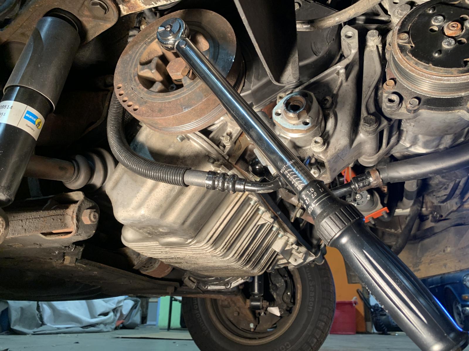

In order to remove the sensor, the bottom gear needs to be removed to pull out the main shaft. A retaining pin needs to be removed in order to release the gear. Spent 15 minutes in vain trying to dislodge this pin with a hammer and punch having it move a measly 1mm and no more. Realizing time is the critical aspect in this repair decide to just purchase the entire distributor, which is about double the cost of just the Hall Sensor and attempt the removal with a better assortment of tools. Test the sensor again to see if it survived all of the blows to the retaining pin. Tell the cashier I just want the Hall sensor and not the entire distributor. They nod their head and ring it up for the price of the sensor, an unexpected gift to say the least.
After getting back to the workspace in the early afternoon, put the distributor in a vice to attempt to dislodge the locating pin with no movement whatsoever. For expediency, break out a sawzall to cut through the center shaft. Install a spare distributor cap to prevent shavings from getting on the magnet/sensor area. Takes 2-3 minutes to cut through the steel and get access to the sensor’s mounting screws. The locating pin on the Eurovan distributor comes off without much effort. Comparing the two sensors, the one from the EVC looks bad visually, a hazy, oxidized coating all over it. Trade the Cabrio’s sensor into the Eurovan’s distributor and bust out the mobile test rig to make sure it is still operational. It is to our relief.
Returning to the EVC in Alex’s driveway, the distributor is reinstalled into the cylinder head, Check and recheck all of the various connectors and wires are back in place. Get behind the wheel, turn the ignition key and the engine roars to life. Feel my shoulders drop and relax, from the lungs a noisy exhale signals a sense of great satisfaction from this victory. Relish in this delicious feeling, although all too briefly. As the engine quietly idles, pack up the various tools and spare parts brought out during the diagnosis and repair phases of this operation. At the same time the Weekender arrives after its 500 mile NorCal camping roadtrip. It did not have any running or driving issues, which while not surprising is a relief to hear. After letting the EVC run for 20 minutes and a short test drive, deem it ready, willing,and able to make the 125 mile trip southward. Now it is time to prepare and pack for the trip to Monterey.

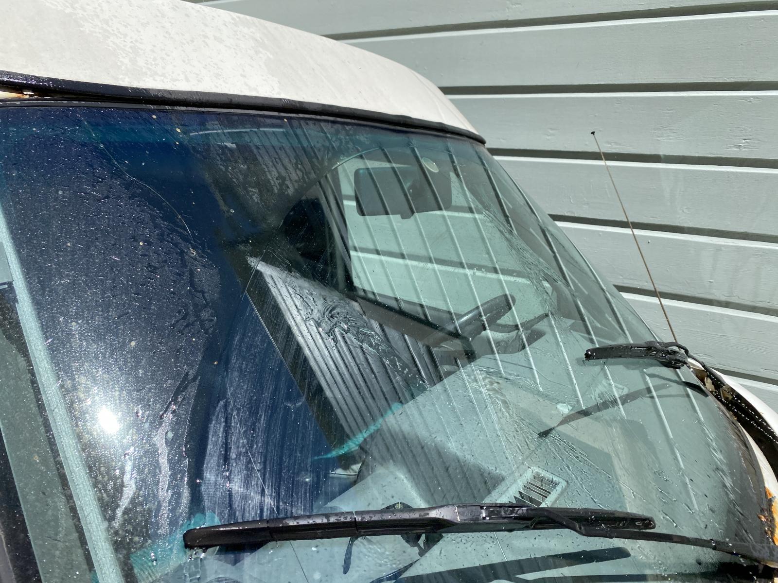

Visibility
While awaking the EVC for the big trip, hit the windshield wipers to clean off an accumulation of dust on the front windscreen. Pull back on the stalk to realize the spray pattern needs to be adjusted as it is hitting all over the windshield and not in the optimal places. With dual nozzles what I do with setting up is to create an overlapping “W” pattern. This equates to the outside nozzle being aimed towards the closest person (driver) and the inner one at the opposite person (passenger). This provides redundancy so each sprayer can project fluid to reach both wiper arms/blades. If one of them becomes clogged for any reason, there still is coverage for the width of the windshield. Adjust the sprayers on the EVC accordingly and now cleaning fluid is not being wasted by being too high or low on the windshield. Check and adjust this on the 1993 Weekender as well.

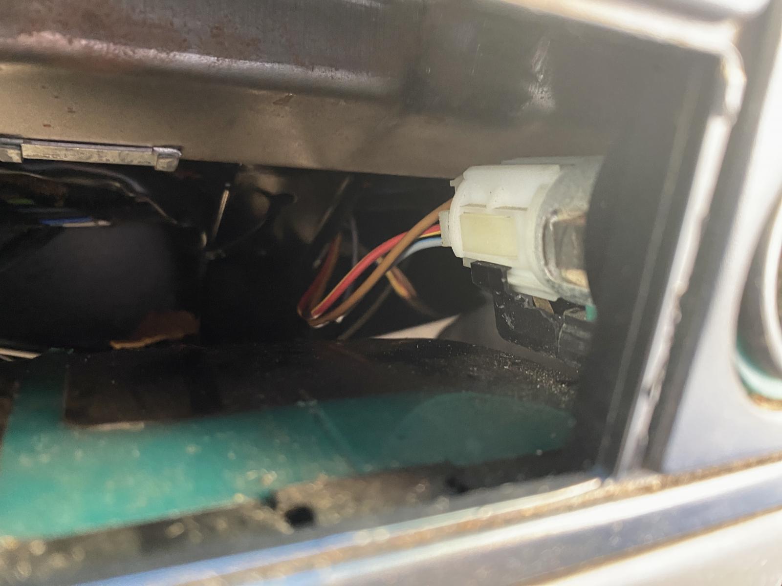

One of the things I notice on the EVC is the bulb for the cigarette lighter is burnt out. Earlier in the year I addressed this on my 1993 Weekender. (https://www.thesamba.com/vw/forum/viewtopic.php?p=10183529#10183529) Since this bulb is not a serviceable item I figured out how to replace it with an LED bulb. After fixing the one in the Weekender, I converted another one of these light fixtures to an LED set up as a spare. This was a simple fix on the EVC, as all I had to do was to remove the old illumination assembly and install the new one. While access is limited because of the internal partitioning of the center dash piece, use a small screwdriver to lever the old one out. Slide the new one into place and the lighter and ashtray are lit up once again.

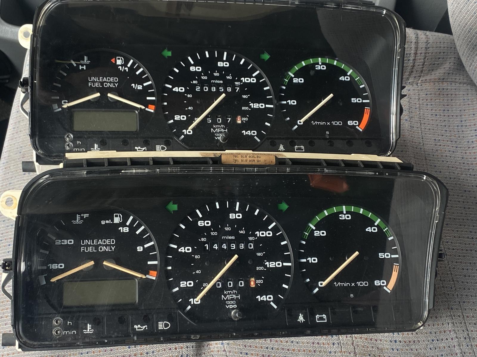

Back at home, inspect the instrument cluster, give it a cleaning and reflow the solder on the joints for the voltage stabilizer. A couple days later install the cluster into the Weekender in order to see if everything works properly. After getting it into place start the engine to let it idle and get to operating temperatures. Oil pressure and coolant lights work as expected as do the gas and temperature gauges.
Reinstall the steering wheel to take it for a test drive. Drive towards the airport and turn around back to home, a 20 mile trip. Everything works as expected, including the odometers as well as the speed sensor for the cruise control. The one thing I do note is the coolant temperature reading. The needle settles out at the same position as in the other cluster, at about 10 o’clock. This is marked at 230°F on the gauge face though this a registering around 190°F on the 52mm gauge mounted in the center dash area. Start to wonder if this might be the reason these faces with degree numbers included were only found in the early production vans. Remove the cluster and reinstall the older one back in its place.

Saturn, do I understand you torqued the crank bolt to 330ft/pd with the DeWalt driver wrench? Does that tool allow torque setting?I didn't see a model that does that. How did you secure the crank while you did this? (Or is that why the timing marks moved?)
I'm getting ready to do this job on the same model, so your response will be helpful.
Thanks
The straightforward answer is no, I am not sure what ft/lbs the crankshaft bolt is torqued to.
This is referencing a post 2.5 years ago covering changing the timing belt, idler pulleys, water pump and serpentine belt in my 1995 EVC ( https://www.thesamba.com/vw/forum/viewtopic.php?p=9897063#9897063). The specification of 330 ft/lbs is beyond my capacity to measure with my tools as my torque wrench only goes up to 75-80 ft/lbs.
In that post I describe the pieces being reassembled along with the torque value listed in the Big Blue Bentley Book. The intent of these values is to include those so its accessible to the reader in the write-up and not have to have a Bentley Book open at the same time.
Reattach and secure the lower timing belt cover then reinstall the harmonic balancer. Install the four and 6mm allen bolts (15 ft/lbs) grab the Dewalt Impact driver, as it makes quick work tightening down the crankshaft bolt (330 ft/lbs.) A breaker bar is braced against the lower suspension arm and the camshaft bolt is torqued (74 ft/lbs) into place. Recheck the tension on the timing belt and then secure the 13mm tension roller nut (10 ft/lbs)
When removing the harmonic balancer, my 1/2" Dewalt impact driver was able to loosen the main bolt with not much effort at the highest setting. While this Speed 3 setting does not equate to a specific torque setting, this is what I used on the crankshaft bolt to loosen and tighten it. What the final torque value turned out to be is unknown, I do believe it is comparable to what it was before removal.
In the above text I reference jamming a breaker bar against the suspension while torquing the camshaft bolt after installing the timing belt on. That was done to prevent the engine from rotating and to obtain an accurate torque reading. An impact drive operates differently, creating a series of quick jolts to loosen a fastener. This quick on/off action tends not to create much rotation on engines with nominal compression. It is times like alternator bolts where parts (fan assembly) may need to be locked to prevent spinning. When using the impact gun on the crankshaft bolt, the engine did start to rotate but not in any significant way.
Abscate
Joined: October 05, 2014
Posts: 24446
Location: NYC/Upstate/ROW
Abscate is offline
PostPosted: Tue Mar 04, 2025 2:09 am    Post subject: Re: Space Capsule 1995: Repairs, Roadtrips, Retrofits, & Wrenching Reply with quote
You can get pretty close as in good enough, on a bolt like that with punch marks. VW wants you to buy a counterhold tool of course.
Source; 55 years experience, punch marks 500+ , loose harmonic balancer nuts 0

After working on addressing this on my 1993 Weekender, my belief is the root issue is an electrical component in the instrument cluster circuit board. Only after swapping the main board out did the blinking coolant light finally extinguish. I do not possess the electrical engineering knowledge and skills to figure out what has either failed or gone way out of spec with that circuit so it stays a mystery.
Right now I am experiencing another issue with my instrument cluster, my temperature and fuel gauges ranging between not registering at all, reading really low and occasionally working normally. It is looking like the issue is in the main harness connection into the instrument cluster. If I reach behind the cluster and press on the main connector sometimes the gauges will come back to life. I plan this in detail in an upcoming post.
During recent crossing of the Bay Bridge into Oakland. These pictures are taken approx. 4 miles and 4 minutes apart while driving highway speeds.
