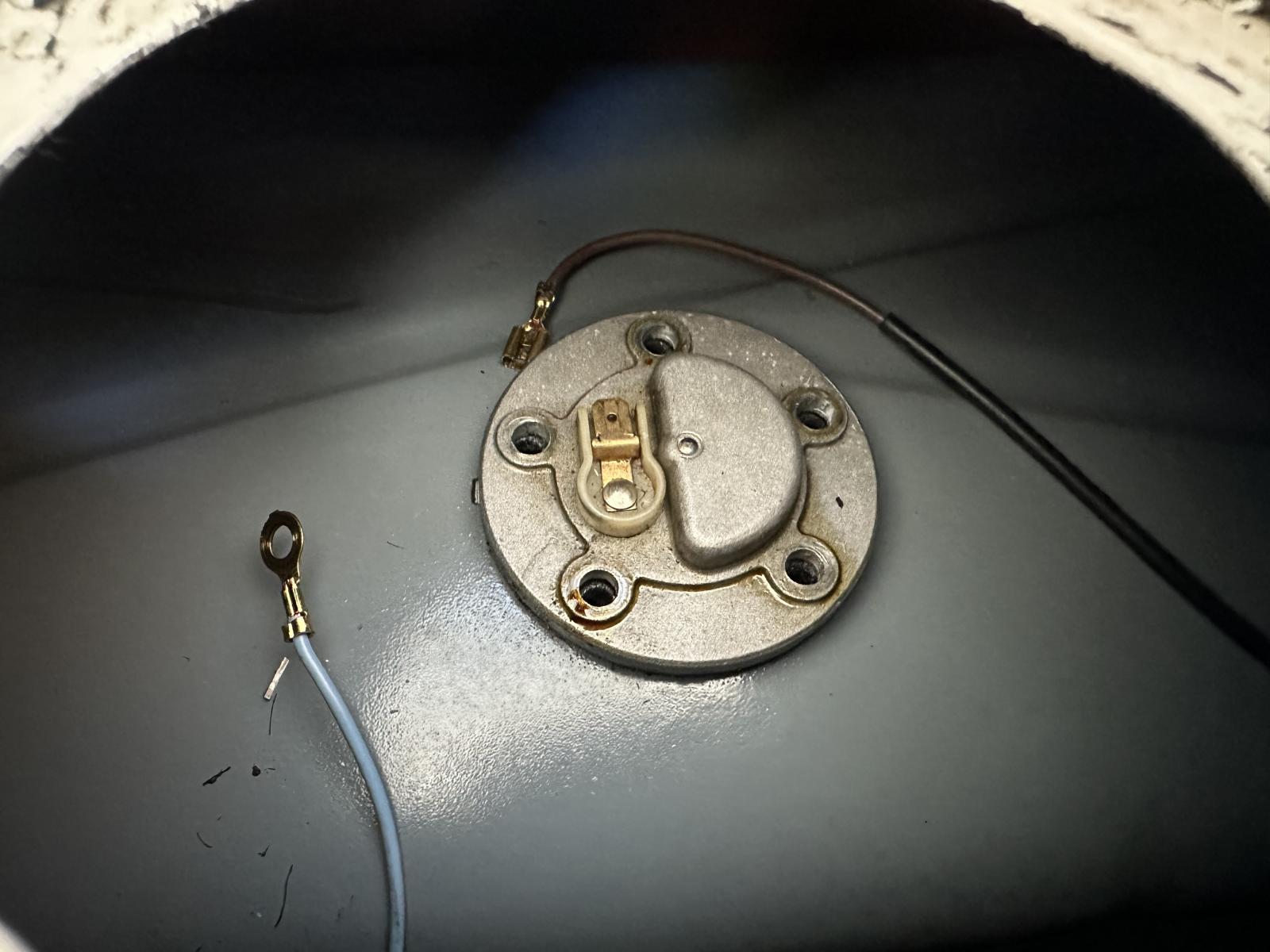

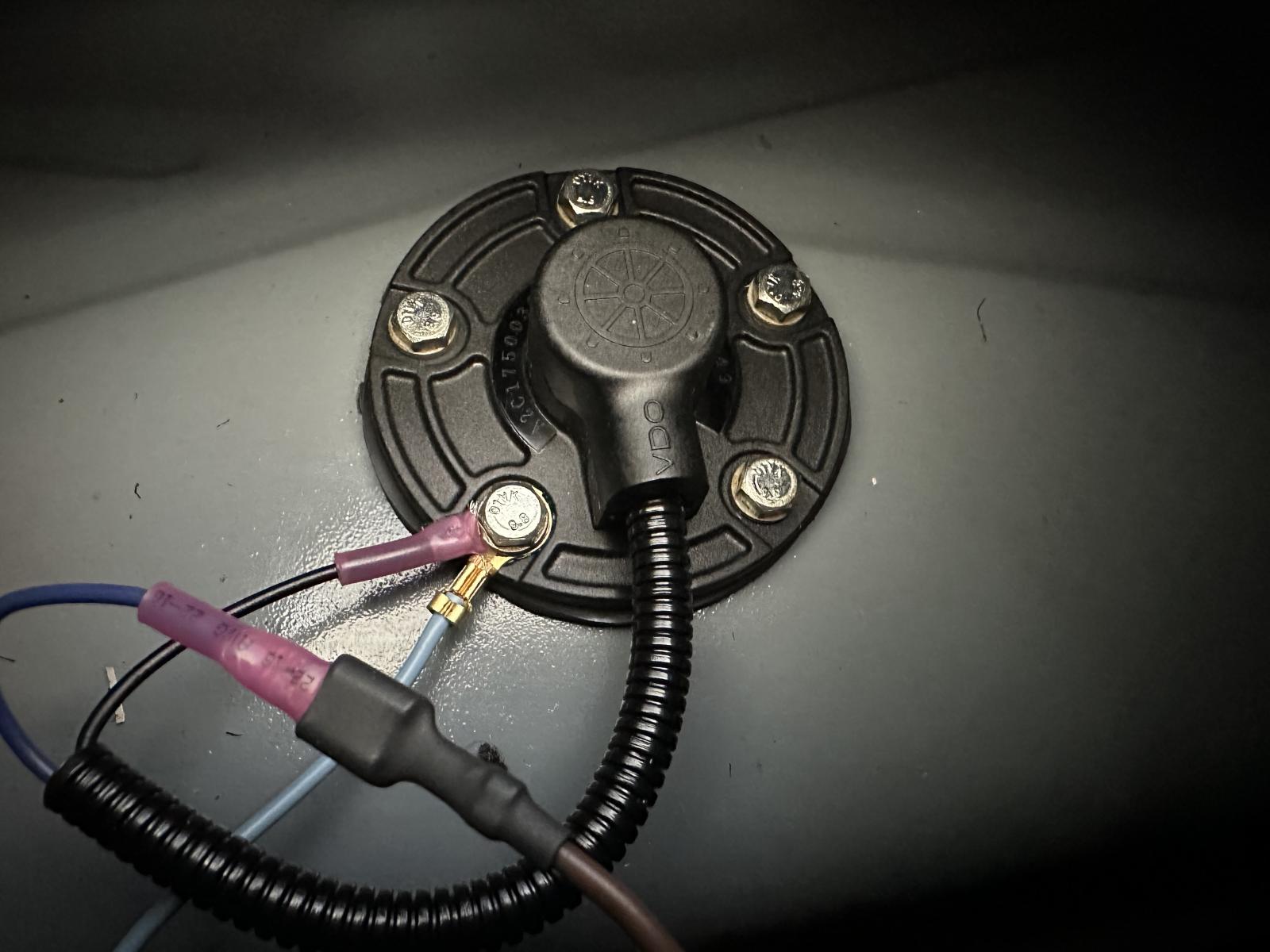

After screwing around with 2 crappy repop senders off and on over the years, I decided to try the recommended Veratron/VDO unit. So far, I'm impressed.
- On the bench, resistance readings are very stable. Resistance reads 4ohms full and 93 ohms empty.
- Extremely well packed (in Switzerland!), and interesting in that there is no locking pin/screw... the float is free from the factory.
- Mechanically it seems identical to the stock bus sender. FWIW I only used 1 of the 2 gaskets... seems like the second one is intended to go inside a tank that does not have threaded inserts.
- I chopped the 2-pin connector to adapt to stock bus wiring harness
- I used this with an electronic gauge calibrator instead of a pot (https://spiyda.com/fuel-gauge-wizard-mk3.html). This unit has a preset for this sender, so no additional cal required.
- As you can see in the photos, I had the luxury (and curse) of an access hole cut by a PO, so installation was a snap.
- Only 1 day of operation so far, but a trip to the gas station moved the needle from 1/2 to FULL, which I have never ever seen on my bus.
- I ordered here: https://www.freeportmarine.com/products/veratron-d...3275329836 . Took about a month to get, but vender communication was excellent and item was extremely well packed.

PostPosted: Tue Aug 12, 2025 12:25 am    Post subject: Re: Great alternative to the poorly made aftermarket fuel senders Reply with quote
No resistor in circuit as others mentioned? Or is that what the Spiyda is about .
I have one of these as well and have just been waiting for my rebuilt gas gauge to arrive to test it.

PostPosted: Tue Aug 12, 2025 12:49 am    Post subject: Re: Great alternative to the poorly made aftermarket fuel senders Reply with quote
That's what the Spiyda's about... it sits between the gauge and sender and lets you (1) pick any sender and (2) set your gauge needle to read full and empty (and some intermediate points to account for weird tank shapes).
