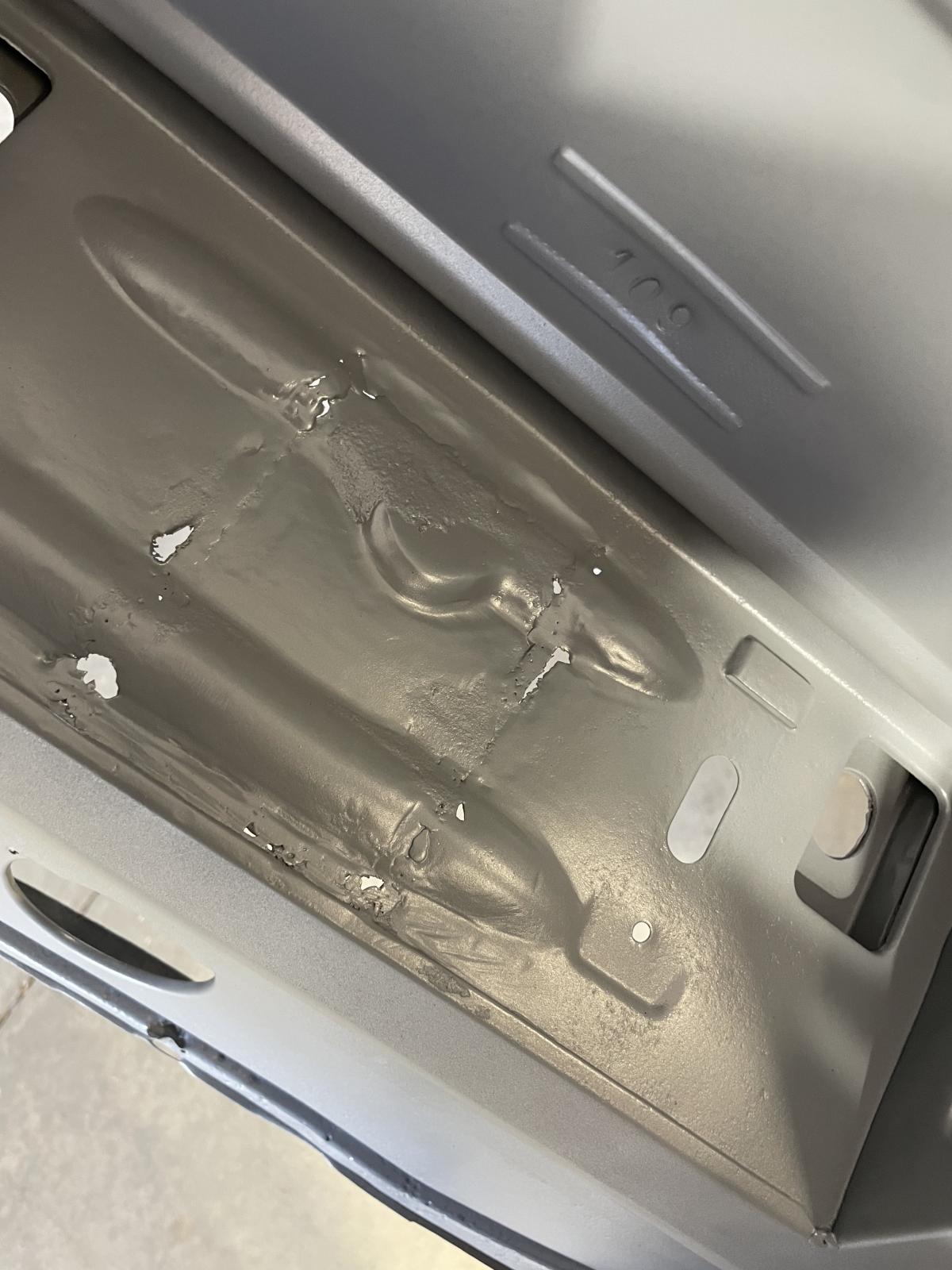

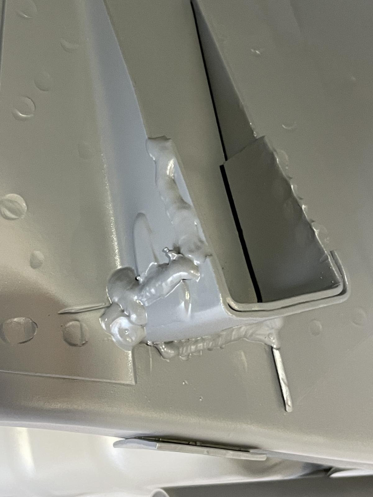

I think you be pleased with how nice this one will return. It will in fact be sealed inside and out. American Stripping does the job like no other outfit I have seen or used and I have used a lot. Their slogan is “ Start with the best finish “ Stay tuned to see the results when it returns.
Here are a few examples of what you cha expect

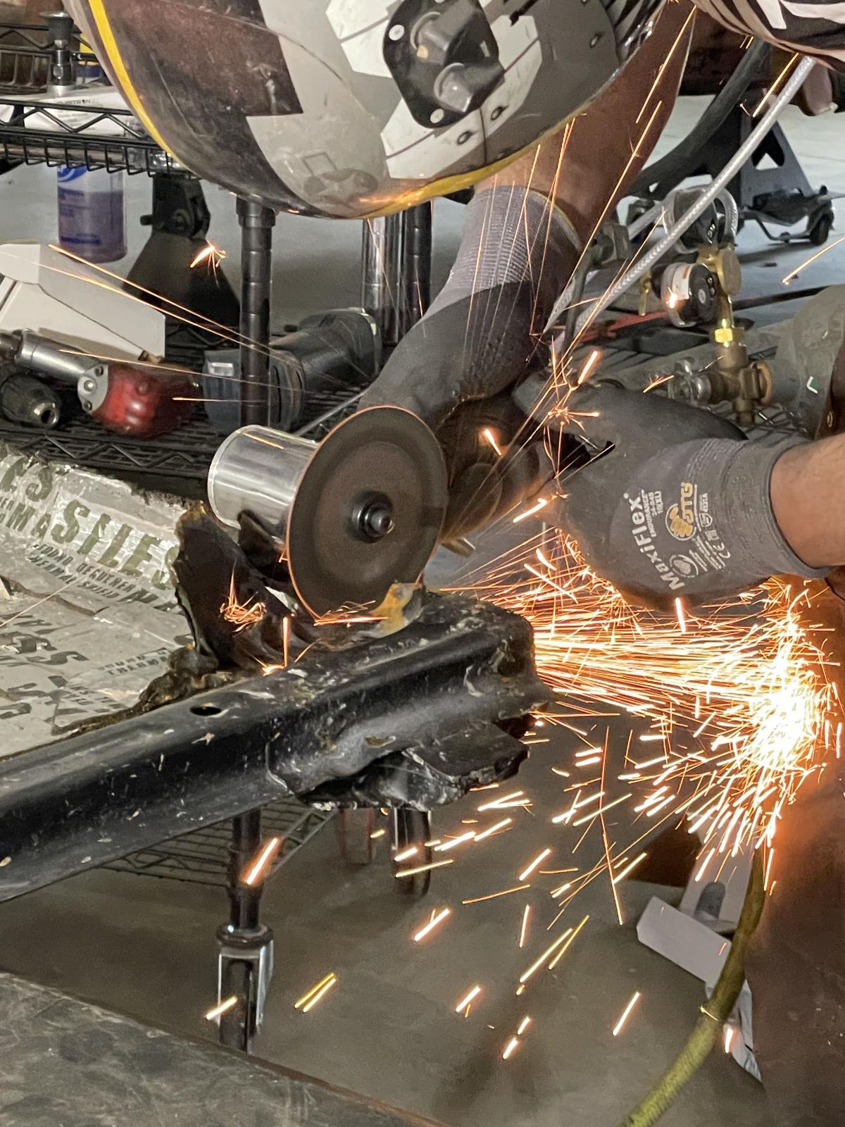

Started removing the old pans halves, larger Mig welds are so much more difficult then factory spot welds. At first we tried air hammering the halves
off the traditional way but no luck. My son had to painstakingly grind away each plug weld. He did a killer job.

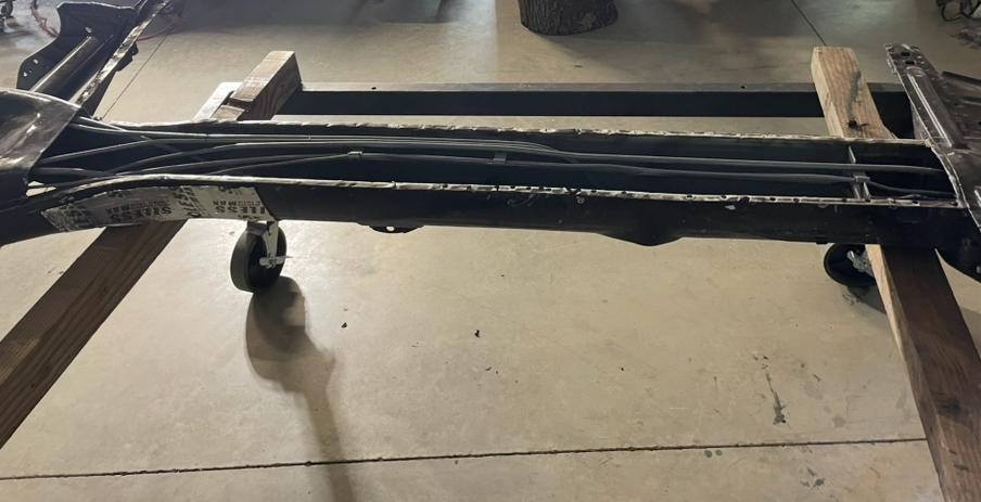

We continue to discover issues with the chassis. After looking close at the underside I saw that the cap was removed from the tunnel by cutting it off in the field away from the spot welds. We cut it off and found the fuel line just floating inside. I think it safe to safe that when it was welded back on this is when the big twist happened. We also removed the jack points in preparation to use them on the new pans.

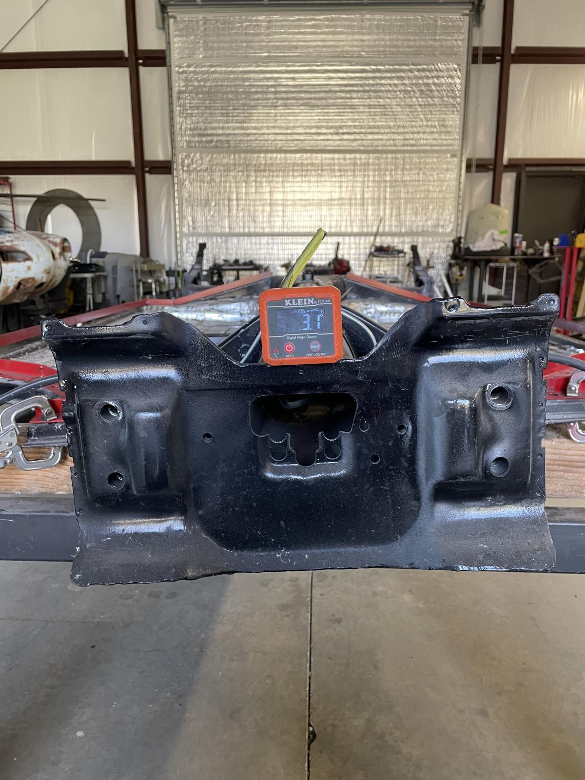

I’m going to get real technical with this chassis. I have a Strong Hand Tools 4x8 modular fab table that is designed to handle jobs like this. Using the table and accessories with the modular layout I will be able to pin it down accurately so we can begin to reconstruct it.
I have a donor pan that I’m going to carefully remove the tunnel cap from so we have a proper replacement. I will also be replacing the fuel line and reinforcing the clutch tube in multiple places.

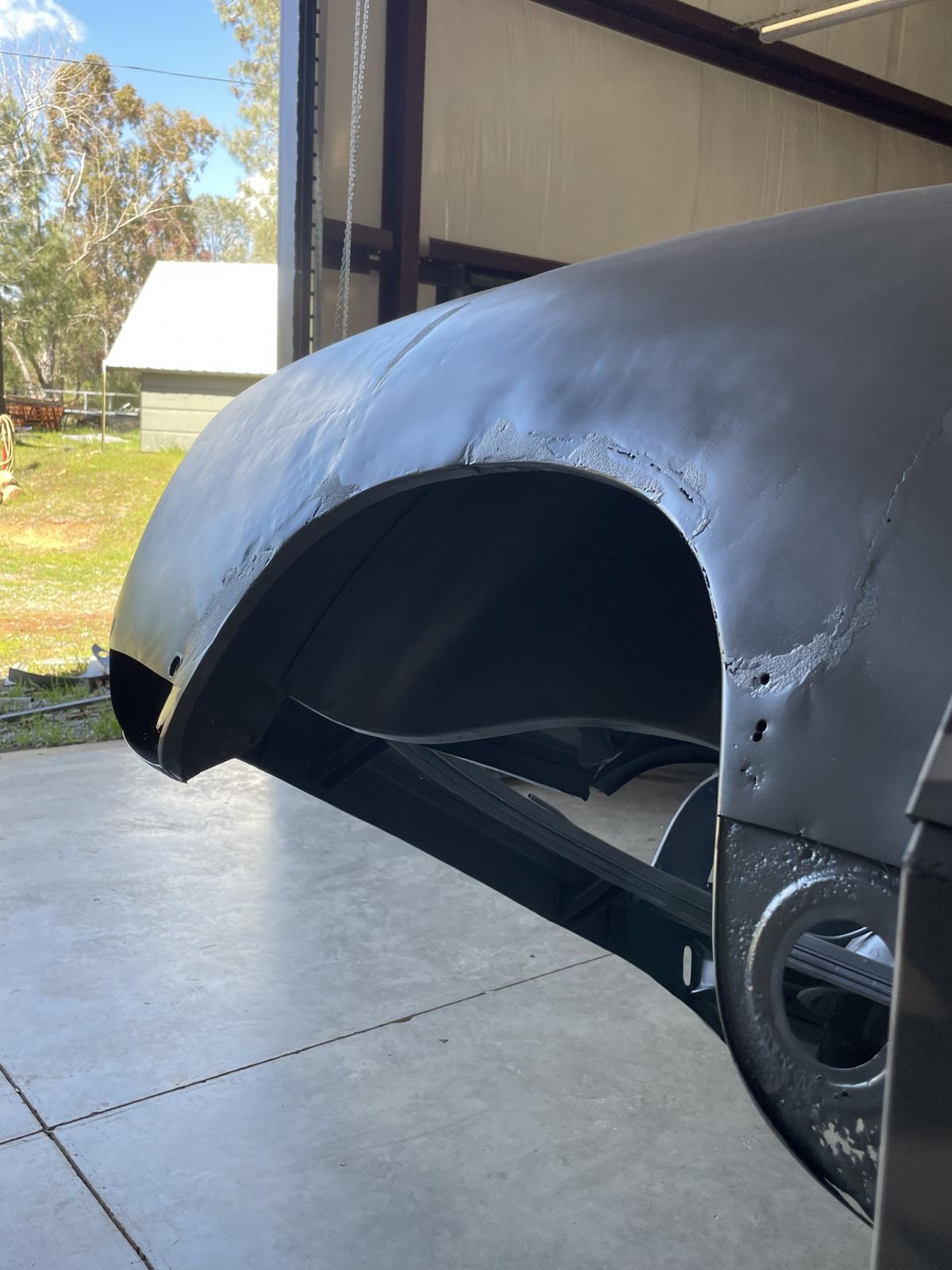

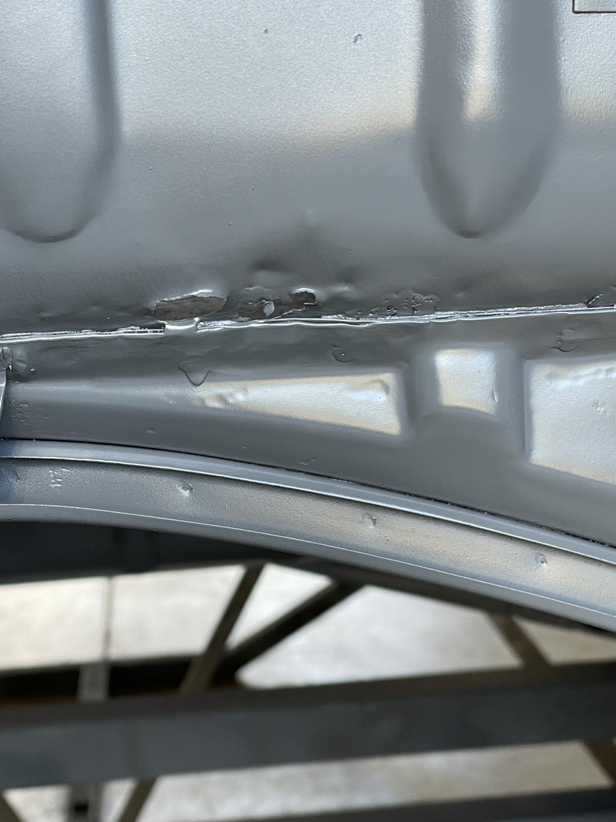

Wow! That is going to require a lot of repair work. I can't believe how lumpy the body panels look. It's going to be great to see this car put back together.

Talking with the guys today at American Stripping we both agreed that the body and the removables must have been previously blasted and unfortunately some of what we see here is warping from the heat of the sand. If extra care is not taken on a VW the sheet metal can warp fairly easy. I have seen this in my early days trying to go to the cheapest guy in the market.

Dang, someone did that car dirty! That's alot to unfold... but you got it brother man!
