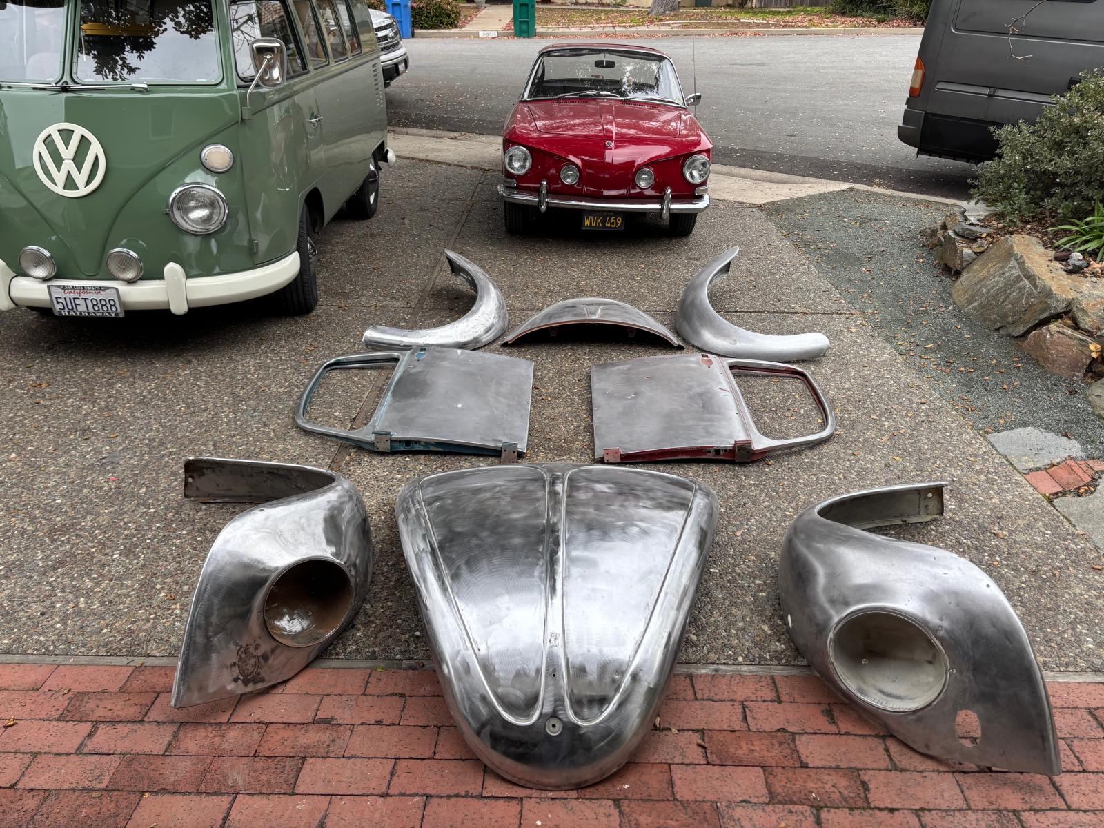

Well, I'm moving past the buying parts phase, and into he getting stuff done on the 66 1200a. I've got most of the paint off and am starting body work. The plan is to get these parts cleaned up and get as many dents out as I can. They aren't too bad. Then get the new front apron and same other welding done. Then a light sandblast to get the paint off the areas I couldn't get to with the DA or sander. Plus remove any surface rust that might appear in the next few weeks.
Then a good coat of epoxy primer on everything.
