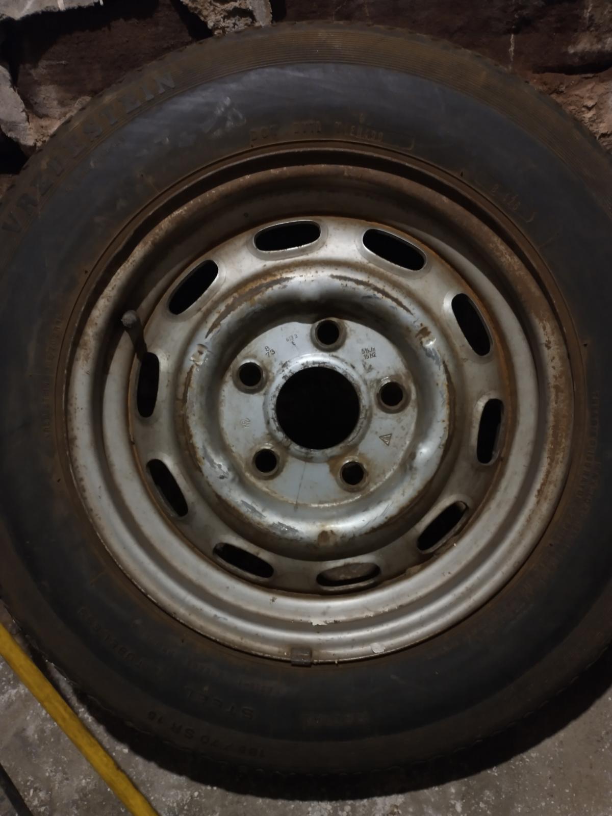

Did you ever find a wheel? I am in the same situation, have a '63 bug that was converted to Porsche brakes but I want stock looking wheels. So far the only option I've come up with is the 944 turbo spare, but they are hard to find.

Currently I am using some 944 phone dials, but when I want the hubcap look I ended up using wide 5 rims and these adapters.

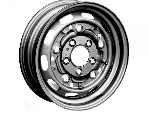

The latest iteration of the Mobelwagen interceptor is the closest I've seen to what you've described, but the circle is 5x112. I think that's outside of the range of the wobble nuts people sometimes use to interchange 112 and 114.3 PCDs.

It's too bad none of that series of wheel have a round center bore, because their 4x130 variation would be better suited to a fill & drill modification, since one of the holes would already be in the right place.
Another thought that would be much easier if it looks okay:

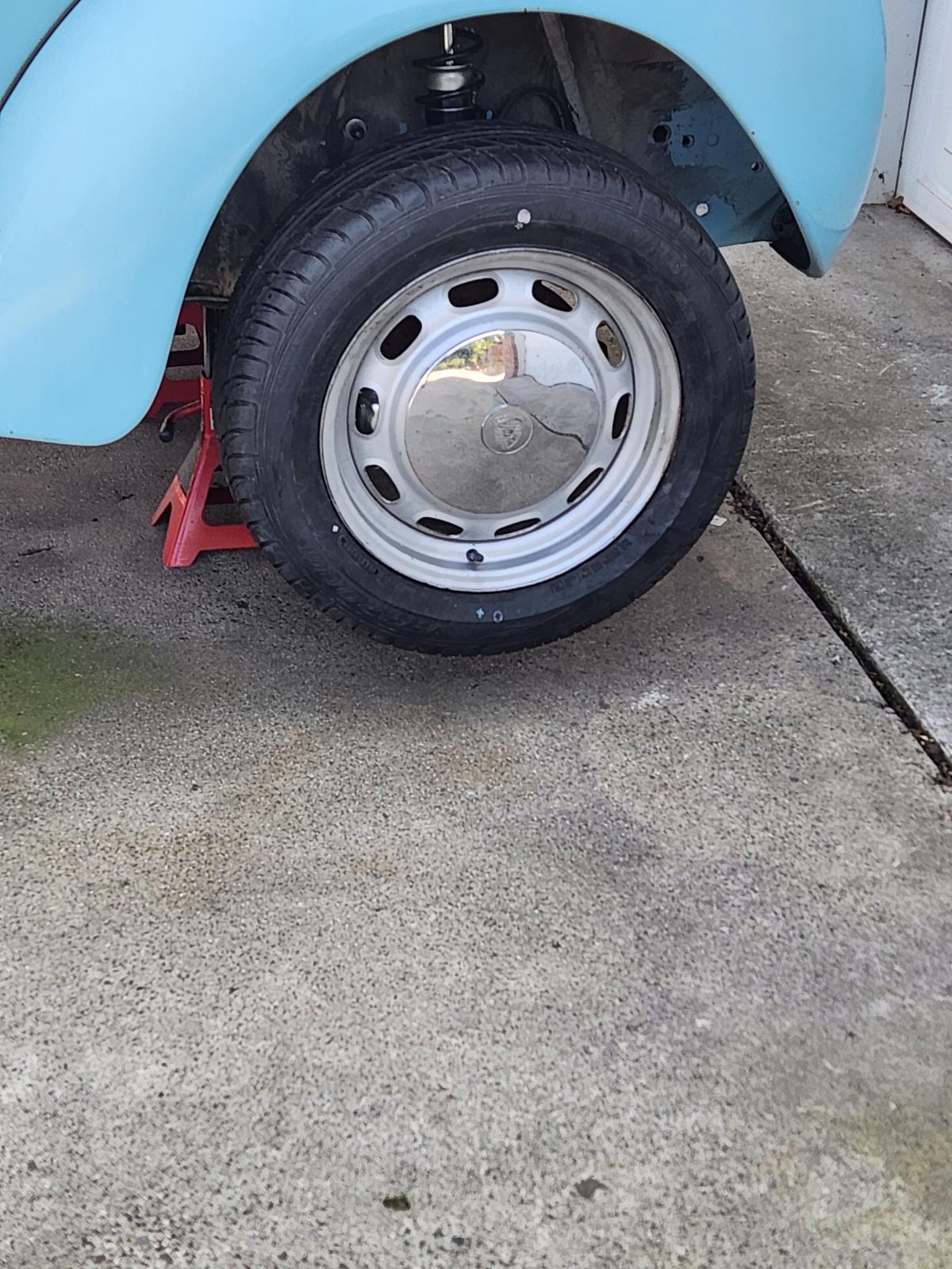

Drilling and installing the early hubcap clips on a 5x130 steel wheel. You could see how it would sit by just placing an early hubcap on top of the wheel laying on the floor. I don't have any early hubcaps, otherwise I'd do it myself. If the edges of the hubcap don't play well visually with the vents in the wheel, you could disguise that with one of the period beauty rings that are retained by the hubcap. Alternatively, you could paint the vented section black to downplay the vents (which aren't bad to have after all.
I have a set of early '70s 5.5x15 911 steel wheels for my Super Beetle project, but I'll be using the stock hubcaps because they look close enough to late Beetle caps. I've kept an eye out for them for a while and paid from $60-$100 per wheel.

4x130 redrill to 5x130 would be ideal, or even drill in between the 5 lug vanagon rims... those are 16x7, by the way. The bigger ones would be even better for my build, that's the same size as the Porsche rims that I have on there now.
I considered trying exactly that with Porsche steelies, but as you said it just doesn't look right.

Those/ these wheels don't look bad someone should do repops of them...
