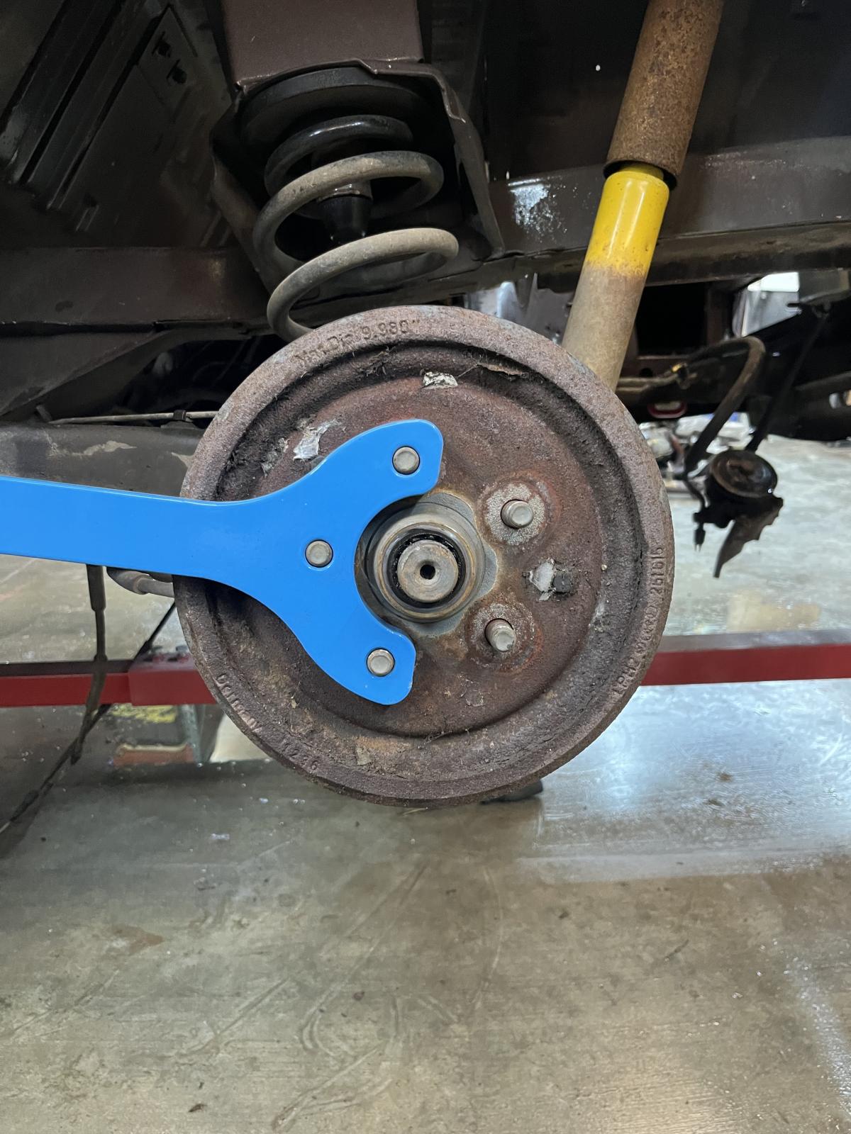

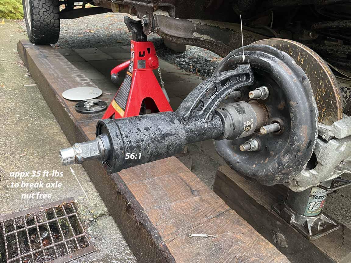

56:1 torque multiplier to loosen the 46mm rear axle nut.
The torque multiplier cost $65 and the 46mm socket was ~ $22
And I had an old 14" wheel that I cut out the center.
Then cut a square hole to engage the torque multiplier's anti-rotation 'foot'.
I also welded a 3/8" socket onto it so I could put a torque wrench on this tool.
At 30ft-lbs it did not break loose.
I increased the torque wrench click-setting to 35ft lbs and the nut broke loose somewhere below 35 ft-lbs (it didn't click).
Incidentally..... 35ft-lbs x 56 = 1960 ft-lbs but I doubt it was outputting 1960 ft-lbs.
Wild guess that the gear-losses are significant, like 50% so maybe it was outputting 1,000ft-lbs (?????wild guess)
The gears inside the $65 tool are all cast steel (and rough).
Note that you only have to anchor the hub to withstand the "35 ft-lbs" input because the 1,000 ft-lbs (???) is all internal to the tool & wheel-plate.
So all you need to do is put the transmission 'in gear'.
It was "easy" with this tool.
35 ft-lbs is ~ 1/3 of lugnut torque.
The torque multiplier cost $65 and the 46mm socket was ~ $15.

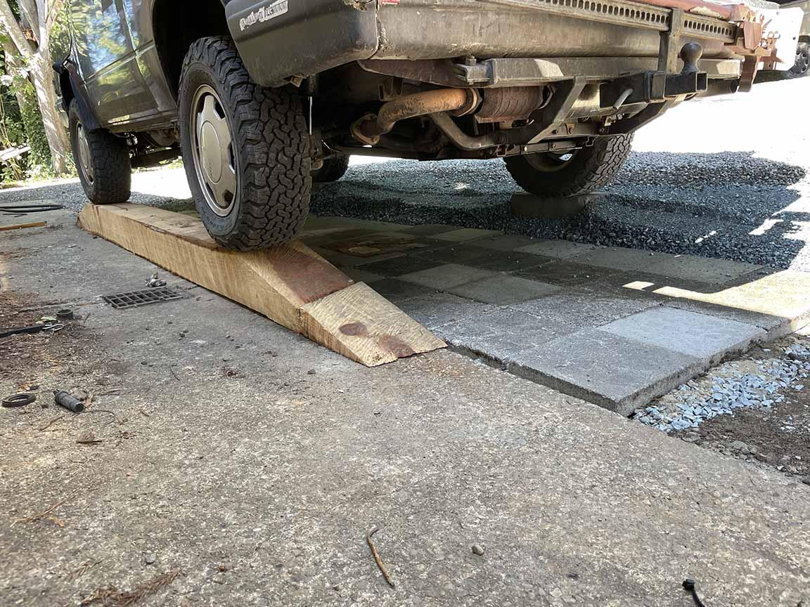

I hope you blocked the tires that are on the ground, the one shown is not.
I am really big on blocking tires when raising the car. Nearly killed by an accident on a raised vehicle, never again!!!! Triple or more safety redundancy for me.

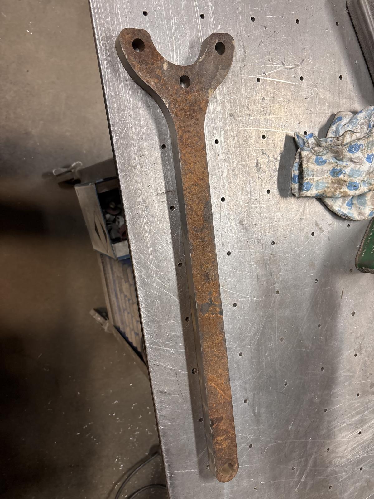

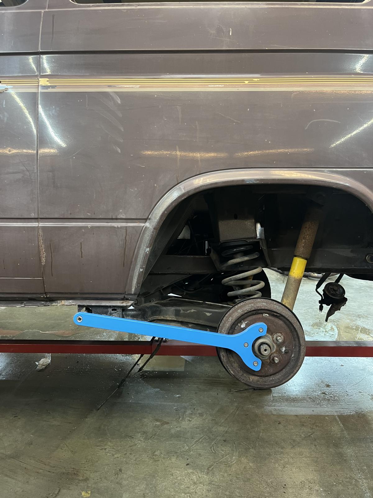

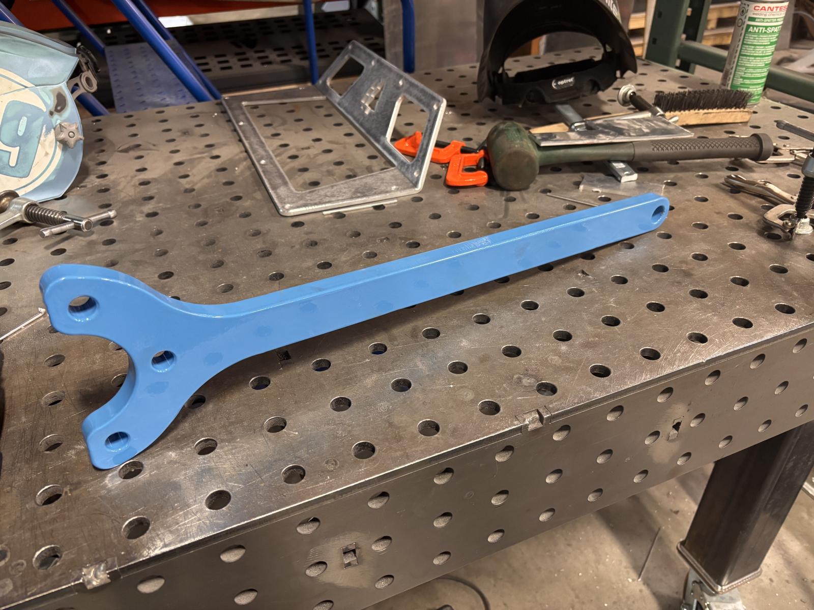

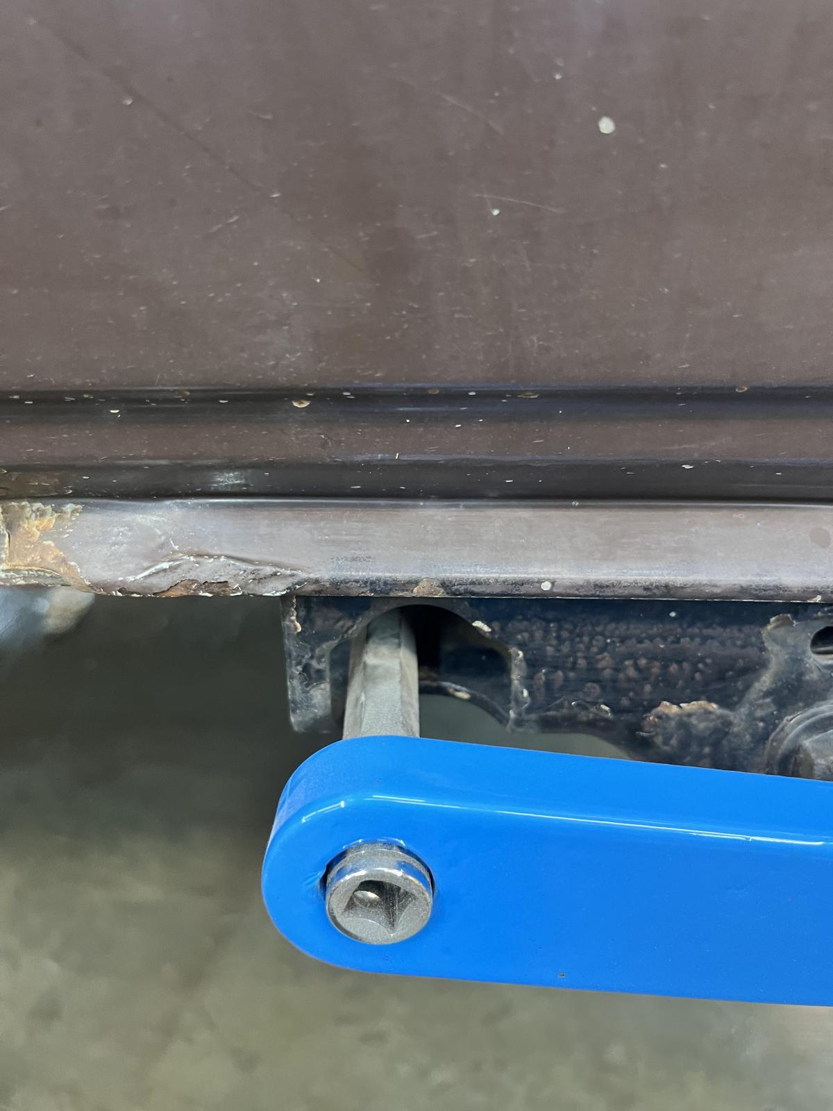

Tom, you made me post this…
Reaction arm , 3/4” steel, powder coated. Can brace against the ground or be pinned to rear jacking point
Luxury indeed, when you want to use breaker bar and cheater instead of the impact gun… ha!

That’s supercool Ragnar. Integrated design!

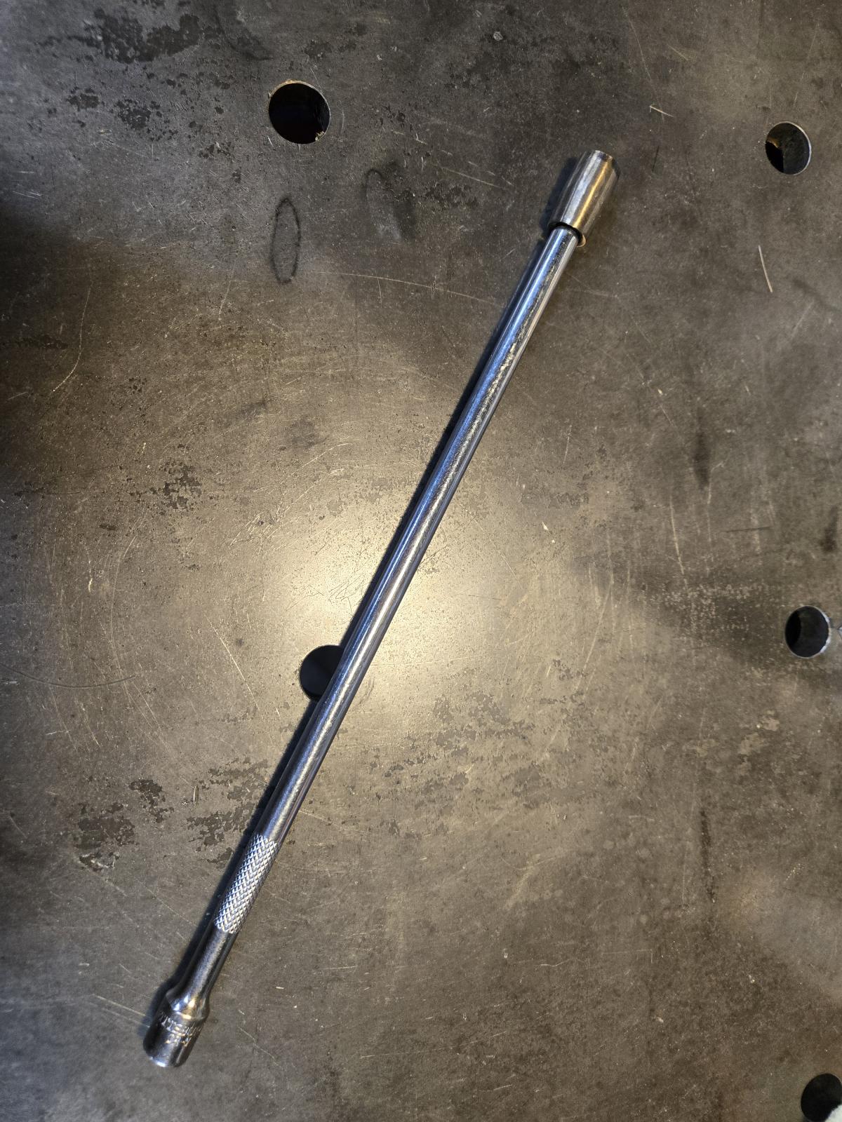

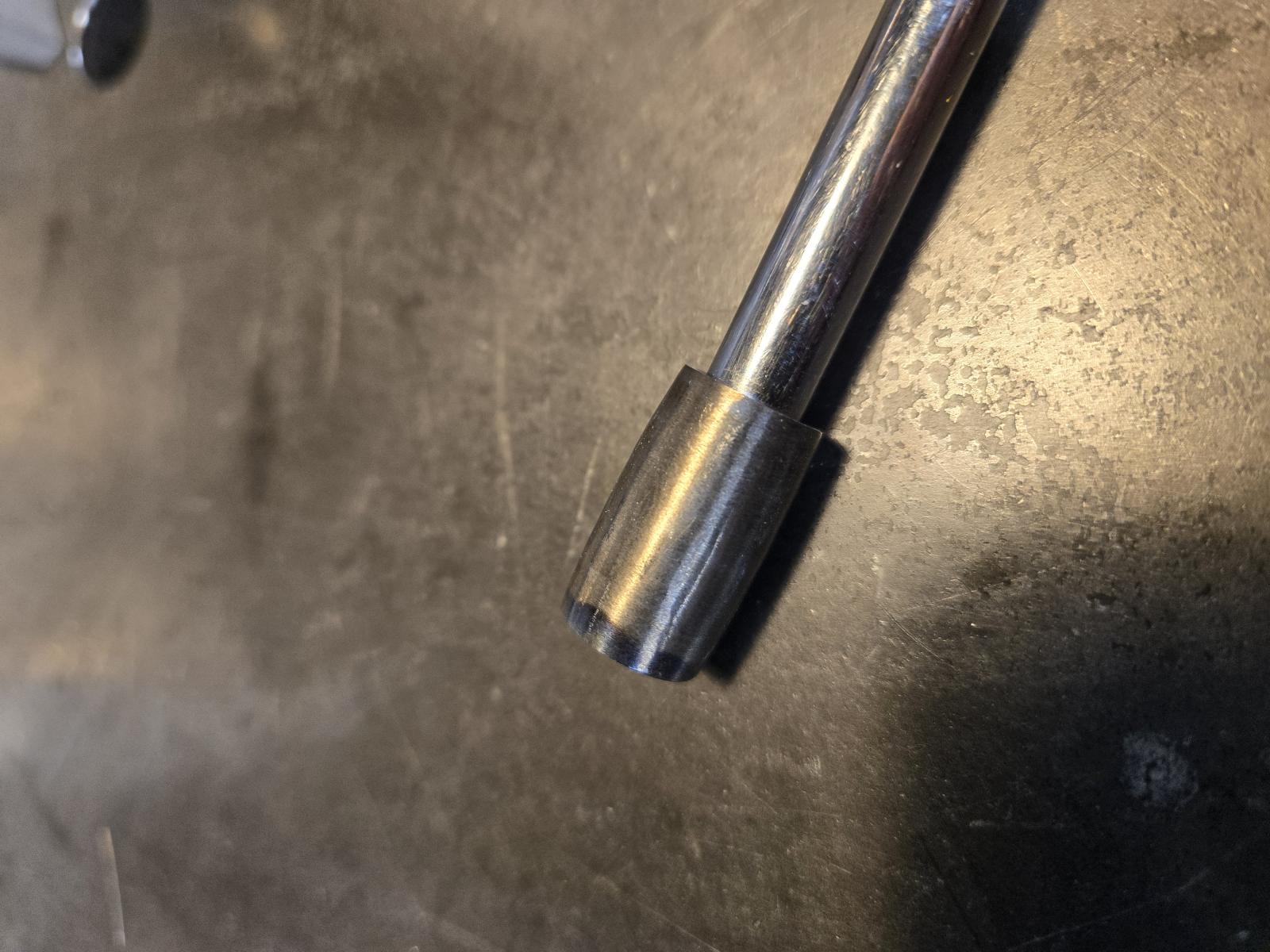

On inline swaps when using the factory diesel oil pan, you have to line up the flywheel to the clearance holes in the bellhousing to tighten two of the many oil pan bolts. The clearance is tight and when you're running a DMF, say for a TDI, the clearance gets even tighter as the flywheel is larger. 1/4" tools dont really fit and if you do manage to fit an extension and socket in there, the socket pops off when you try and retract it and you have to fish it out with profanities and surgeon tools. Remember the game operation?
Enter the captured 10mm thin socket wobble extendo tool!
I took a cheap HF wobble extension, welded an M4 screw to the end of it, slipped the socket over top, then threaded and welded the nut on, retaining the wobble feature.
A wholesome grind with the belt sander thins the 10mm socket down and the barrel shape guides it in and out. Oh baby!
I wouldn't want to put much torque on this thin wall socket, but for 7ft-lbs diesel pan bolts it's great!
neat tool and solution..
not to diminish it but to add for others...
we change those bolts out to an Allen head and use a Loong allen socket.
they don't take much torque. might use a star lock washer too. I can't recall though.

Of course! Never even crossed my mind! Time to go buy some long hex extensions.

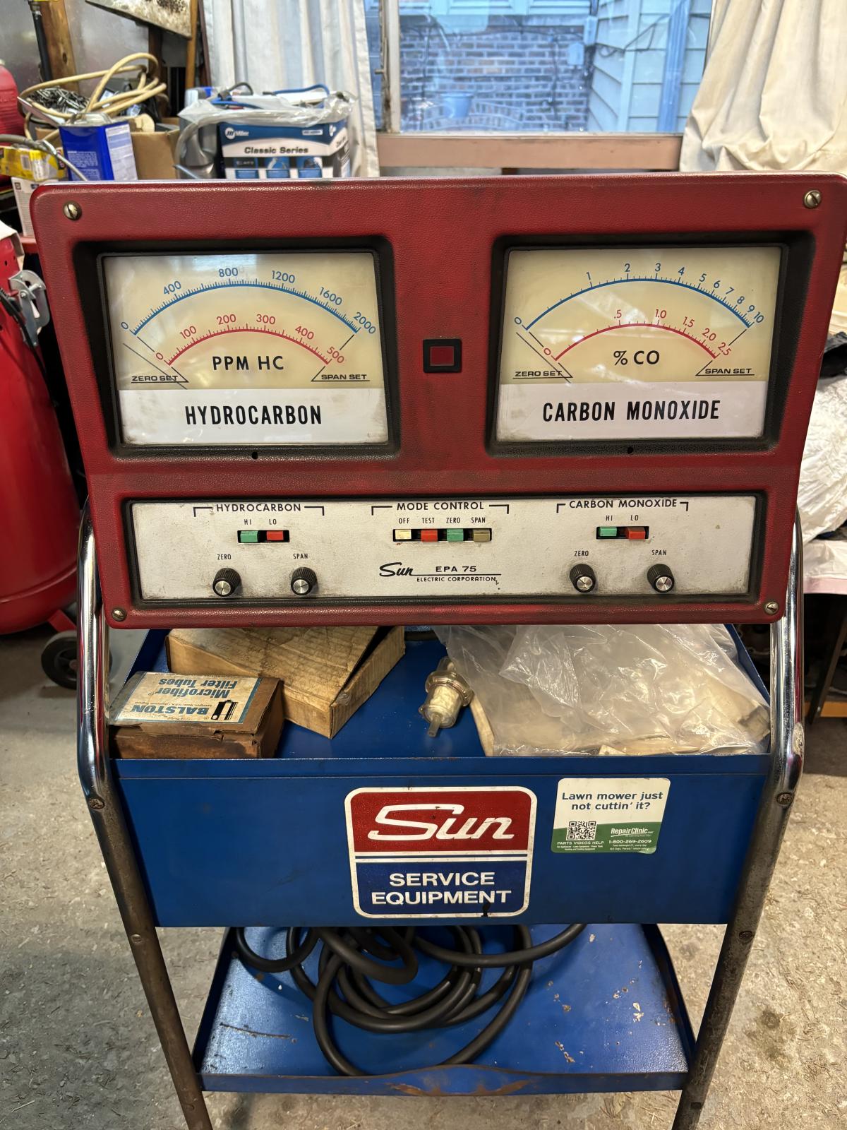

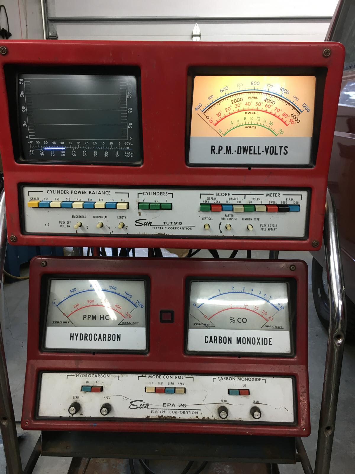

Newly purchased Sun Exhaust Gas tester, simpler 2 gas versus the 4 gas versions. Smaller footprint instead of being part of a massive rolling console like so many shops had years ago.
I have spare filters for it, and even have the Canister of Calibration Gas that I got from another shop some years ago who had no idea what it was for... Laughing Laughing Rolling Eyes Rolling Eyes
One illumination bulb is out, but so far that's all I've found wrong with it. Pump works, gauges work- will start dialing it in sometime soon.

PostPosted: Thu Apr 17, 2025 7:26 am    Post subject: Re: Luxury Tools Reply with quote
I have one of those, but have not used it in some time. It takes about 15 minutes to warm up and stabilize. Otherwise the readings are inaccurate. The internal hoses will require periodic replacement.
To use it on most USA VWs, after 1979 models, it is necessary to use the OE port in the exhaust that is in front of the CAT. Those are usually rusted and difficult to open. Sometimes heating it up red hot will free it.

PostPosted: Thu Apr 17, 2025 7:47 am    Post subject: Re: Luxury Tools Reply with quote
i've got the EPA 75 as well, but it needs a total rebuild. all hoses rotted. the CO sensing light sensor is unobtanium but dunno if mine works.
the scope works nice! refurbished that and it came out well.
Yes, well aware of the warm up time. I started using these in the 80s, although the internal parts were younger back then.... Laughing Laughing Wink Wink
As for my own exhaust port on our Vanagon. I keep it freed up with Copper Anti-seize. So no worries there.

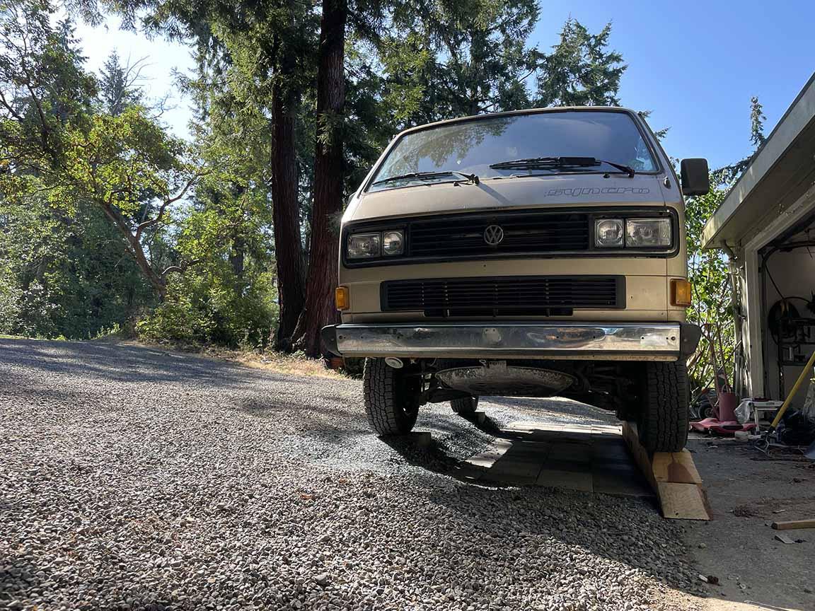

Sodo wrote:
I love your simple 'car lift' there! Im curious as to why you only have one side(or maybe I just can't see the other side)...Im going to measure all my vehicles track widths to see what kind of range I would need to accommodate something similar for our rigs.

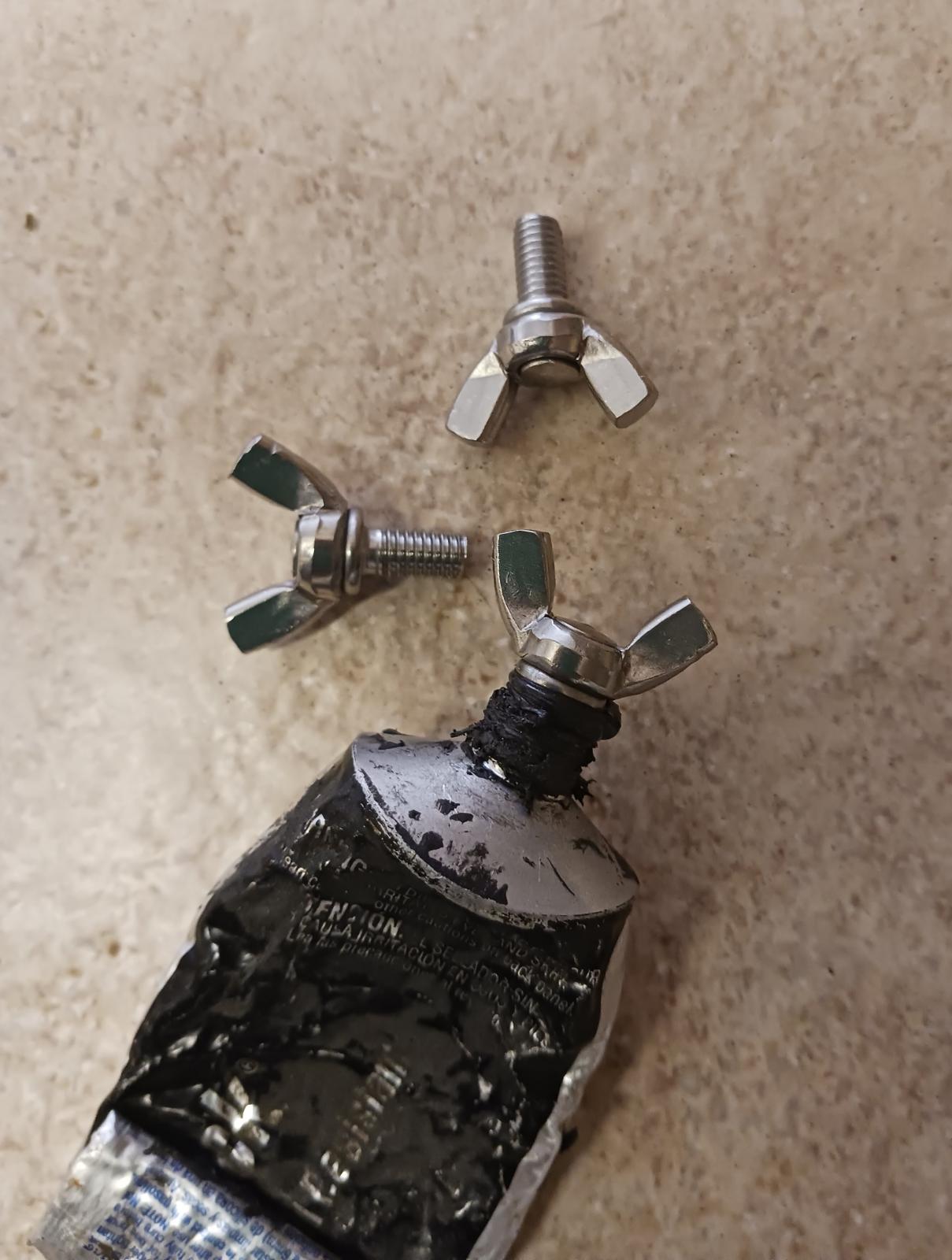

1/4" or 6mm wing screws. No more wasting half a tube of silicone because the cap decides to crack on you.

Dan, The Sun tester with the scope and tach-dwell-volts, was a VW dealer tool. That was long ago. It was packaged in a different box with another brand on it. When those things worked they could be some help.
Of course it is just combining several instruments in one box. Biggest problem was the clamp leads for the ignition wires would malfunction. Then all the readings were incorrect. Had to call their repair service which took a long time to show up.
Many of the mechanics had the 'old school' tach-dwell-volt-ohm multi-meter and a separate timing light.
Those were pulled out a lot.
Later in the 1980s, several companies were selling a similar "does it all" analyzer it also had a amp function for testing starters and alternators.
The sales people kept pushing me to buy one, but it did not work very well and its recommended test procedure was time consuming. We had a Sun VAT 40 that did the job better.
I'M GONNA TRY THAT !! Is there a plastic plug that silicone won't stick to, that you can insert? The cap itself could be molded with a plug/insert.
I guess you could consider this a "luxury tool" to those who have to work on sloped ground.
I cut the "9x10"with a chainsaw, from a tree onsite.
You can see this log-section I had....barely accommodates the 96" wheelbase.
The two uphill wheels are on concrete pads. I screwed 18" lag bolts into the earth, leveled.
Then 'formed' the concrete pads to the top of the bolt-heads.
Higher level of luxury would be a (clear-floor ! ) garage that I can drive into without removing the cargo racks.
