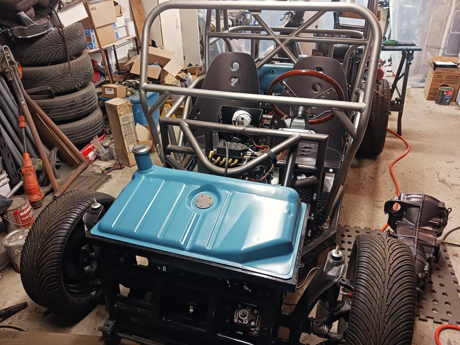

PostPosted: Thu Jul 24, 2025 6:53 pm    Post subject: Re: Low down Hillbilly Reply with quote
All of the recently shown parts have been sealed with high solids black primer, sanded where necessary and this round of silver is officially done. I'll likely follow up with another coat of clear when Jon at the paint store gets back from holiday next week. Soon to follow will be the first coat of Dove blue on the air + fuel tanks and rear body support ring. I've got new mounts and output flange seals, clutch/pressure plate/TO bearing on order to keep things leak free and reliable after the install.

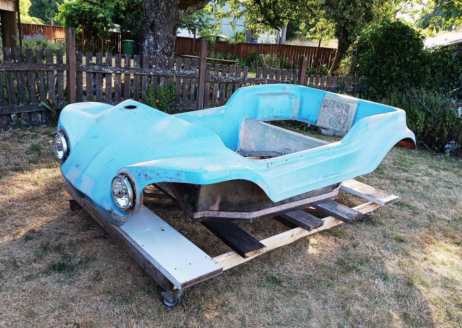

Today I made a 4 wheeled cart to store the body and roll cage when the car is not assembled. I needed a platform to paint the cage, so this will double as workspace while I finish other parts of the build.

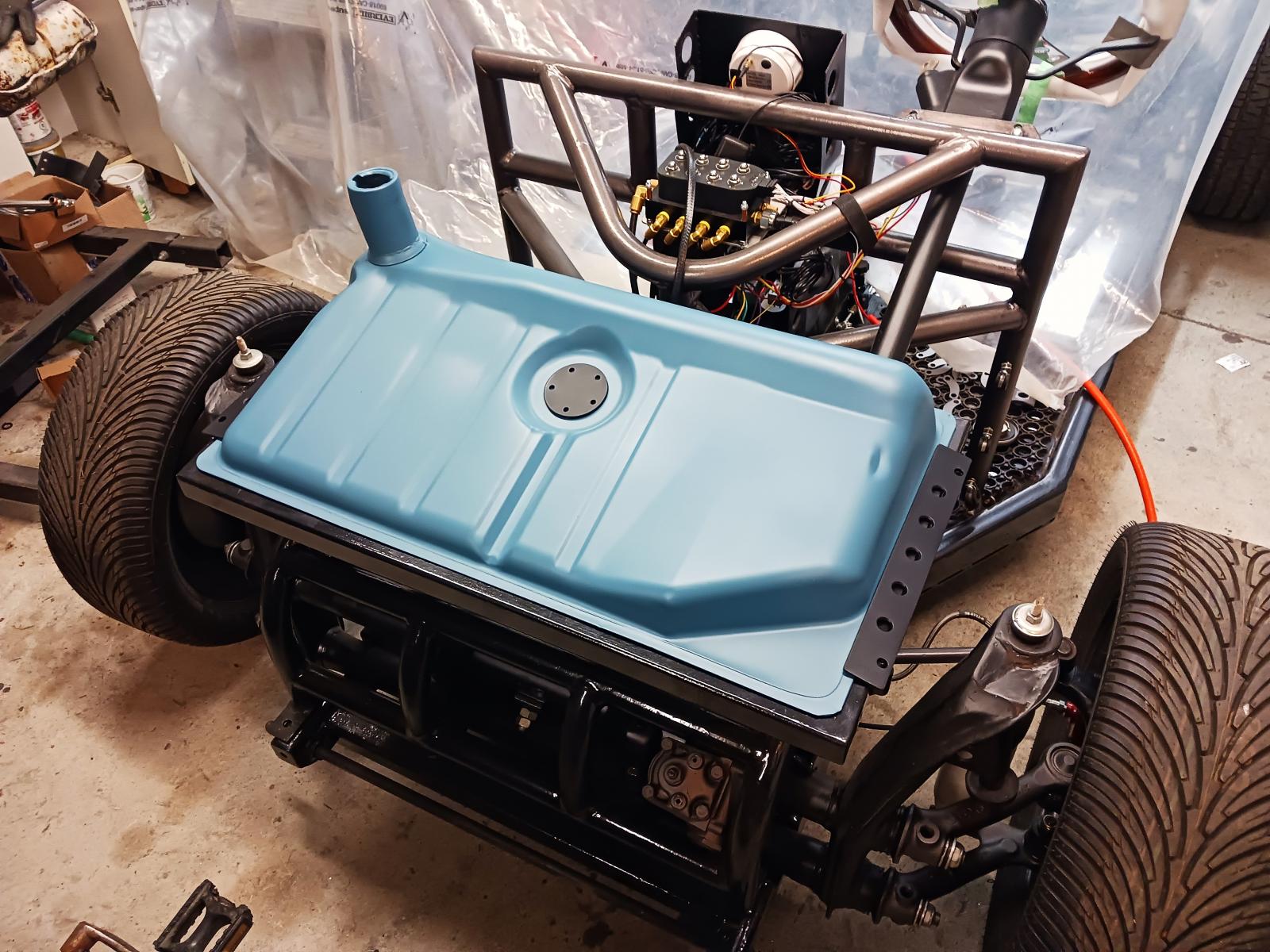

I shot the tanks with another coat of base to see if it would darken a bit as suggested by my paint guy, but in the end it looked the same to me. I'm not unhappy with the varience in colour, so I decided to matte clear it anyway and move forward. Although this mix of Dove Blue is little brighter than expected, it does fall in the middle between the original body gel coat and what I had envisioned.

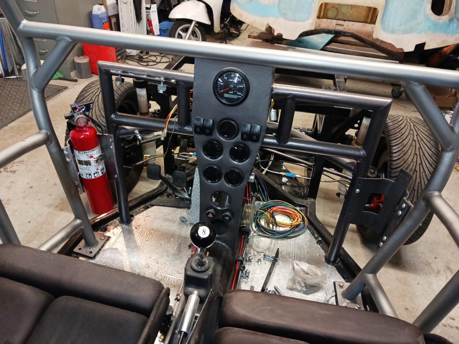

After some ocean-side camping in August, I'm back in the workshop and have managed to get the seat belt loops for the cage done, along with the driver's side extinguisher bracket. The lower seat belt mounts will also be receiving additional work, afterwhich the cage will be ready for paint.
