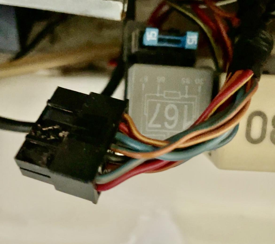

PostPosted: Sun Jun 29, 2025 1:04 pm    Post subject: Re: Official Mexican / Brazilian Beetles - All years Reply with quote
Antonio said its a special order part from Clarion...but it would cost me more than the stereo to get it...guess I'm going to have to just replace it with a more modern set.

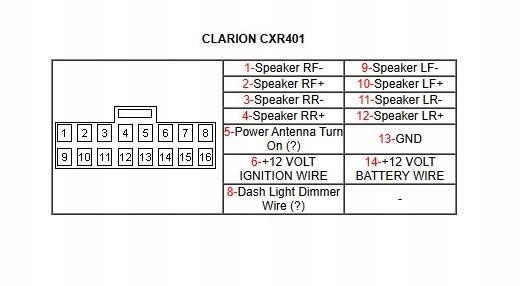

so anyone know what the wire codes are for this?
New radio has black, white, green, yellow...normal colors but the Mexi beetle has pinks, browns, pastels.

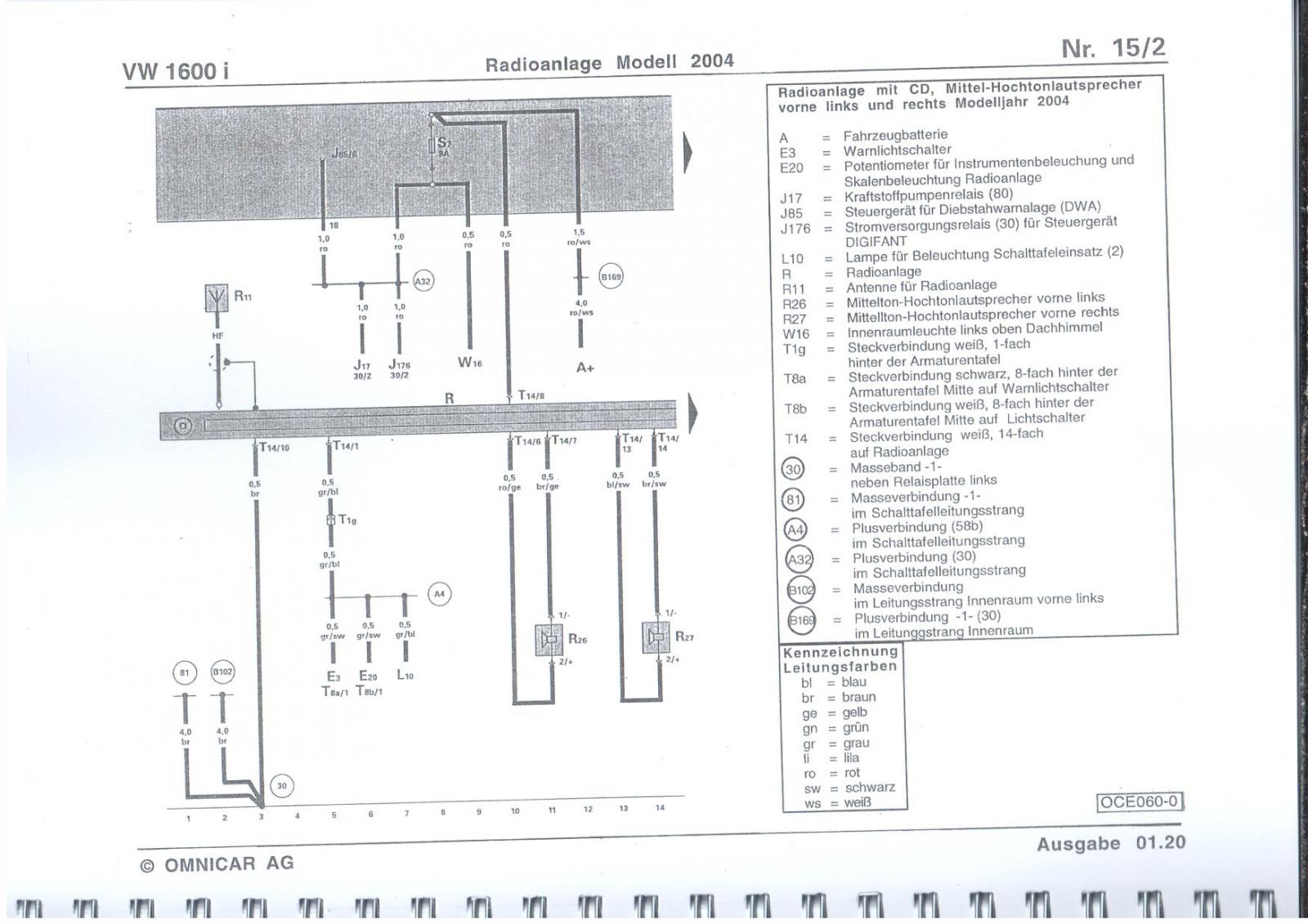

hopkin Premium Member
Joined: June 25, 2012
Posts: 2546
Location: Ottawa, Ontario
hopkin is offline
PostPosted: Mon Jun 30, 2025 5:18 am    Post subject: Re: Official Mexican / Brazilian Beetles - All years Reply with quote
I found this 16 Pin Clarion layout, and schematics with the pin-outs for the connector (Maybe might help)
Check your wire colours against the schematic. If they match, a cheaper, non-cut, option might be to order the pigtails and make your own adapter.

PostPosted: Today 6:04 am    Post subject: Re: Official Mexican / Brazilian Beetles - All years Reply with quote
Success! I switched out the clarion radio plug to a ISO plug and I now have a working radio. Took her out for a cruise and really enjoyed it. Very Happy
