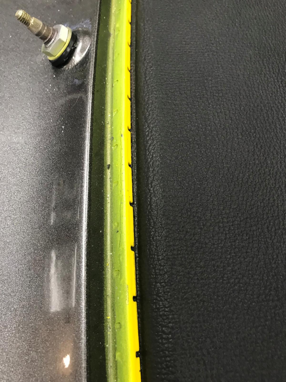

Did you remove the metal gripper strips?
And do you think I have enough space between the dash pad and window?
Anyone want to answer these questions?
