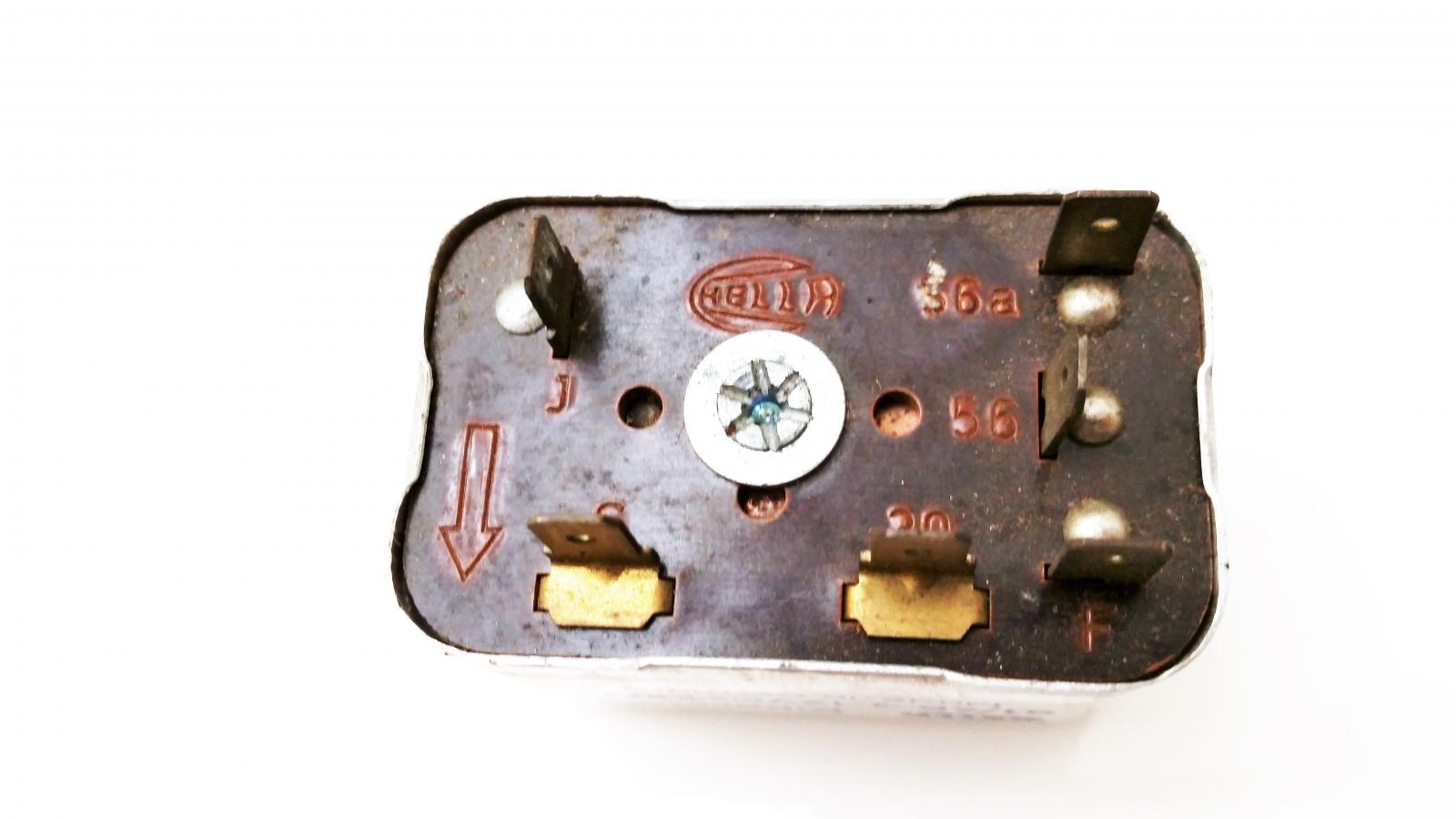

So to follow up on what I did in my 12 volt conversion:
Pulled the 6 volt headlight relay pictured below:
Went to the FLAPS and bought a 5 terminal electronic relay and wired it up using this very crude diagram created through a discussion with Telford Dorr.
As you can see, the "J" wire wasn't used.
I have all of the original functions that were available in 6 volt configuration. Flash to pass with all lights off, high beam, low beam, etc.
I finally got around to testing it today and everything works perfectly.

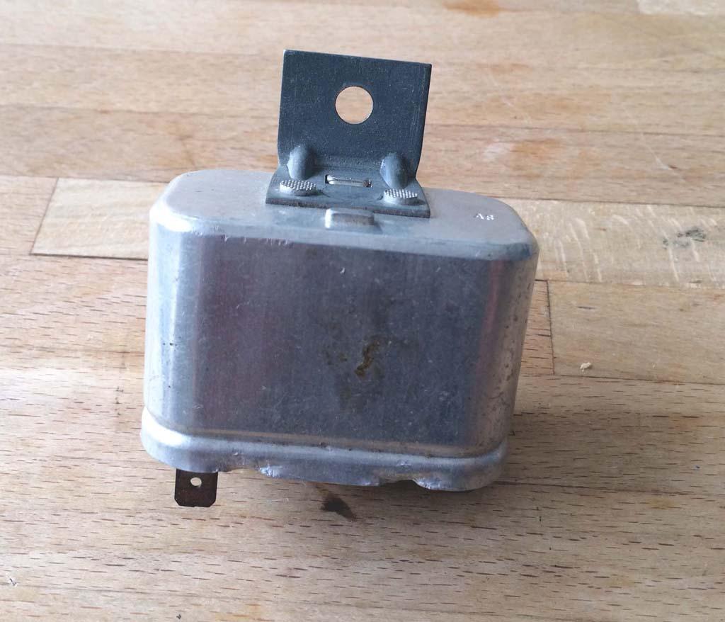

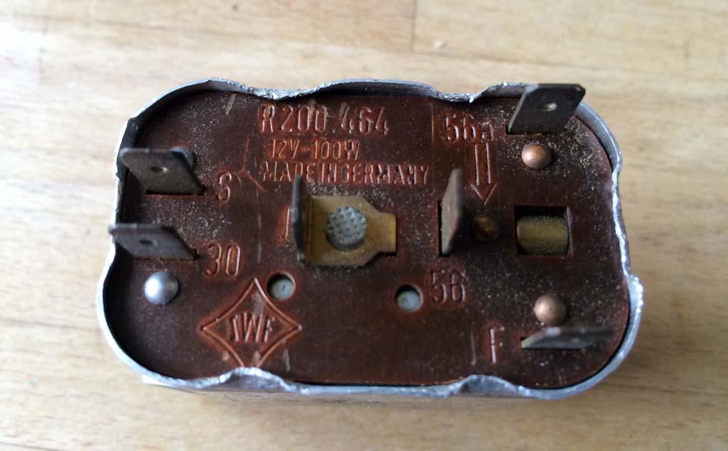

PostPosted: Sun Aug 14, 2016 8:52 am    Post subject: Re: 6v pushbutton switch to 12v headlight relay questions Reply with quote
I happened to find the 12 volt version of this relay. Not sure of the origin, but may be Volvo or Saab.
The SWF part number is R200.464.
Terminals (compare with the 6 volt version in post above)

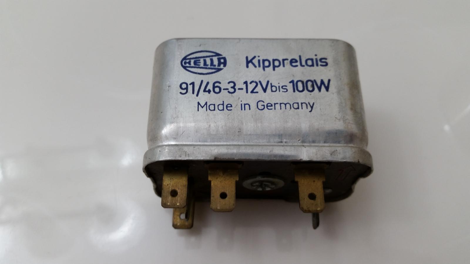

PostPosted: Sun Aug 14, 2016 7:07 pm    Post subject: Re: 6v pushbutton switch to 12v headlight relay questions Reply with quote
That's interesting...I was never able to find one.
I bought the Hella version in 12 volt - fairly easy to find.
