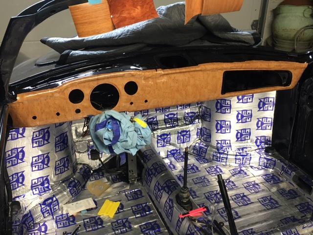

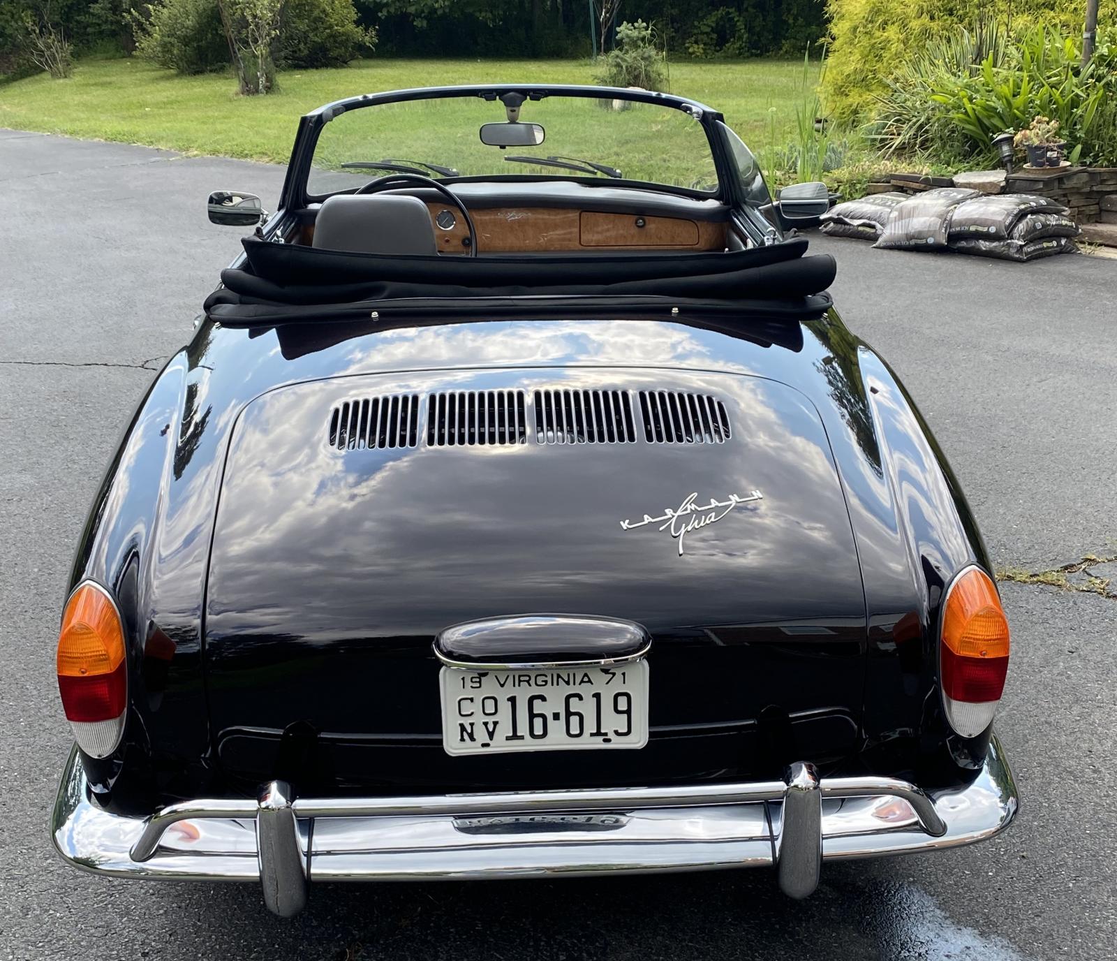

jpajya
Joined: April 25, 2019
Posts: 65
Location: Northern VA
jpajya is offline
PostPosted: Wed May 07, 2025 8:21 am    Post subject: Re: Wood grain plastic dash face vs. Woodgrain vinyl wrap Reply with quote
Check out rbsurfguy's build thread for another option, using 3M DINOC vinyl wrap wood look.
He discusses in detail the installation, and has several photos to show how it looks. It's a great looking option and looks as good in person as it does in the photos.
https://www.thesamba.com/vw/forum/viewtopic.php?p=9074292&highlight=#9074292
