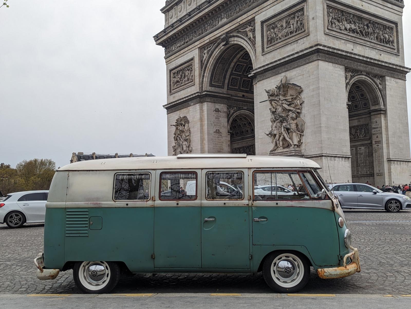

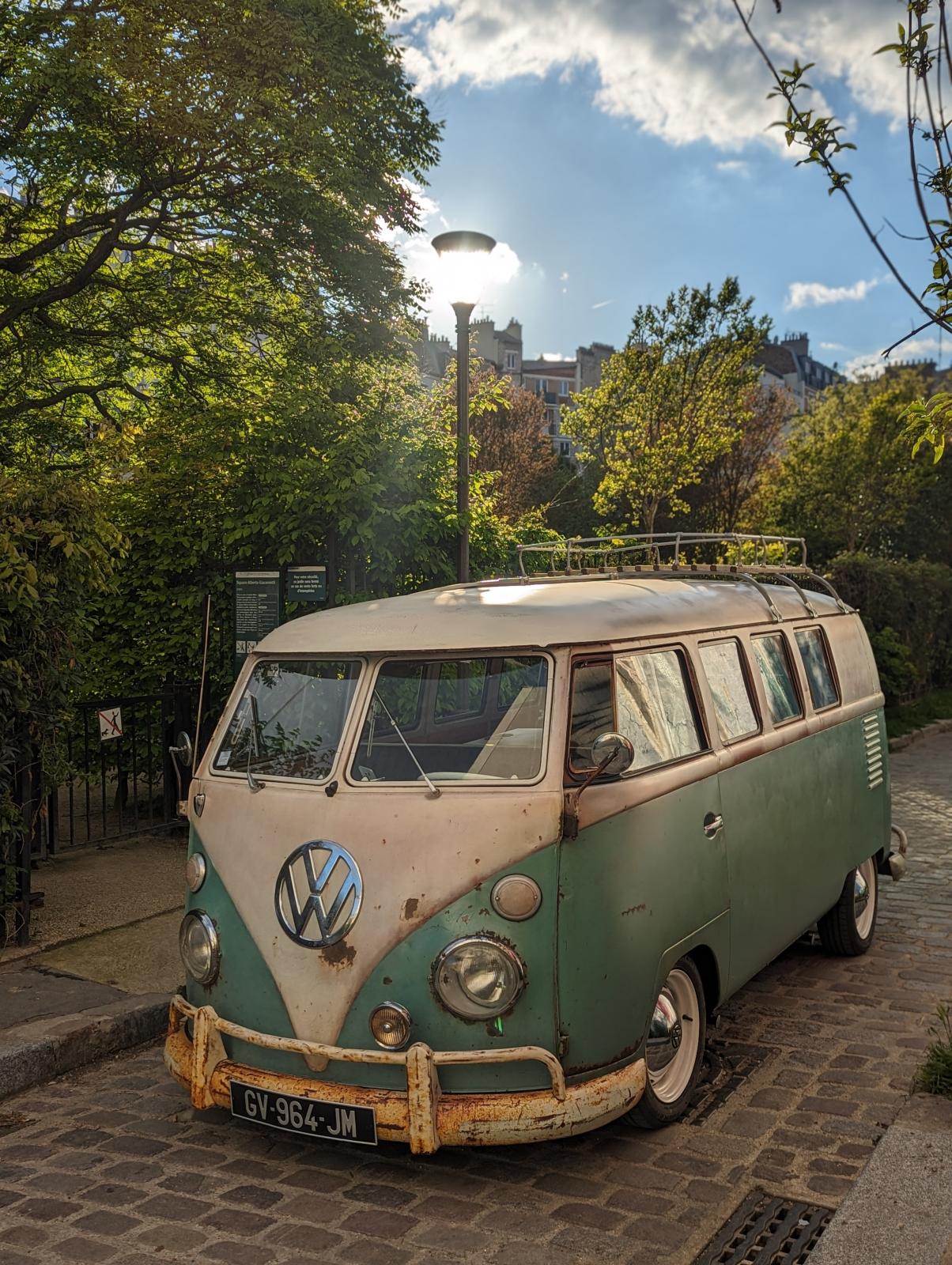

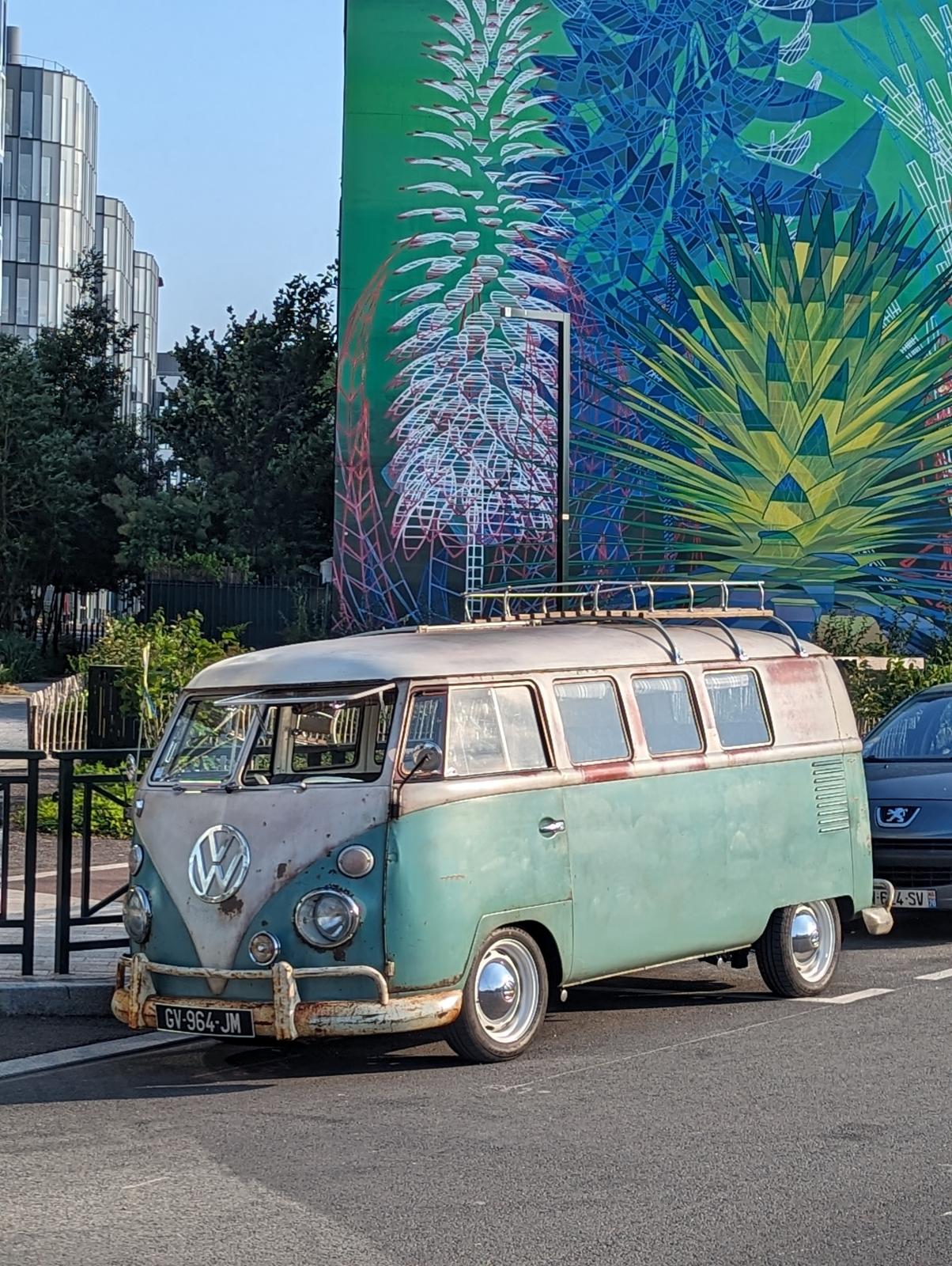

PostPosted: Sun Aug 04, 2024 4:11 am    Post subject: Re: Specs. of tire, wheel, and suspension - Lowered Buses Reply with quote
1962 Westfalia SO33
Front: 175/60/15, dropped spindles, 2-inch narrowed adjustable beam, sway away
Rear: 175/60/15, IRS, adjustable spring plates
All around: Bilstein bus shocks, replica 356 wide 5 stud
My setup does no allow larger than 175 tyre, as it is really close to touching side panel from the inner side.
