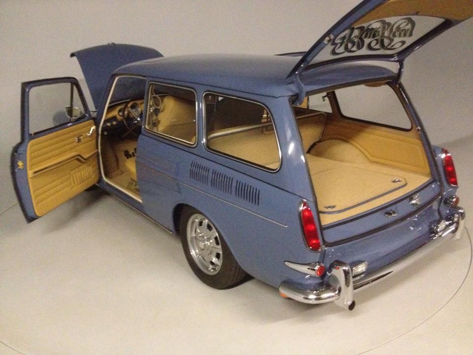

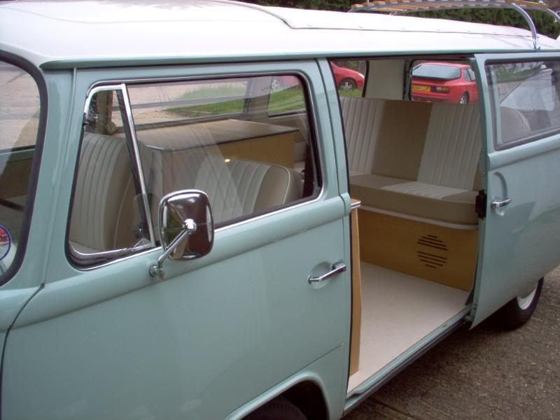

So, a little background...
Bought this van in 2001, it needed some restoration handled by my restorer, Hayden. It had the bottom 6 inches replaced and then a full respray, new interior, refreshed engine. We used it as a regular camper from 2003 to 2014.
In that time I went through a full restoration of a 1967 beetle with Hayden and a show standard Squareback which won Volksworld in 2014!

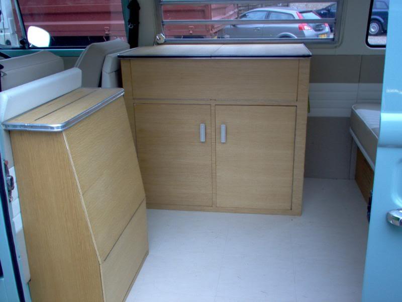

Interesting project
What is in the sloping cabinet behind the seat?

W1K1 wrote:
Interesting project
I made that! It had a seat that pivoted down and a full screen TV that popped up on an electric window regulator LOL

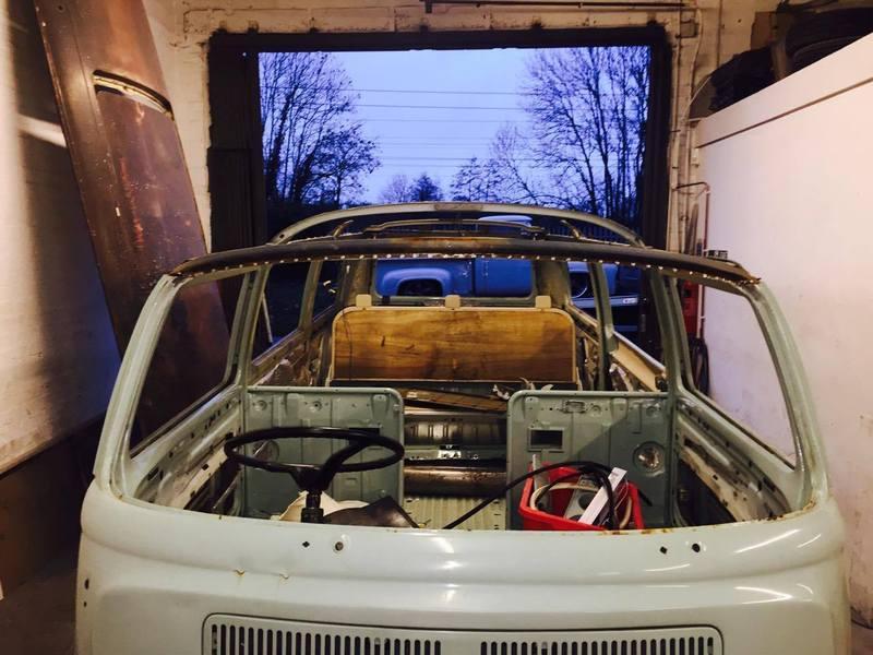

PostPosted: Tue Apr 15, 2025 1:22 am    Post subject: Re: Long running Custom Bay project - the Rebuild Reply with quote

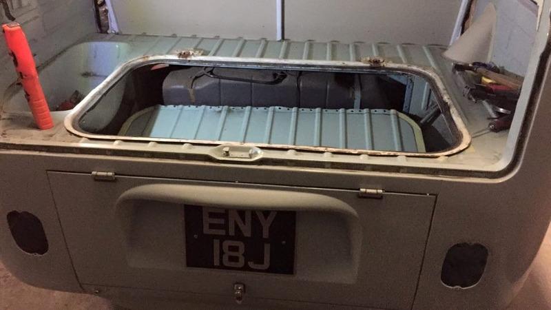

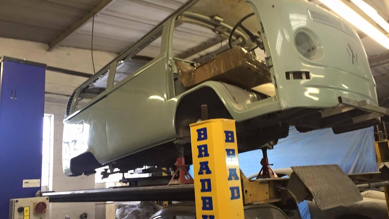

So, a little more rust repair and some progress on the engine hatch plus teasers on the air ride work. Anybody who tells you putting a flat 6 in a van is 4 bolts needs to be shot LOL

PostPosted: Wed Apr 16, 2025 10:09 am    Post subject: Re: Long running Custom Bay project - the Rebuild Reply with quote
I want that vanagon engine lid in my bus. Would love to know how you did it.

cut one out of a donor, and weld it in
type 3 works too

Exactly as they said. I found a late donor in a scrap yard in NJ, cut it out, brought it back from the US and my retorer grafted it in. It takes some work to make it look perfect but the really smart thing he did was used the cut out metal to delete my spare wheel well!

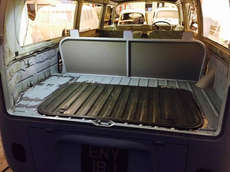

PostPosted: Thu Apr 17, 2025 1:30 am    Post subject: Re: Long running Custom Bay project - the Rebuild Reply with quote

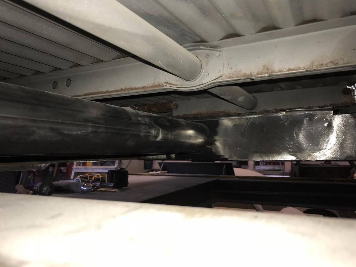

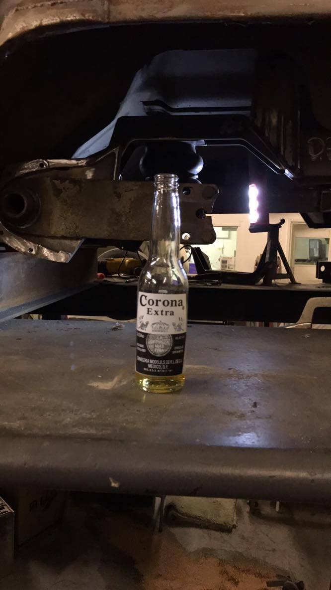

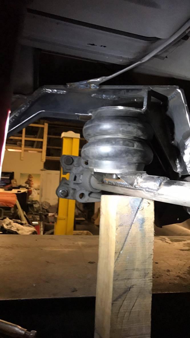

So.. let's start talking about putting a flat 6 in a VW van.
Some people tell you it is 4 bolts, really easy - they are idiots.
A few challenges are - dry sump so you need an external oil tank, cooling a big flat 6, and that it is about double the weight of a VW engine. That would lead you to ask "why bother?" and the answer is, because its hard!
I am not trying to make the fastest van as you could do that with a turbo type 4 VW engine most likely. I love trying things that not many people have done properly, which means rebuilding the chassis to handle the extra power and weight and combining with brakes that will stop the thing!
The other challenge is using a 915 transmission with a gear shift that is in an entirely different place to a VW.
What you need is a genius fabricator which I am fortunate to have!
So a few teasing pics:

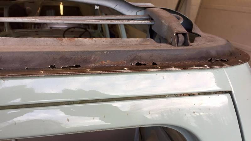

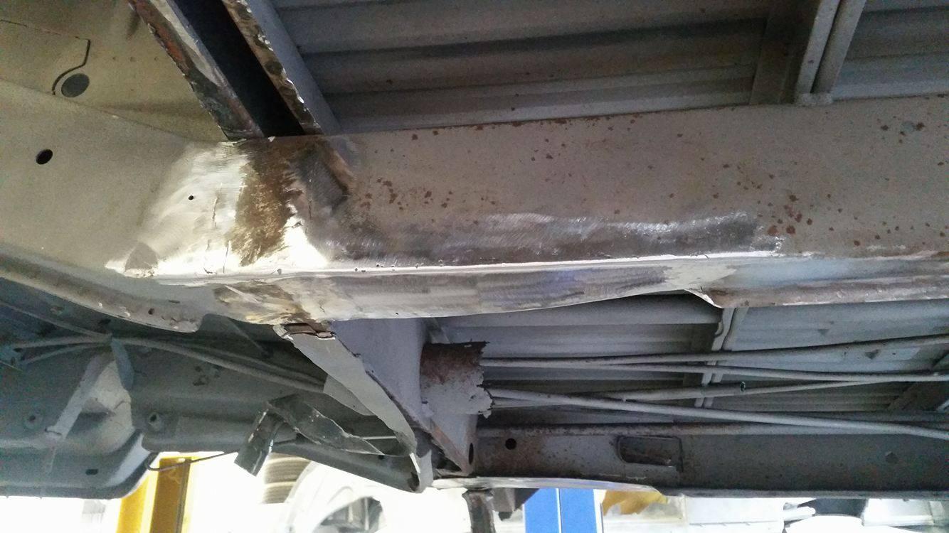

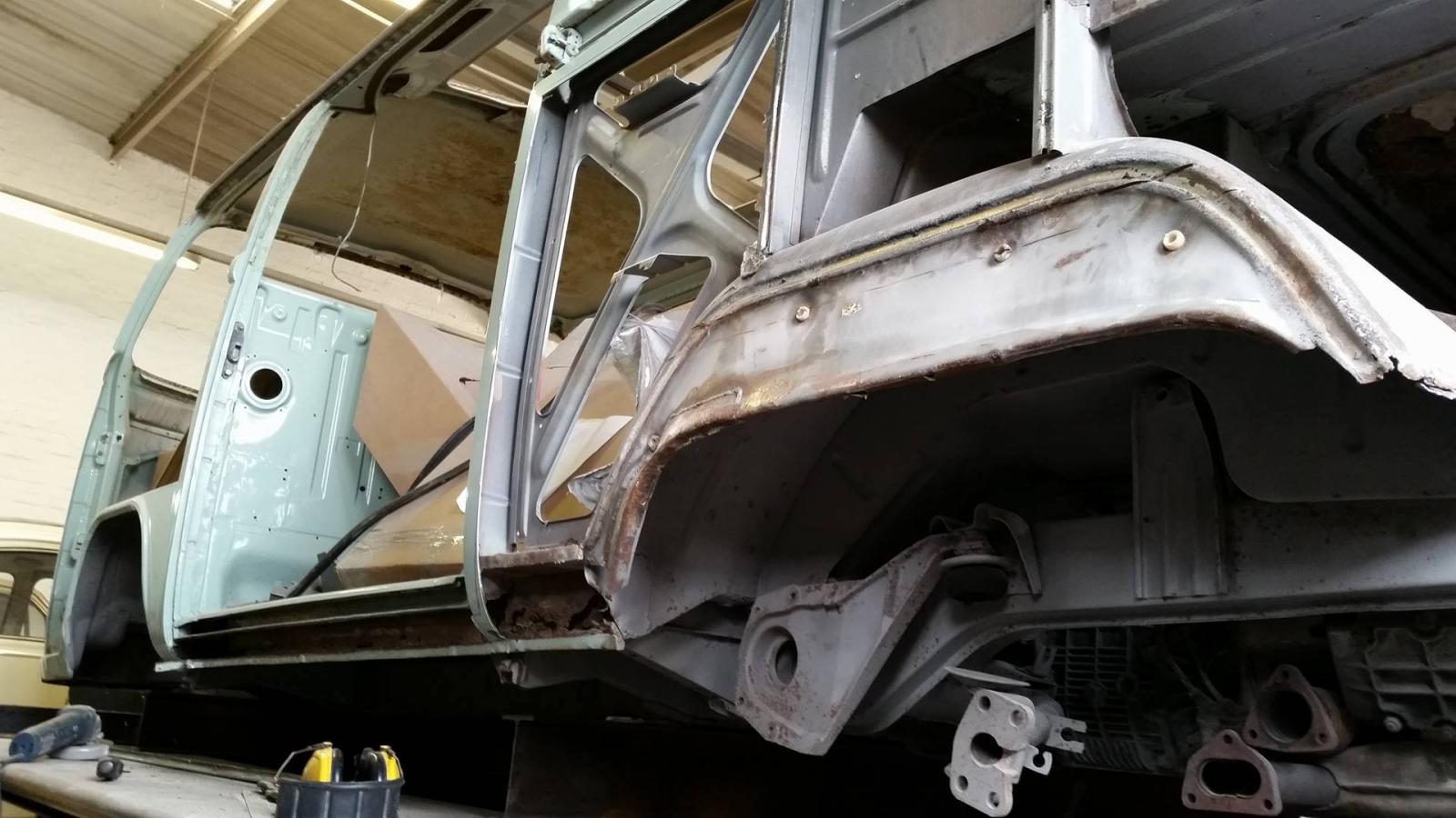

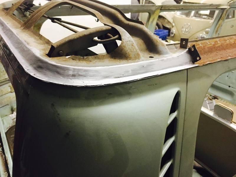

PostPosted: Thu May 08, 2025 8:28 am    Post subject: Re: Long running Custom Bay project - the Rebuild Reply with quote

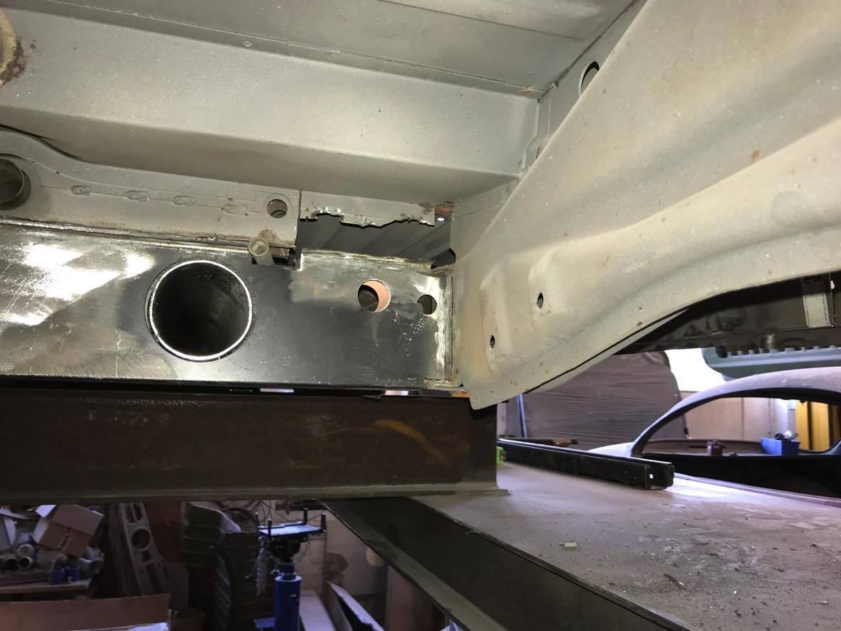

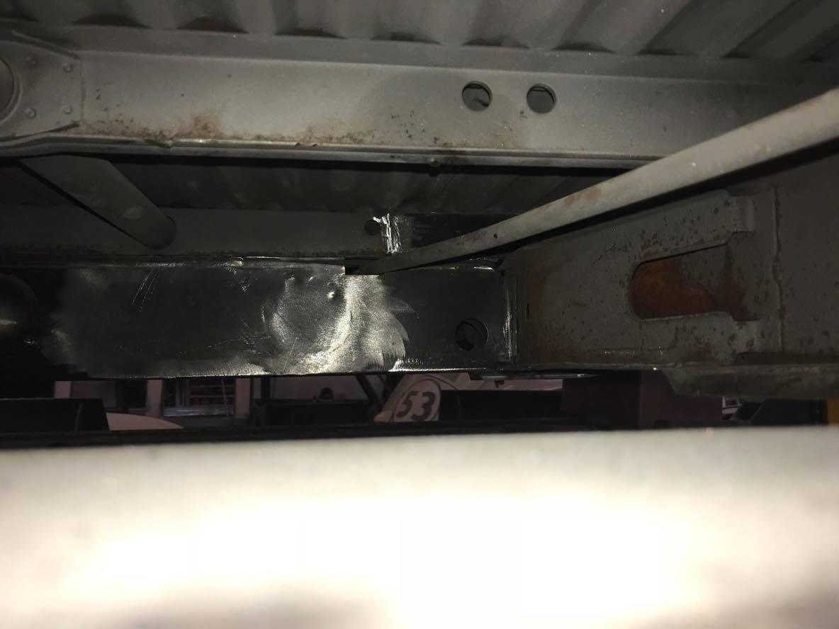

So, as you can see, we had significant rust repair to do. Not the sexiest subject but definitely
part of a great project:

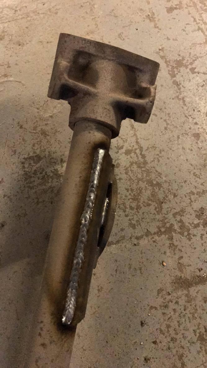

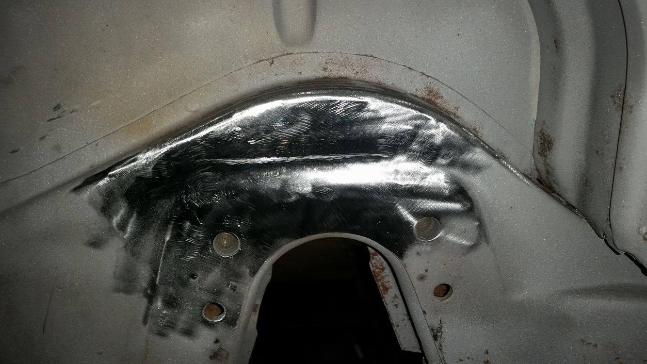

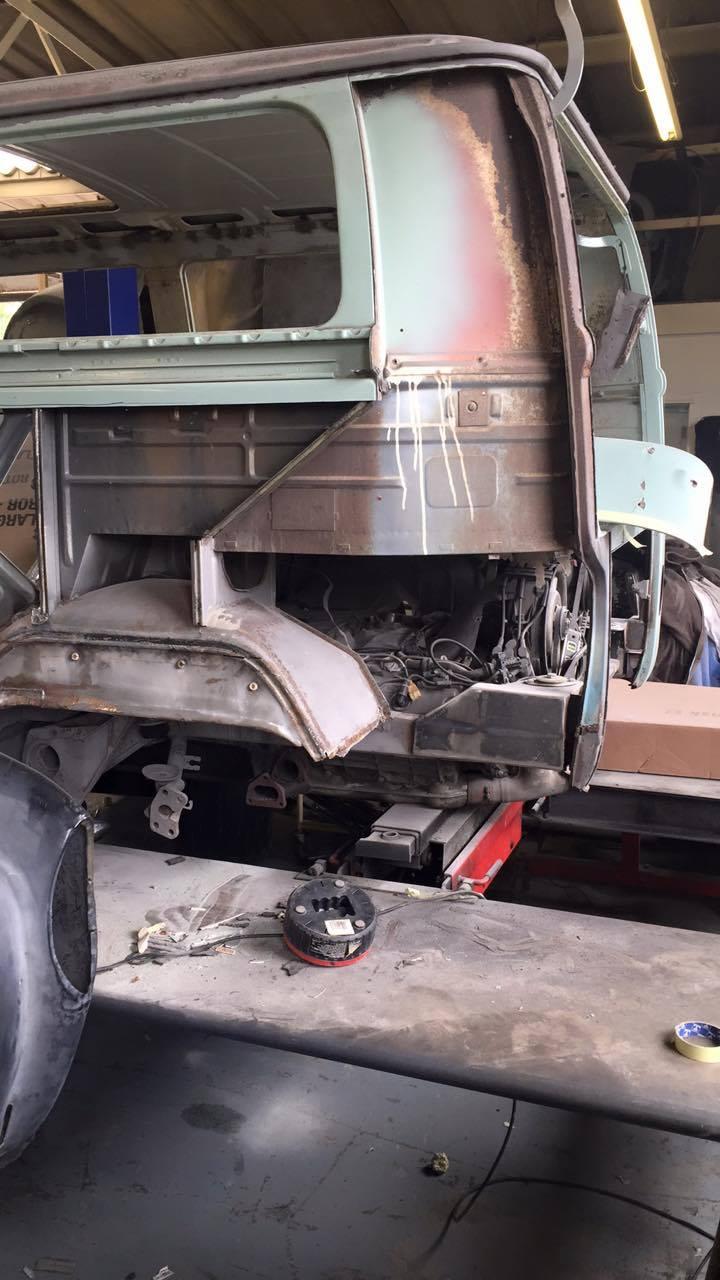

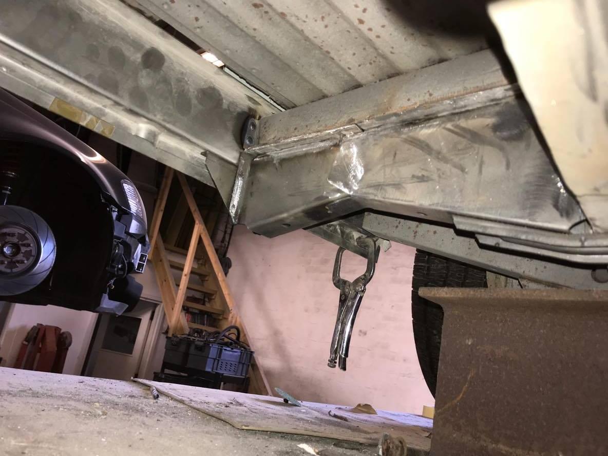

PostPosted: Fri May 09, 2025 2:39 am    Post subject: Re: Long running Custom Bay project - the Rebuild Reply with quote
More rust repair, panel fitting, air ride, Porsche 915 shifter etc. This van has had every major panel replaced. You will also notice some work on the Porsche 911 dash!
