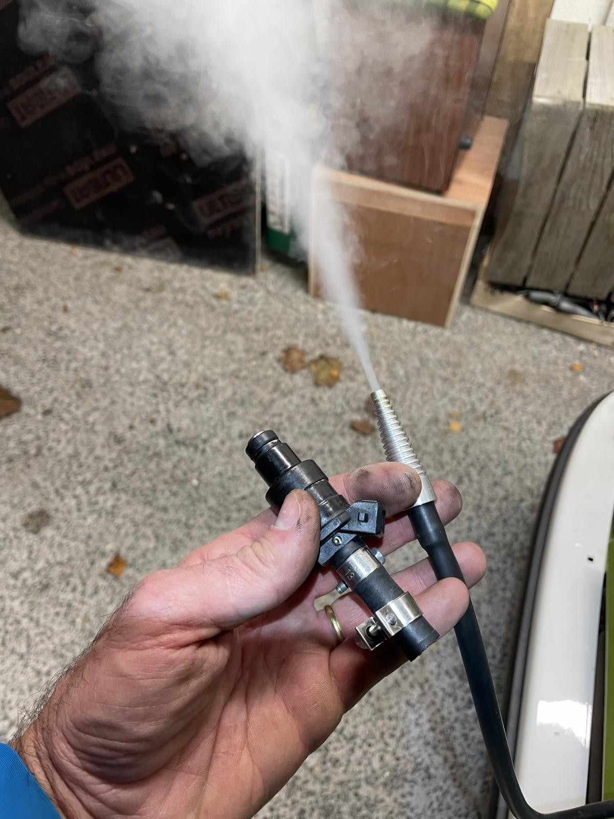

I checked the injector seals and everything is ok with the smoke tester(that I inserted at the level of the hose of the auxiliary air valve).

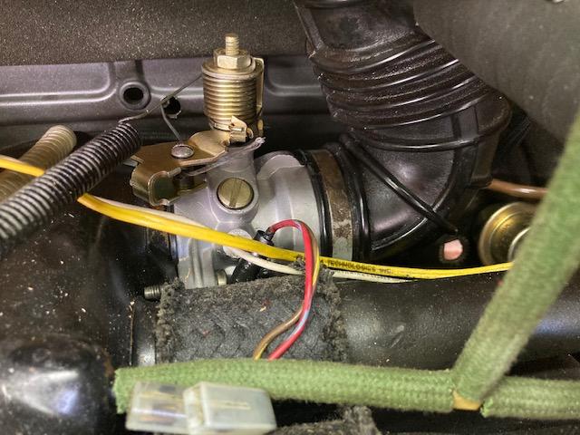

I didn't understand why you said it was worn out if it didn't have the hole?
Why?
I'll put a picture of the inside of the throttle body and the number. Thanks a lot for your help Robbie
[img]https://www.thesamba.com/vw/gallery/pix/2283009.jpg[/img

PostPosted: Sat May 10, 2025 8:28 am    Post subject: Re: ignition timing, how to adjust? idle L Jetronic Reply with quote
Have you checked into whether your AAR (auxiliary air regulator) is closing fully once the engine warms?
Your throttle plate clearances look good to my eyes.
