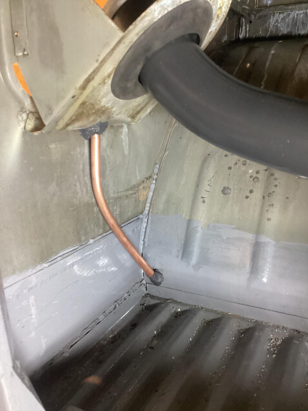

Are you going to setup a drain system for the gas door like the bus models do in the engine compartment? Rain always get around that door to rust out the floors inside the trucks.

I used JBWeld. Misses a few drips, but gets most of the dribbles.

Now that you mentioned a drain system for the gas door. That is the last thing on my list that I have posted in my workspace. Picture to prove it and I love lists. Just haven't found a solution for it.

As for the gas door water intrusion situation, have yet to do anything with our runner single cab, but it has for the most part been kept under cover and not driven in the rain for many years now. Been thinking of making a "U" shaped gutter (with a bit of a "V" bottom to encourage water and dirt to slide on downward) about 1" tall, and wide enough that someone can run a finger into it to pull out and debris that might get into it.
Thinking of going pretty much the front to rear length of that panel with a 30 to 45 degree slope for the gutter going downward to the rear. Front end of the gutter would not need to be closed off with that steep of incline, and the rear end to funnel into at least a 13mm (1/2") pipe to drop down just in front of the rear wheel well. Weld the gutter to several points of the panel and use a drip rail or body panel seam sealer coating to keep water from getting past the gutter. Probably would need to make the panel side of the gutter higher to allow easy welding and visual of the coating/sealing.
Have also thought about a cover panel that would connect to the gutter and cover as much upward of the whole gas filler area to catch as much of the water spray that gets into there, but be easily removable with 4 to 6 machine screws. First would be to do the gutter and go from there.

What year truck, E&B? Does it not already have a gutter like the one in my pic, above? On my truck, it was just a folded U in the neck support, and it looks like VW intended for gas and water to spill over those side openings and into t/c. I drilled a hole, added the copper drain pipe, and made little dams at each end of the U trough to encourage liquids to exit via the pipe. I've only had it in rain twice, so I can't say how well it works for that, but the gas that spills seems to exit properly through tube.
I bet Kb65single could zap that up in an hour and improve upon it. I think just welding tabs covering the U ends and properly welding in a drain tube would resemble the bay setup and be faster.

Both the driver DEC62 and the spare MAR1963 SCs have the same gutter like you do, we just are not satisfied with the front to rear length of the stock gutter. Not only because the gas door is wider, but how any wind blowing around the door will affect the spread of moisture. Just figuring on getting as much of the water that gets into there out thru a drain, before it can pond up on the floor.

Understood. VW was not worried about water as much as saving $5 on that bit.
Kb, while you are making a to-do list before paint... while laying in my t/c replacing the gas sender, I once again boggled at the amount of wasted space back there. I was thinkg a good welder could make a removable panel to protect the tank, yet still allow for installation of some storage containers back there. I saw a steel Army shell case that looked the right size to bolt it to the firewall and put in emergency supplies... cosmoline-dipped crank, rods, p/cs, hell a whole case! Pop off the main divider panel and haul out the spares. I can see you fabbing something with doors and roll-out shelves. :)

Yes, Hans und Franz did a real bad job of designing that part. The original floor in that section had multiple holes drilled in it to drain the water out on both sides. I am assuming that the treasure chest doors don't seal that well and the gas tank door and its surrounding metal is what it is.
I'm leaning toward drilling holes to let the water out and making a foam seal on the gas door to hopefully slow water from entering. Probably a metal pipe like you did. The VW gods will hopefully look kindly down at me for making a decent effort. The bus might get wet, but it won't be a daily driver.

PostPosted: Mon Aug 25, 2025 6:02 am    Post subject: Re: Rusty 65 SC restoration Reply with quote
BarryL, 70bus, Barb&Eric
Here is a real picture of a bumper bracket and not a stick figure. These are the angles (AB, BC,and CD) that need to be correct for the bumper to sit right.
There is a rubber pad inserted in the bus corner sheet metal about 6 inches from the bumper bracket. Not sure why it's there it just is.
Picture of the rectangular rubber pad that is sandwiched between the bumper bracket and the splash pan. The rubber pad is smooth on one side and has ribs on the other side, not sure which side is up or down.
