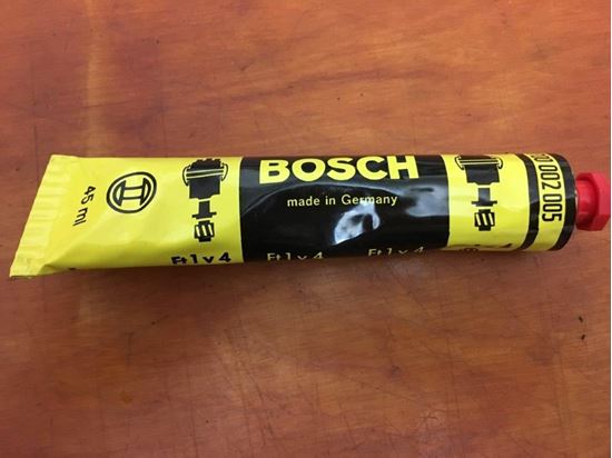

Jazzfess wrote:
I filed the points and now the car starts. New parts on order.
Remember to put a little distributor cam grease on the distributor shaft where the points rubbing block will rub. I saw this failure frequently when I worked at a VW/Dune Buggy rental place in the "old days".
I hope you ordered TWO sets of contact points so you can carry a spare set in the VW.

Jazzfess wrote:
I did order two sets of contact points.
Good thinkin' !!!
Jazzfess wrote:
However, I do need to apply some distributor cam grease.
I have a tube I bought some decades ago. However, I confess to using (successfully) a tad of wheel bearing grease. This is a photo from gallery, like mine.
