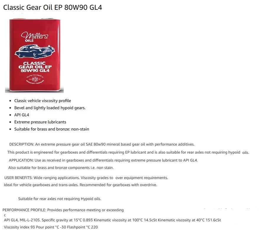

For my 1955 tranny,
Would this oil be fine to put in?.. not sure about the comment of "rear axles not requiring hypoid oils" - just don't get that.
Dang cracked axle boot..
Thank you

OK... pricey.... but I have to admit, my transaxle is worth it.
Of course I read the 70+ page on GL4, vs GL5, as well as another thread, and for me.. want to go with GL4...which I think the redline is... have to double check.
Thanks all.

And is now ordered! ...

mr matt wrote:
For my 1955 tranny,
Thank you
VWs don't have hypoid ring gears so it should be fine, however, the consensus is that the Redline oil is the best.

The dedicated gear oil topic is now 70 pages long. There is no consensus on what oil to use.
Since Matt is asking about his 77 Bus, it does have a hypoid R&P, so it needs to use GL-5 gear oil.
Now, for all the nancys out there that fear GL-5, there do exist gear oils that are GL-4 and GL-5 rated.
I strongly recommend synthetic 75W-90. Then when the gear oil is cold, it shifts just like when the gearbox is warmed up in the summer.
