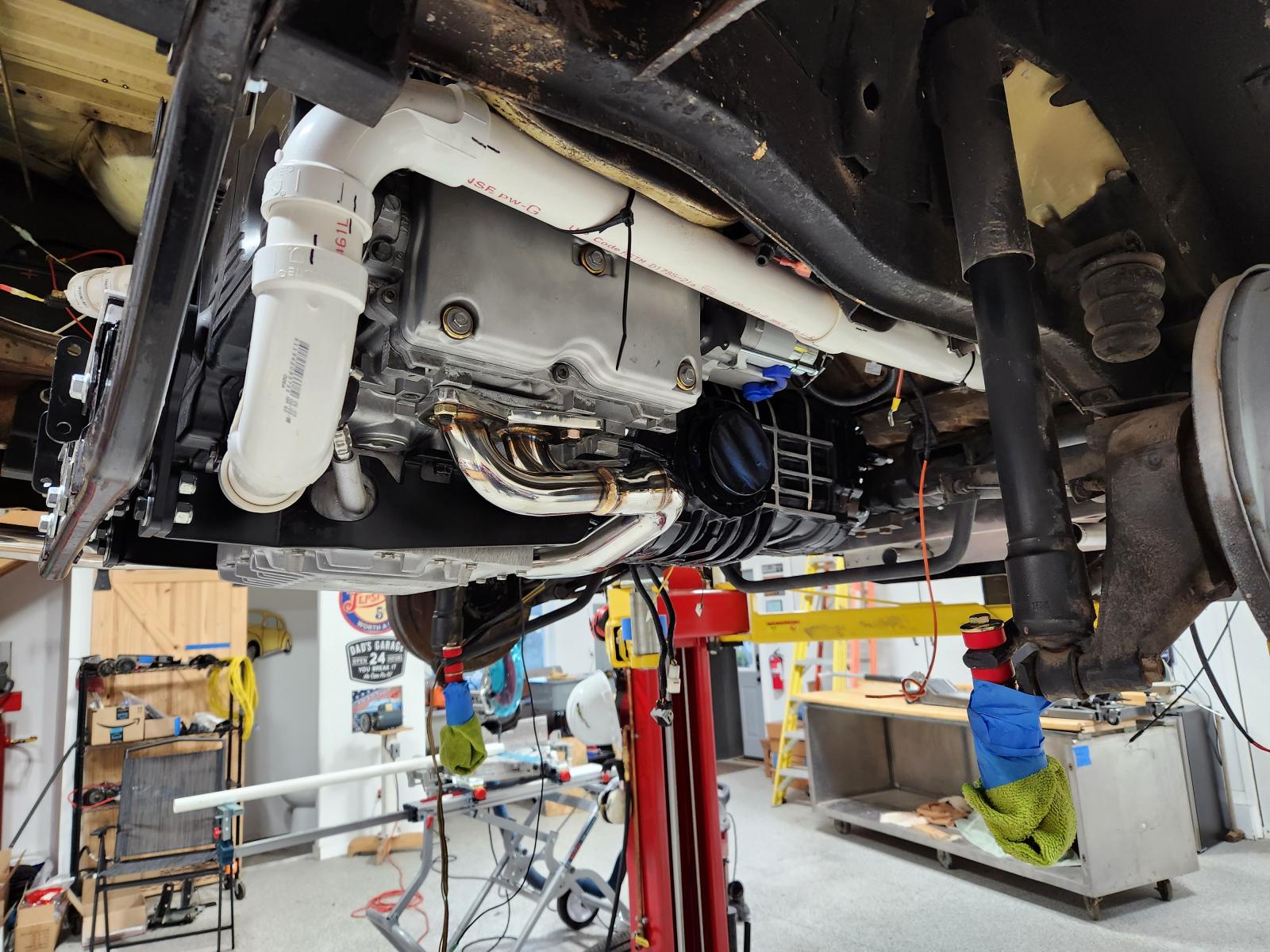

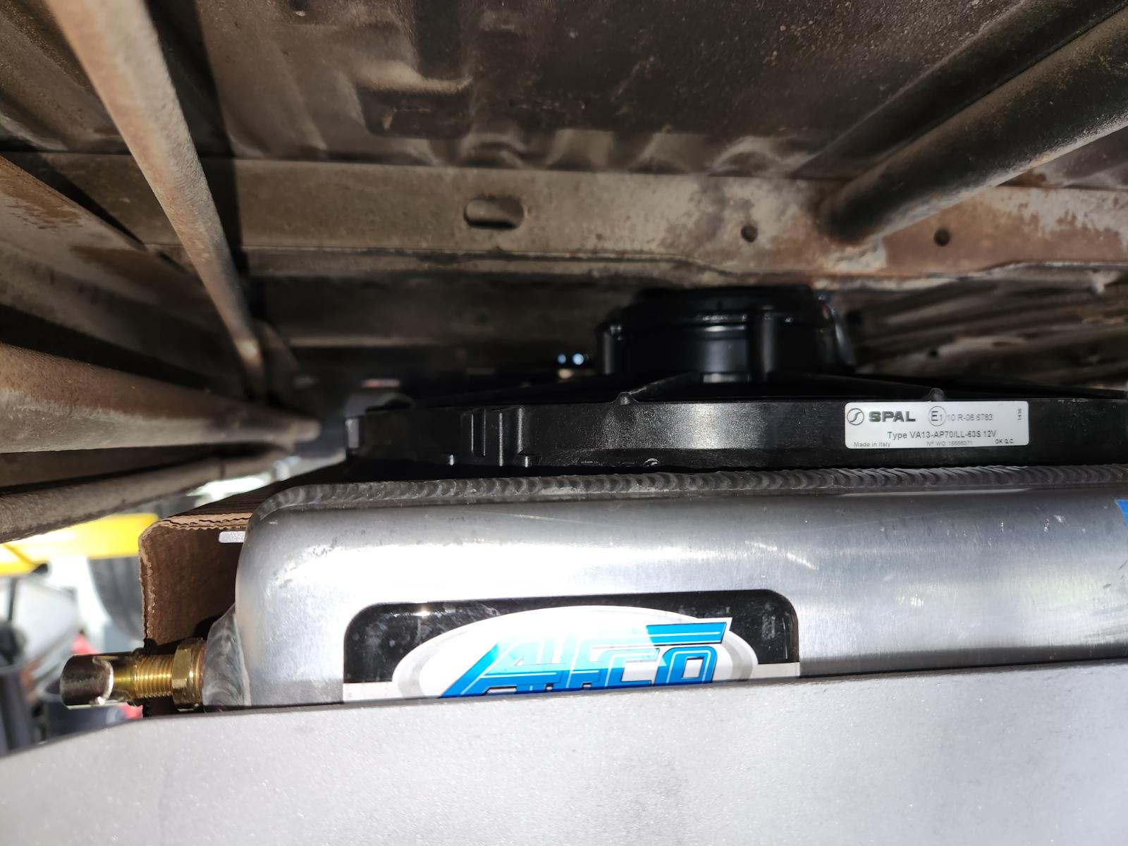

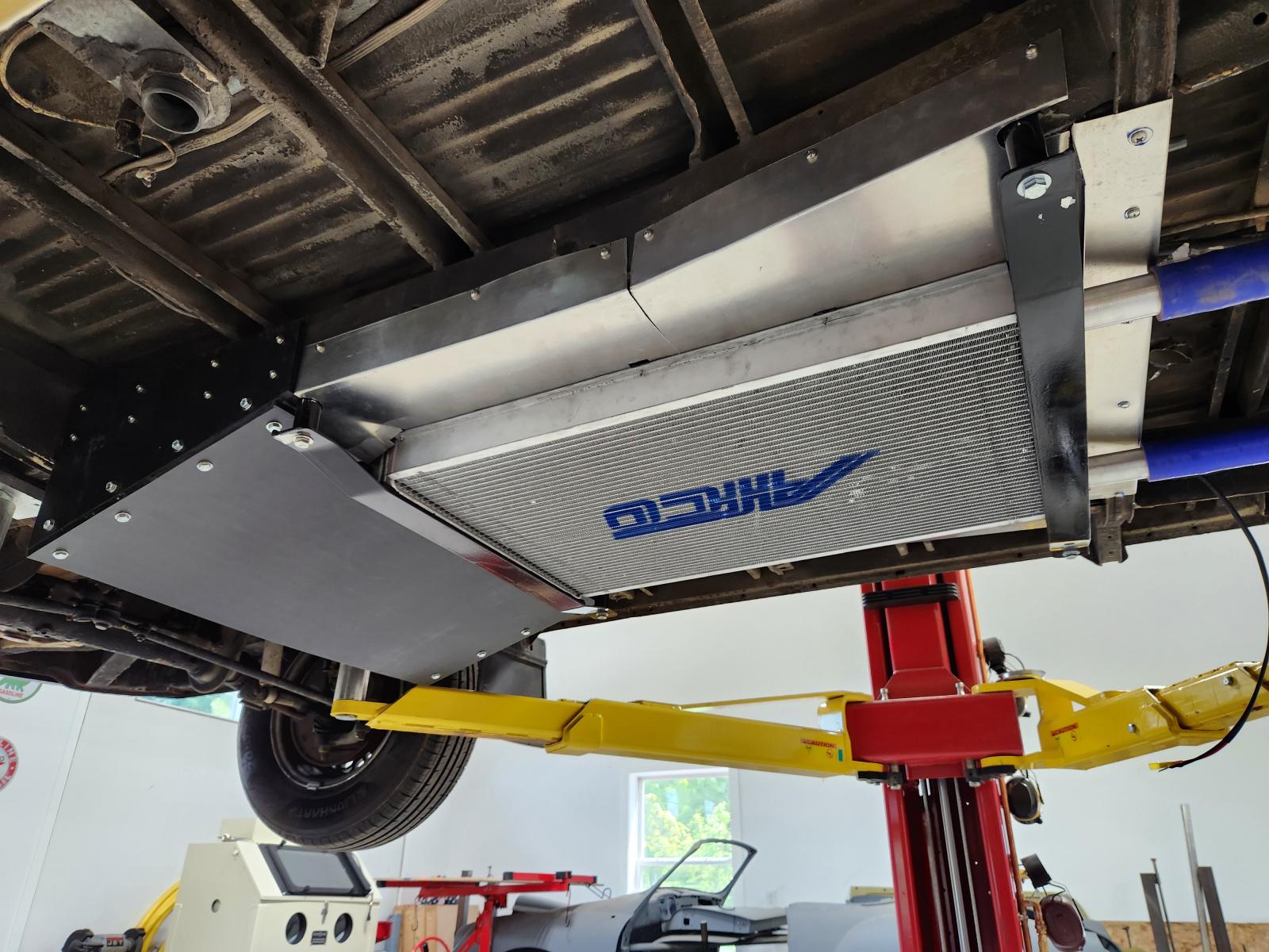

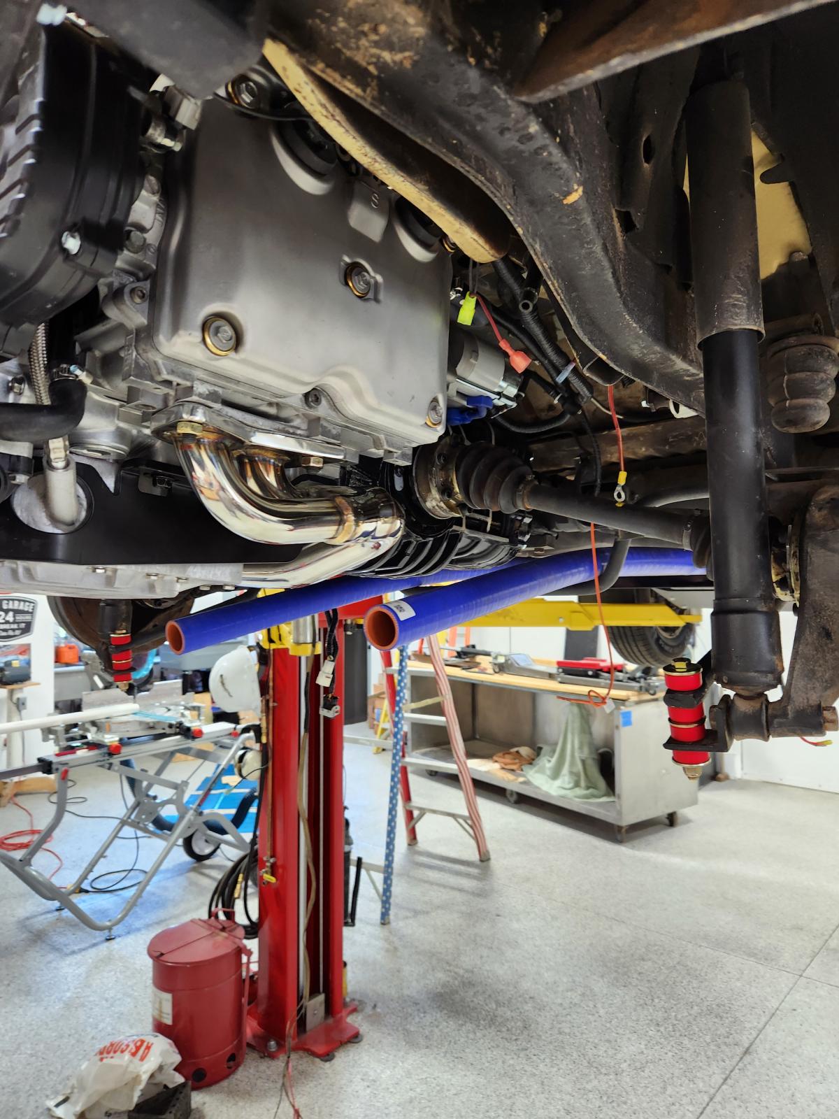

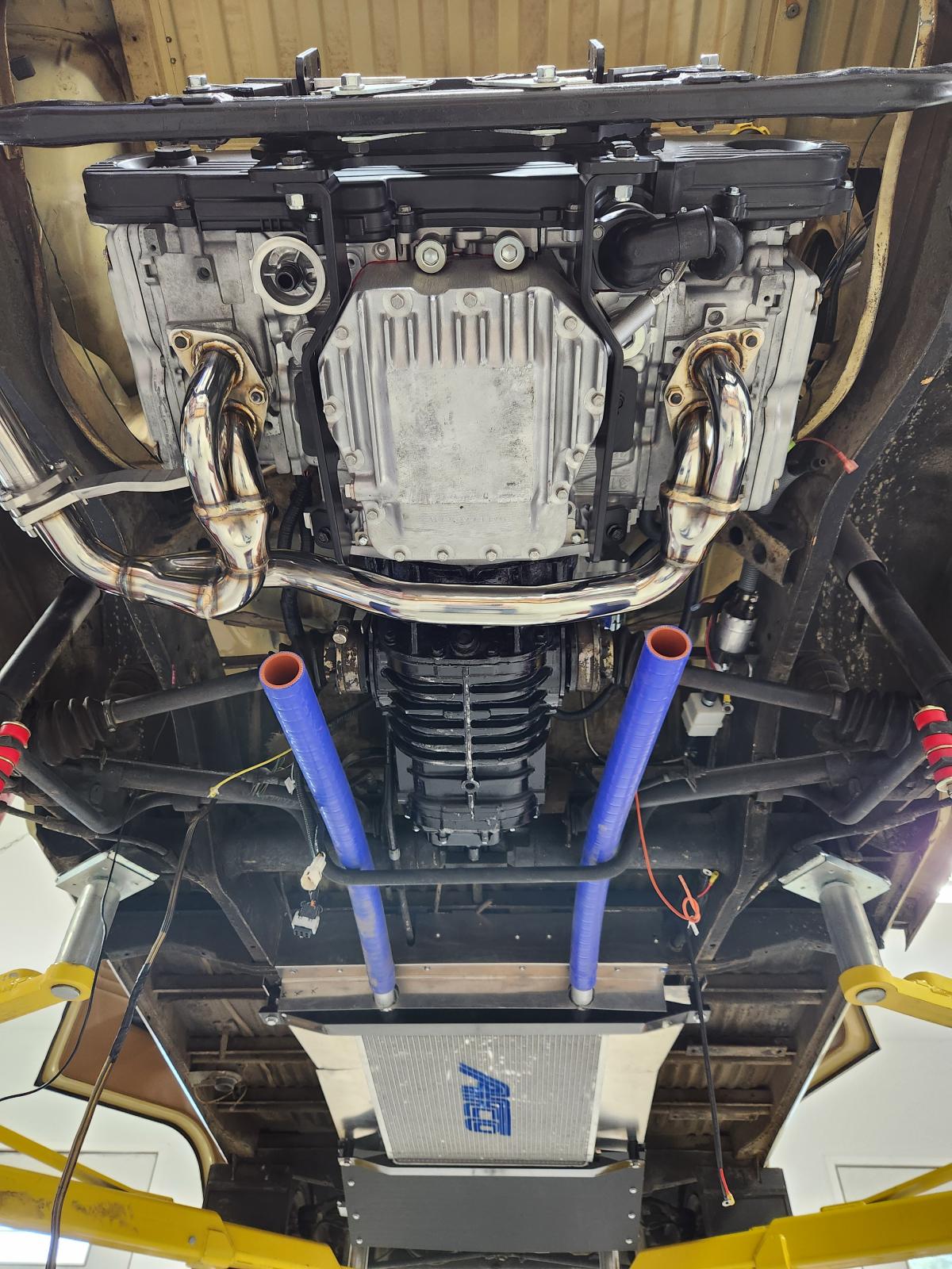

PostPosted: Tue May 27, 2025 9:04 am    Post subject: Re: Subaru conversion Reply with quote

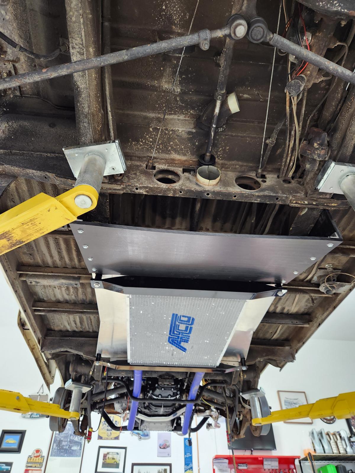

It’s been a while since I posted any updates on my project and I’ve been busy.
I assembled the engine using a new short block from Subaru. I used only genuine OEM Subaru parts for the build. I had a local machine shop go through the heads and rebuild them. The transaxle has been rebuilt by Leduc Racing Components with a new 4.13 R&P and a 0.82 4th gear.
Following Vee-Dub-Nut’s example, I’m going with a belly mount radiator and using a modified AFCO all aluminum radiator and two Spal 13-inch fans. I used a NAPA, a 5/8” diameter molded ”U” shaped rubber hose to connect together the feed and return pipes for the heater core.
So, at this point the engine, transaxle and radiator are installed in the bus. Now I'm starting to connect the cooling system, and I have a couple of questions:
1. Has anyone used copper pipe for the hard lines between the engine and the radiator? The Big Box stores have copper pipe and fittings at reasonable prices, especially compared to pre-made stainless steel coolant pipes. Copper pipe and fittings will allow me to custom fit things as needed.
- I don’t believe galvanic corrosion will be a problem, as the dissimilar metals
will be separated by rubber/silicone coupling hoses.
- Would using mild steel exhaust tubing be a better choice?
2. How did you route your coolant hoses to the radiator; did you go over or under the torsion housing? Do you have any pictures you could share?
3. Expansion Tank. I know I need one, but I don’t know much more about it than that . . .
- Where does it go?
- What size?
- How should I plumb it in – Coolant manifold side or Thermostat side?
- Tee in at the high point of the cooling system?
Here are a few pictures of my progress to date. Note that the white PVC coolant pipe is just for mock up purposes.
Interestingly, I found a Subaru dealer here in Michigan that gives a 23% to 35% discount on parts. They do provide shipping for a nominal fee. Here is a link: https://www.subaruparts.online/productSearch.aspx?...5627642738
W1K1
Joined: March 04, 2004
Posts: 5263
Location: Southern AB
W1K1 is offline
PostPosted: Tue May 27, 2025 10:12 am    Post subject: Re: Subaru conversion Reply with quote
i bought 1.5" stainless exhaust tubing off amazon and built mine, i tacked it with the mig and a buddy tigged it for me
drivers side is the high side, tee goes to the top of the VW bottle
pass side tee goes to the bottom of the bottle
http://www.thesamba.com/vw/archives/manuals/jim_martin_engine_build.php
1973 super
1965 squareback 1500E
1971 bay window westy- subi swap

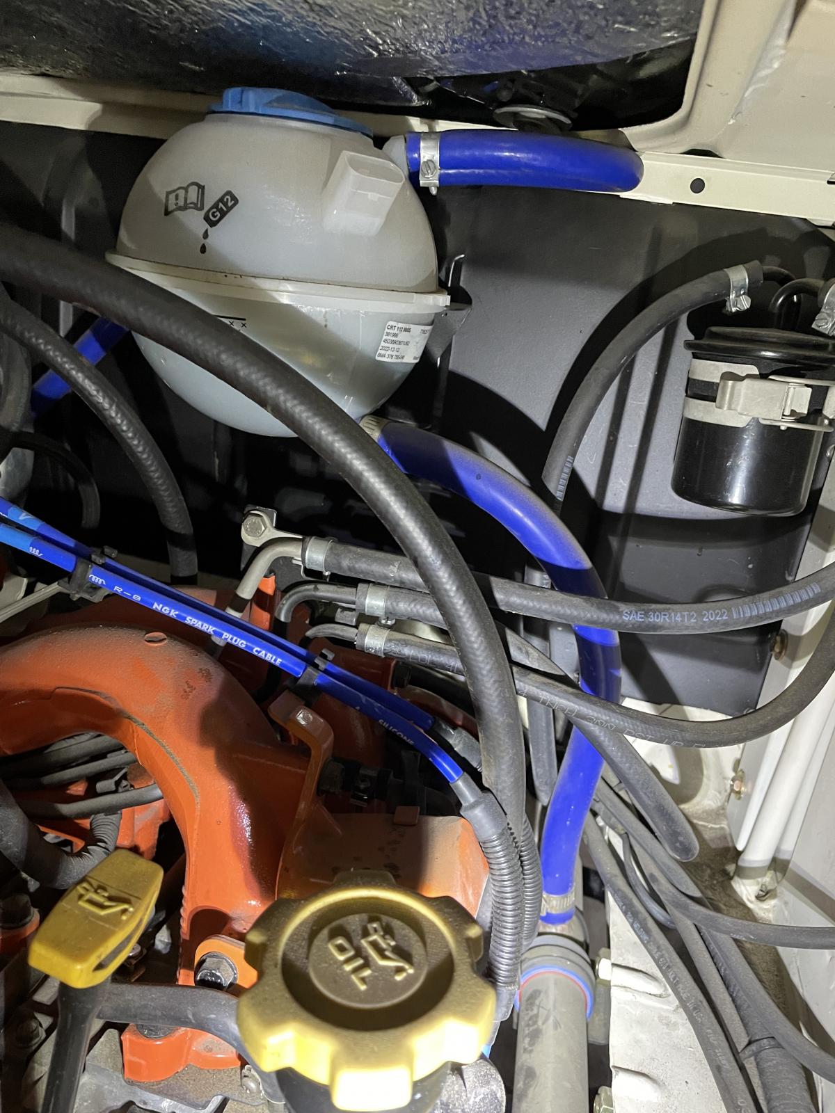

PostPosted: Tue May 27, 2025 12:32 pm    Post subject: Re: Subaru conversion Reply with quote
From page 1 of my build thread:

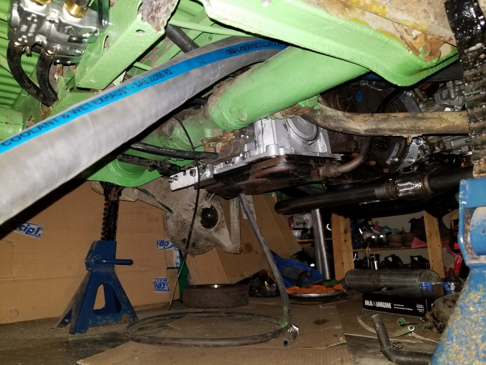

My build is not as "elegant" as others but functions well. I used the Subaru rad and fans out of my donor as well as the overflow tank. Used heavy duty marine exhaust hose rated for the temp, materials, and operating environment. Added 4 connecters: 2 at high points in the coolant lines for bleeding air that lead up to a filling point (with shut off valves) just under the rear access hatch and the other 2 at the inlet and outlet of the rad to install temp sensors, wired to aftermarket gauges to monitor temps before and after the rad. Added a temp/thermo (180F) switch in the outlet connector of the rad to control the cooling fans and ran the ECU fan control wires to the Small Car Code cheat board.
All coolant hose that touches metal (or anything else) is protected by 2" PVC pipe to protect from abrasion or damage.
Experimenting with where to run the coolant hose.
Dry run before adding the protectant pipe.
