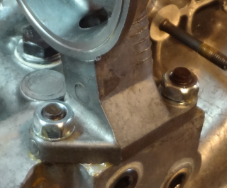

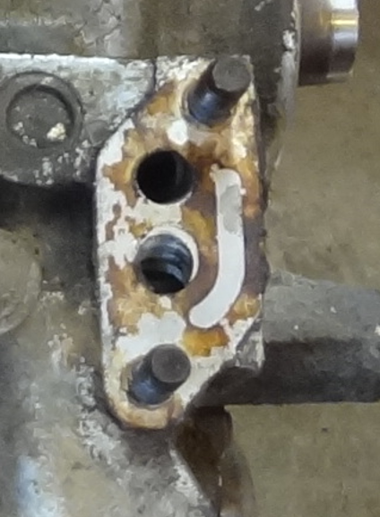

The photo shows the engine from my 1978 Bus, with GE case, during disassembly in 2017. The location of the oil filter mount attachment point is visible in the bottom right. The second photo zooms in on the mount attachment point on the case before case cleaning. At this point the gasket has been removed, however the shape of the original gasket is still visible on the case. It shows a third hole, in the elongated shape in the original gasket. Looks like this version of the 1978 year used the current gasket style.
Photo 1: Engine disassembly 2017
Photo 2:Oil filter mount attachment point
After putting 10K kilometers on this rebuilt engine I suspect it is leaking at the filter mount. Alternately it could be the oil cooler mount. Oil flows downhill. Short of removing the engine and tearing it down, I would need to examine this with a surgical borescope. Just need to befriend a proctologist to borrow the equipment.

That said, the gasket on Good Old Dusty's 1978 is thin like Mike's. I can see where a gasket like this is a better solution than what is out there now. When the old stock early ones come in, I plan to mic it and see how thick it is compared to the ones available now and post the results. Most likely I will exacto the third long hole.

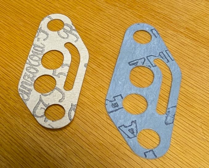

Colin wrote and said he remembers the change. It was done to increase "unit pressure." I am guessing that means reduce surface area to increase the gasket crush more evenly as we discussed.
I found two I have, there may be a couple more, it so I will add them tomorrow.
The one on the left based on the logo is an original factory gasket "Reinzoloid FS 53". The one on the right is from a Victor Reinz type IV kit.
late 021-115-359A Factory "Reinzoloid FS 53" is .015" thick
late 021-115-359A Victor Reinz aftermarket is .021" thick
early 021-115-359 Factory "Reinzoloid FS 53" is .017" thick
The Loctite 577 probably will work this time. I had a tiny bit of film from it on my hands when I wiped my Mitutoyo calipers down, and the jaws were stuck together when I pulled them out tonight. Interestingly, Isopropyl alcohol dissolved it.

Imo, if you would use a factory gasket and affix it dry with a torque of 20 Nm, just as once in factory, this would minimize issues!!!
Only the first filter mounts on 69 only type 4 * V-engines * up to nr. 0 033 302 had a structural problem and tended to crack.

Any kind of liquid gasket added to that ribbed paper gasket, can work as a lubricant and reduce friction when the bolts of filter mount are tightend.
Imo, that´s most probably the favor or reason for blowing out the paper gasket and cracking the filter mount then.
Again, suggest to ask yourself, or have a look in bentley, what kind of liquid gasket was used by factory? Why testing own ways of unknown success here?
The new style paper gasket with that channel added, is designed to affix it dry.
While using the old style gasket without hole, channel or gap, imo, liquid gasket, if you "must" use it, should be not that high risk for blowing out the gasket and cracking the filter mount.

Photo shows: Detail of filter mount base installed on case, showing Curil K2 around base.
Looking back in the records of my engine build in 2018, my notes for this step in the process read: Oil Filter Housing apply gasket with Curil K-2. Apply nuts and washers - no torque spec - use 15 ft-lbs. The gasket was in a VR engine rebuild kit as supplied by The Type 4 Store as part of a Camper Special Kit.
In my research for this project I referred to the Ratwell site, Jake’s video, Wilsons book and of course the Bentley Manual. I couldn’t find a torque spec for this part. Do we all agree that the torque for this should be 15 ft-lbs (20 Nm)?

straight edged the two mounts I have, both had a tiny bit of warp. Sanded them flat again on a piece of glass. The one on it has some porosity in the aluminum, which probably was responsible for some of minor seeping at that spot. Both are in the ultrasonic cleaner and I will check them again when clean. The one that is in best shape, the relief ball has lost chrome and is showing copper. The other one is not but it is a little porous. The ball is staked in pretty good and I hate to take them out to swap them or try to find another ball bearing the same OD. The chrome looks worn away and not chipping so I will probably go with that one. Just would hate to have a chrome chip end up in a bearing.
