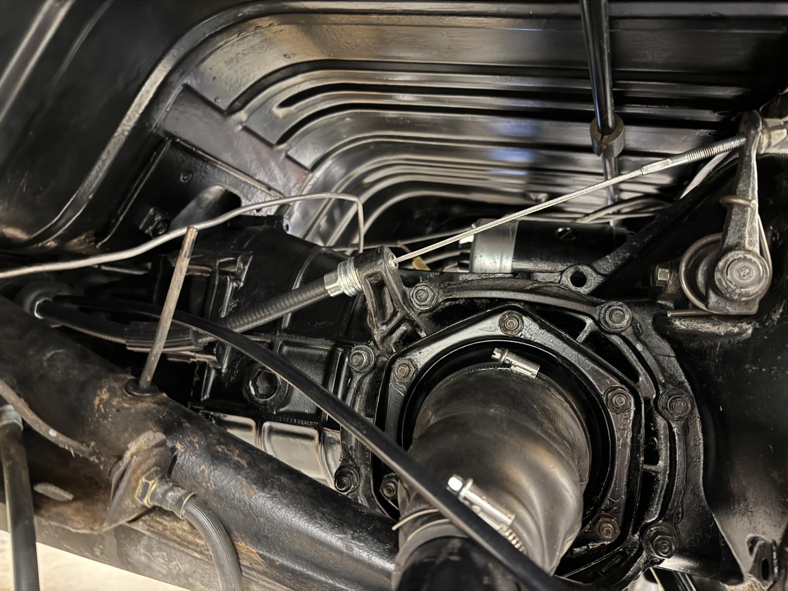

my3bugs wrote:
...if you double click the pic it expands to see better .
Since you are dealing with the line that goes across over the nose cone, this is a great picture.
While you are taking it out, there will be one or two little metal tabs folded over the line to hold it in place that are easy to deal with if you know that is what is going on.
I replaced mine by jacking up the car (supporting it with jack stands and also sliding the stack of rear wheels under the car as a redundant catchall) and working from the passenger side and underneath. I pre-bent the new line approximately matching the old pieces (but more gentle curves rather than tight right angles) and fed it up and over, but unbent and re-bent as I went along. I was not able to precisely match the exact shape of the original but did manage to feed it up and over the other side.
General thoughts from experience:
True copper lines are much easier to work with compared to steel or copper coated steel.
Both rubber rear lines are ripe for replacement regardless of how they look on the outside, as they fail from the inside. So those go in while the rear system is opened up.
Removing the bolt from the T fitting so it can float around makes it easier to get the lines started when threading them back in, but bolt it back down before final tightening.
When disassembling, I use a Mapp gas torch (yellow bottle at the hardware store, it's hotter than propane) to get the little fittings almost red hot before using the wrench. Every time I try to force a little brake fitting without the heat, I round it off with the wrench, or twist and break the line, making for a very frustrating afternoon. The fittings are frozen in place for 50 years so every time now I go full hot first and it always works. Make sure to cut the old rubber line first or the boiling brake fluid will burst out unpredictability scaring the heck out of you.
On assembly I use a thread dressing (like Permatex silver) to let the threads slide easy when tightening the little fitting so I don't round off the head.
You can do it!
P.S. it's much easier with the engine out as you have more access, but this it totally doable, as I have done it on two of my cars in my driveway
P.P.S. the one along the tunnel is totally doable as well and I first removed the drivers and rear seats, the pedal cluster and the master cylinder to have access.

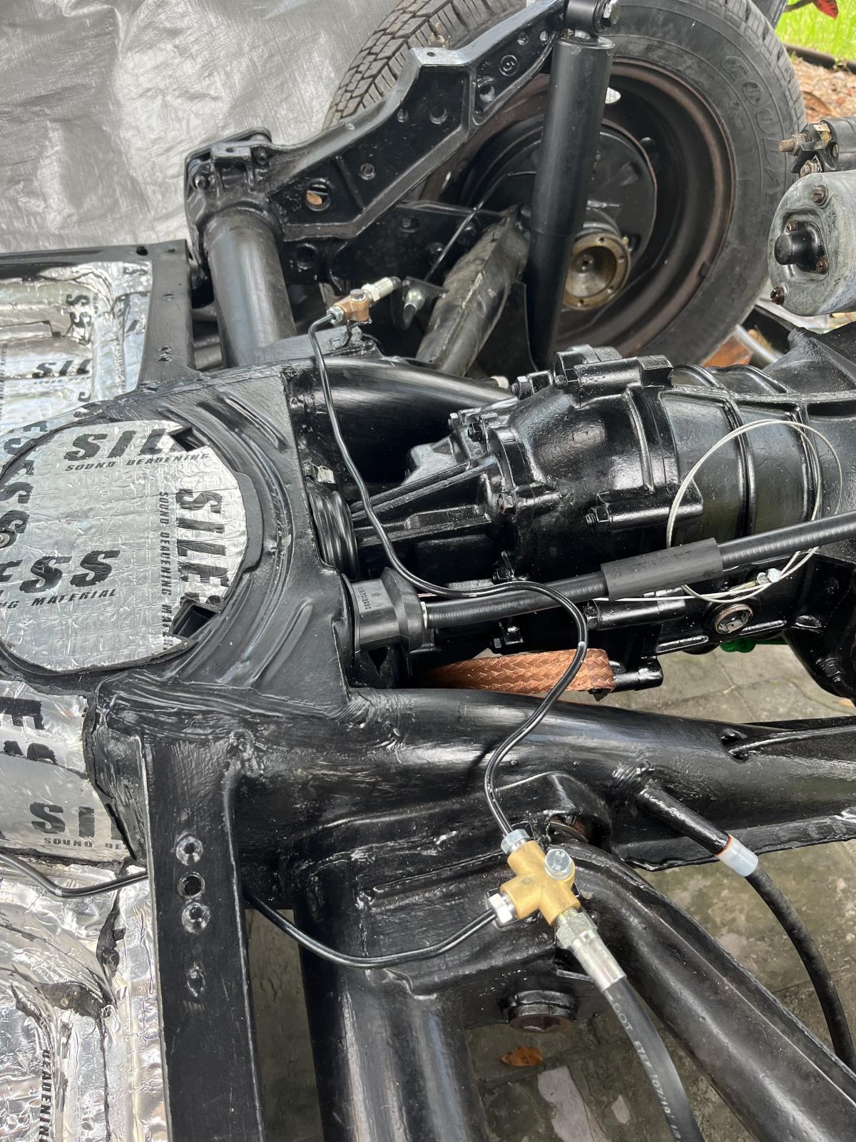

PostPosted: Wed May 14, 2025 4:54 am    Post subject: Re: Replacing brake line. Rear T to right rear. Reply with quote
That picture is for a swing axle, the IRS brake line routes differently I think. A bit harder to get to. Heres how my '69 routes.

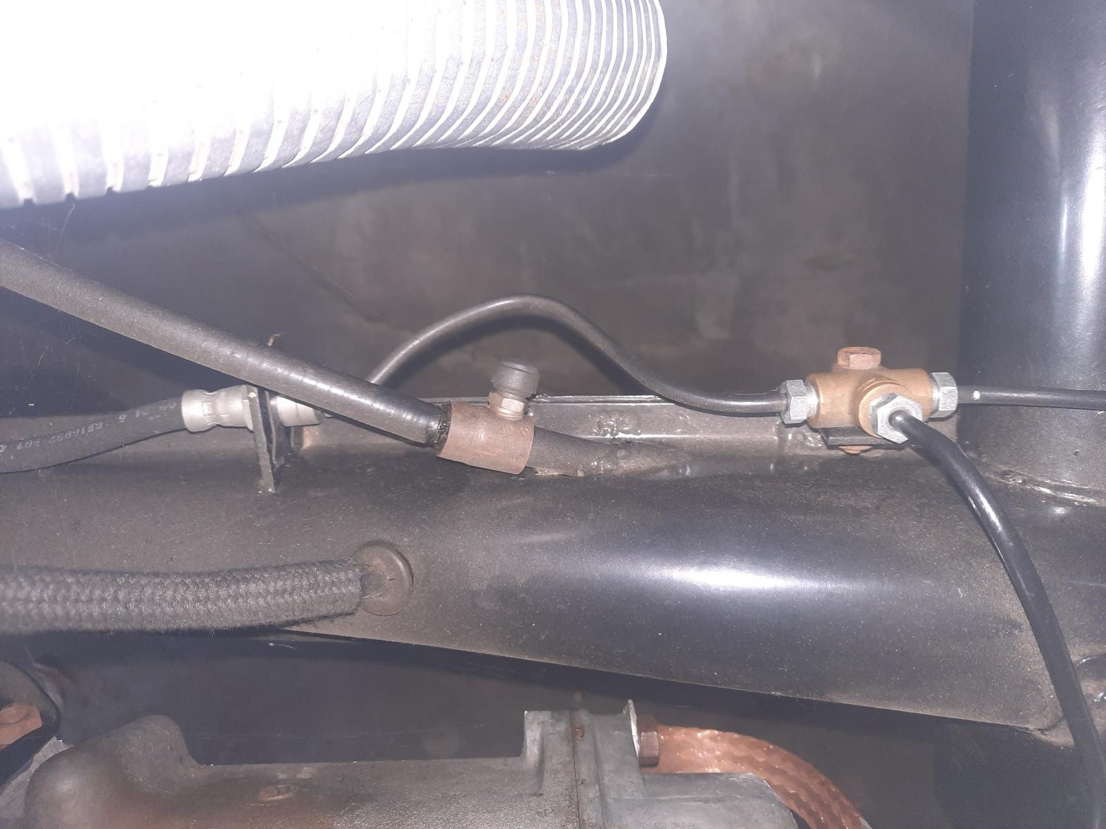

PostPosted: Wed May 14, 2025 5:33 am    Post subject: Re: Replacing brake line. Rear T to right rear. Reply with quote
This is how it is routed on the 71 super. Line is popped somewhere just before the first right angle (closest to the nosecone) on the passenger side.
