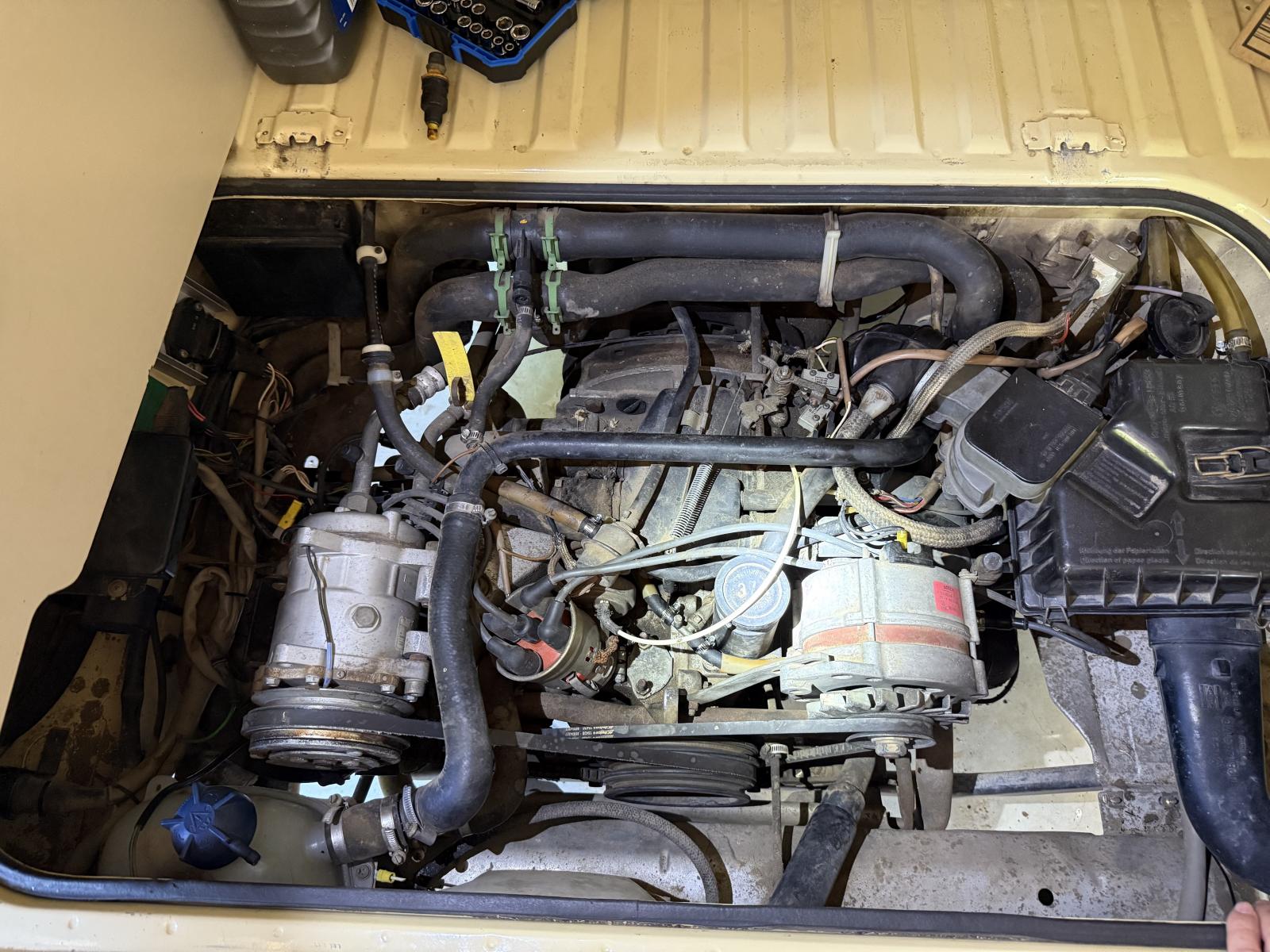

Here are some photos that I had on hand. Let me know if you would like a photo of a certain part of the engine, and I'll take one next time I'm out working on it. Also, here is a picture of the small hose that was fitted into the normal-sized hose. appears to be hard plastic. It was fastened inside with a hose clamp around the larger hose. Pen for scale, if that even helps. They had these running from Tank->Prefilter->Engine and back to the tank from the top of the Fuel pressure regulator (FPR) but it started about half way. The FPR has been replaced since this photo was taken. I pulled the injectors and turned the key and they sprayed gas into a towel I was holding.

That plastic hose appears to be the stock lines that all Vanagons came with from the factory. It's actually less of an issue than rubber fuel hose which degrades fairly quickly and needs to be replaced routinely. The plastic lines seem to last forever without degrading. Definitely nothing to do with your starting/running issue.
It would help if you answered all of the questions I asked in my prior post.
