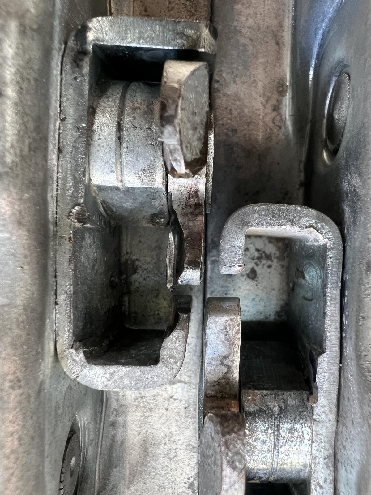

Here's how to know if a latch is going to cause anger and frustration.
Hard to tell from the pic, but years of loose maladjusted slamming have thrown up a huge burr and worn a groove in the latch pawl.

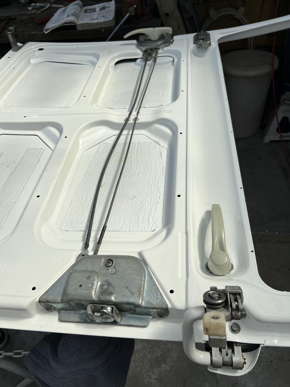

On left:
We also had the cable connecting the mechs broken at the threaded adjuster section.
Didn't get a pic...
Everything cleaned and re-greased.
"New" wear parts like the fiber block.
(That same fiber block i got new from the dealer in 1994 BTW Wink )
We're getting there. Sliding door nirvana.
Elephant... Bite bite.

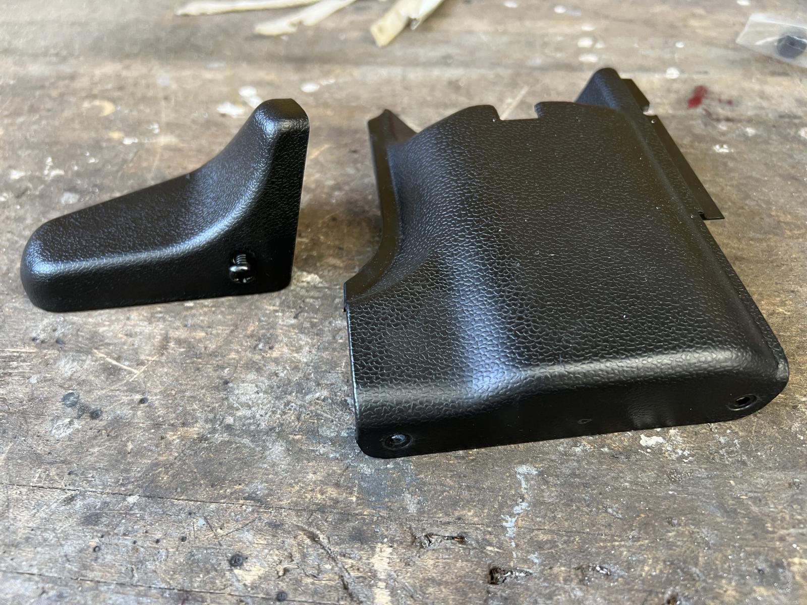

Finished getting all the best of my door stuff cleaned, lubed and properly fastened down.
Owen got out the vinyl dye and did the plastic trim pieces all
Prettypretty.
Drilled/tapped the bracket for a machine screw and even painted it to hide.
Retentivity obviously runs in families…

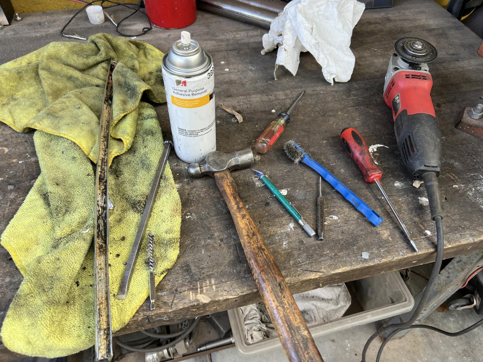

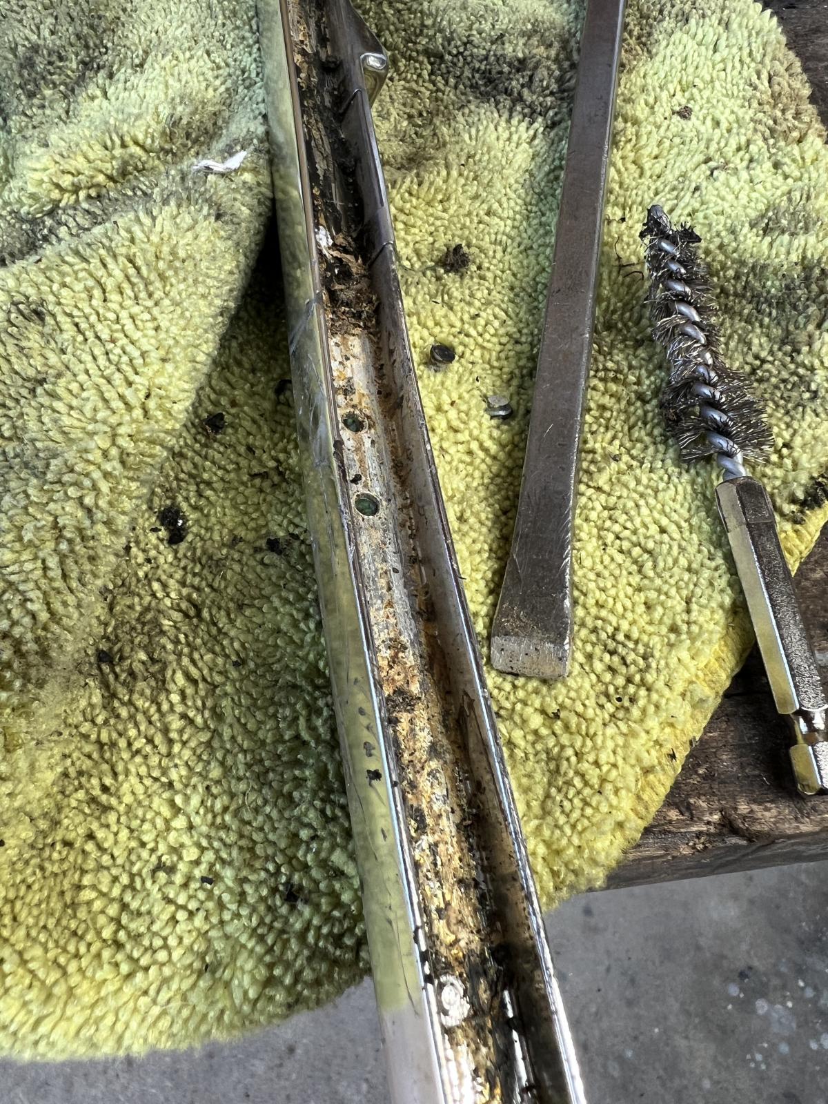

Prepping channels for new felt tracks.
Scraping old gasket glue.
Adhesive remover is the key ingredient.

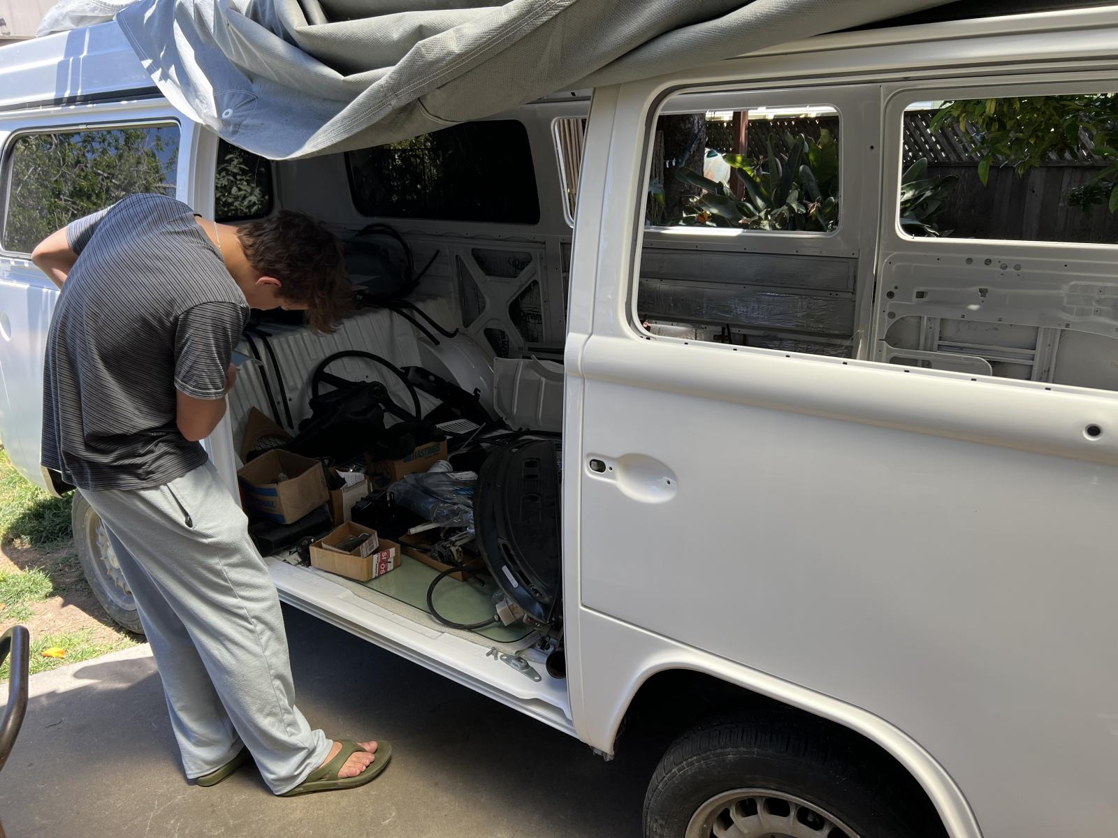

Here's big brother pushing his dad to hurry up.
