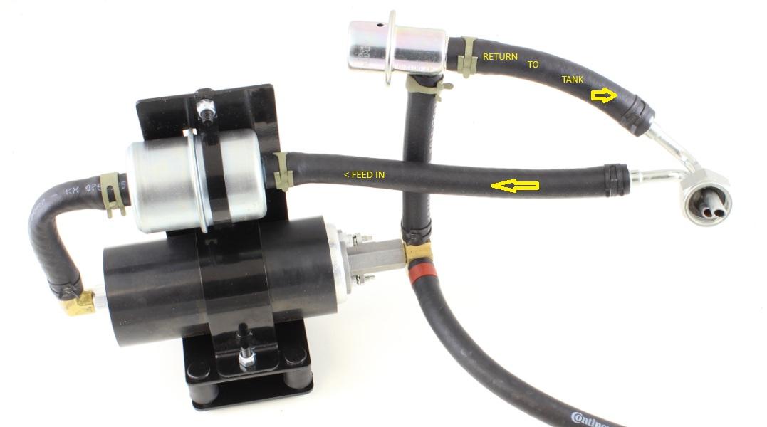

Looking at the installation PDF, it looks like a 2nd return line is not installed as part of this kit...?

PostPosted: Fri May 16, 2025 5:21 pm    Post subject: Re: Washburn EFI for 1600 Bug Reply with quote
In the pics from your first post there is a pic of the return line. Not sure what you mean by a 2nd return line.

Other than that picture, I didn't find a reference to a 2nd fuel line in the installation PDF. I spoke w/the maker and he confirmed that he uses a single line, no 2nd return fuel line from the engine bay to the tank.

PostPosted: Mon May 19, 2025 12:23 pm    Post subject: Re: Washburn EFI for 1600 Bug Reply with quote
There is a return line in that link also. It's from the FPR and goes into the bottom of the tank right where main feed line to the filter > pump .

PostPosted: Sun May 25, 2025 10:26 am    Post subject: Re: Washburn EFI for 1600 Bug Reply with quote
So that looks they dead- head the feed to the injectors, teeing the pressure regulator off the pump rather than cooling the fuel lines past the injectors by putting the pressure regulator on the far end of the fuel rail.. Interesting to find out what happens when things get hot.

mikedjames wrote:
Same concept as an in-tank returnless pump such as those available from Holley for their EFI systems. I'm running one on my super right now and so far no issues.

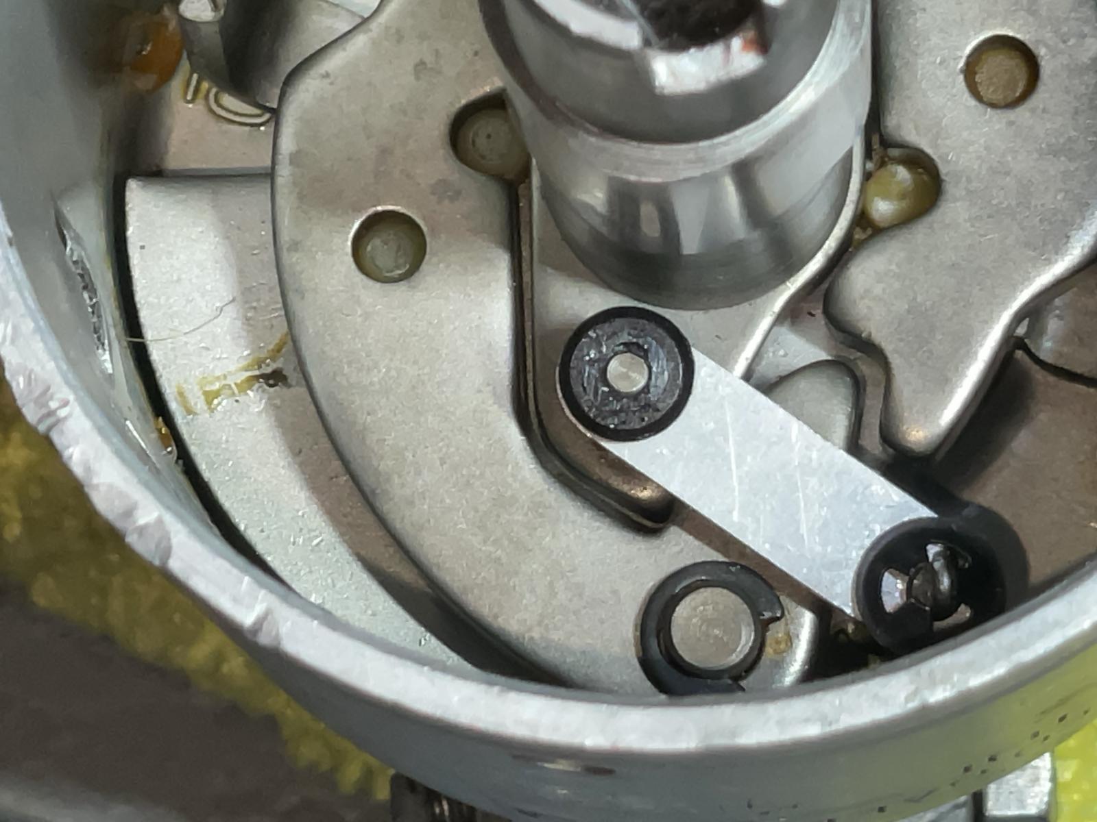

This one doesn't appear do any programmable timing control either. At least there is nothing for reading crank degrees, unless they are using the stock distributor for that? Not sure how they would alter the timing then?
The distributor gets locked so it doesn't advance. The kit uses the existing PerTronix Ignitor Ignition for timing. The red wire provides power, and the black wire is used for the trigger. The MicroSquirt system will use the trigger wire to fire the spark plug for advance. The distributor needs to be set at 12 degrees, and the ECU will handle the rest.
