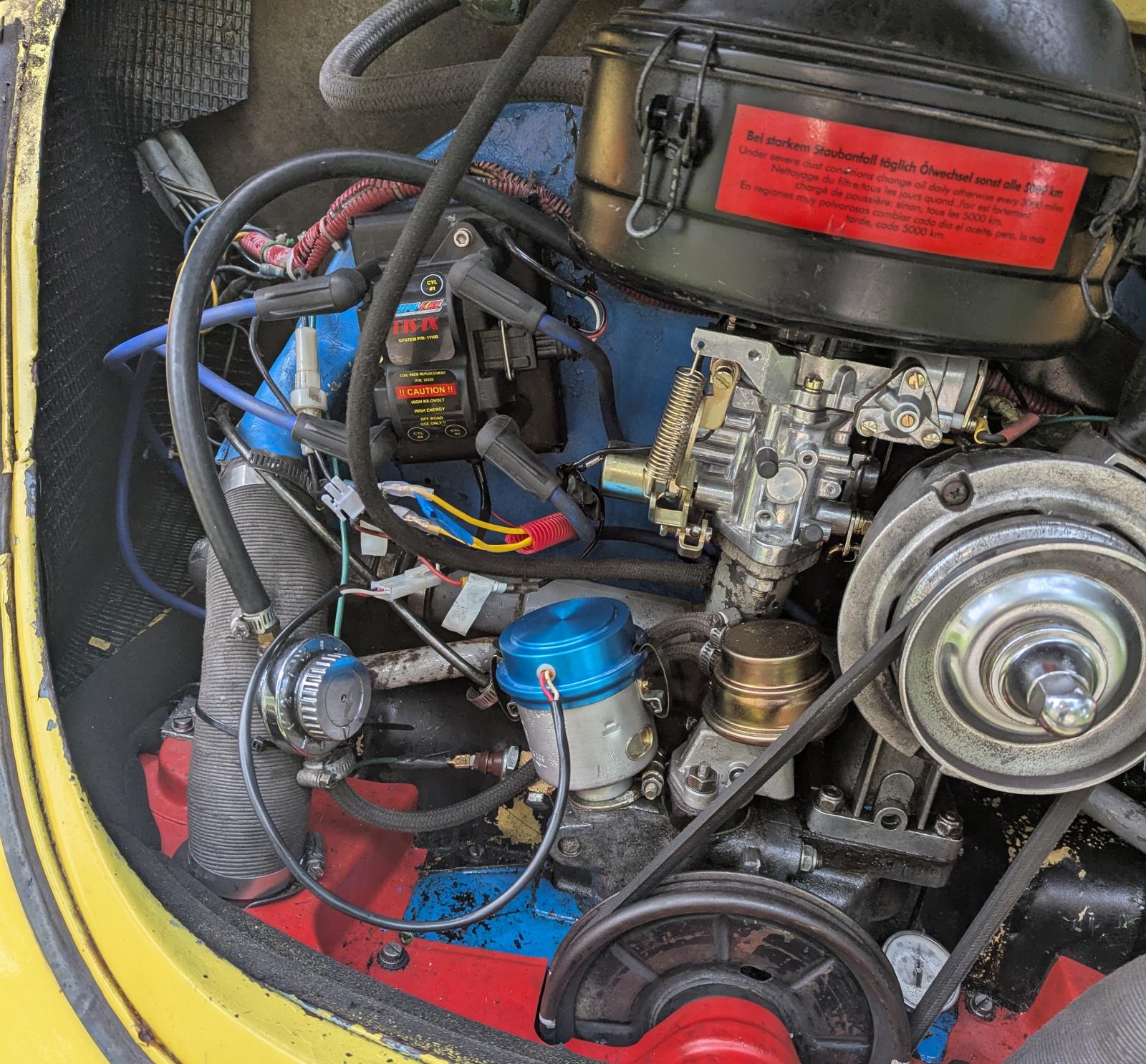

Re-installed the Compu-Fire DIS ignition system today because, well, why not? I paid for the damn thing, might as well put it thru its paces. Spark plugs gapped at .050. Or is it .50? I had tried this a year+ ago, but coincided w/a coil having gone bad previously and I'd misinterpreted dirty carb issues as another coil problem and removed it. Turned out the carb was dirty. Anyway, it ran great on 30-mile highway run. We'll see how it does during June's driving.
One thing about this car is that oil temps never reach 200* on a mild day like today (73* & partly cloudy), even on a 30-mile highway run at 70 mph.
And....the problem w/the right turn signal/flashers came back again during today's 30-mile highway run. Sucks. Not sure what other grounds I can clean on this thing.
One easy repair which could hopefully fix the grounding issue is to run a dedicated ground wire from one of the blinker's attachment studs to one of the fender bolts; ideally the bolt closest to the blinker near the top of the fender bolting flange. 20 or even 22 ga. wire is enough, solder on the round terminal lug ends and apply shrink tubing. Use dielectric grease on each lug to protect against rain water splashing up inside the fender. Run a M8 x 1.25 tap through the threaded fender hole in the body to clean out any rust.
Were you able to drive up to the June Bug meet in PA yesterday?

For grounds for lighting what you can do is take a small wire and use it as a ground wire. You will hold it to a ground on the car such as the bumper and then the ground on the light assembly. If attaching this ground wire makes the lights work you know it is a ground issue. You can then either trace the ground or just run a new one to the fender.

Rome, I didn't make it to June Bug. I went last weekend to Summerduck here in VA and found some of the parts I was looking for...so instead stayed to install the DIS ignition and try and ID WTF keeps causing my blinkers to go on the fritz. Hope to take the various recommendations for alternate grounds this afternoon to see if I can ID a definitive cause/solution.
It's frustrating because it's intermittent at times. They'll work normally then in the middle of a drive they go bad.
