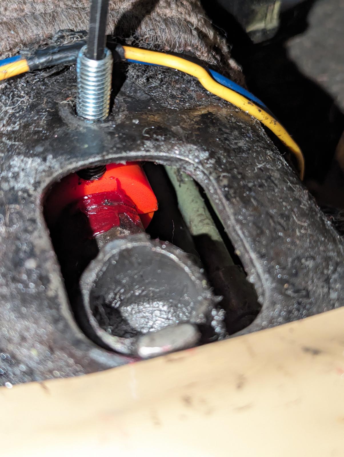

I've had the CIP1 split red one on my daily driver '73 Super for 18 months now. So far, so good, perfect feel to the shifter. And Super easy to install!
