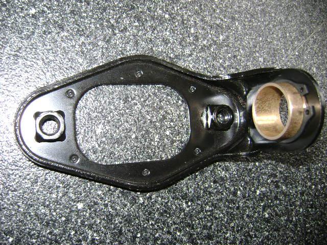

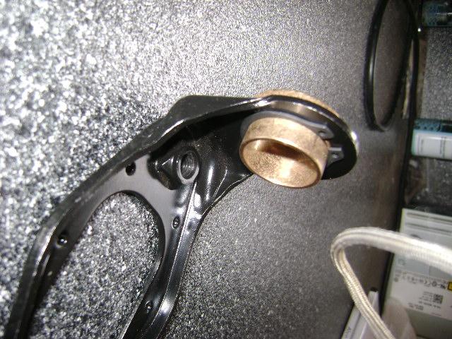

I believe the Bronze Bushing is impregnated with oil... i keep it greased. It is possible to slide the Scat Drag Fast Shift Boot upward and reach in with a long Screwdriver to add grease to the Shaft. Worse comes to worse if the Bronze Bushing wears, the Shifter will be removed and i can always reach in, unsnap the snap ring, remove the Bushing and install the traditional Shift Shaft Bushing. Which'll have no effect on the new Bracket i welded in. I will report back if and when any problems arise.

I was just wondering how you will be able to "reach in" and unsnap the snap ring, taking into consideration that it was installed at the back end of the bracket--at the opposite side that you would be able to access from the shifter opening, that is
I also remember graphite-impregnated bronze or brass bushings that we used to use on the pivot points of the lower sections of springer front ends on motorcycles, back in the early '70's; but I have to wonder how oil can be impregnated into molten brass or bronze.
Even so, a bit of grease maintenance every once in a while, should keep the bearing from wearing for many years.

Damn!! I installed it the wrong way... LOL! Take a closer look, the snap ring is on the front side of the Bracket.

Haven't got to that point, but my idea was to use the snap ring pliers. Maybe I can give it a shot when I need to re-grease it. All I remember was that my pliers can reach to it but never really tried. The whole idea was borrowed from the add that was posted on the classifieds, but his was steel vs bronze? Steel would probably last longer but would still need a lot of grease I would assume.
I don't think you installed it wrong. The snap ring should go on that side because that's where the rod feeds through. I believe the one posted on the classified ad is setup the same way. Once you get the snap ring off, then you just push the bushing out with your finger. It would be harder to get the snap ring off from the other side.

PostPosted: Mon May 02, 2016 10:18 am    Post subject: Re: Shifter rod hanger broken Reply with quote
63vdubbug wrote:
I don't think you installed it wrong. The snap ring should go on that side because that's where the rod feeds through. I believe the one posted on the classified ad is setup the same way. Once you get the snap ring off, then you just push the bushing out with your finger. It would harder to get the snap ring off from the other side.
Very true ... thats what the... "LOL" was for. Snap Ring goes on front side of Bracket.

dcarlson12 ... I've heard of ppl on this Forum using Steel Pop-Rivets, probably their lack of a wire welder, but i would never use Aluminum. As far as removing the Snap Ring, i would think you could just reach in with a good set of Snap Ring Pliers and remove the Snap-Ring from the front...then push the Bushing to the rear and catch it in the same Hand, then go on replacing it with the Nylon Bushing as if the Bronze Bushing was never in there. My Snap-Ring fits tightly against the Rear Bracket, maybe that is why i don't get a "Rattle".. but, i also carry a new Nylon Bushing in case the Snap-Ring comes off.

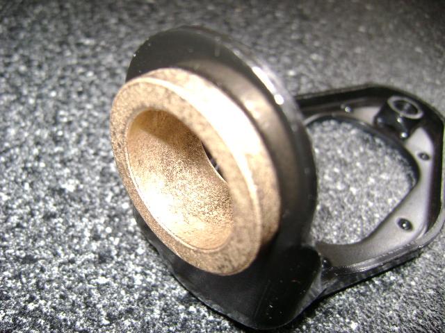

The bushing itself should last a long time, but the methods used in this thread are cutting that lifetime in half. Why? Because machining the snap-ring groove is creating a thin spot in an already thin-walled bushing.
An alternative might be to start with a thicker-walled bushing, and just bore (open up) the receiving hole in the bracket to accommodate the larger diameter bushing...then after grooving for the snap-ring, there is still more material left over for the lifespan of the bushing.
Just brainstorming from my armchair. And if you wanna see a crapload of bronze oilite bushings in every size, go to McMaster dot com.

The only machining you had to do was the snap ring grove?
