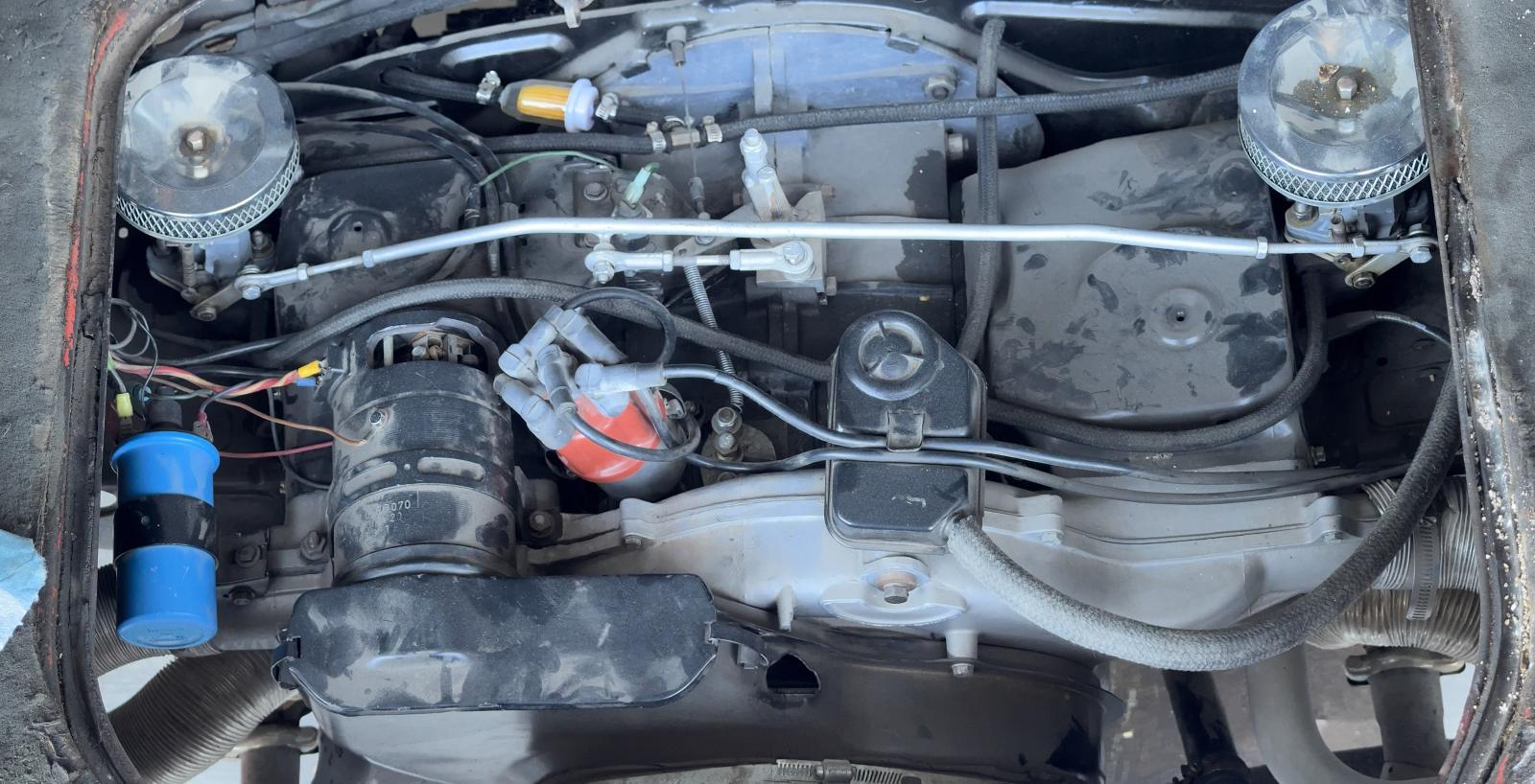

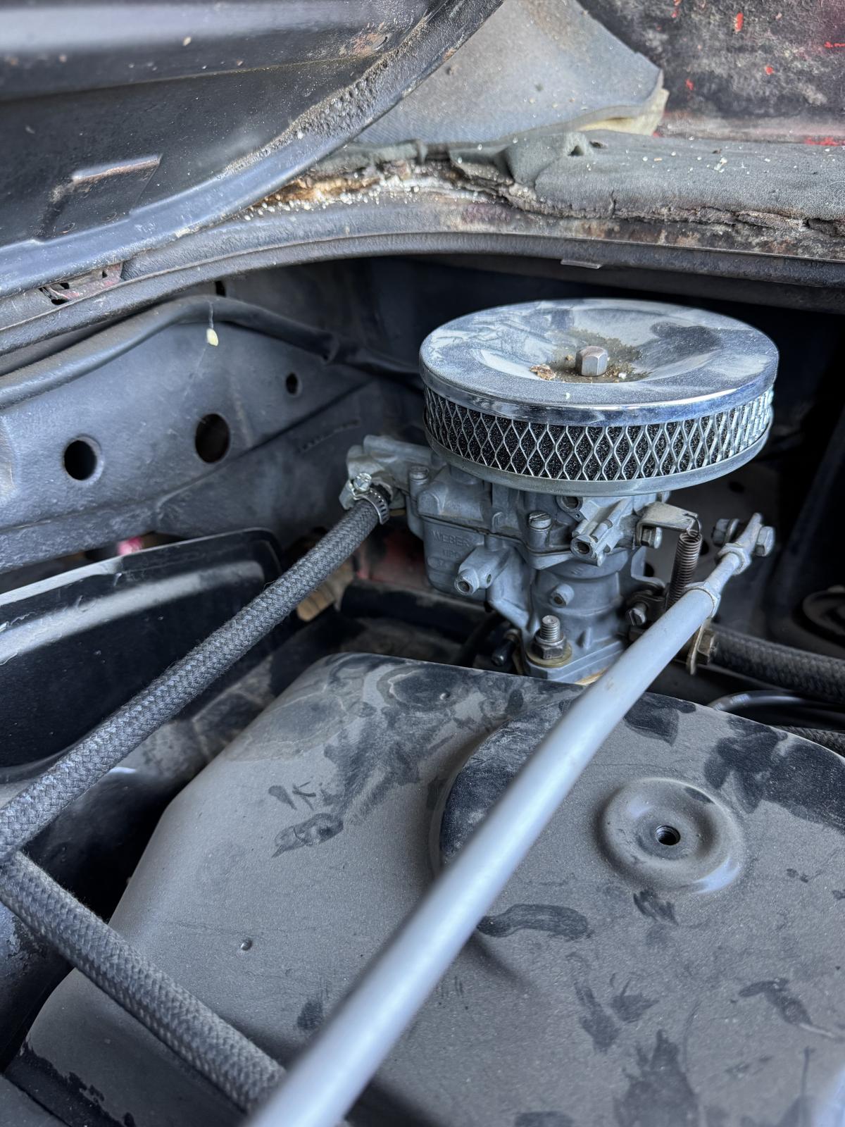

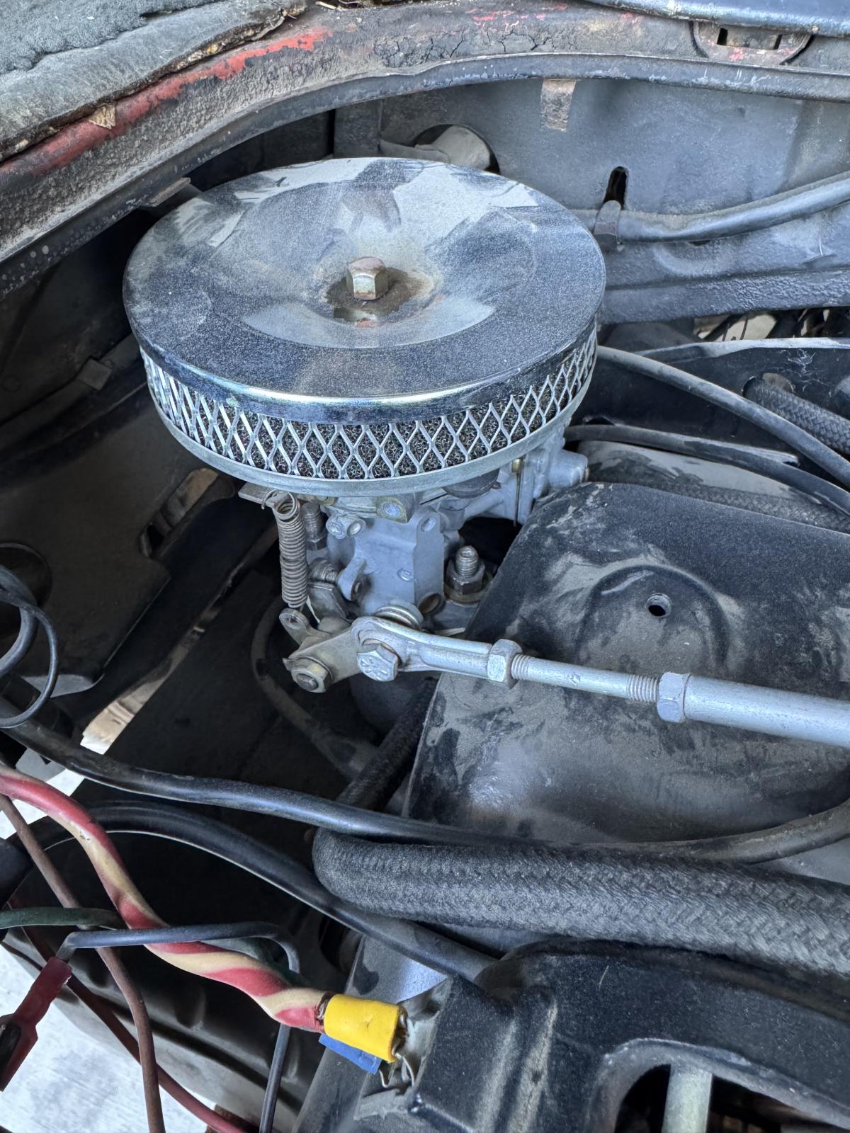

As this car is new to me and the fact I dont know alot, i had to go look. Honestly, i had to look up what a kickdown switch is.
I dont see one based on the pic's i looked up... here are a few pics of the engine bay.... (yes, I'll be removing the plastic filter)

Looks like an aftermarket linkage, without a provision for a kickdown switch, so you'll have to get creative.

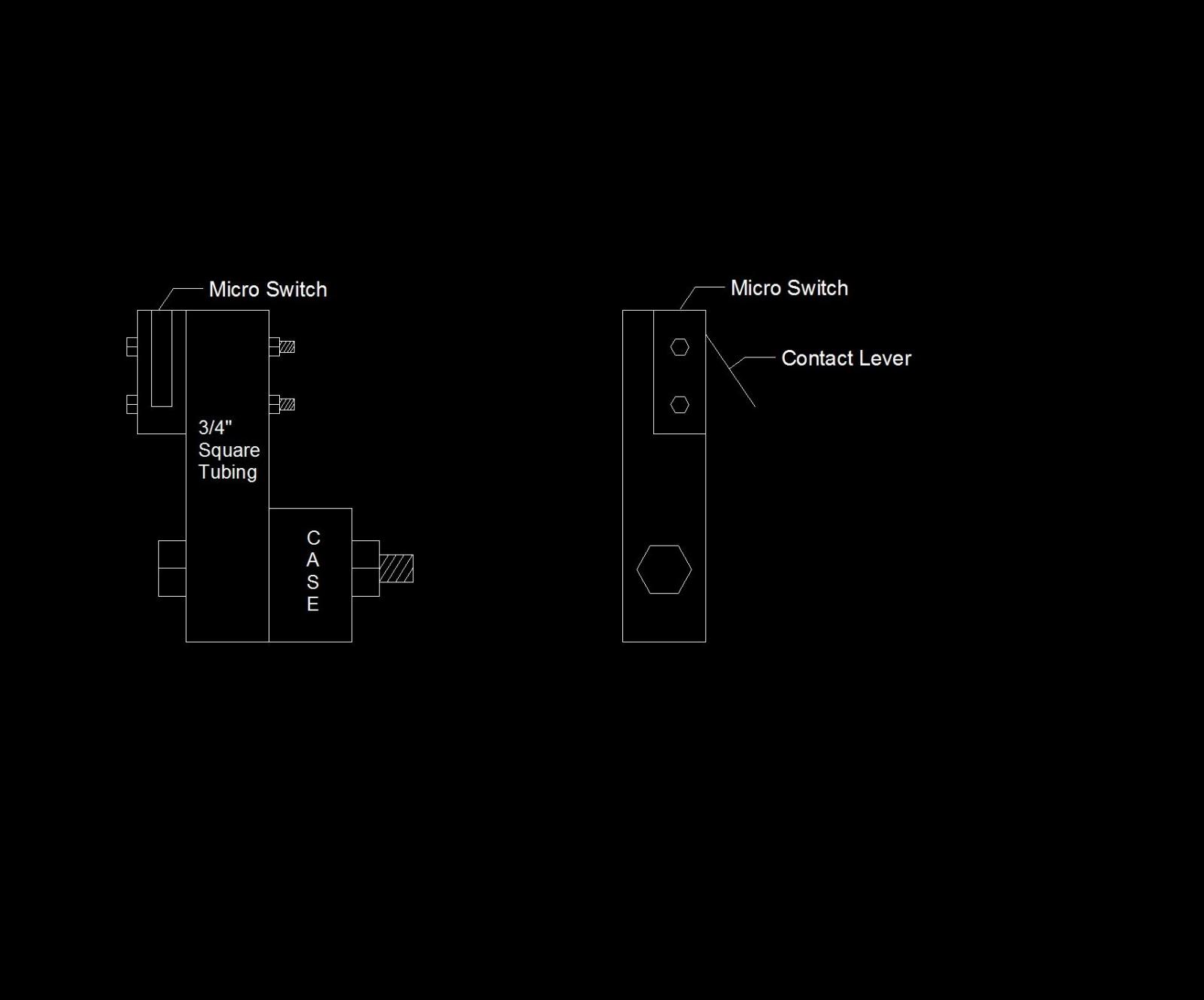

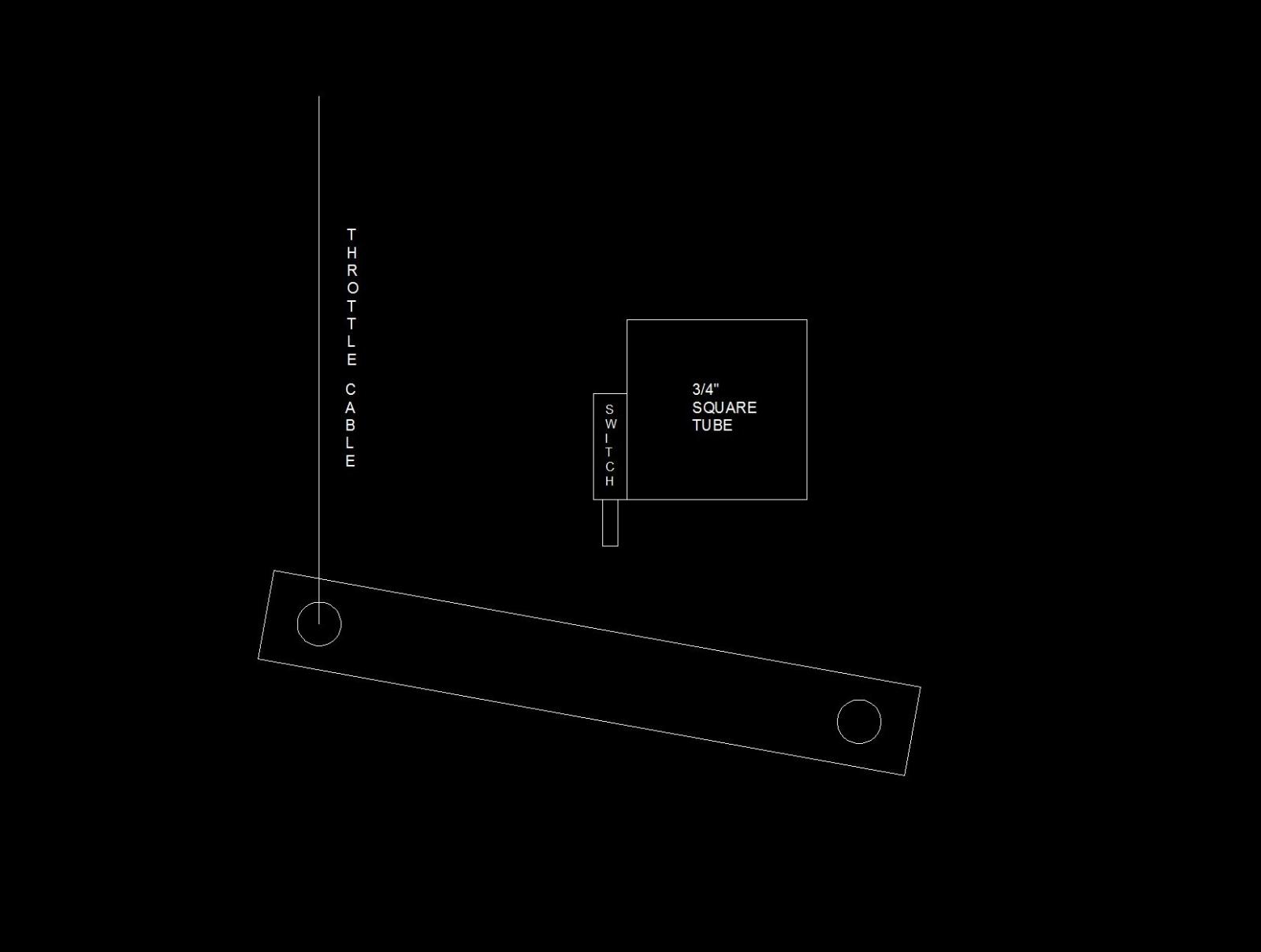

Honestly, I have been using some form of non stock kick down switch with out the spring for about 15 years. You just set the switch to where it closes at WOT. I drew up a little diagram of what the OP could put in his car if he wanted kick down capabilities (he really does Very Happy )
First off here is the type of switch that you would want.
Here is where you would put it.
Here is the drawing of the assembly.
As you can see, it could be made with the most simplest tools. Just a hacksaw, and a drill. Once you experience the advantage of having the kick down switch, you never go back without one.
