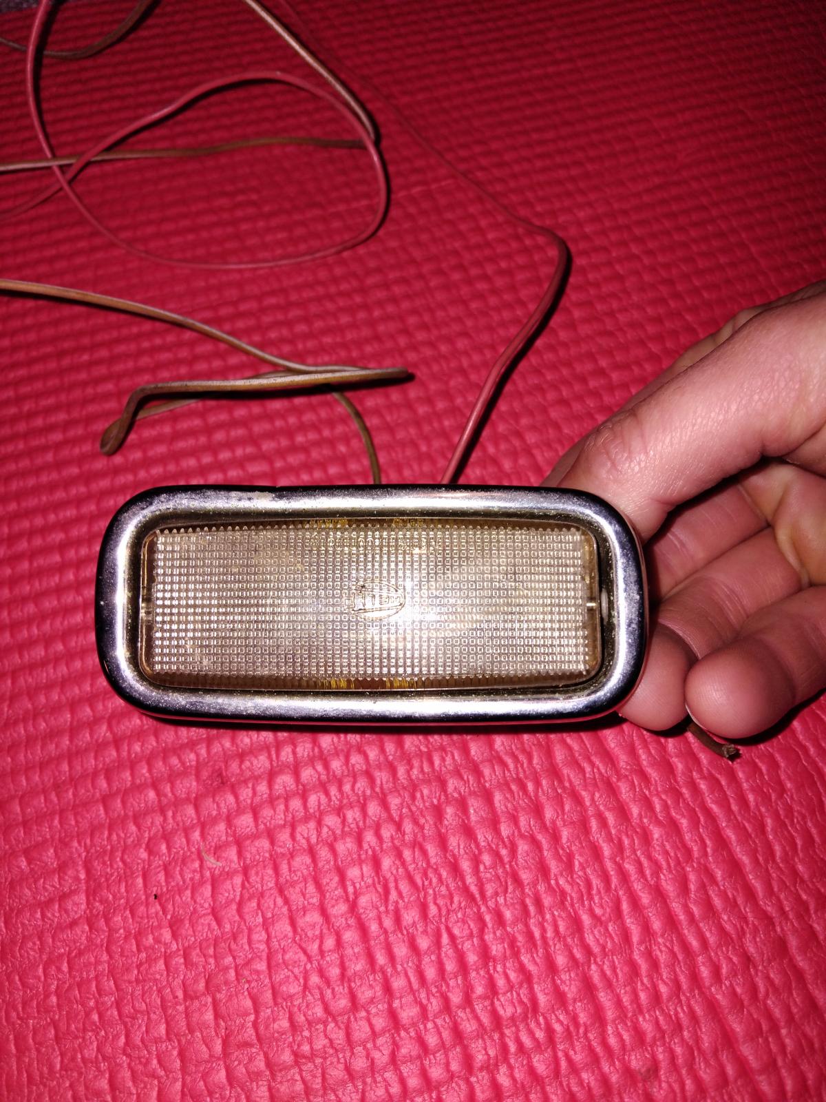

Hey Samba team.
I'm going through some old kombi and beetle bits and I have found this light. I can't seem to determine what its from. Can anyone help? 10w hella made in Germany. Cheers!

from a type 3, I reckon...
https://www.thesamba.com/vw/classifieds/detail.php?id=2275281

Yes and also type 4.
311 947 111 B

And also 356C.
Doesn't belong on any 58 - 67 Beetles.

Yeah, it's Type 3. They don't fit in the Beetle body. Unless you cut the hole larger... and I did this in my Baja bug when I re-did the headliner.
I did that because I like the design of the Type 3 dome light where you rock the lens to turn it on or off.
