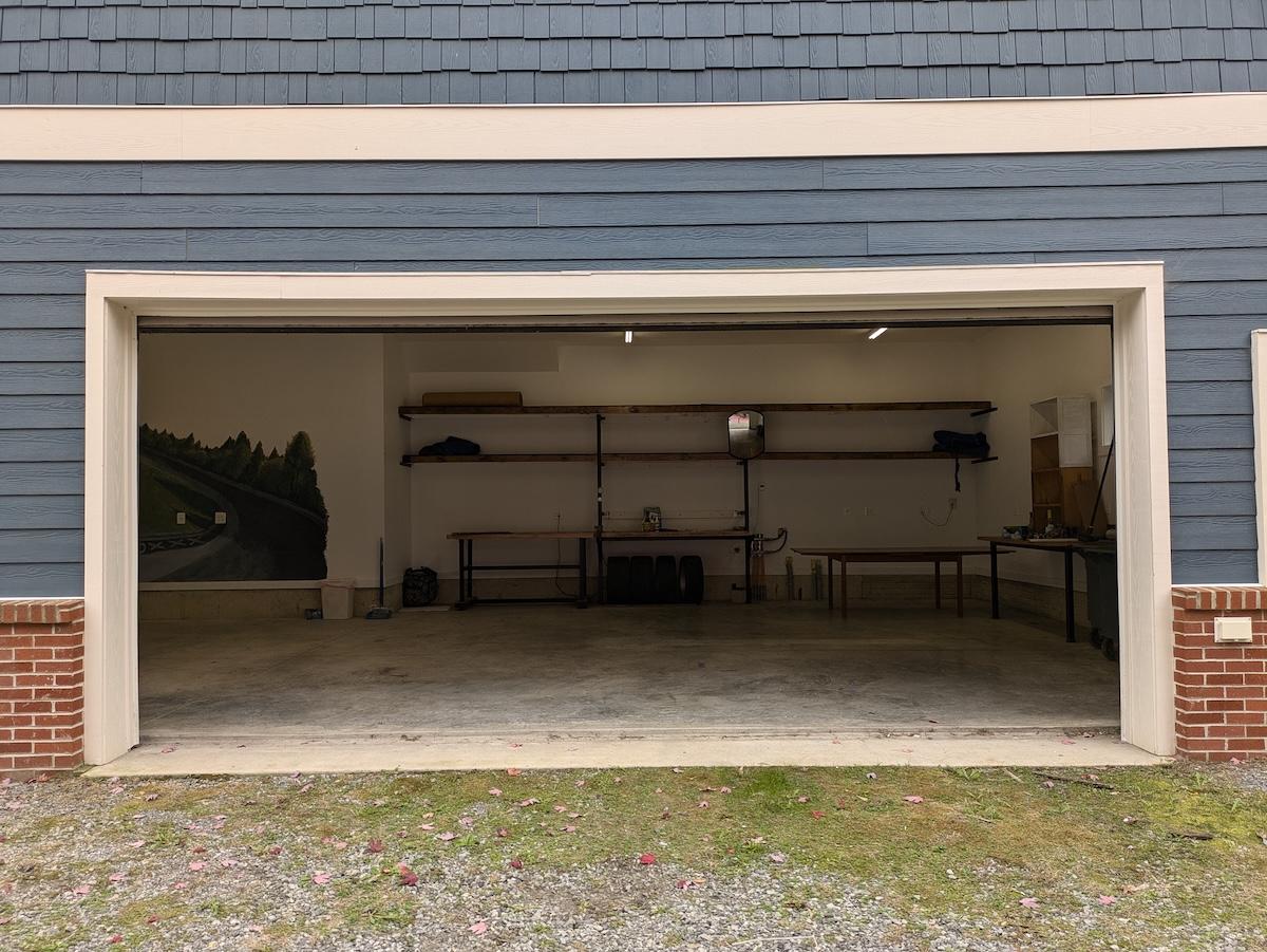

When I saw this pic, it saddened me a bit. It feels like your VW hobby is over and you're moving onto another one.
Will you be resurrecting your VW life in your new country?
At any rate, I wish you well in your future Expat adventures.
