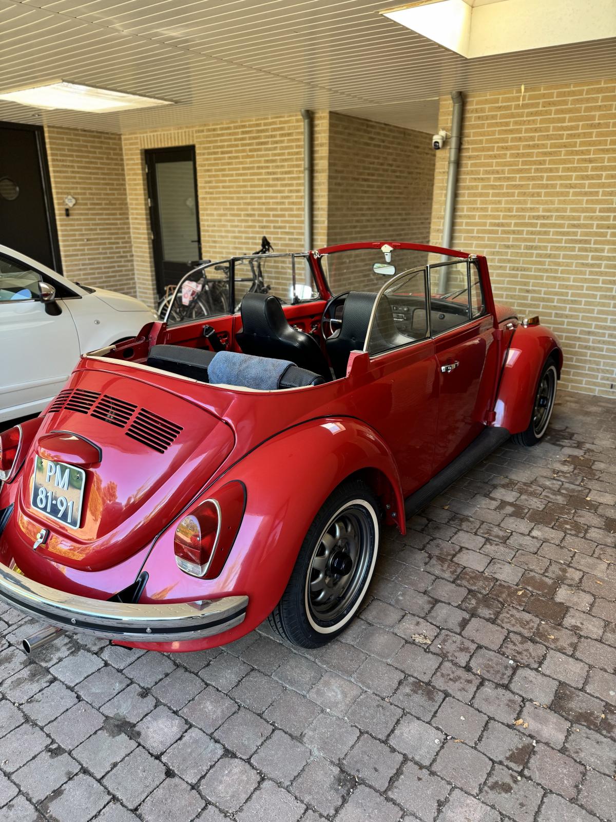

Practiced my polishing skills today.
My 71 super convertible project: https://www.thesamba.com/vw/forum/viewtopic.php?t=765788

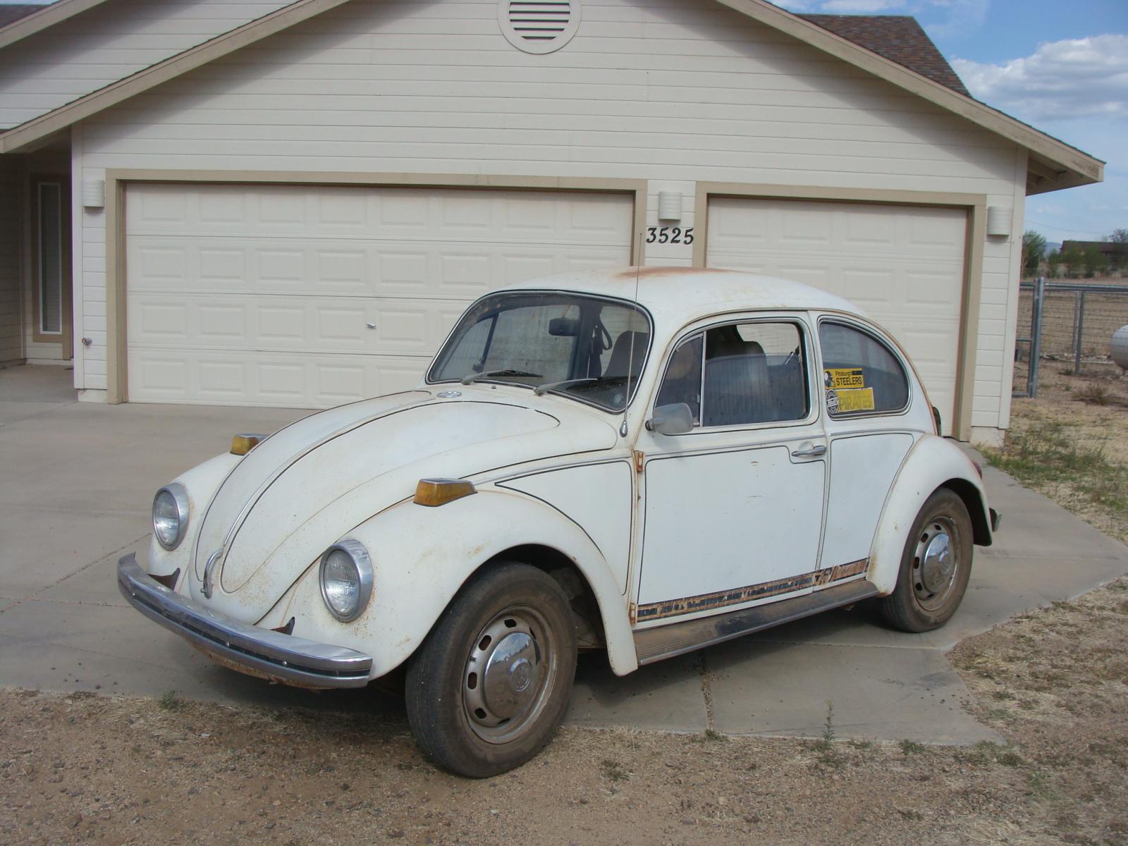

Picked up a standard 71, mfgr date 5/71. Now for the fun part of correcting the previous previous owners weird things he did, like took off the dog house oil cooler and fan shroud and replaced it with the oil cooler inside the fan shroud. Its an AH case and I'm pretty sure it came with dual port heads but he replaced them with single port. But theres no body damage, its got a lot of things on it like roof rack, aluminum running boards, empi 8 spokes and its already lowered. The engine is a little rough but it drives

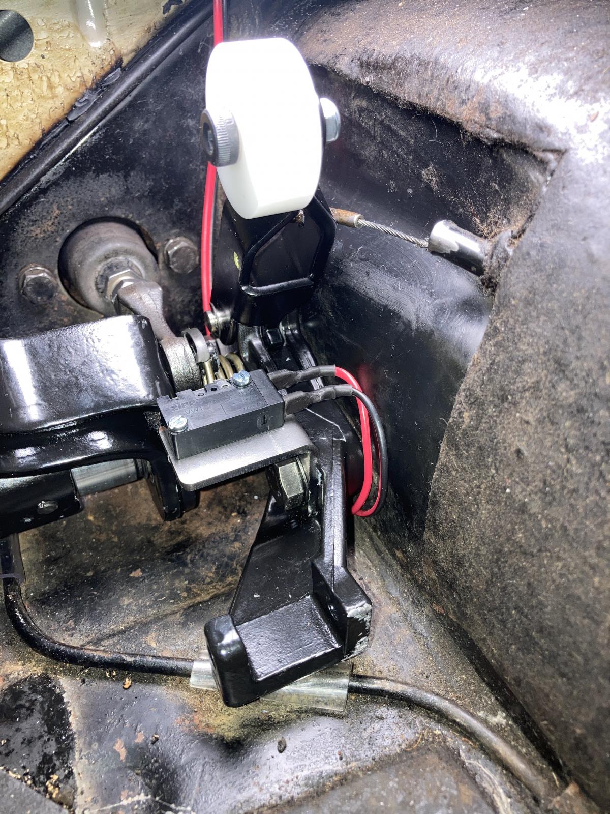

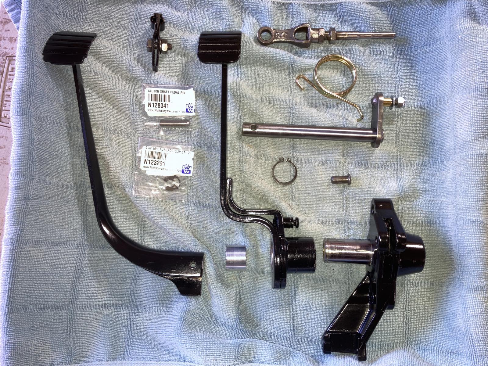

Finished up a pedal cluster refresh with upgrades on my '69 (have already done this on my '63).
Installed a Big Boy Clutch Pedal Extender Kit and X-celerator Speed Wheel Kit from Classic Bug Parts.
https://www.classicbugparts.com
Also installed a brake pedal switch from Air Cooled Evolution to trigger the brake lights the moment the brake pedal starts to move forward.
https://www.aircooledevolution.com/product-page/pedal-activated-brake-light-switch
Though the pedal switch kit doesn't include a relay, I chose to wire it with one so the micro-switch and the 18 gauge wire supplied in the kit only need to deal with the very small amount of current needed to trigger the relay rather than carry the full current load for the lights. This will extend the life of the micro-switch and provide a more reliable current path to the bulbs.
Brake pedal micro-switch and the speed wheel accelerator.
The clutch pedal extender spacer moves the pedal ~ 3/4" ... which doesn't sound like much, but it makes a big difference. Very Happy
Pedal cluster with all upgrades. Note that the accelerator pedal that comes with the speed wheel kit is noticeably taller than the original pedal.
Sounds like he built a 1600cc single port engine from that AH engine and used the doghouse cooler and shroud and dual port intake and cylinder heads on a different engine.
slagathor
Joined: December 08, 2012
Posts: 273
Location: Oakland, CA
slagathor is online now
PostPosted: Tue May 20, 2025 1:43 pm    Post subject: Re: What did you do to your Bug Today? Reply with quote
Cusser wrote:
Yep, pretty much what I'm figuring.

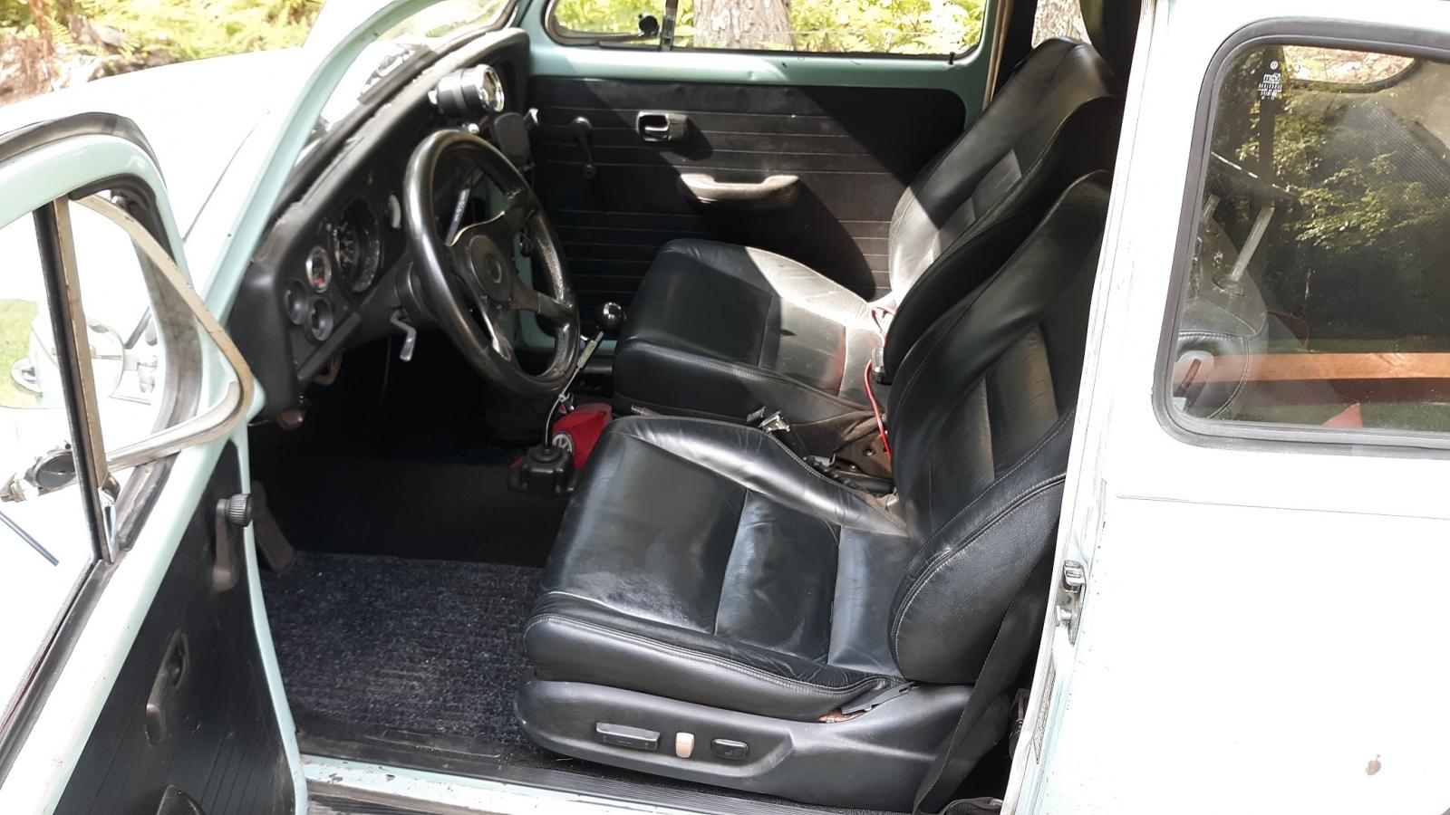

OTTO 1303 wrote:
BIGMIKEY wrote:
Do those seats sit you higher or lower? Same?
Mike T
These seats are actually lower, but have an elevation adjustment which can be higher or lower than the original seat.
ROME is correct about how I did it.
I will document the process in the forum when I have some time.
I see those adapters now that Rome pointed them out. Nice idea and nice job of fabrication. Some adapting was needed too when I put the seats in My 1973 Bug. I am tall and worked hard to put the seat as low as I could.
Mike T
2011 Honda Accord power leather seats.

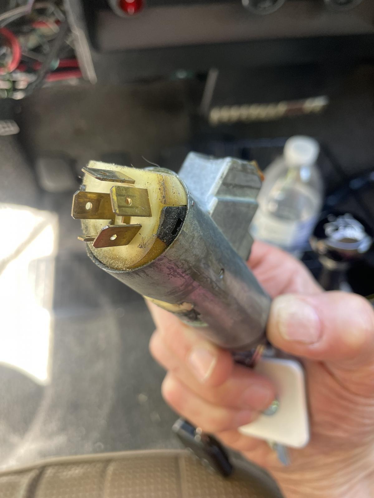

PostPosted: Mon Jun 02, 2025 4:34 am    Post subject: Re: What did you do to your Bug Today? Reply with quote
Actually yesterday. Swapped out the 52 year old ignition switch for a new replacement. I think I bought it from Wolfsburg West. I actually started this little project about a month ago but sadly the bug has been sitting in front of mynhouse with no steering wheel and the steering guts out all this time. Other projects. Anyway, after bundling all together the car would still not start, battery dead. Charger for about an hour and then roared (as much as a beetle engine can roar) back to life. We'll see if the new switch solves my interment starting issue. This was a relatively easy project but undoing all the stacked crap in the steering column was a bit intimidating. Especially getting it all back together.
Washed down and drove all day. Even up to Greenwich, Ct. for their Concours event. Running outstanding.
I did fix that droopy Dead sticker too, that was also easy, ha.

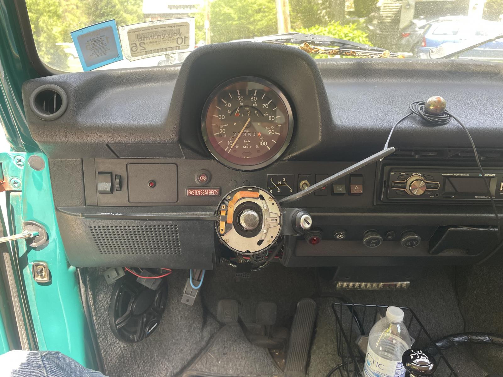

Installed replacement turn signal switch into my 1970 sedan. I had installed a German SWF switch back in 1989.
