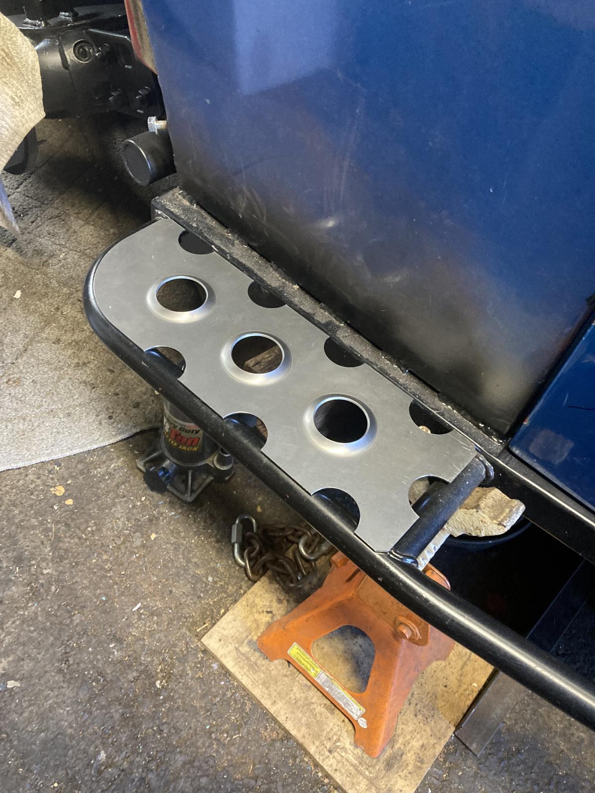

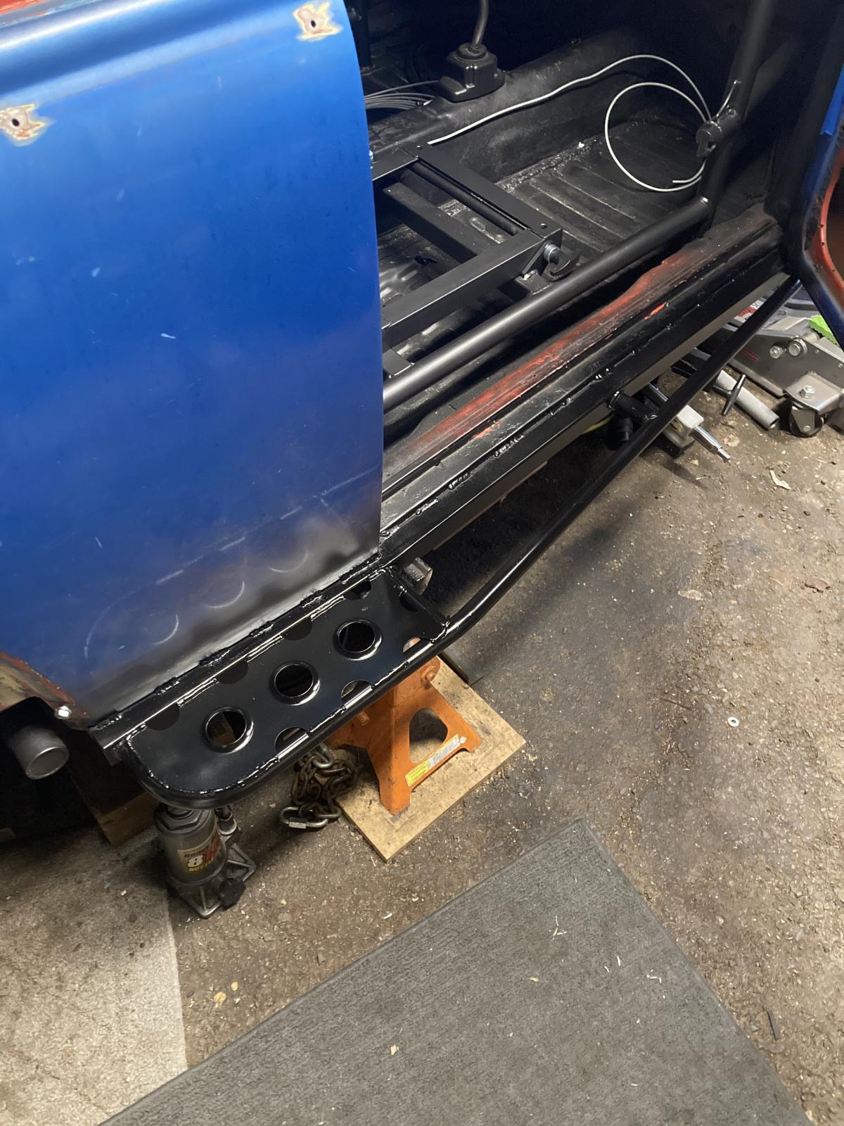

I made my own side rails. I really wanted them to be strong enough to stand on and used as a step for easier access to the roof rack. They also serve as a great easy jacking point along with adding protection.
I molded some square tubing along the body’s channel and welded it in place. The wall thickness of the tube is .120”
I bent some 1x.120” round tube for the railing and laser cut/dimpled the step plates out of .095” sheet.
I really like how they turned out and they’re way stronger than any off the shelf version.
I can post some detailed pics from the making of them if interested.

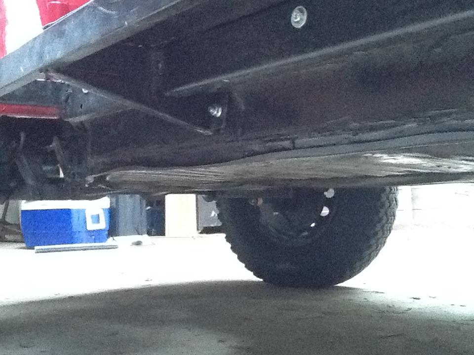

This is what I did
I have a 3” body lift that I have braced to so no upper bar into the body.
Didn’t think it would be strong but it is. Have had several encounters with rocks and a tree stump, and a roll over and they have held up. I put a piece of rubber mat at the door location so that I can step out with bare feet.
Currently I have a metal bucket mount for the gas can instead of just a strap

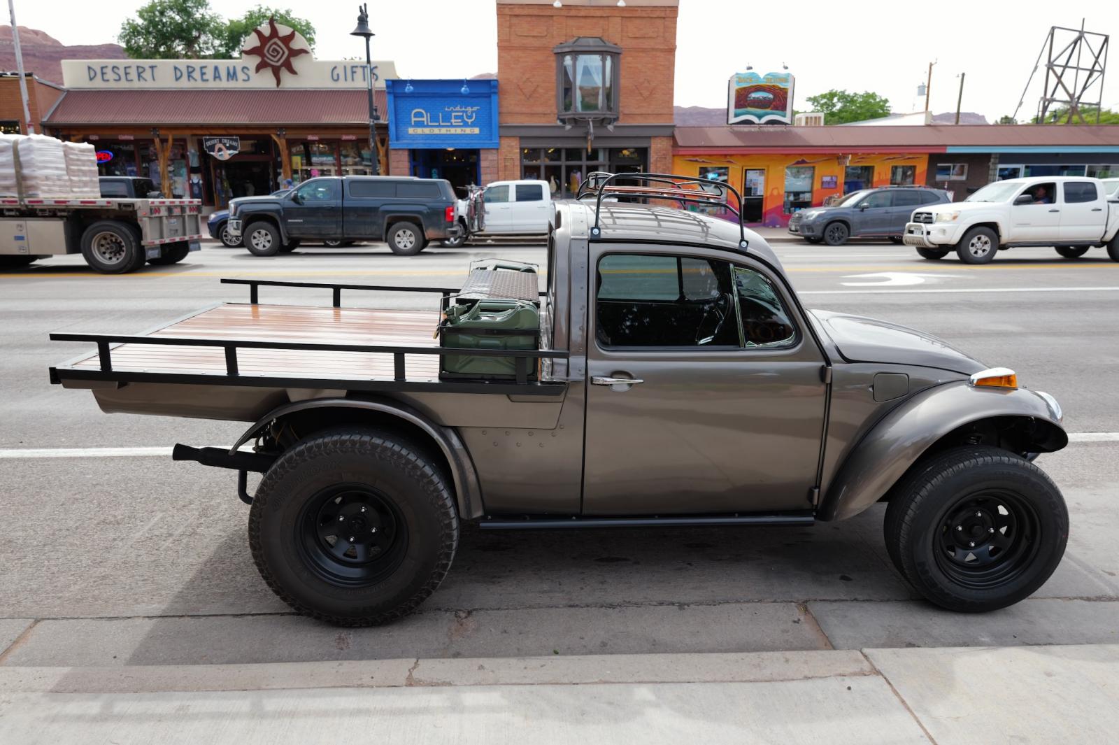

I saw these rock rails today, and really want a set. I assume they are home made, but if not, take my money.
They were on this beaut.
-Joe

If you can fab a flatbed into a bug I'm sure those sliders were nothin to make.
