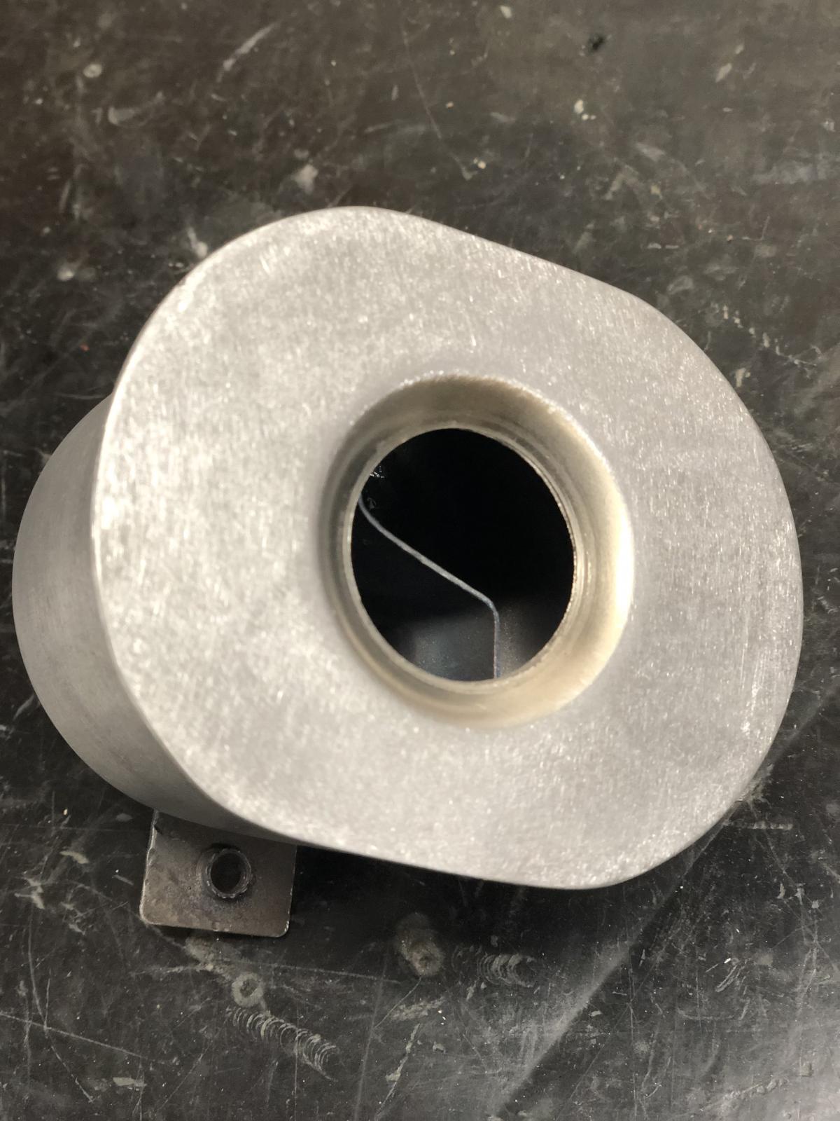

I have seen an early metal reservoir cut down the middle, in half. Then a nipple was welded into each side at the bottom. Then the 2 halves are welded back together with a steel plate separating the 2. It ends up looking OG and satisfies the 2 independent banks.
I went looking for it and cannot find it. If you want something like that, you could probably do it yourself, or get a local welder to handle it, or PM me. I might have a free minute in the next few months!

vwhelmot wrote:
Pics from the reservoir build. I wanted to keep it stock looking.

VW_Jimbo Premium Member
Joined: May 22, 2016
Posts: 11160
VW_Jimbo is offline
PostPosted: Tue May 20, 2025 10:31 pm    Post subject: Re: AC Industries master cylinder suggestion Reply with quote
Awesome! But please edit your post to “thread”, not tread! That is when the spell checker is not wrong but is not write! (Get it!)
And thanks for inputting that. I am never sure if that is frowned upon or encouraged. I always try embedding a link so anyone who stumbles onto the thread, can get to the info. But I really like when the info is RIGHT THERE!

PostPosted: Thu May 22, 2025 11:29 am    Post subject: Re: AC Industries master cylinder suggestion Reply with quote
Thanks for all of the info, I would like to keep the original look of the reservoir, so may go with the 2nd option, and thanks for posting the pic.s!
The underneath reservoir is def a second option.
Thanks Dan for mentioning the "T" - have to see how mine is hooked up, been quite a few years

56Cabrio
Joined: May 22, 2008
Posts: 2053
56Cabrio is offline
PostPosted: Thu May 22, 2025 12:42 pm    Post subject: Re: AC Industries master cylinder suggestion Reply with quote
Again, appreciate all the help here.
If you do go with the second option you can leave your original reservoir in place, so you would still have that original look. That's what I did.
