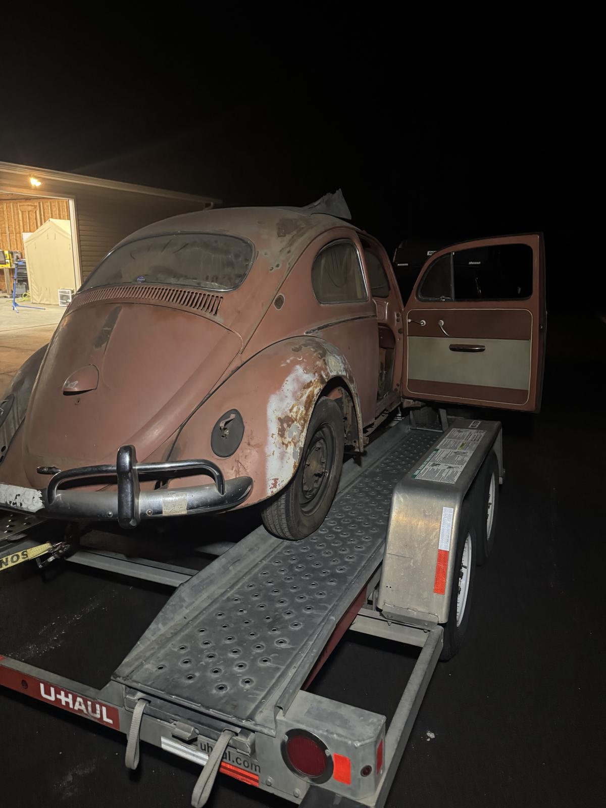

PostPosted: Mon Mar 17, 2025 7:03 am    Post subject: Mikes 58 Ragtop Beetle Restoration Reply with quote

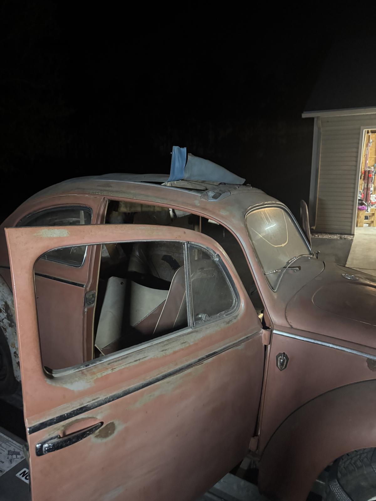

I picked up a 1958 Ragtop Beetle a few weeks ago. Will be doing a full off chassis restoration. Lots of rust in usual spots but will get it all sorted. Had a few Beetles growing up including a 58. It's been a while since I've been in the VDUB scene but something I've wanted to get back in to for a while. I've actually started the restoration process so will be following up with additional posts/pics. This is my first full restoration, so any creative criticism is welcome. Razz

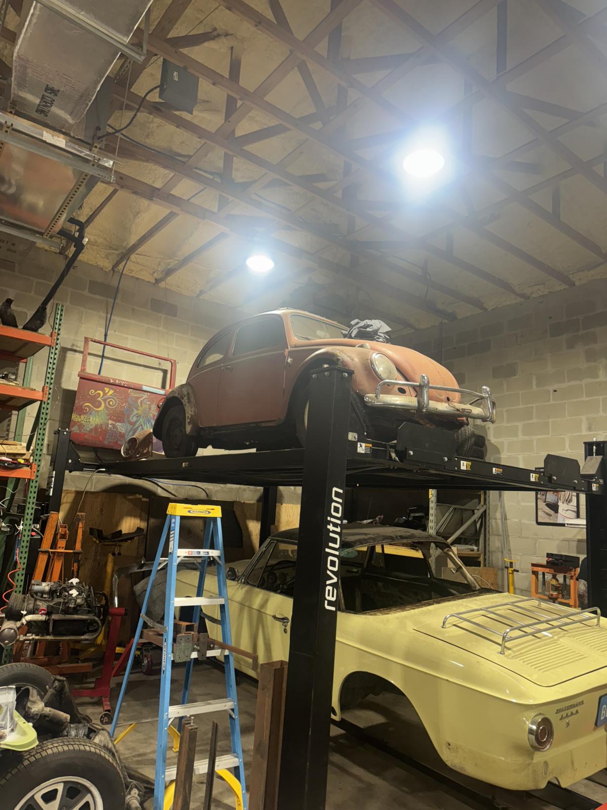

PostPosted: Mon Mar 17, 2025 9:37 am    Post subject: Re: Mikes 58 Ragtop Beetle Restoration Reply with quote

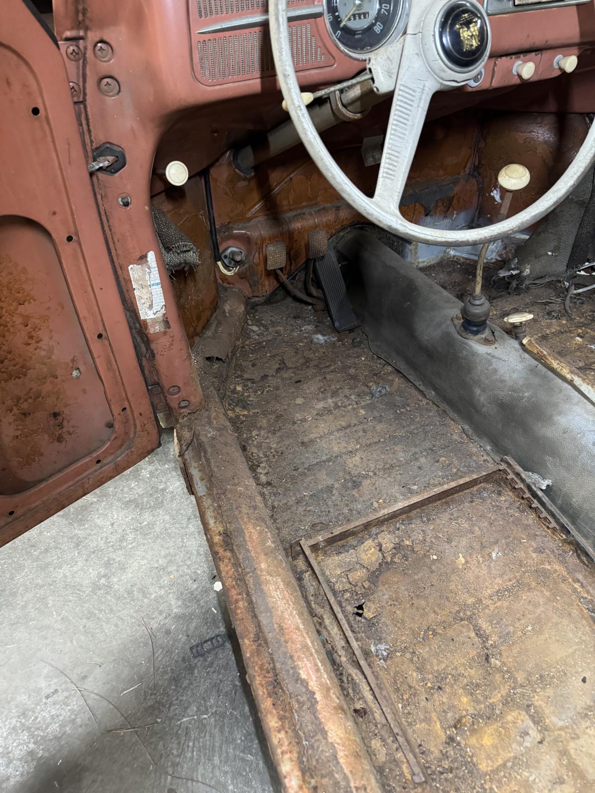

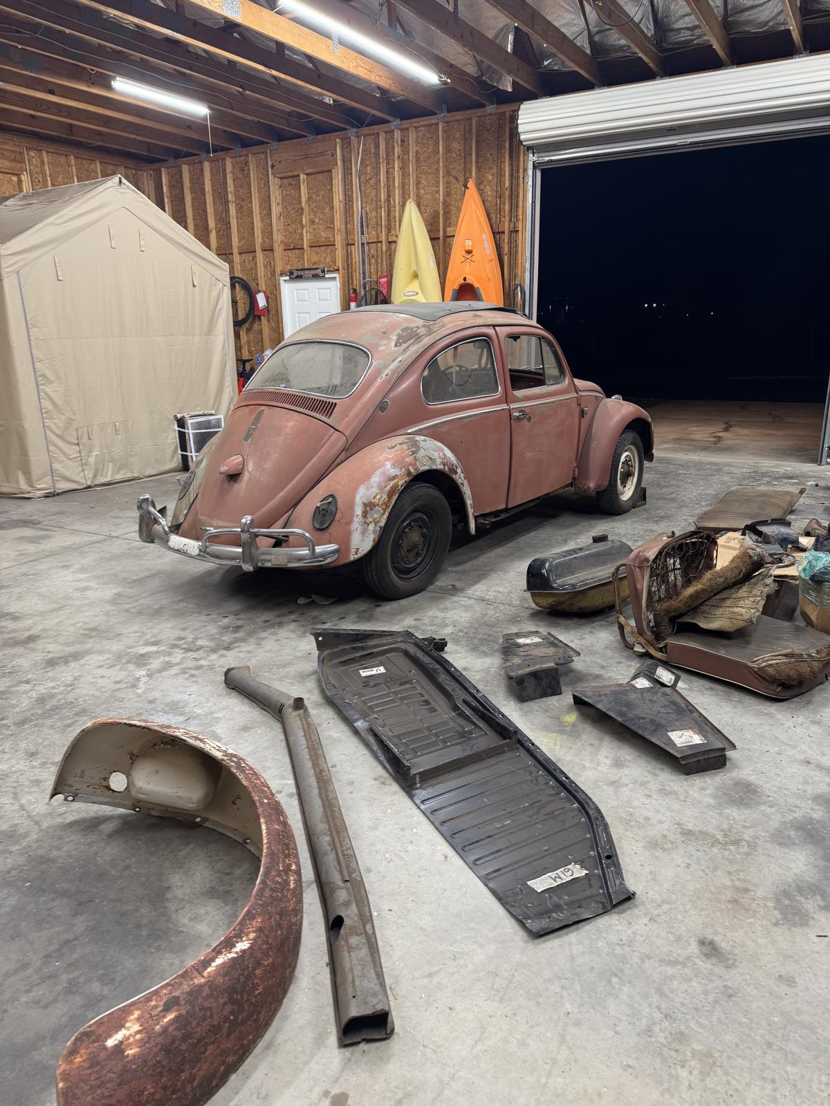

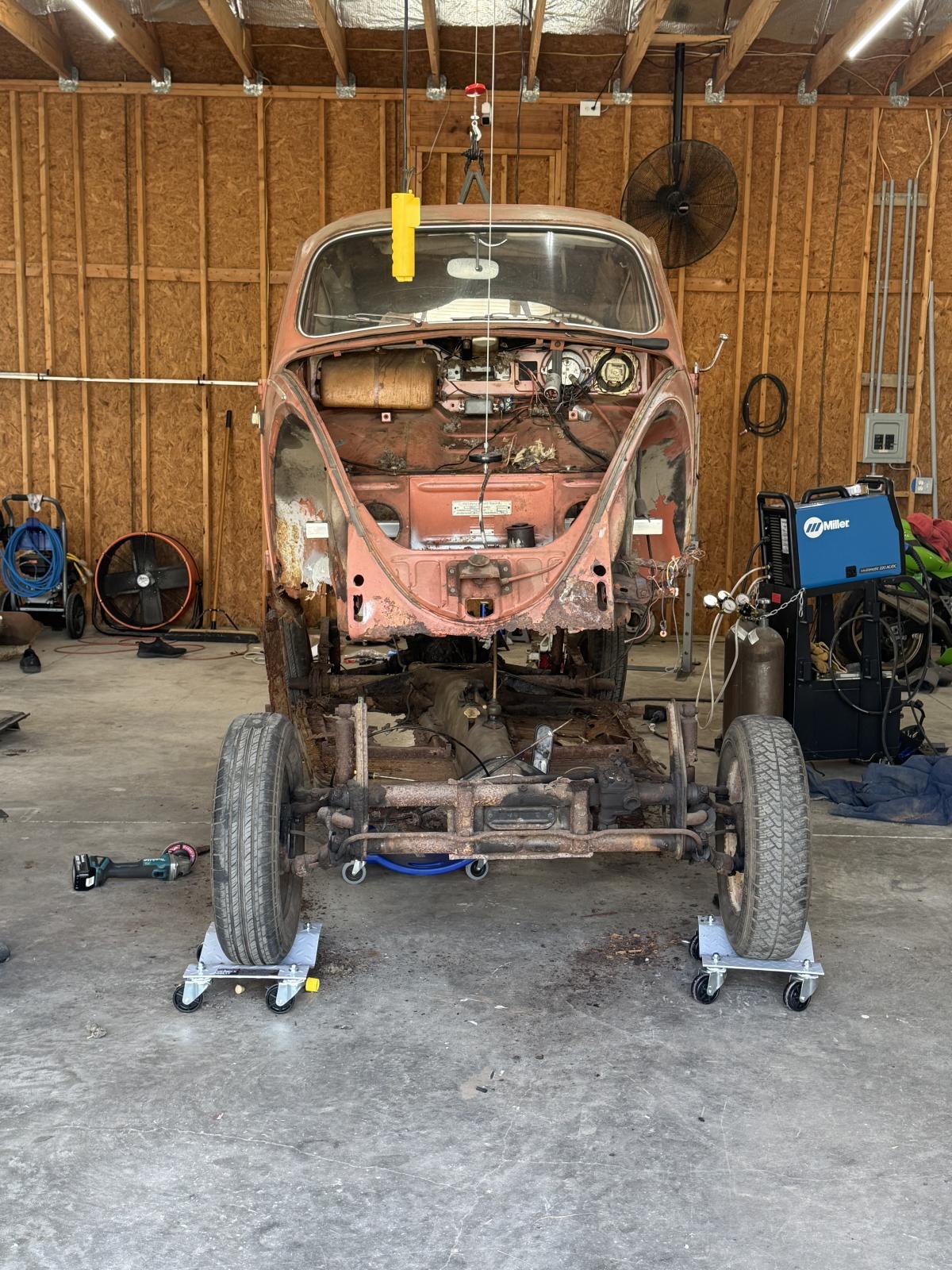

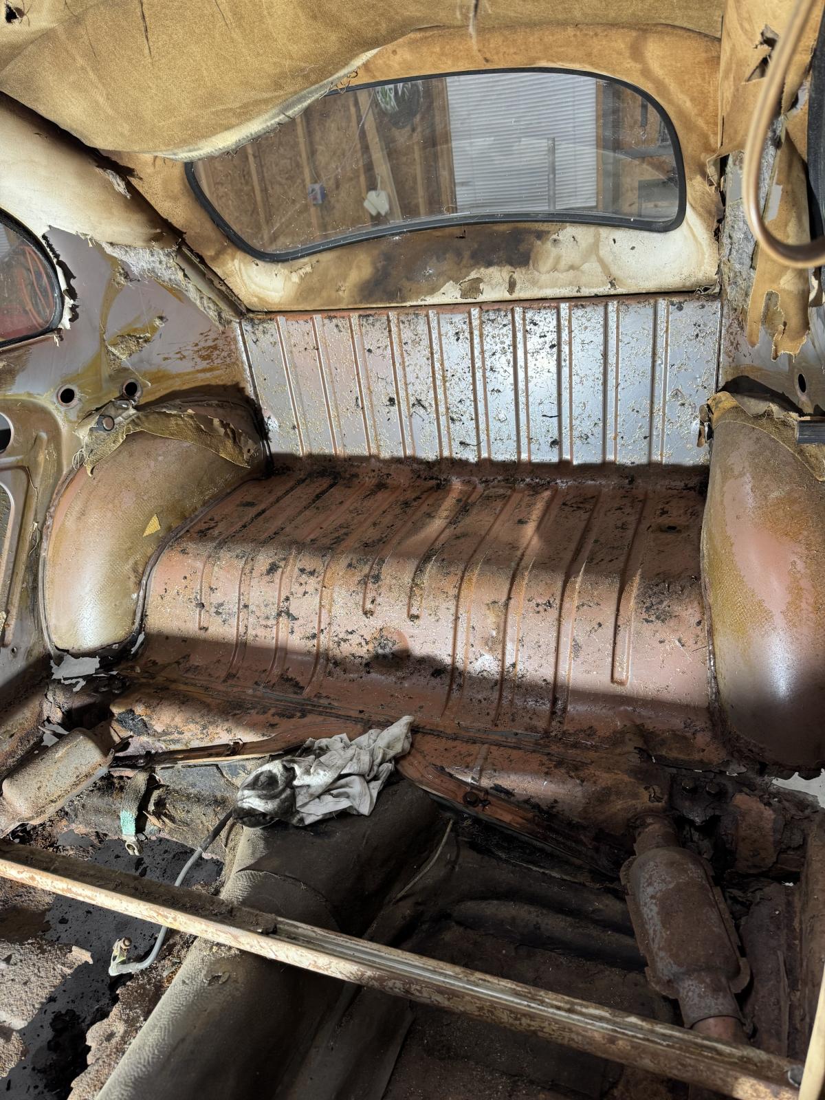

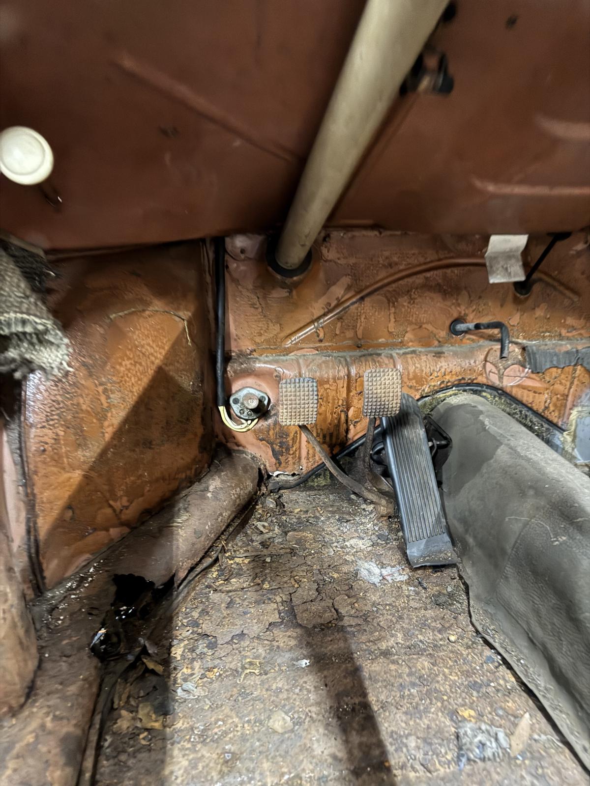

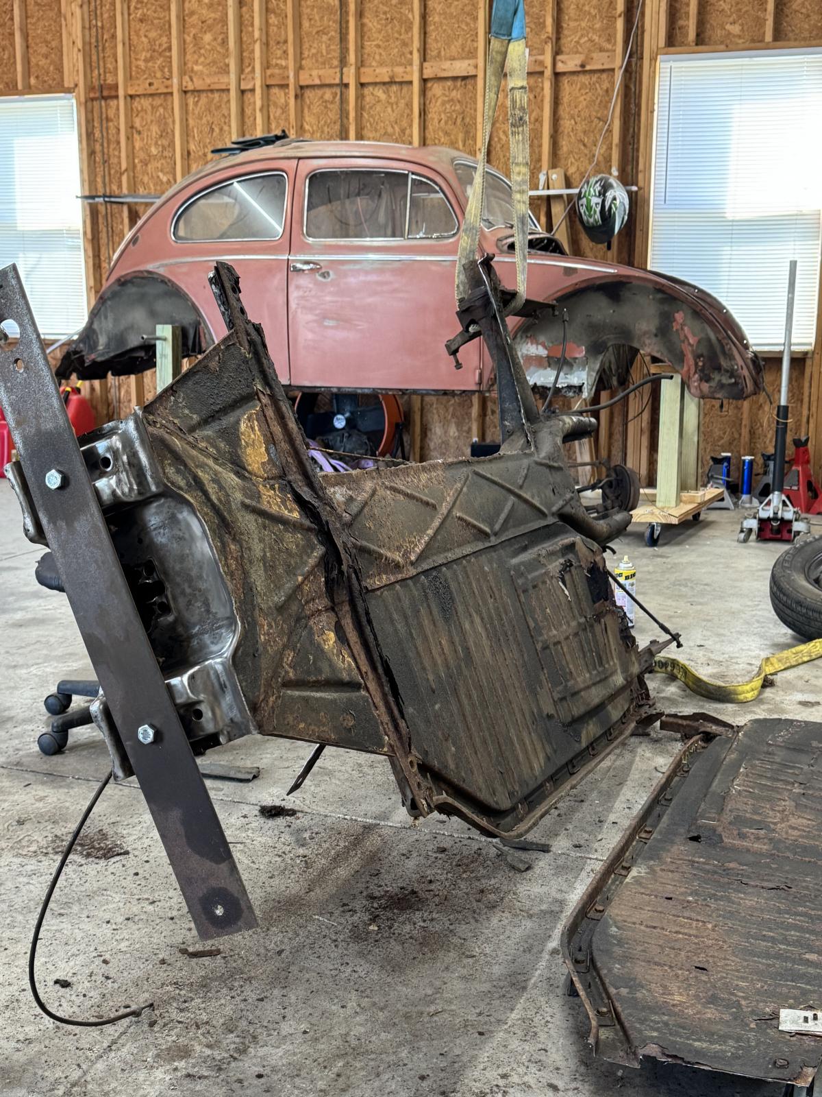

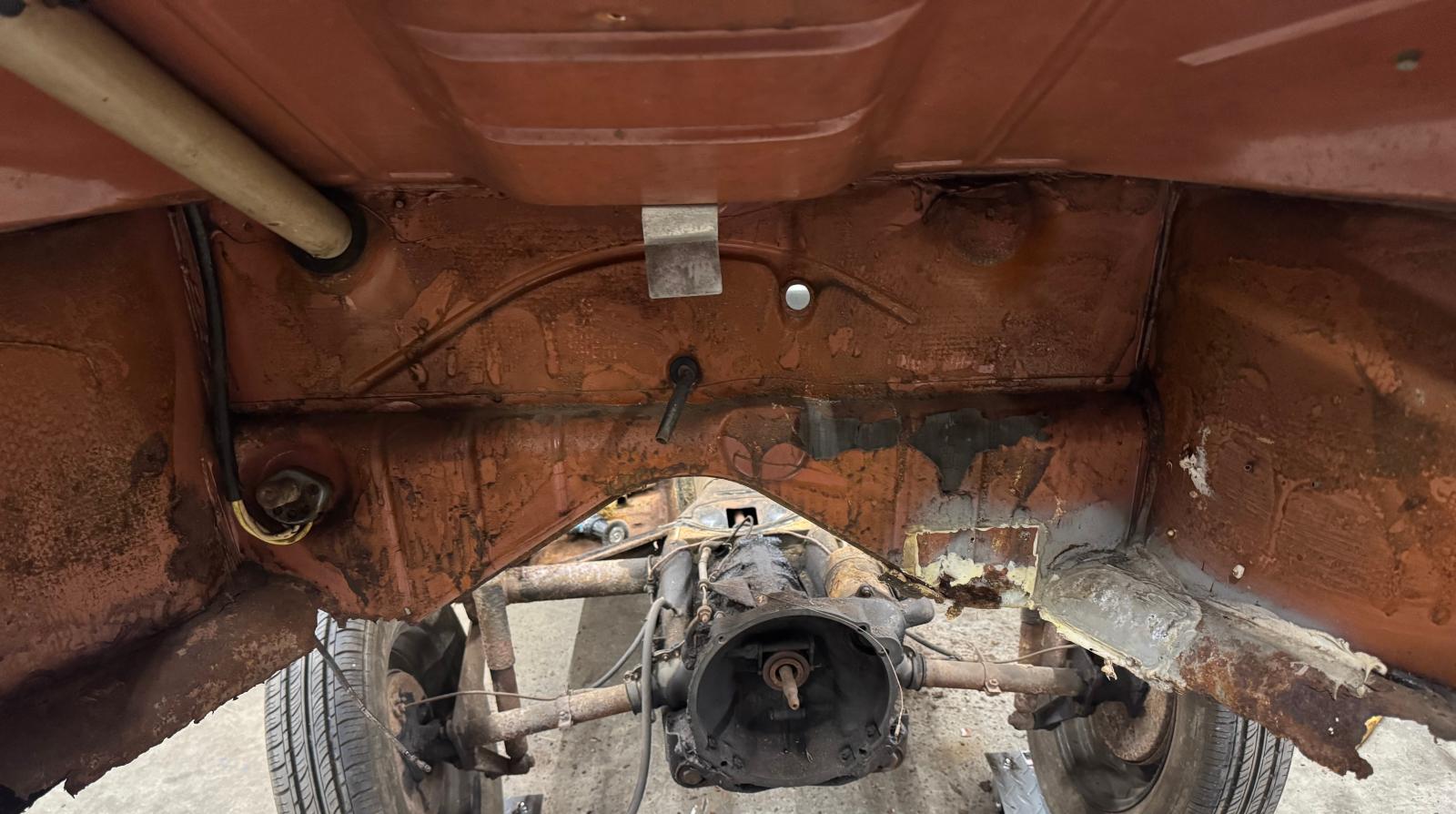

Spent time sorting through car and getting a better look at what I'm getting in to. The ragtop seems to function just fine. Just needs servicing and new top. Cleared the cargo tray and was pleased to see rust only down by the supports. Definitely will need new heater channels and floor pans, which a driver side pan came with the car. Also, some firewall repair will be needed too. Next will be removing body from chassis.

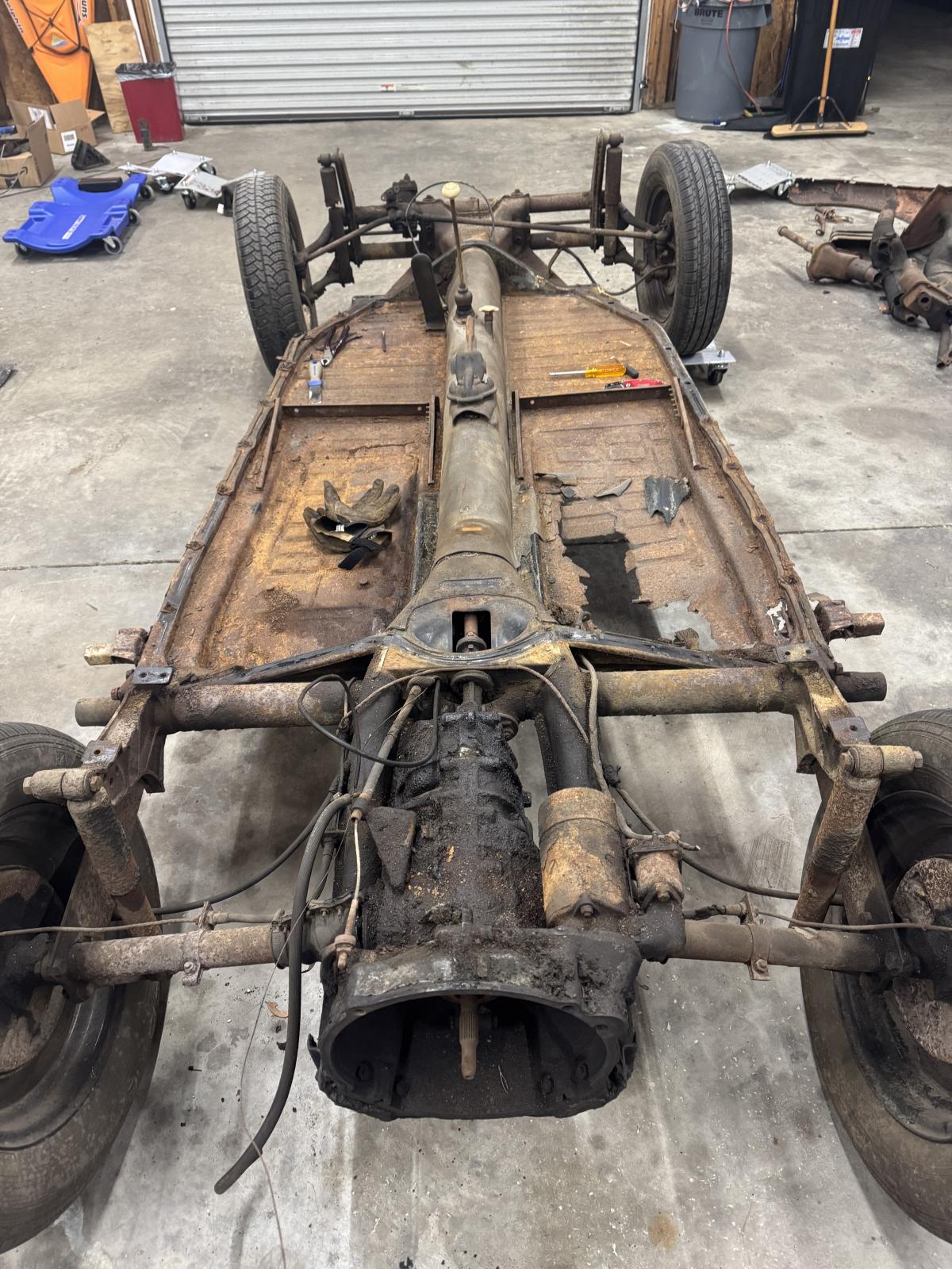

Mike1101
Joined: February 26, 2025
Posts: 13
Location: Florida
Mike1101 is offline
PostPosted: Mon Mar 17, 2025 10:13 am    Post subject: Re: Mikes 58 Ragtop Beetle Restoration Reply with quote

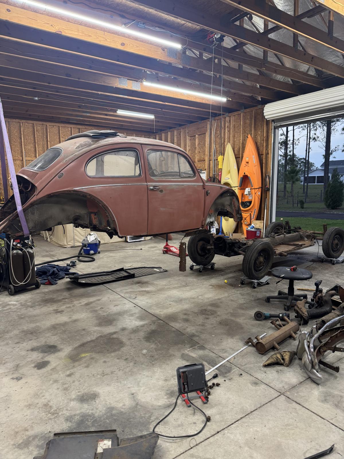

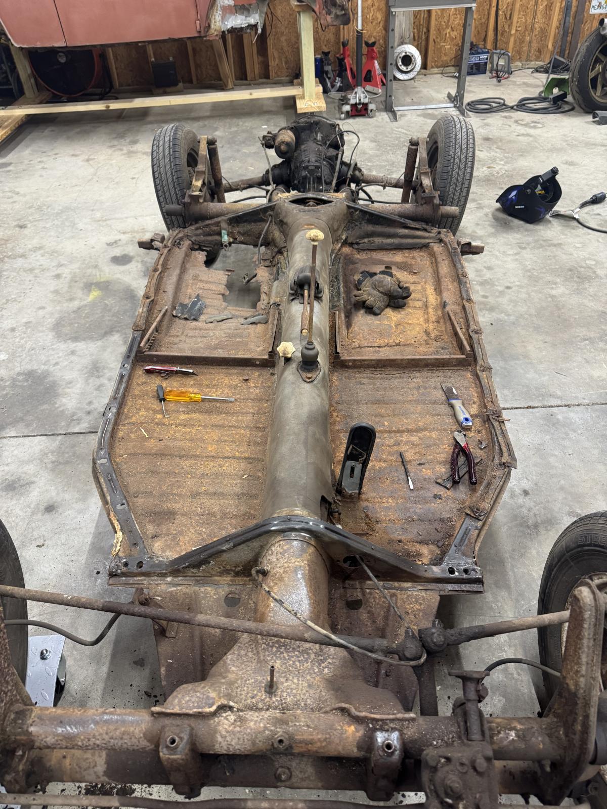

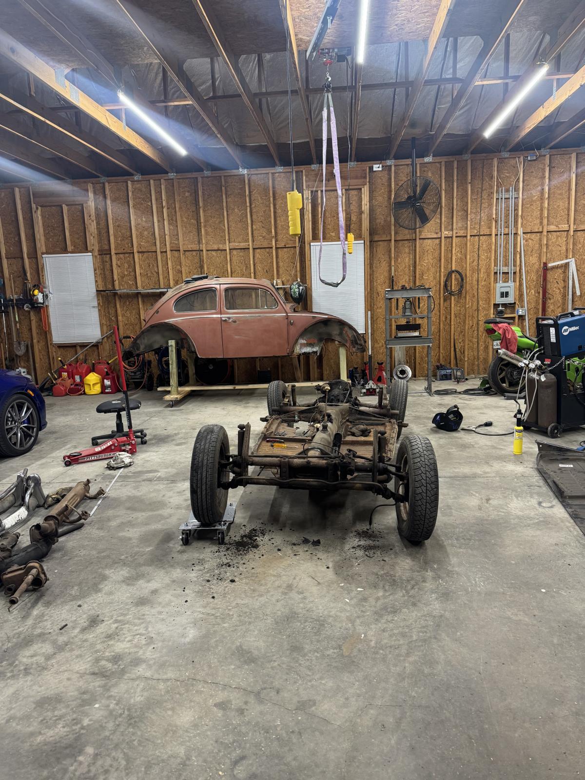

Huston, we have separation! Applause

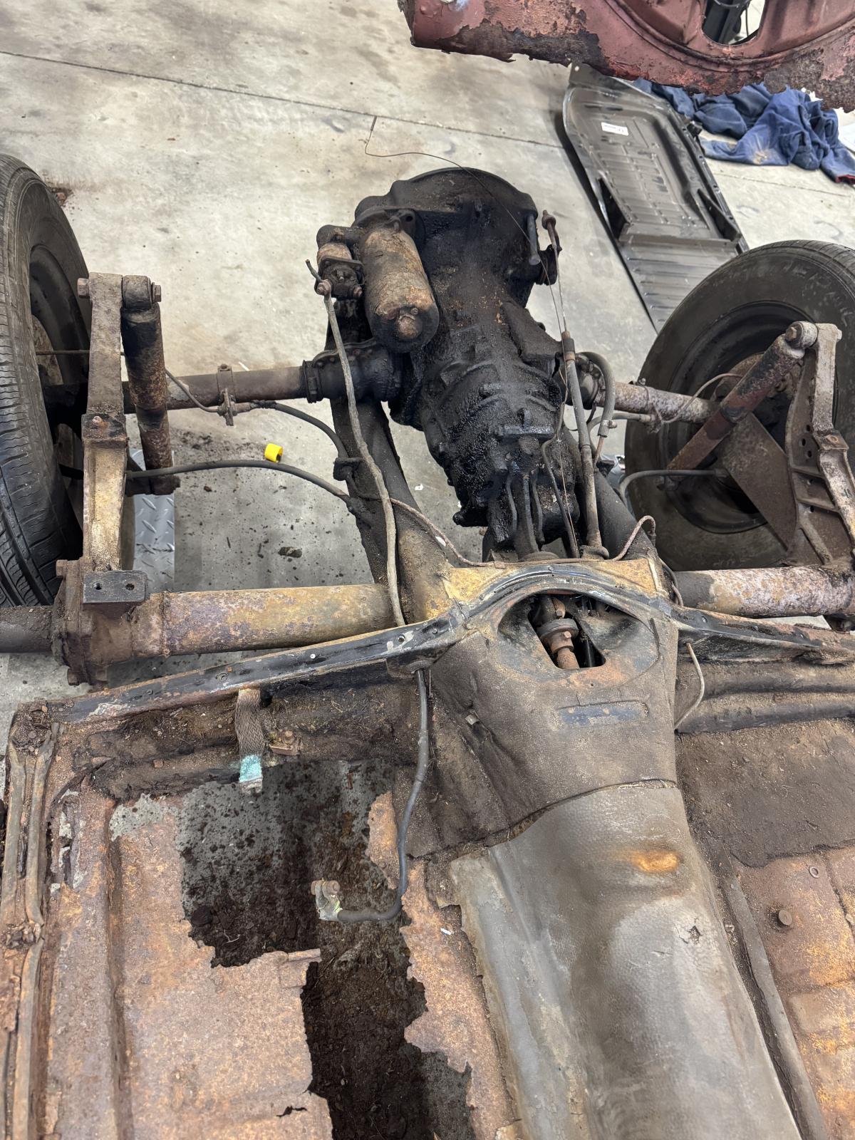

Disassembly begins. Lifted body off chassis. Think my plan off attack will be to focus on chassis restoration first. Did see some pretty bad rust directly under the napoleon hat that need to be addressed. Also think it will need a complete napoleon hat replacement. The rest of the chassis looks to just have surface rust which Ill dispatch with a wire wheel. Next Ill disassemble chassis and cut out floor pans

Looks like, except for the rust you mentioned a pretty nice car.
Coral is one of my favorite colors, and a rag? Nice score! One thing to note, looking at the pics, not sure about the drivers side, or the quarters, but the passenger side door panel looks really clean. I would at all costs try and keep the og panels, as the repops, in my opinion just dont look right.

Mike1101
Posts: 13
Location: Florida
Mike1101 is offline
PostPosted: Mon Mar 17, 2025 10:59 am    Post subject: Re: Mikes 58 Ragtop Beetle Restoration Reply with quote

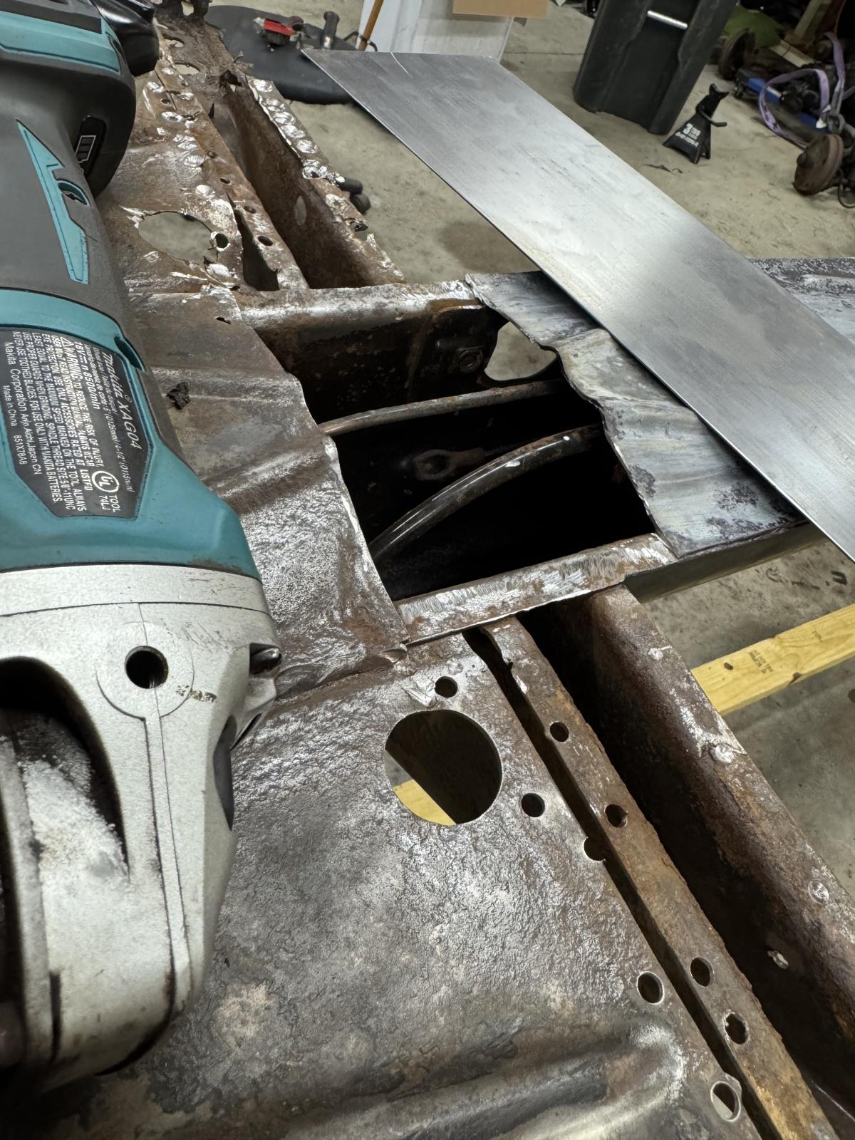

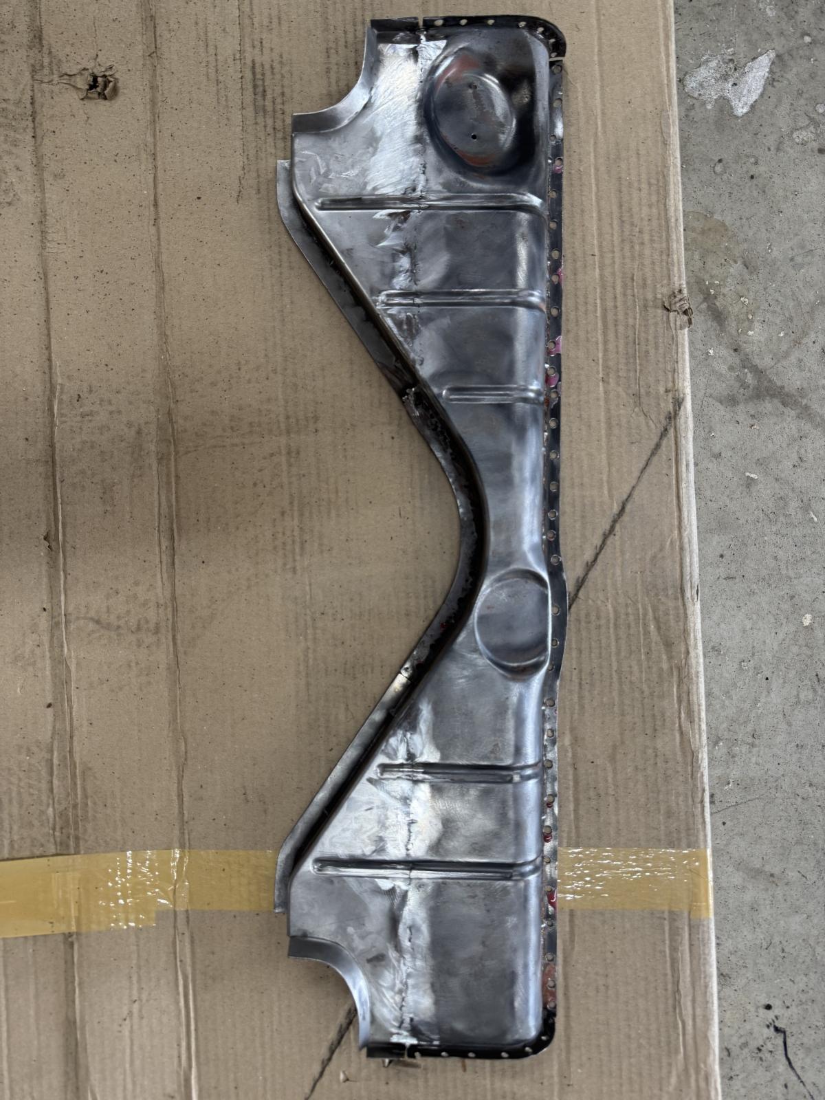

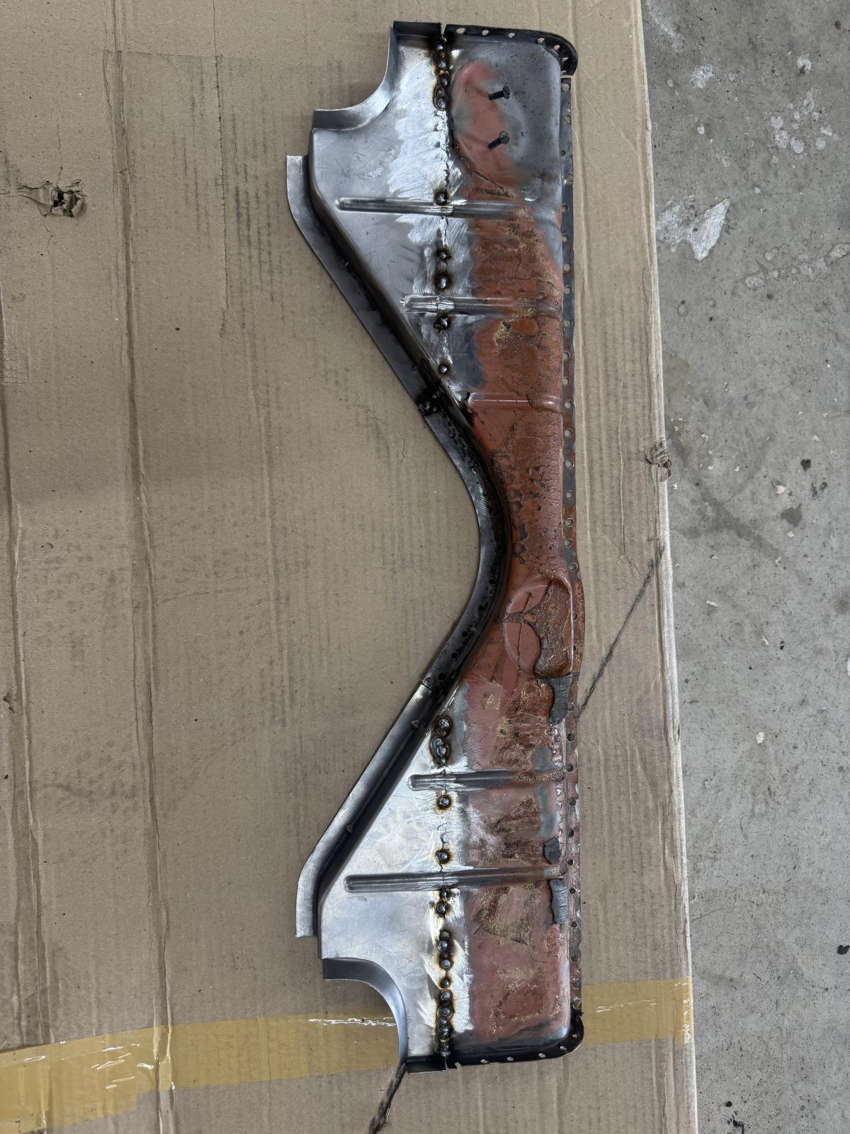

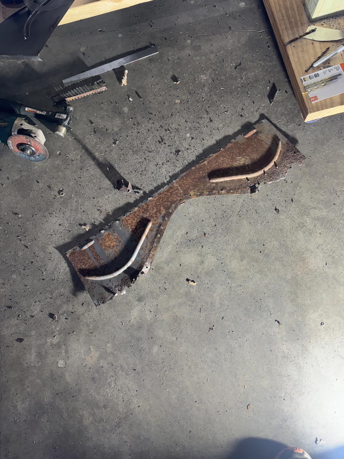

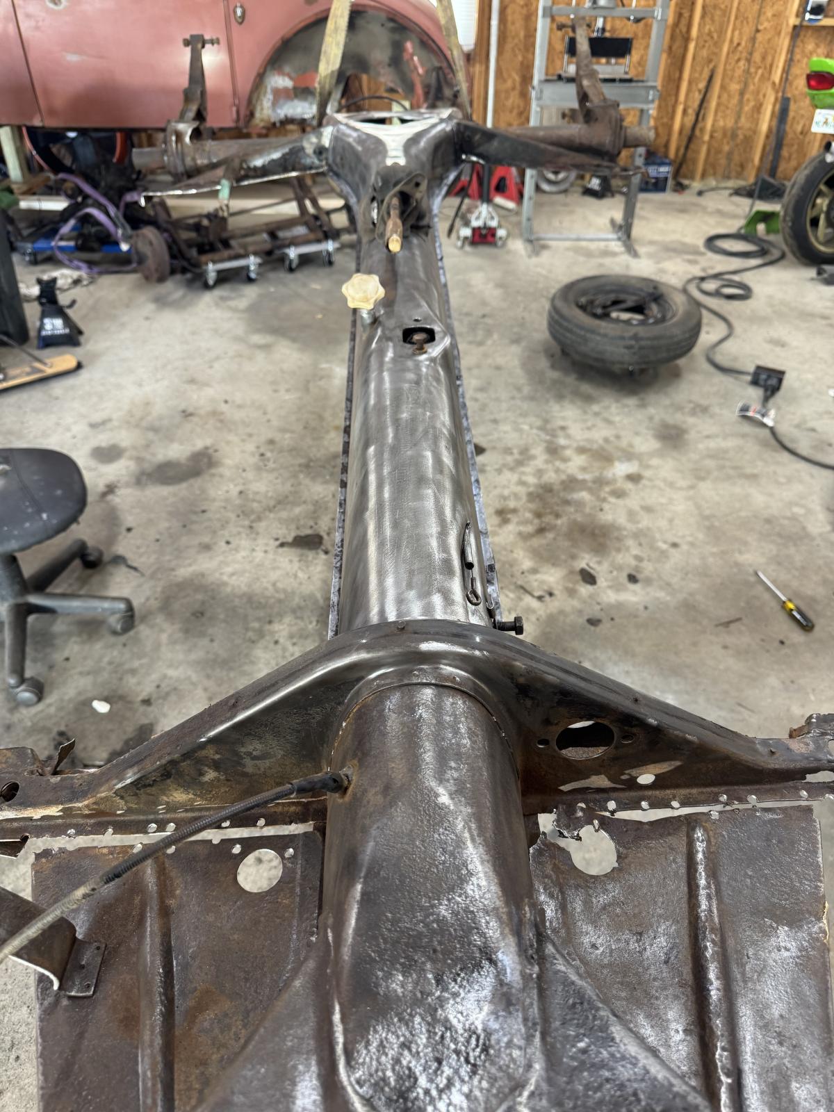

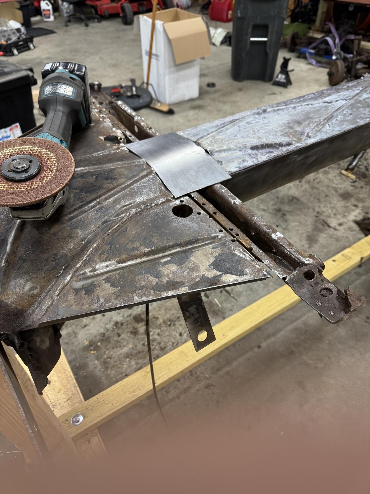

The rust below the napoleon hat was much worse than I expected. I was also hoping to save the napoleon hat, but the ends are wasted. While I'm waiting for parts Ill cut out the pans and address this major rust issue on front chassis bottom side. The silver lining is now I have internal access to the front chassis tube so I will rust treat as much as I can with Naval Jelly. Hope I cut out enough rust to get a decent weld for patch plate. Its 14-gauge plate so think there is still some good metal to make it stick.
I fully agree as to the right door panel!
OP, I was skeptical about the amount of welding work your '58 needs in your opening post but am glad to see you have equipment and skills to do the welding/patching.
I strongly recommend to not throw out any panels/fenders/hood, especially if they are original German. The rear fenders, if original, should have pressings in the mounting flange between the bolt holes. Repro front fenders are easy to find but have many minor differences to German ones.
Your rear bumper is a '67, with the inner ends of the towel bars dipping down slightly compared to being level like the outer ends thru a '66. But they're German so hold onto it.

PostPosted: Tue Mar 18, 2025 2:21 am    Post subject: Re: Mikes 58 Ragtop Beetle Restoration Reply with quote
Your doing a great job on that chassis, it’s comin out really nice!! I agree, I would not throw away any original German parts until you are positively sure what direction you are going to go with the build. Original clean door panels and parts are hard to come by and those are in great condition. Love the set up you have , clean shop and plenty of space! Keep the pics comin!! Cool Thumbs Up Popcorn

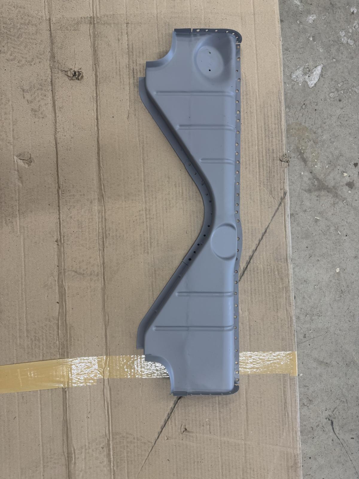

PostPosted: Mon Apr 07, 2025 11:56 am    Post subject: Re: Mikes 58 Ragtop Beetle Restoration Reply with quote

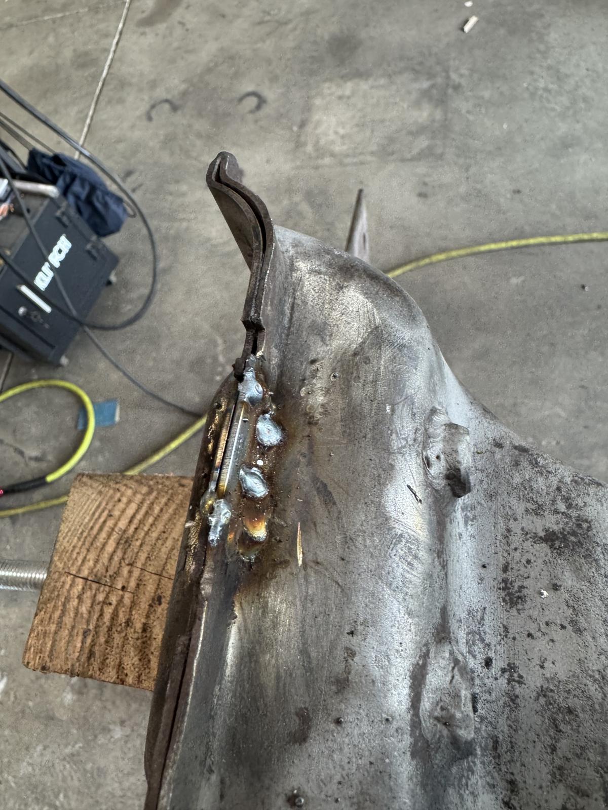

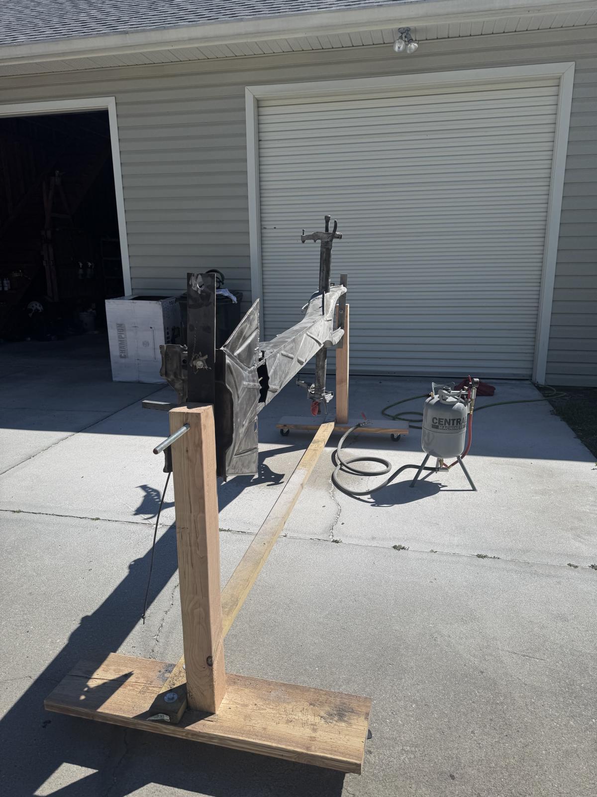

Making some progress on the 58 ragtop chassis. Got the major problem areas resolved. However, I was unhappy with the replacement Napolean Hat fitment. It was a klokkerholm part which required a bit of persuasion to fit correctly. Should have just cut off the ends and welded them on as that was the only issue on the original hat. Made some additional bulkhead repairs and sprayed the chassis with a couple coats of epoxy primer. Decided to put the chassis aside for now and start on body work.

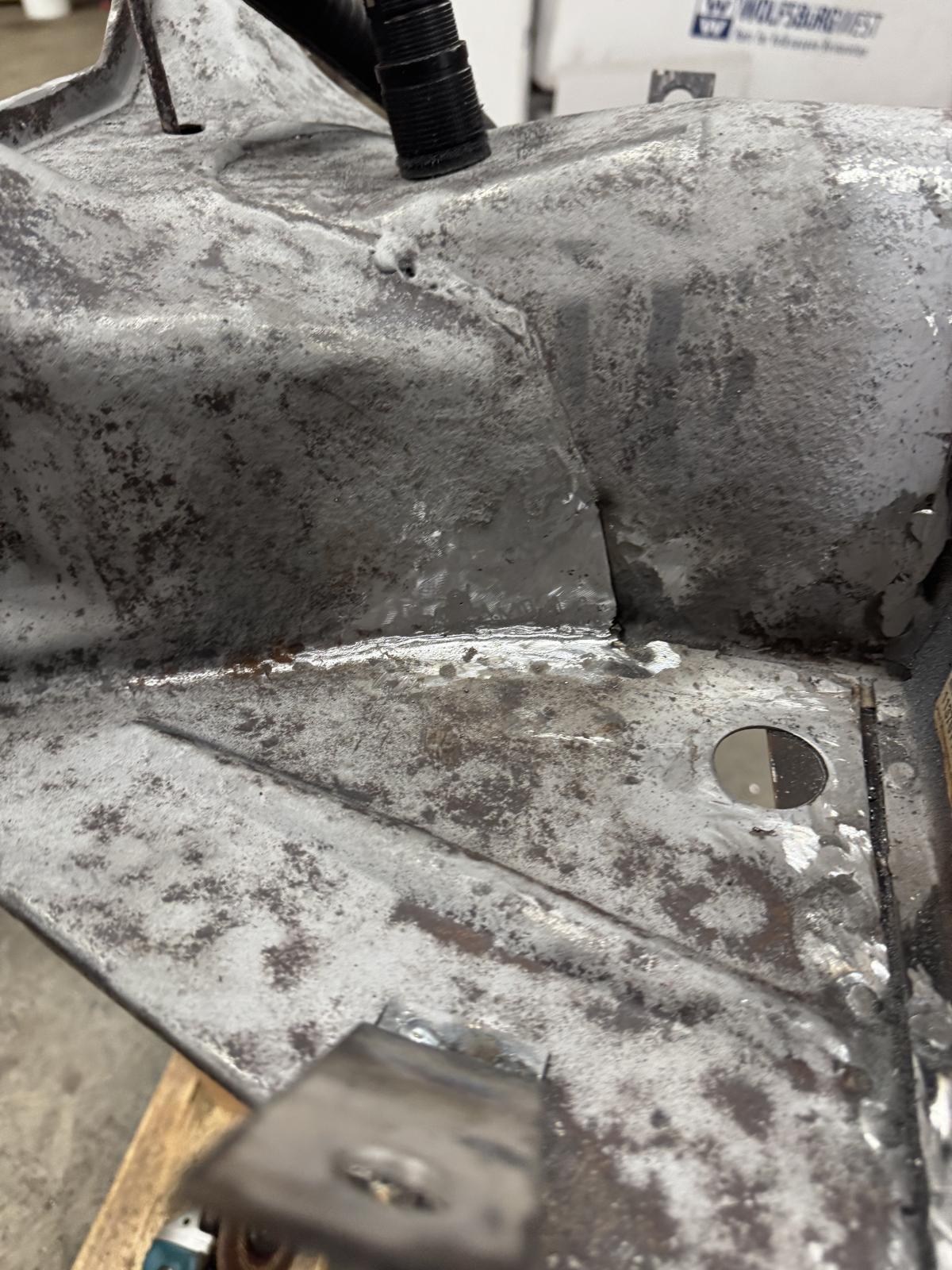

PostPosted: Mon May 19, 2025 6:37 pm    Post subject: Re: Mikes 58 Ragtop Beetle Restoration Reply with quote

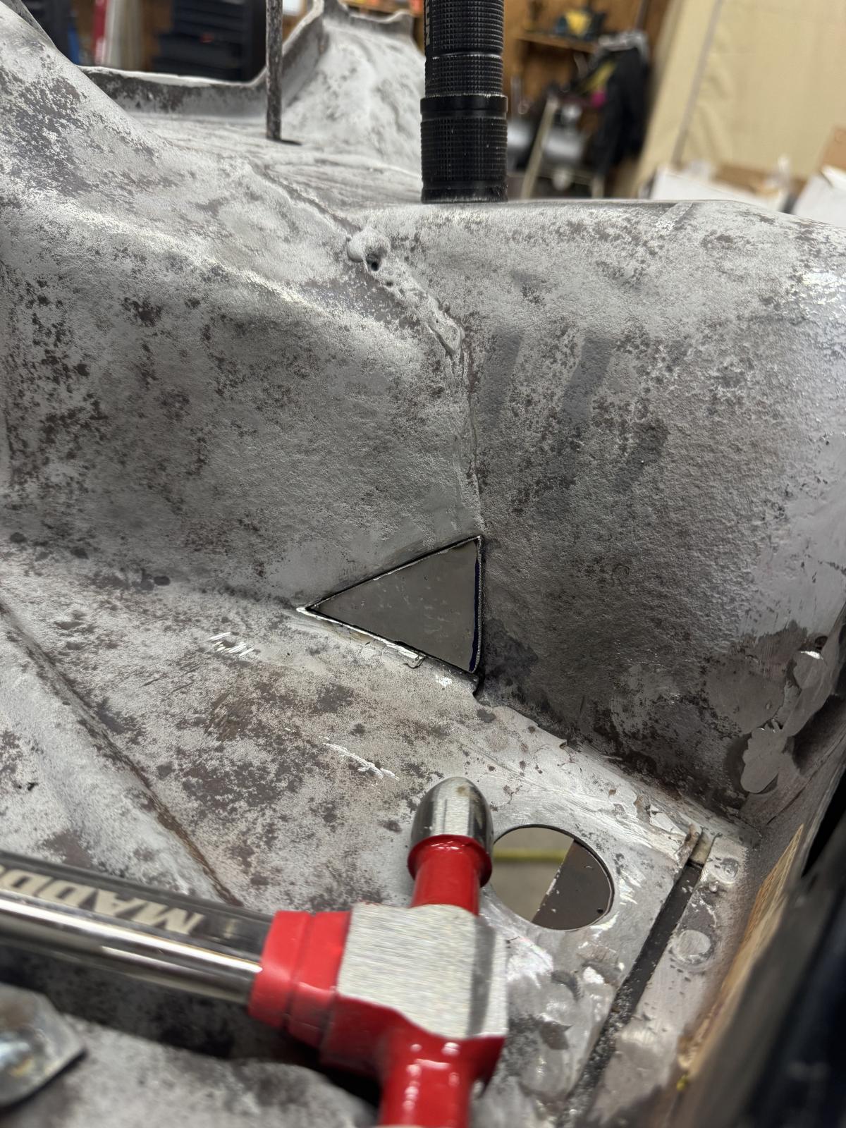

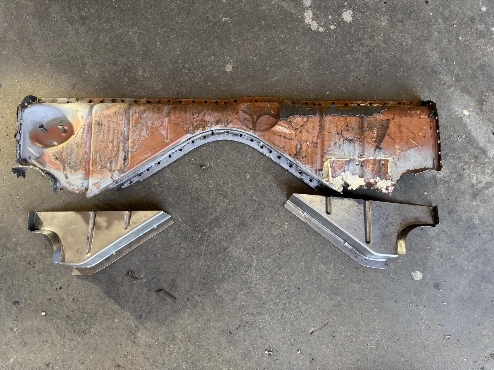

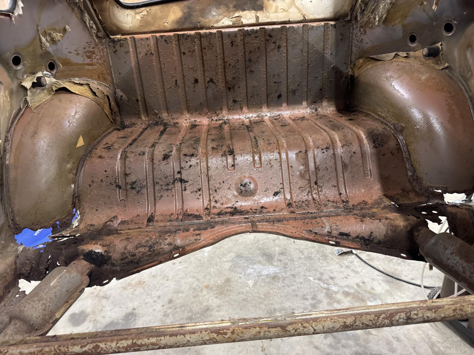

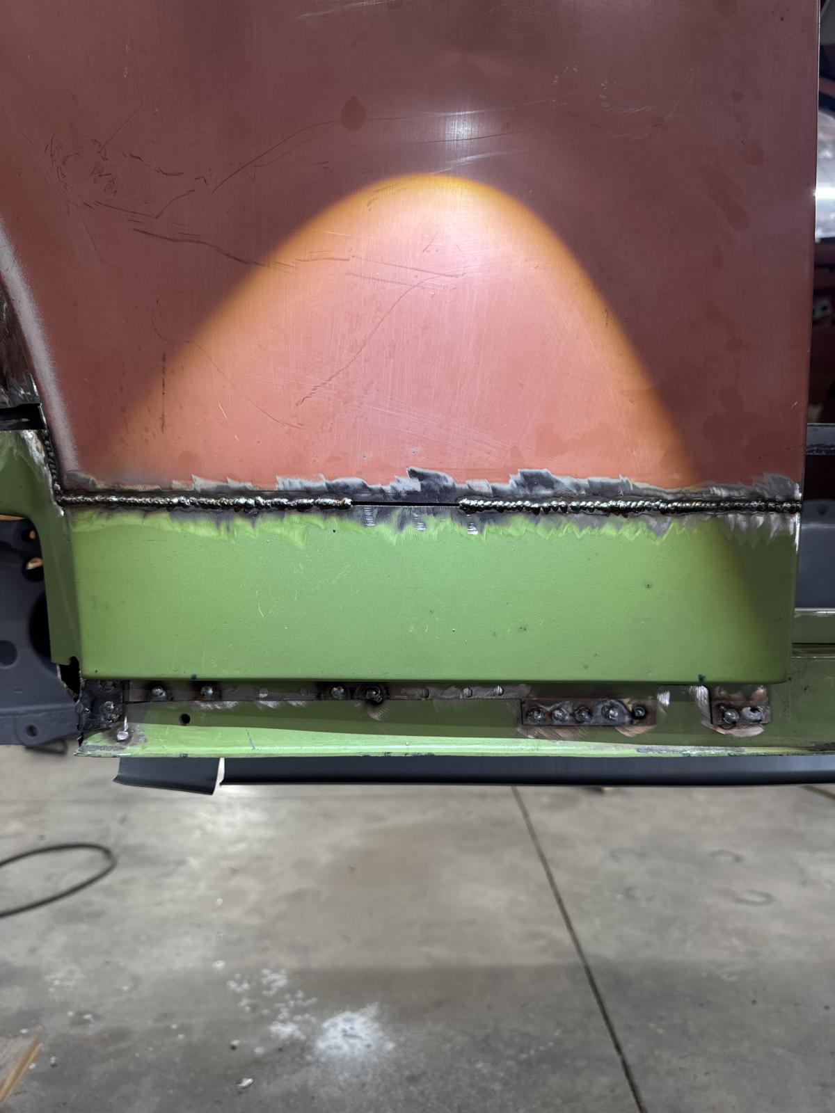

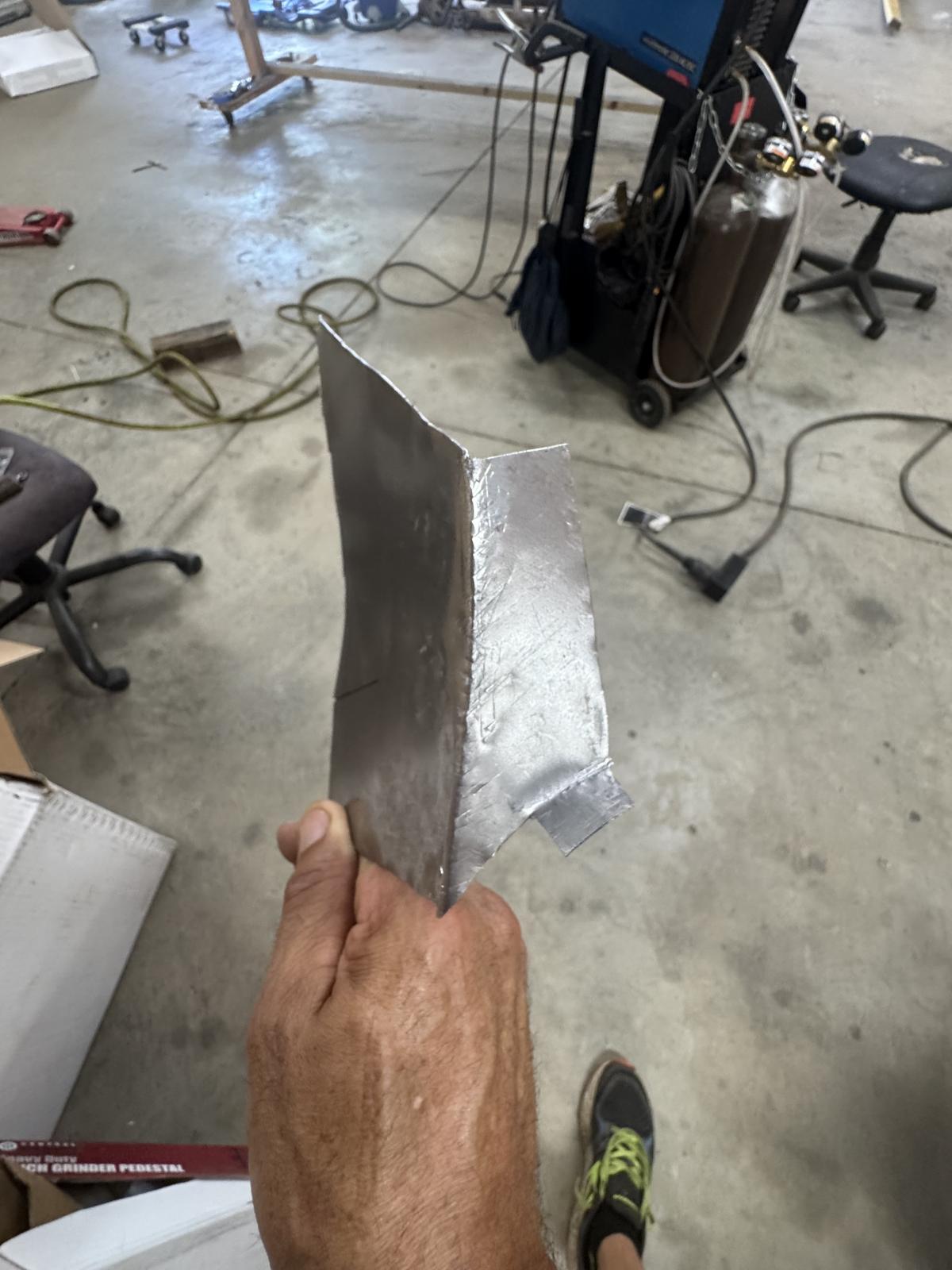

Haven't posted in a while so thought Id provide and update on the 58 Rag. Lots has been done, so ill provide several posts. I left off with getting the chassis sorted and primed. Since then I have begun work on the body. Lots of rust requiring metal work primarily at the lower 5 to 10 inches. Started with the firewall. My goal is to save as much original metal as possible within reason. Was able to rework the inner firewall with some lower replacement metal. Did the same for the lower half outer firewall.

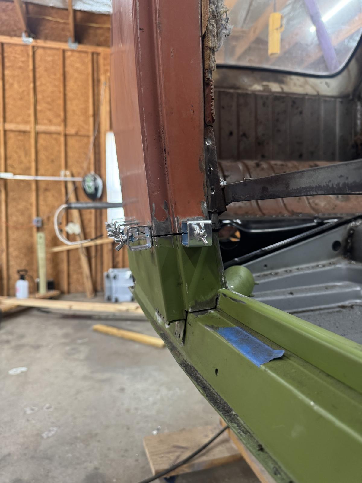

PostPosted: Fri Jun 06, 2025 1:24 pm    Post subject: Re: Mikes 58 Ragtop Beetle Restoration Reply with quote

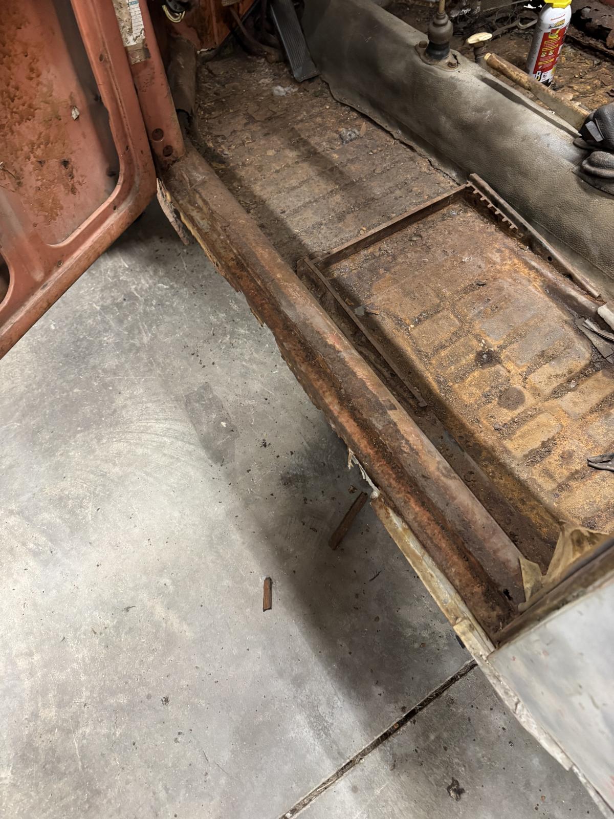

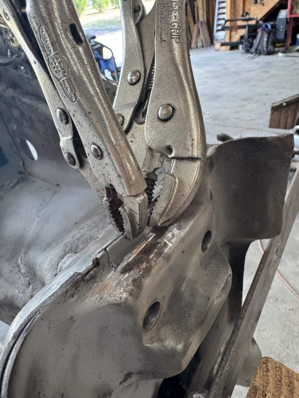

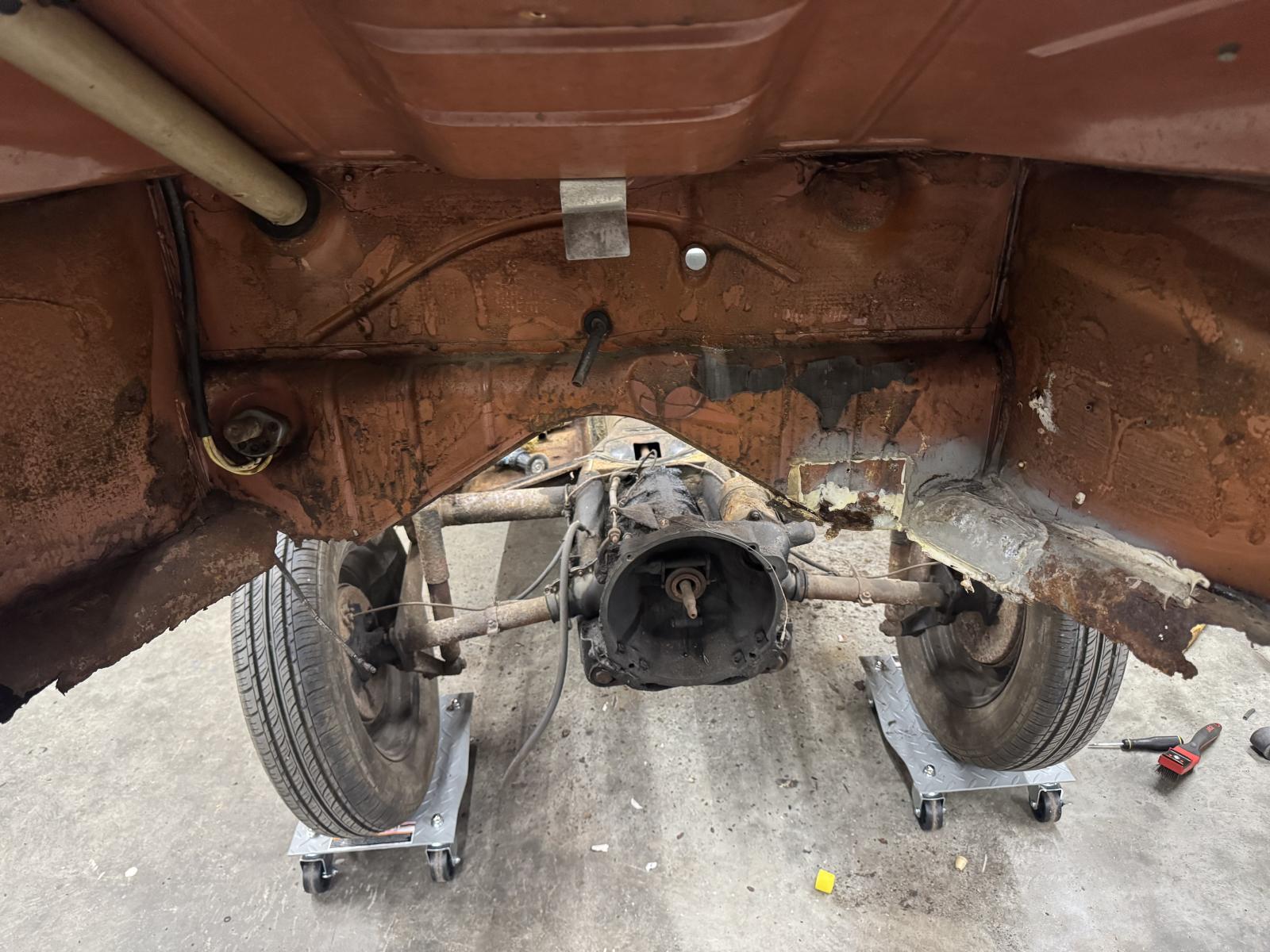

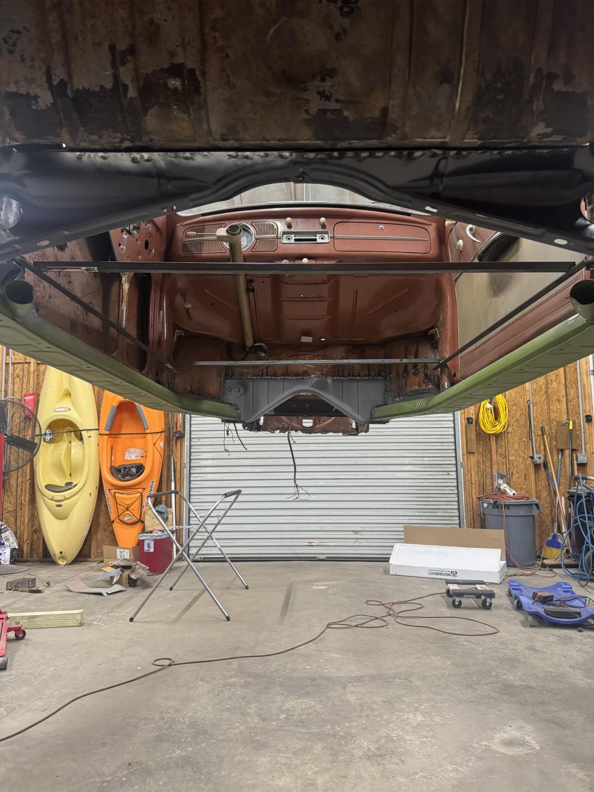

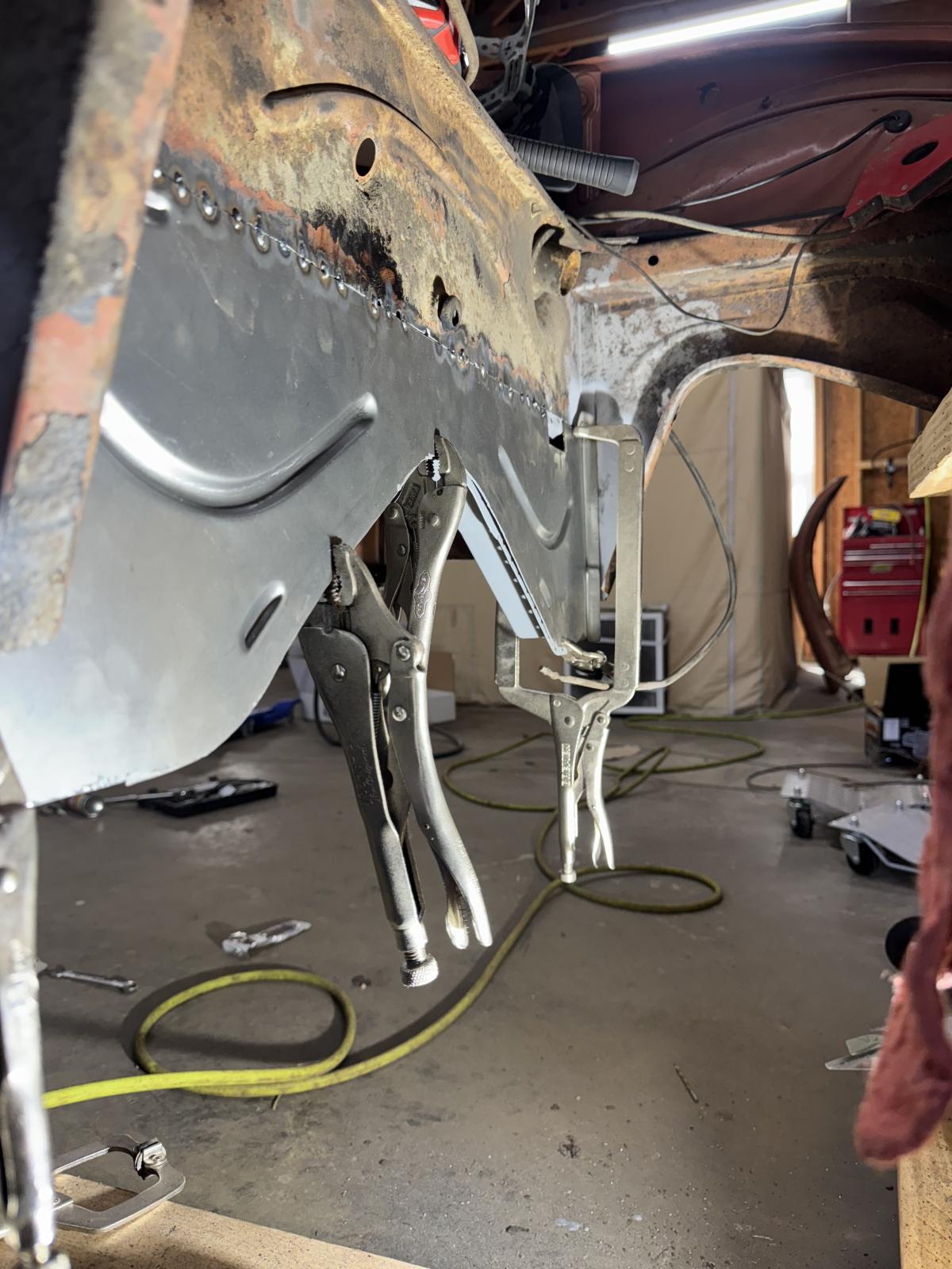

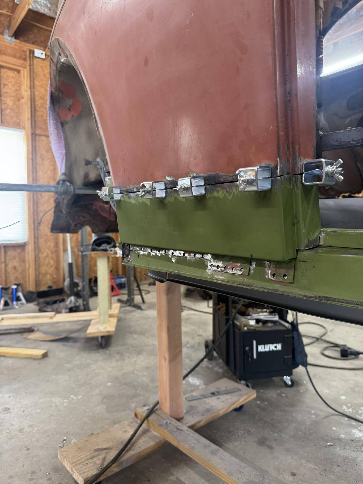

Here are some photos of the progress I've made on the 58 Rag. Heater channels are in and have been doing metal work to remove rusted metal. Basically working areas between front firewall to rear crossmembers. The inside quarter panel areas were very challenging due to the irregular shape but was somehow able to pull it off Shocked . Passenger quarter panel came out pretty good. Still need to do driver side. Hope to get another post up soon.
